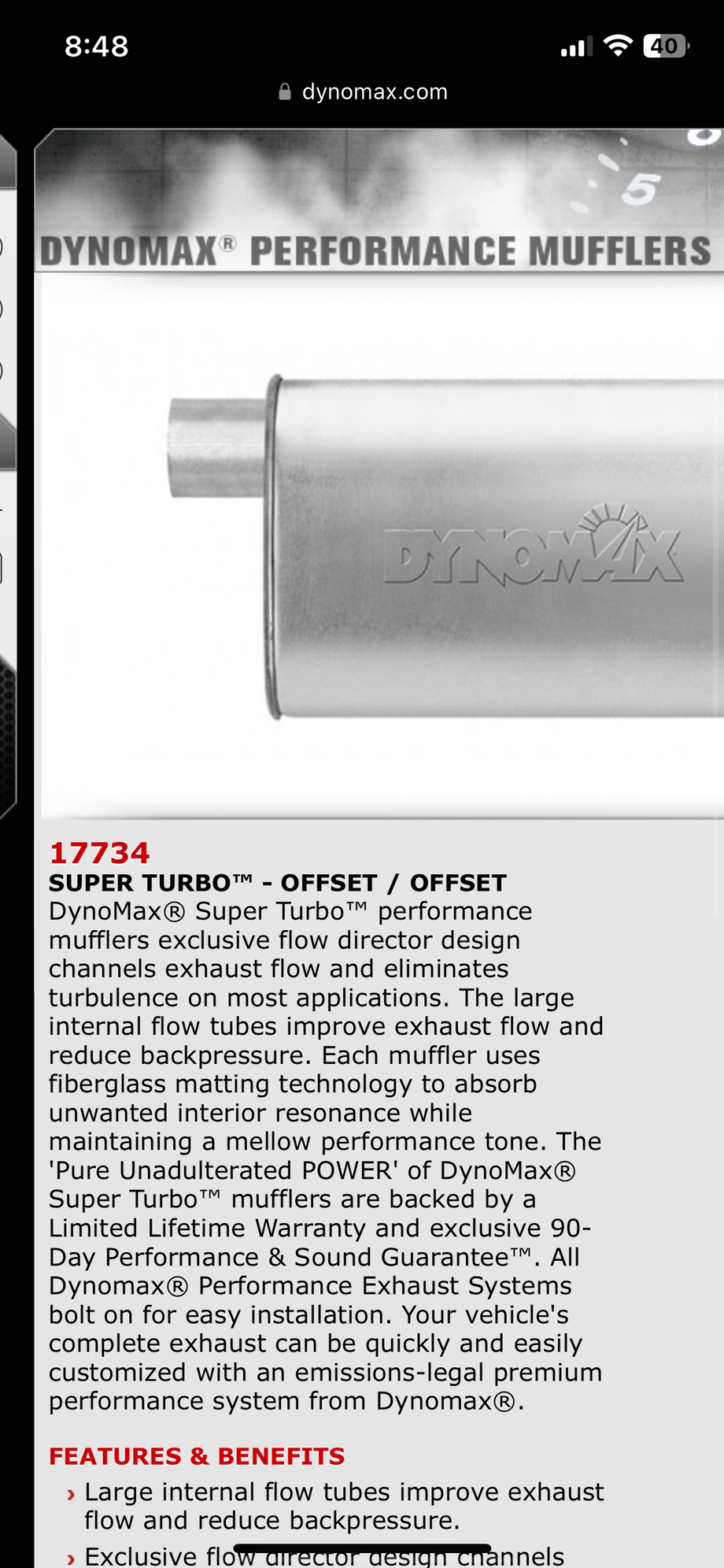

found the receipt from 1997
Dynoflow 17734 looks like a super turbo but they are old.
Old Sep 23, 2024 | 07:40 PM
Posts: 42,497
A lot of us use that same muffler without issue. My guess is that the innards have deteriorated.

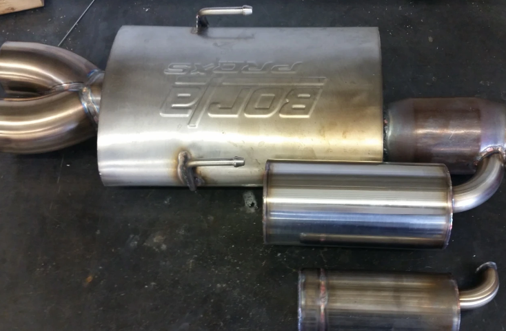

Helmholtz-resonator-style noise reduction pipe may help. Requires a bit more work. Just depends if you have the room. Looks strange, but it works. I know several 5/6th gen Camaro guys using these with different catback systems, although some just use a J-pipe instead of the proper chamber. Just something to consider.
If seriously interested in tackling drone, here's a nice little blog entry where someone built an exhaust system and used his own spreadsheets and caculations to build an H.R. to reduce/eliminate the drone. Includes links to get a copy of his Excel calculators if you want to build your own.

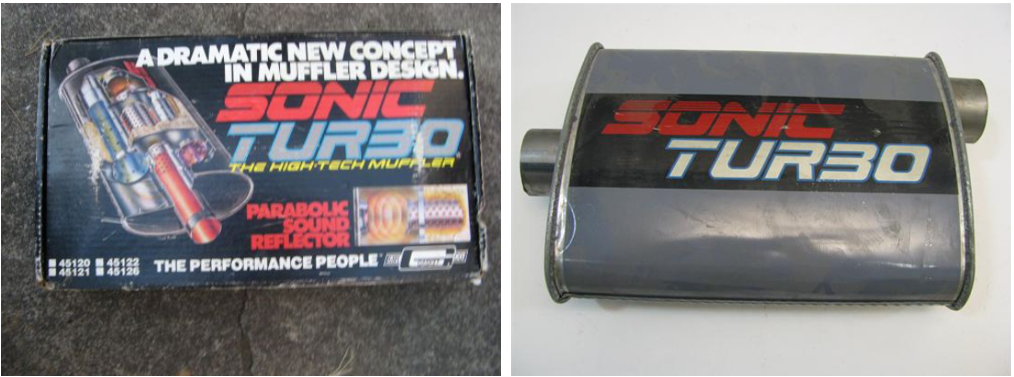

My car has a set of Sonic Turbo mufflers that I installed in the early 80s and they still sound good. They have been "abused" through a couple of engine, transmission, and rearend iterations but are still holding up well.
