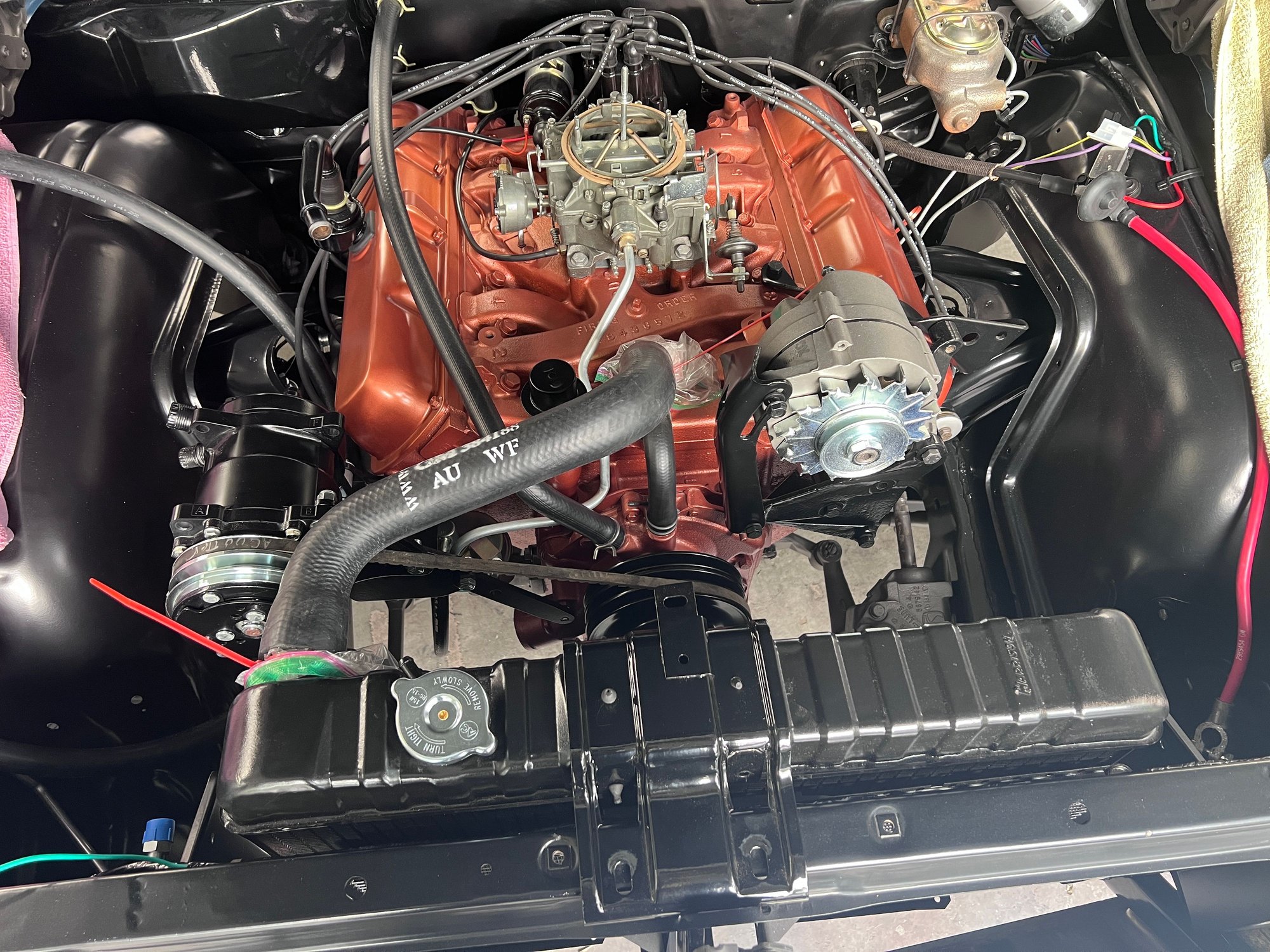

Rallye469's Avatar
Joined: Feb 2008
Posts: 2,664
From: Jacksonville, FL
Inline Tube.
The 66 wont work as it's a quadrajet and not a 4GC
https://www.inlinetube.com/products/...OlrIKMRS3NmNlc
(gratuitous engine shot!)
