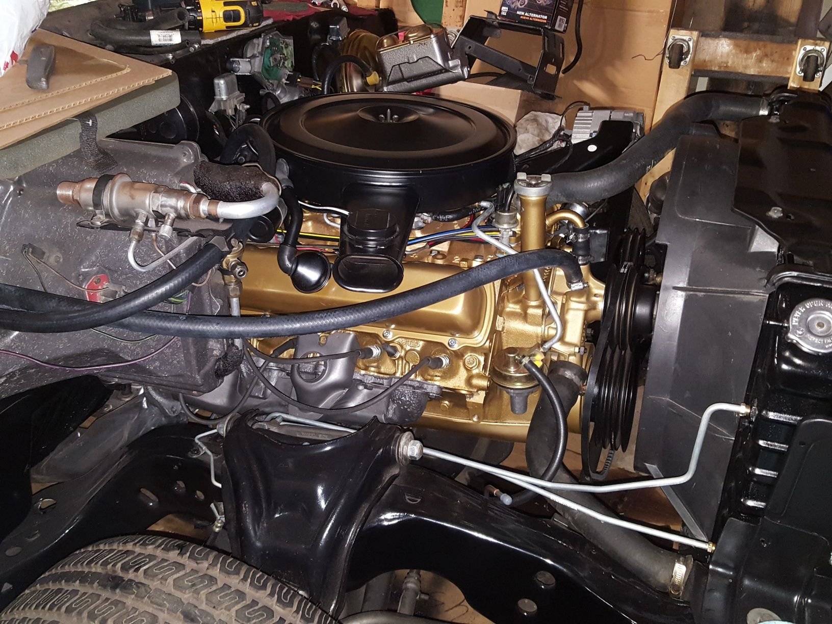

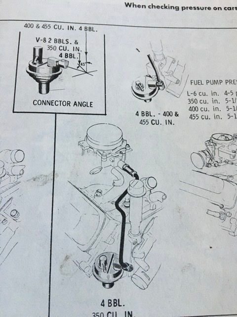

Trying to replace my pump to carb line, filter inlet is frozen to line and threads. Ordered a replacement line from Fusick. Isn’t fitting. Carb is stock pump is a 40704. Angles don’t work:
sorry about the angle, is correct on phone.
Anyone run into this? This is a AC car, but manual shows no difference in pump or line. Any other source of these?
if not might attempt to twist it to fit, or have line made.
Thanks.

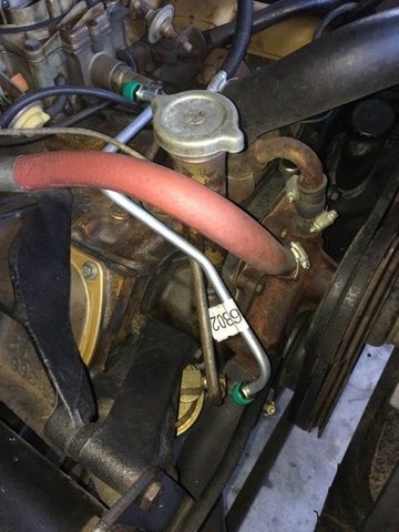

I rotated the image for you. This issue comes up more often than you might think. I replaced mine from Inline Tube a couple years ago - didn't line up correctly. I improvised by cutting out a center section ~3" - 4" of the metal fuel line (I had just purchased) & inserting a piece of rubber fuel line w/ appropriate clamps. Personally, I wouldn't worry about an exact fit - you'll gain the flexibility you need to assemble the fuel line with a center section of rubber fuel line. Your call, of course.

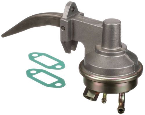

I don't think that your replacement fuel pump has the correct stock angled fitting.
Pump appears stock. Has the screw in fitting shown in the csm at the correct angle.

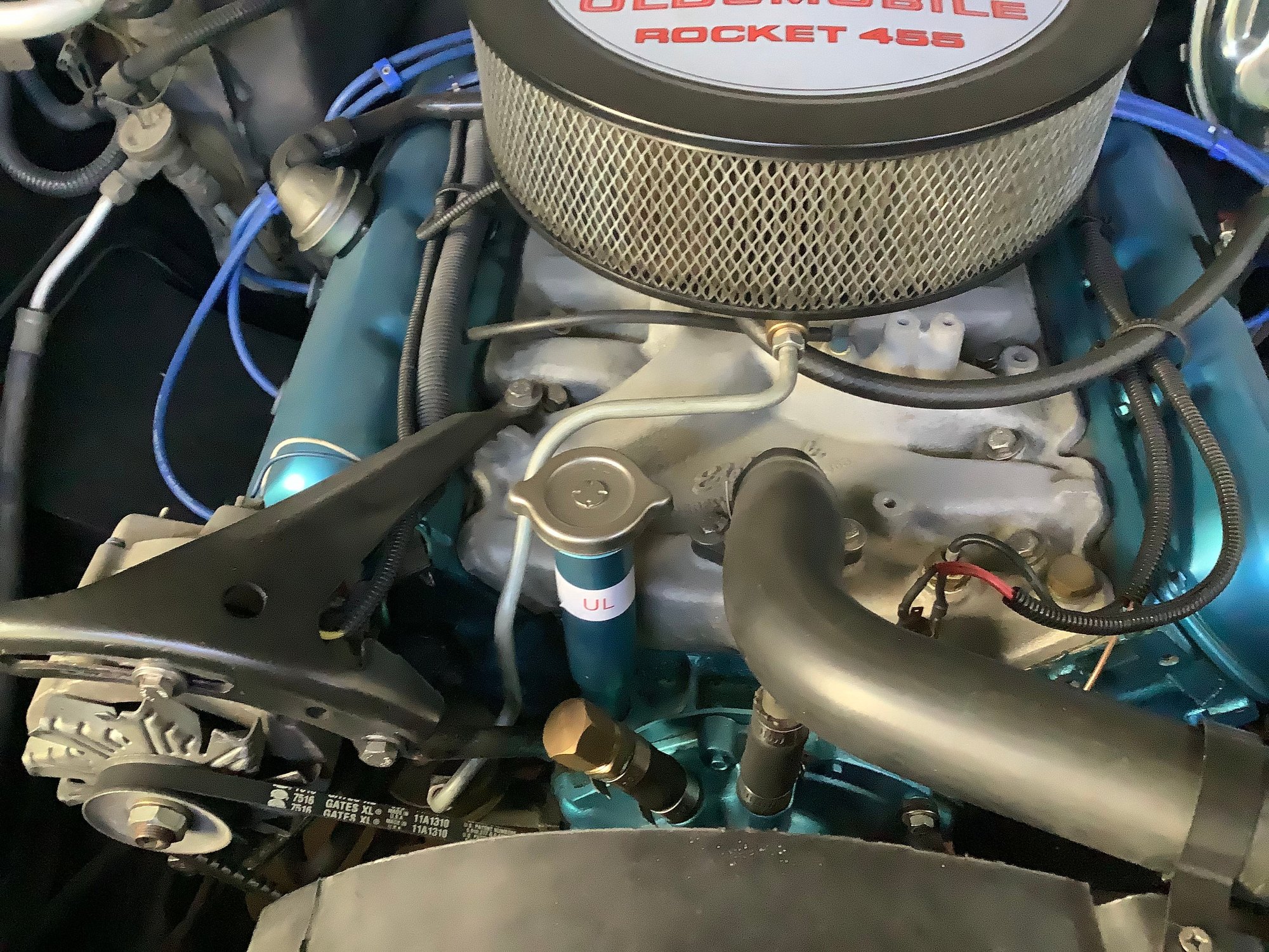

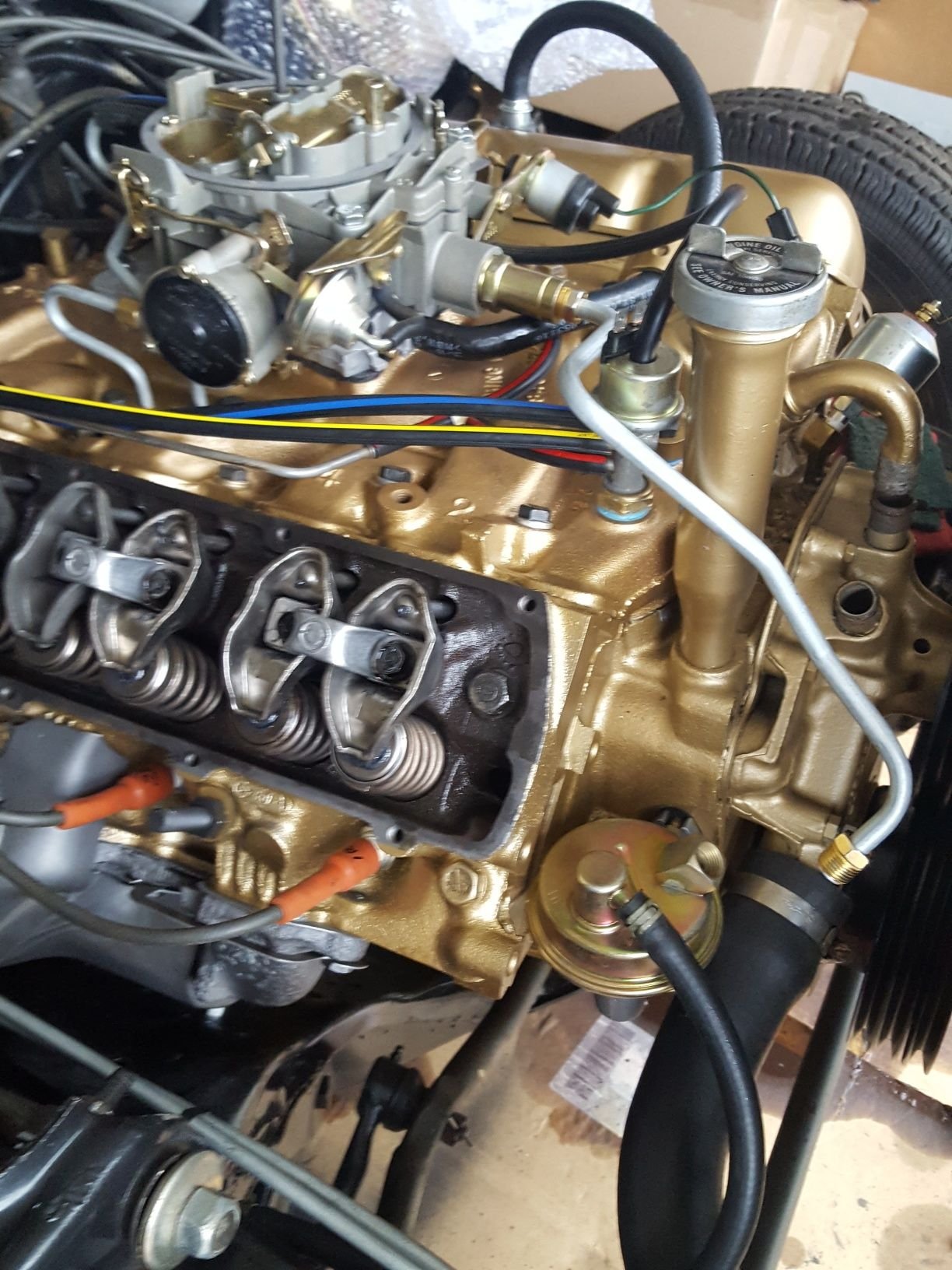

i got mine from inline as well, it was very close but i also have a performer intake i was able to easily get it to line up YMMV
i just looked i dont have a pic of mine handy If i remember ill snap a pic tomorrow.

As described in post 4, the line you bought is designed for a different pump.
If you can't make the line you have fit (personally, I think you can twist the end at the pump and increase the angle at the oil fill tube), your choices are to buy the correct pump for the line or buy/ make the correct line for your current pump. The problem with buying a line is that you may well end up with what you currently have. It is not hard to make your own line as described in post #5. I agree with you that I don't like rubber from the pump to the carb as I personally know a few guys whose cars burnt to the ground from a rubber fuel line failing (granted they were running rubber the whole way from the pump to the carb but still). That said, in 71 the W30 line set had steel lines connected to an inline filter with short sections of rubber.

Thanks I’ll call supercars and see where they source theirs. Pretty sure sure my pump is correct 40704. Has the proper adapter at 45 degrees shown in the csm

Yeah mine looks like the others too and the line fits well. Do they list other PNs?
if you have a place nearby that can bend one up maybe make a good template w a wire coat hangar and bring it to thrm to bend up?

From your photo the part sent looks like its closer to yours than mine. Note how your pump outlet comes straight out, mine is facing the pulleys.
They do have different numbers for the 455 like yours compared to the 350 4 bbl. Enough folks have had issues that something is messed up.

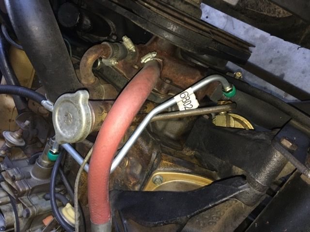

I bought my fuel line from Inline Tube also , as you can see in the above picture It did not fit
I just re-bent it as carefully as I could to prevent kinking it and it fit fine just be patient and take your time and you can make it fit.
As long as you have the proper parts you will be fine
Good Luck

Sorry I just looked at your picture again and noticed that your Pump fitting is at a different angle
you will probably need to get a different pump to work with that line, will still need to adjust it though.

Greybeards outlet appears to match the 350 configuration shown inhis manual. The outlet connect is at the 10 o clock position and the pump outlet is 45* from parallel to the engine.
the rest of ours shows the pump outlet parallel to the engine but the outlet connect points 45* away from the block
I dont think thats the best terminology but its obvious now how its different.
i think theres a fuel pump sticky somewhere, might be easier to replace the pump now w one that has a more common outlet, if it fails down the road youll be revisiting a mismatched fuel line again i suspect.

The difference in the angle of the fitting on the fuel pump is a year thing. I think 68/69 are like greybeards and the other one shown is 70+. My 68 455 has the pump like greybeard shows and the fuel line I purchased from inline for a 68/69 455 fit perfect. I did connect it to the carb first then I bolted the carb to the manifold.
