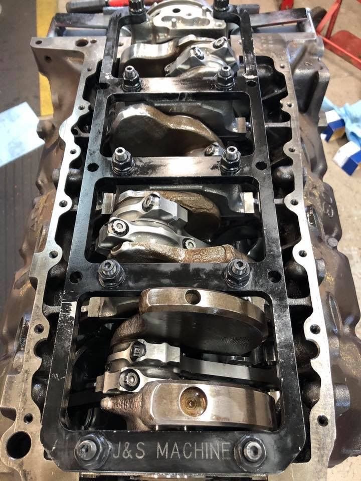

4.380 Bore Custom Racetec piston, 1.5mm ring pack, 6cc valve reliefs. 9.5:1
Eagle LS 6.125 I beam rod
330 crank, ground to SBC Lg journal size, 3.400 stroke, internally balanced
5 main halo
C heads, 2.07/1.68 valves, just a cleanup and filled crossovers and welded dividers
Lunati Hyd roller 227/232@.050, .565/.565 lift 110lsa
RPM intake, center divider cut 1", opened ports to more closely match heads.
Holley Terminator TBI, 950cfm
Holley Dual sync
497hp/513tq.
Dyno sheet won't attach for some reason.

Hello,
Mark built this motor to go in my ‘79 TA. I do plan to retain the shaker and once the motor is in the car, I will be able to determine which drop base to go with. Right now I am looking at either Blocker or PTFB. This is just a street car and Mark spec’ed it with that in mind. I have a 2004r built by Dan that will be behind it along with 3.42 gears.
Trey

Hello,
This is the motor that Mark put together for my ‘79 TA. Once it is in the car, I will be able to measure and figure out which way to go so that I can retain the shaker. Blocker and PTFB look like the top contenders for the drop base. This motor will be backed by a 2004r built by Dan ( Dr Dan) with 3.42 gears out back. (Second time trying to post with the pics)
Trey

And as far as output goes, I always like to double check my work. This had a Holley EFI on it which is a lbs/hr based system (not the best but it is what it is). The measured hp was about 462, (corrected was 497) and it showed 238# of fuel per hour in the Holley software. Based on a bsfc of about .52 that works out to be pretty damn close so I’m good with these numbers.
