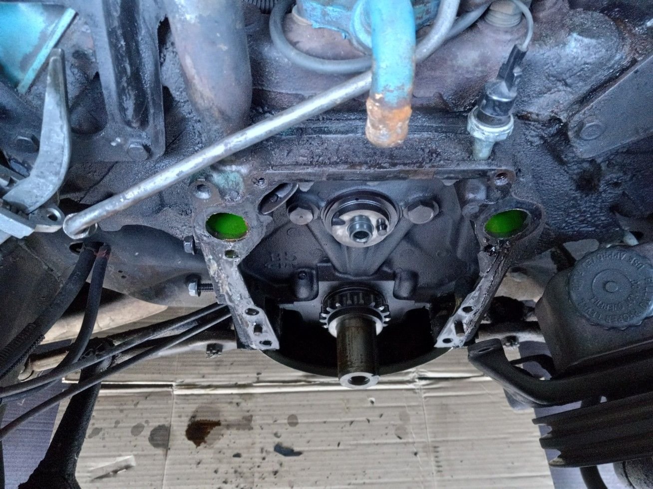

Ity has been awhile since I have posted anything. I still have the 1978 Royale and has 93k miles. About two years ago I started it in the storage facility and it died quickly. It wouldnt start and the starter had the freewheeing sound. I knew what it was. It jumped time. I finally got around to working on it a few months ago. I have it apart, and the new chain installed with both cap and #1 cyl at tdc. I havent replaced the front cover yet since I wanted to get a mobile oil change company to come out with an extractor and stick the tube through the front cover first and suck out the oil and any debris. Then remove the pan bolt to drain the rest. So far its gone well and have been careful. It is hard to find anyone around Charlottesville to help. I called an oil place and he made excuses twice. It is like no one wants to work anymore.
in place
in place
Old May 25, 2026 | 08:29 PM
Sugar Bear's Avatar
Posts: 4,109
Purchasing your own extractor would probably cost less than having someone come out but, in my opinion neither will help much. Sure cleaning the pan is good but the problem is that many of the nylon teeth that broke off are stuck in the oil pump intake screen. No suction extractor will get them out. The only way I know of to clean the intake screen properly is to remove the oil pan.
Don't want to be the bad news guy but this is the case.
