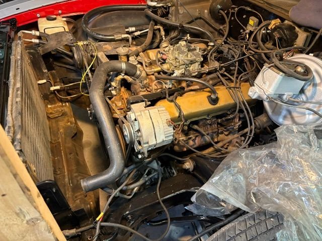

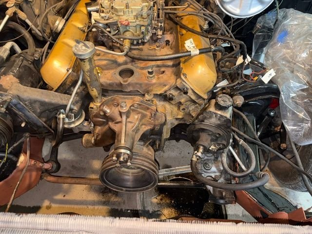

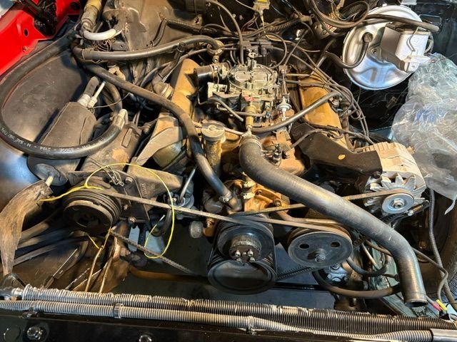

Old fella here, so not a lot of desire to pull the engine and do a rebuild of a 72 Cutlass 350 with 70,000 miles on the clock. I have been working car Sheetmetal and have both quarter panels installed, right door and fender reworked and in epoxy primer. Left fender also currently off the car, patch panel welded in and fender in epoxy primer. Day after day I walked by the old faded black metal under the hood and decided to remove it and paint it. In process, found a radiator leaking that is currently being re-cored. So the engine is a whole bunch easier to get to with bumper and left fender off the car, and radiator and fan shroud also off the car. With fender off car, I can step between the frame rail and wheel and work the engine standing up, rather than stooped over. Had back surgery 8 months ago and don’t care to revisit that. So….I decided to paint what I can get to on the top parts of the engine. Already had some parts painted with single stage catalyzed black urethane. They look nice and should wear well. Now in process of removing AC brackets, Alternator brackets, currently stalled on the Power steering pump bracket. I think it wise to pull water pump and change timing gears and chain. Maybe also the intake manifold, as it looks like maybe it was leaking oil too? I think the valve covers are an easy target to remove and replace gaskets. So I should do it while relatively easier.
Any comments on what else to do will also be appreciated. Any comments on valve cover gaskets, timing chain set, that type of thing much appreciated. Last time I was this deep into an engine was in 1972 when I put a solid lifter camshaft into a SS396 Camaro.

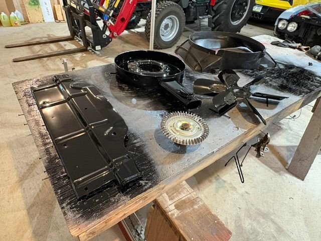

Already have some of the parts painted with urethane single stage

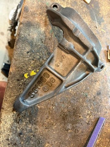

Bracket removal in process
Pulling the carb will open up the intake manifold a bunch.

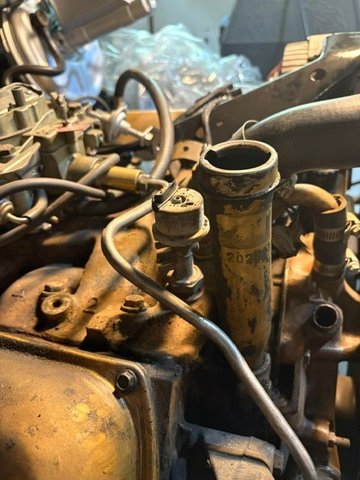

I checked some videos on how to remove the oil fill tube, but I think I can work around it with it in place
I will blast all accessory brackets and paint black, off the car
I checked AC pressure and there is no refrigerant left in system, so I will remove AC to where I can get to right valve cover for removal

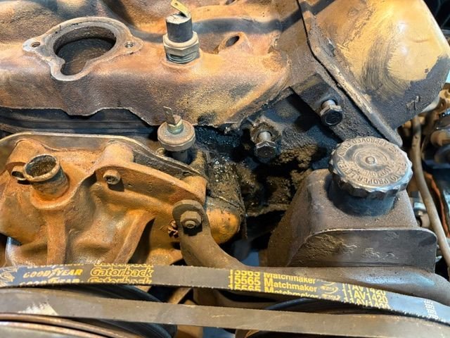

I am not sure if the oil seep behind the steering pump is an intake manifold gasket failure or not?  But if it is, now is the time to remove intake and fix it, as much as I hate the thought of doing it.

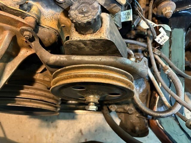

Currently stuck at the steering pump pulley.  I will likely leave the pump in place and paint it in place to avoid draining down the pump oil.  I may be overthinking this.

X2 on the compression test. Check the timing chain condition unless you know it has been replaced, the cam gear can be viewed through the fuel pump hole in the block. If the cam gear still has nylon teeth consider replacing the timing set.
I'd also leave the oil fill tube in place.

Glad you see the Oil Tube the same way. I saw YouTube’s of people taking hammers and banging on the side of the tube. Had to be causing damage. I had dreamed up a purpose built tool that I think would work, but just couldn’t see the point. I can clean and paint around it.

I removed the oil fill tube on my '71 350. Easy-peasy. Insert a dowel rod or broom stick handle into the oil fill tube and simply rock the rod/stick in an off-centered circular motion - use a towel or two along w/ the rod/stick (if you like) to form a type of wedge in the oil fill tube hole if you like. The oil fill tube is nothing more than wedged into the hole.

just fyi, I have used aluminum foil in the past to 'wrap' items I didn't want painted or overspray on such as hoses, wiring, etc.
THAT is a really good idea. Way better than trying to mask tape and pull it all back off. Perhaps small amounts of tape here and there just to secure the foil?

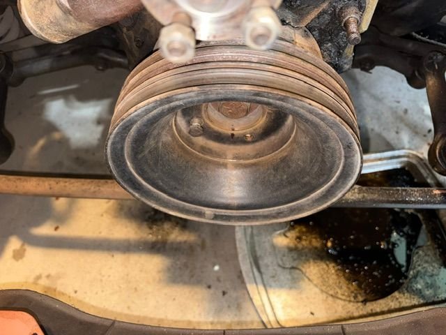

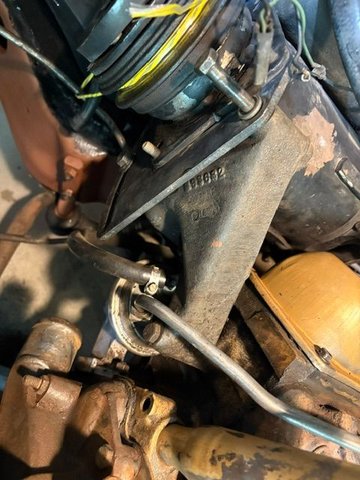

Today I got the power steering pump and res separated from the bracket, actually two of them. Just have the AC lower bracket to remove. I did try to remove the crank pulley, the one with the three belts. Thought it would be easy, as there were 4 small cap screws that came out easily. But there must be something I am missing, as banging it with a hammer and trying a screwdriver between the pulley and harmonic balancer didn’t move it.
Getting closer.  Just the AC lower bracket and that is the last one, I think?
Getting closer. Just the AC lower bracket and that is the last one, I think? I was going to clean and paint the power steering pump in place, but think I will be time and surely quality ahead to suck the oil out, disconnect hoses, and clean and paint on the bench.
This puzzles me.  I took out all 4 cap screws and thought the pulley would separate easily.  It has not
