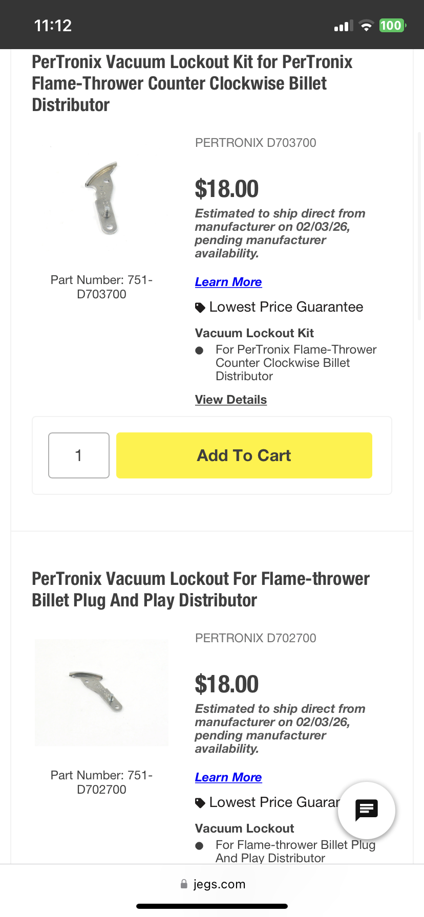

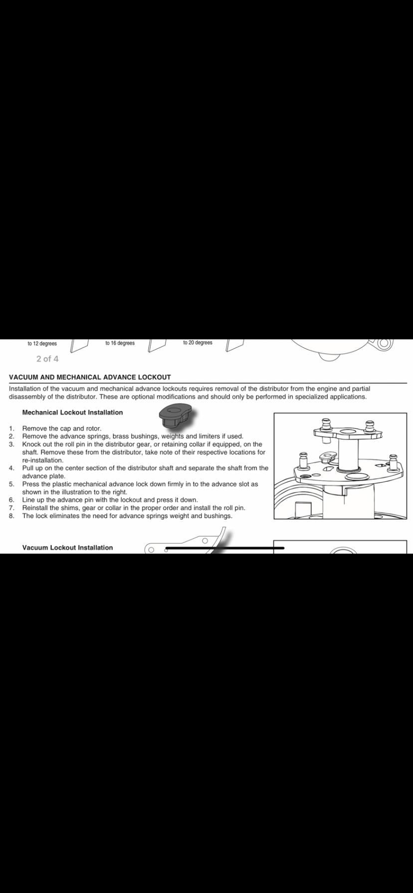

I did a motor for a guy who had a pertronix dizzy and a carb set up. He went FITech and locked out his original pertronix no problem. They have a vac advance lockout plate and a plug for the mechanical advance lockout. The billet flame-thrower dizzys come with the mechanical lockout plug. He had to buy the vac advance lockout plate
been running for years now.
