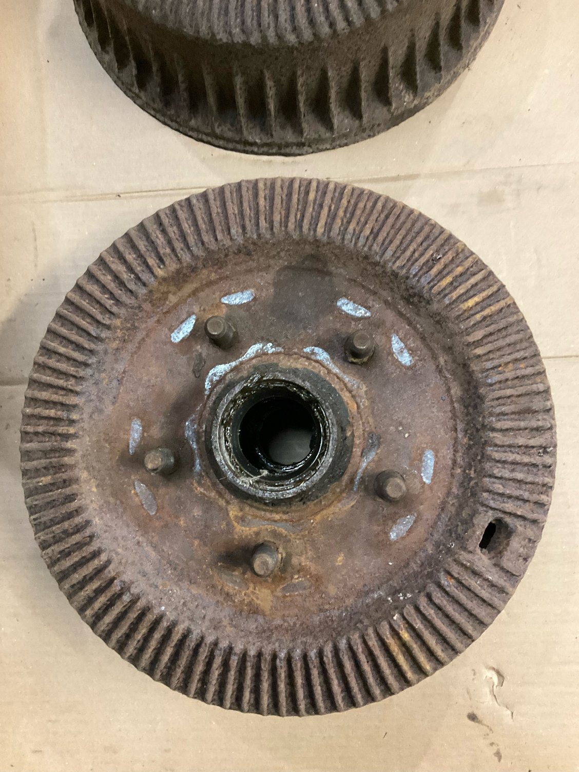

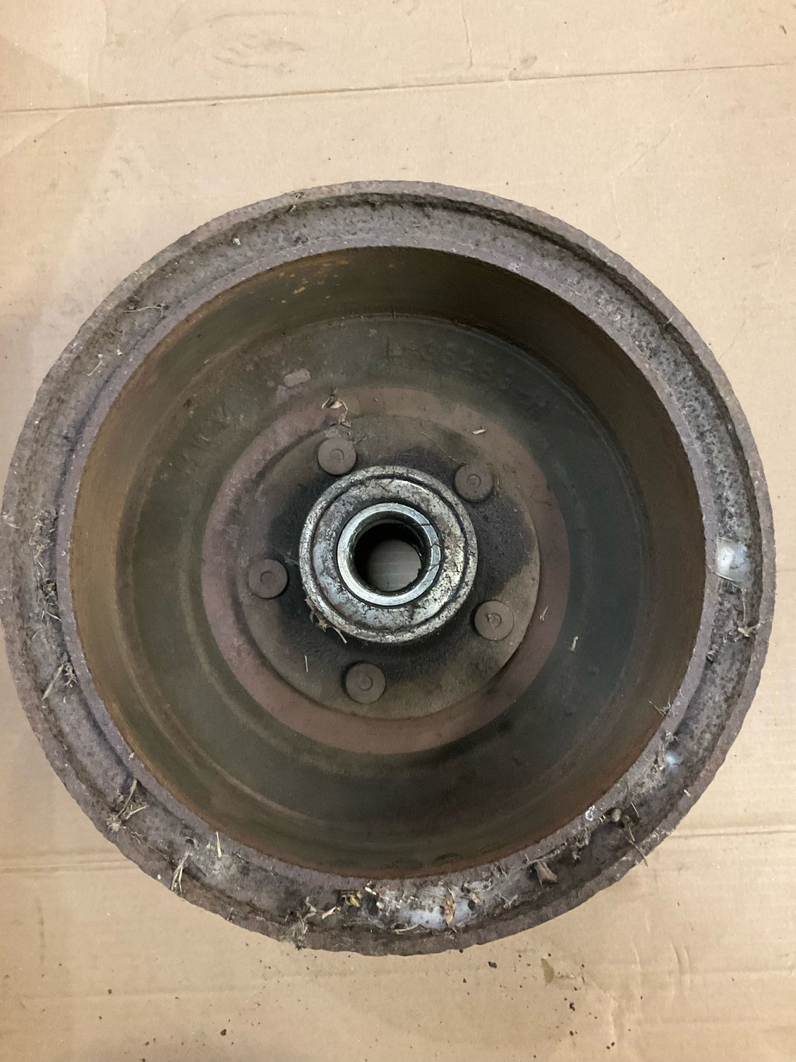

Old Jan 31, 2024 | 05:21 AM
Minibike Mark's Avatar
Joined: Apr 2022
Posts: 119
From: Central WI
I was able to pull the drums last night:
