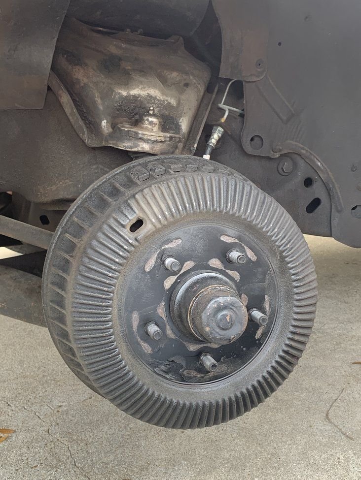

And that was my next question. I wasn't sure if it used the 4.75 lug pattern. I'm definitely going to go with the ones from Kanter granted they fit. Below is a few pics of my drums just to verify
Passenger
Driver with speedo cable thing
