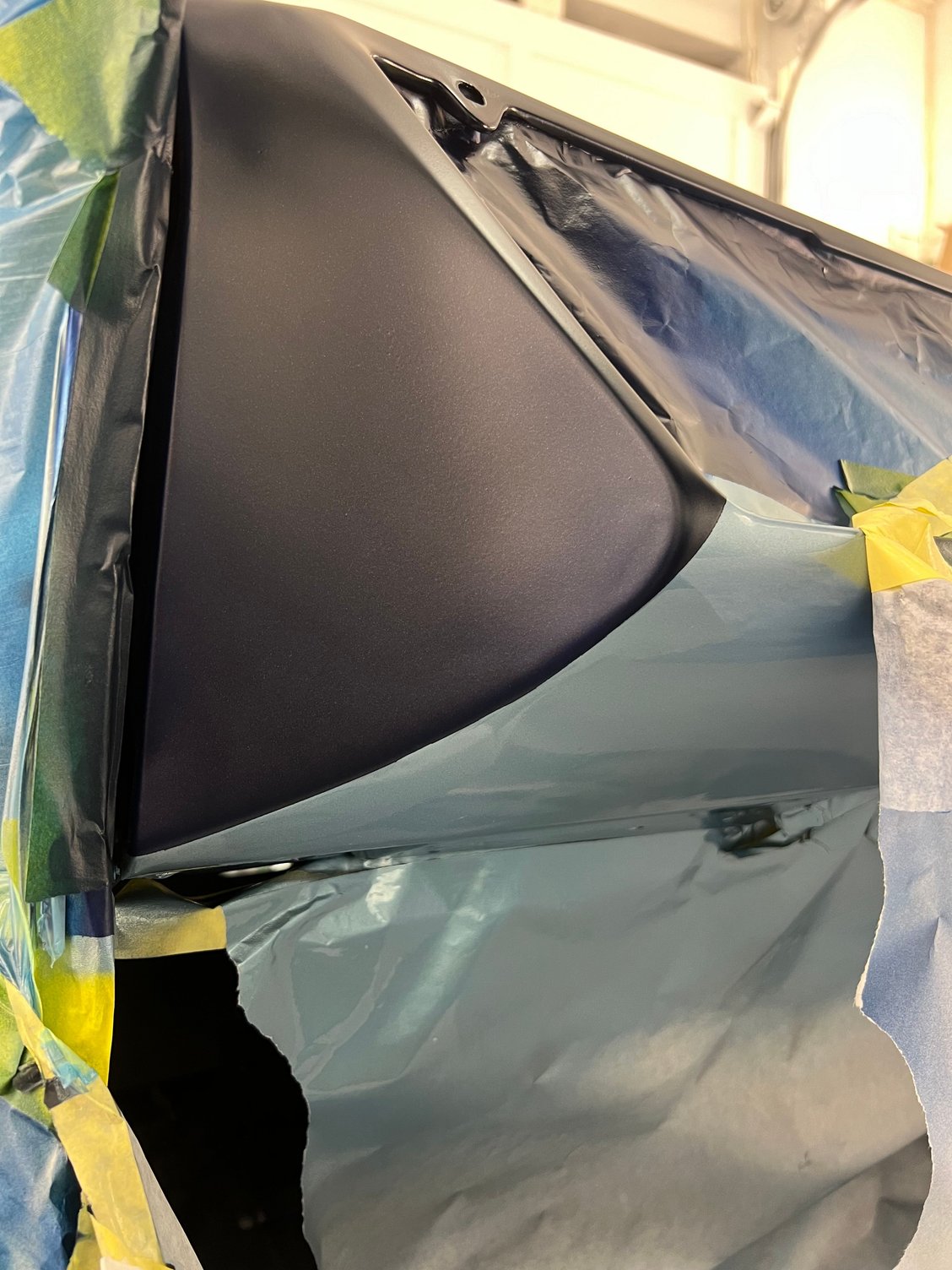

This is what I gave my painter and he was able to get to a good place (I think).
Too much sheen? Not sure... looks good to me.
That looks really nice. Thanks for posting the info and the pics.

This is what we ended up with. I think it looks good.

Yes sir. Nice!

Looks great! Congrats.
