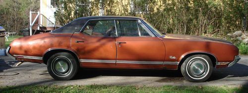

BTW, you know how hard it is to find a picture of a 71 CS that isn't wearing the full length SX style side moldings??? Those moldings are 'sort of special' I guess. What's really annoying about them is they require the wheel opening moldings to be precisely matched to the height of the body moldings. There's a surprising lack of those opening moldings on the market, not repopped either which is strange considering the side ones are. Most often, people buy the aftermarket opening moldings (at $$$$) and then have to cut them to match the SX style body moldings. If you've ever had to remove or install those SX style moldings you'll learn some interesting vocabulary along the way about the ancestry of the person who designed them. Only thing in their defense however is the car had them installed before the glass went in the doors and quarters. Likely the moldings were also installed prior to the fenders being assembled as the front clip of the car on the final assembly line too.
The wide, die cast moldings were standard equipment on every Cutlass Supreme built in the 1971 model year, not just the SX. Even the Supreme Holiday Sedan got them, and obviously that was never an SX. Any car without them has had them removed by the owner.
I'm not sure what you are referring to. Do you mean the standard 1970-1971 Cutlass Supreme side moldings? If so, you can't find a picture of a Supreme without them because, well, they were standard equipment. Those are also on the SX because it is a Supreme body style.
Duly noted. I should have looked at the standard features on the 71 SPECS before making my statement. It WOULD however explain why it's so hard to find a picture of a 71 CS with narrow body moldings.

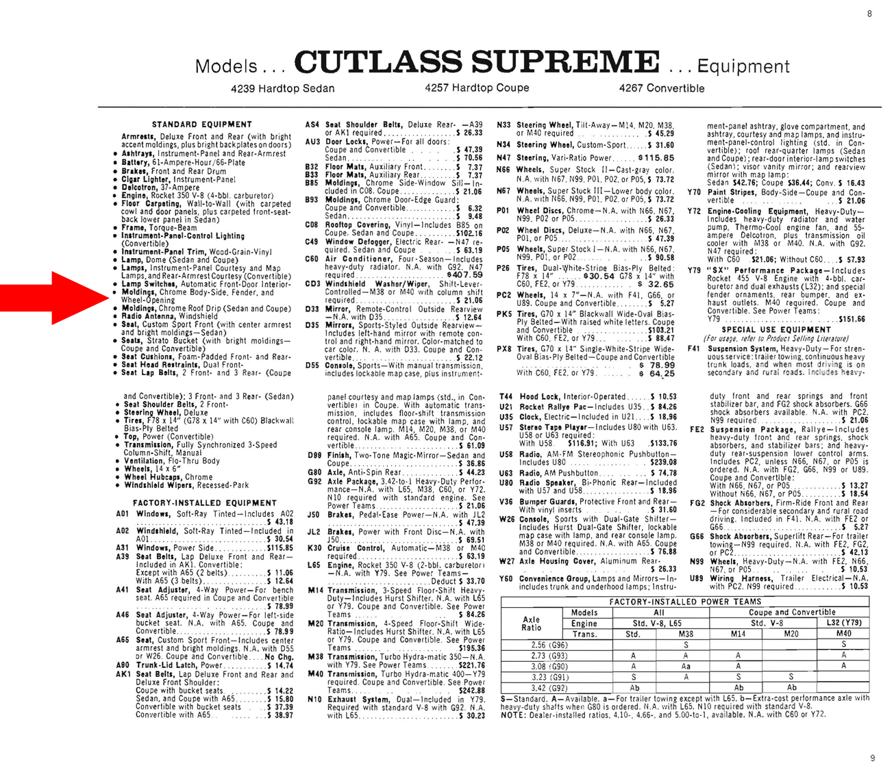

Here's the deal. When I purchased my 1971 CS I was (and still remain) interested in identifying OEM STANDARD & RPO features on my vehicle. So, I spent a considerable amount of time reviewing several sources of information - including CO. Since I previously had owned both a 1967 4-4-2 and a 1972 4-4-2 I had gained some previous knowledge of the history of the 4-4-2 and some of the OEM STANDARD & RPO features. When I purchased my 1971 CS I began reviewing some of the STANDARD & RPO features.
When I addressed the OP question (Post #1), I was keen to notice striping because I had previously reviewed some of the STANDARD & RPO striping on my own vehicle.
Would anyone care to explain why in the 1972 DEALER SPECS the RPO Y73 is listed, yet is NOT identified as an available RPO? I would suggest this is a FUBAR when the 1972 DEALER SPECS was written. Comments?
I believe the RPO Y73 has changed over the history of the Oldsmobile - as it is identified differently in various years of DEALER SPECS.
1972_Oldsmobile_Dealer_SPECS-05
[/Q
The Y73 is not listed as a stand alone RPO because it's part of the 1972 W29 (lesser 442 than the coveted W30) package. It refers specifically to the special hood decal that was used. You'll note that in the following picture, not only does the hood have piercing and Oldsmobile script above the headlight (due to the placement of 442 numerals on the grill), the hood has the Y73 reveal decal. You're correct to note that the Y73 changed from 1971 where it was run down the middle of the hood. So no, Olds didn't have any FUBAR or SNAFU of any kind with the Y73 because it was mandatory included cosmetic equipment on the W29 RPO. This isn't unique - GM has done this with other brands and models.
As far as the Y73 RPO in 1971, it was only offered on the Cutlass and Cutlass S as a stand alone option, BUT the 1971 442 included the Y73 in the standard equipment section detailing Hood, body and trunk paint stripes without actually saying that in the standard equipment section of the 442 model. 1971 - Different model year, different model offerings, different marketing strategy. Nothing FUBAR about it, IMO you're overthinking this. THAT is why you don't see it listed on the 1971 SPECS for CS, but will see the aforementioned included paint stripes as part of the 442 offering that year.
Does that answer your question?

The real reason for the limits on availability of RPO Y73 in 1972 was the fact that those hood stripes were contoured to fit around the chrome hood louvers. Note the red car in the four car ad above. The base hood on the Cutlass and Supreme models that year was the hood without louvers. As a result, the Y73 stripe would have looked silly on that hood. The Cutlass S did come with the louvers as standard equipment and thus RPO Y73 was offered as a stand-alone option. Here's the applicable page from the inspector's guide. Note the availability on the Cutlass hardtop and Supreme convertible models is caveated by a footnote that says only on 3287 or 4267 with W29. This is because the "louvered" hood was installed on those models only when you got W29. The Cutlass Hardtop had an additional option availability of Y75, which included the "louvered" hood on the 3287 model, and if Y75 was selected, then the Y73 paint stripe could be added since it worked with that hood. Also, obviously, you couldn't get the stripe with W25 hoods either.
Understand that RPO codes existed for every option that would possibly have to be dealt with on the assembly line. Not every RPO code could be ordered by a customer as a stand alone option. As an example, there were RPO codes for each individual suspension spring. These codes would show up on the build sheet if you could find it.
