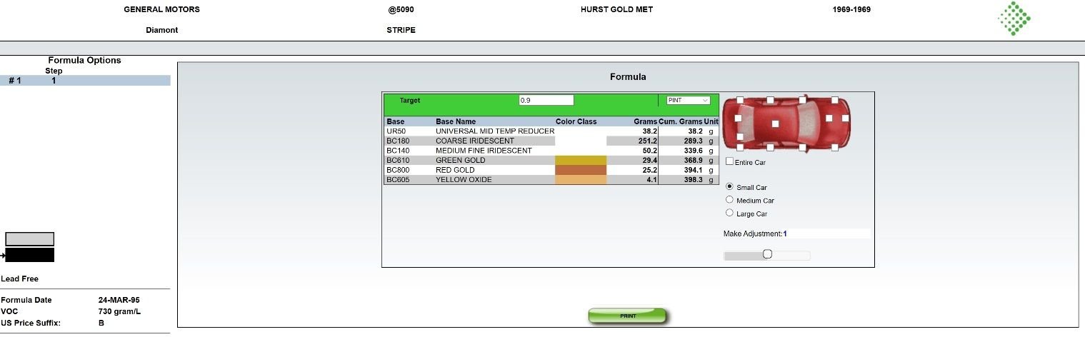

Well for anybody else going through this dead end, this is what I decided.
When I started with this car from the ground up.
Took the wheels that were painted white over 3 colors all chipping and had them spun for tru, then blasted primed, painted and clear coated.
Got a buddy with a 70 CS in the gold and after lots of reasearch and dead ends decided to use this color as close to Firefrost as I could get it as a base coat.
Below is the formula for that along with the current faded hood stripe and finished wheel.
It seems to make sense to use that color for the stripes at this point where a perfect match isn't possible.

I’m building a 69 h/o convertible clone , I appreciate your efforts , I’m assuming you checked out the formula posted by ctos flying in his thread? It’s amazing how many hoops you need to jump through for a little gold paint lol

Dupont formulation for the 69 Firefrost gold for a PINT:Cost code from DuPont: (important) F
4530S Flop Control Agent 45.4
890J Transox Yellow 86.0
894J Extra Coarse Alum 109.3
845J Transp Yellow 131.0
895J Bright Coarse Alum 149.9
802J LS White 161.1
832J Green 162.0
1005S Gold Pearl 180.7
1008S Moss Green Pearl 181.0
62320F Binder 326.3
62330F Balancer 457.5
There's also some from BASF, so depending on what brand you use...
