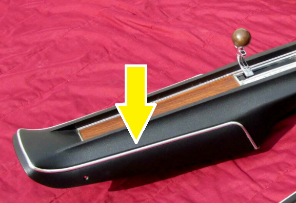

Looking to do the same on my 71. For paint prep, wondering to remove the silver trim, or just tape it off.
I'm referring to this silver piece here pointed to in yellow.

Take the molding off as long as you are gentle & careful with the tabs. If it’s not cooperating or you’re unsure, tape it.

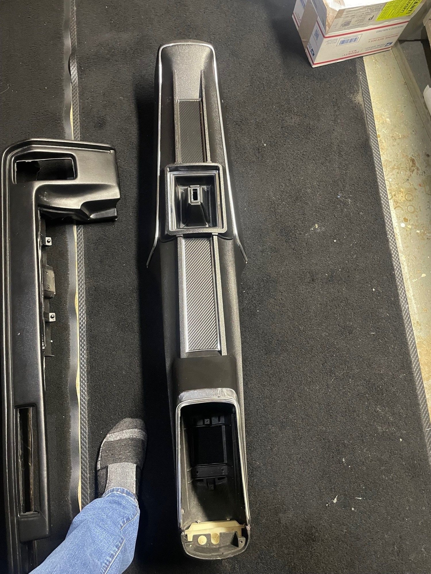

I disassembled my console down to its base shell but masked the trim in painter's tape to avoid damaging it.
