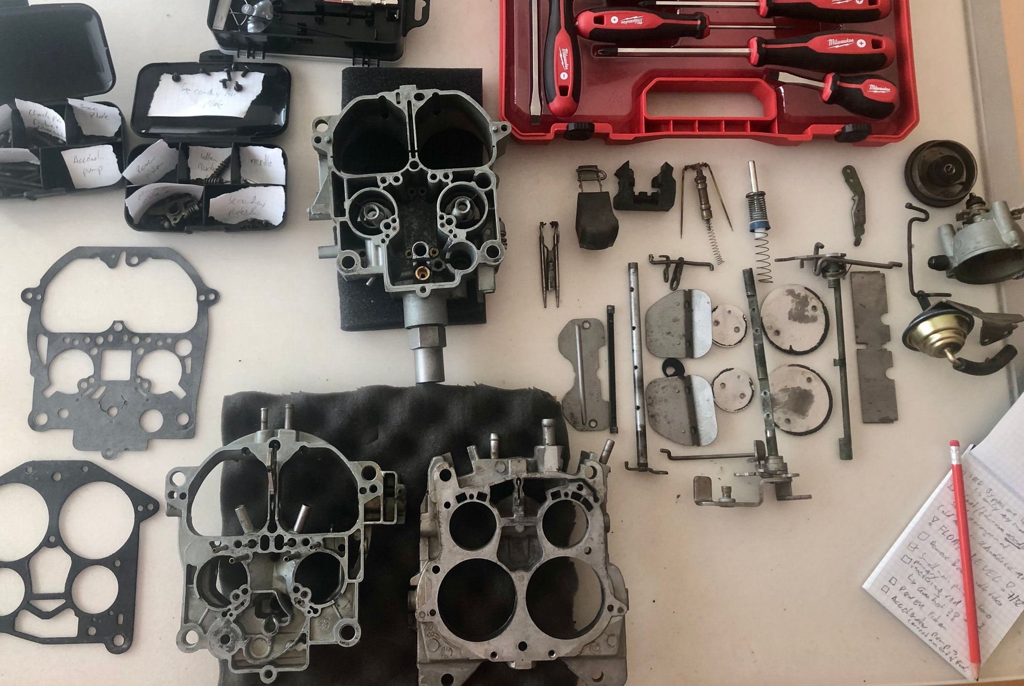

educating myself and started rebuild the Rochester Quadrajet and tune it to requirements of the ohc6 high compression 10,5:1 and cam specs

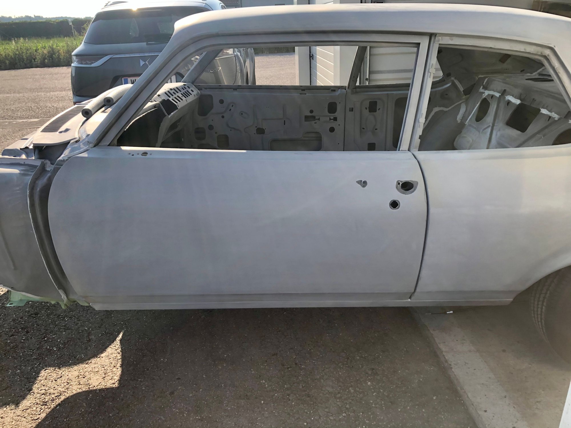

From: Mautern, Austria

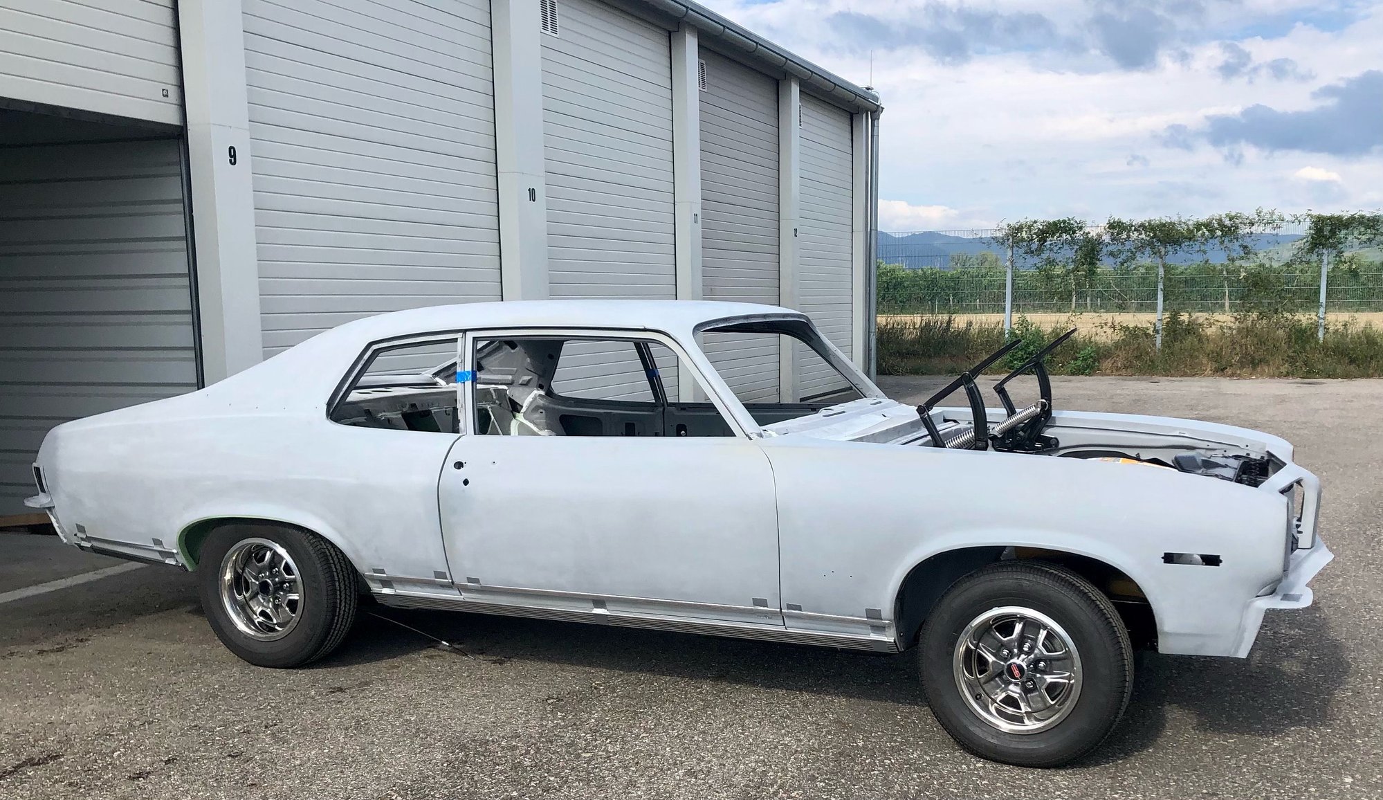

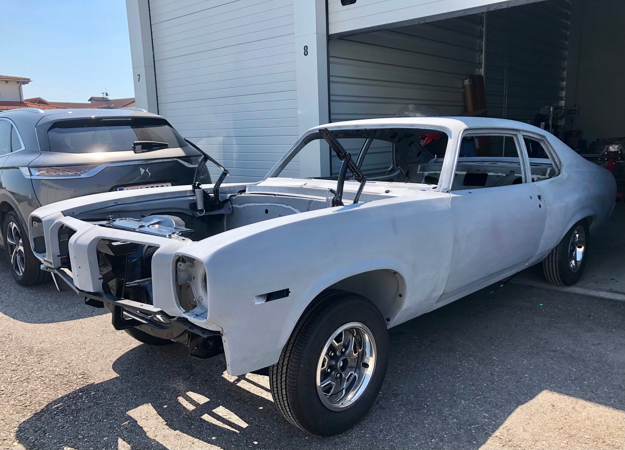

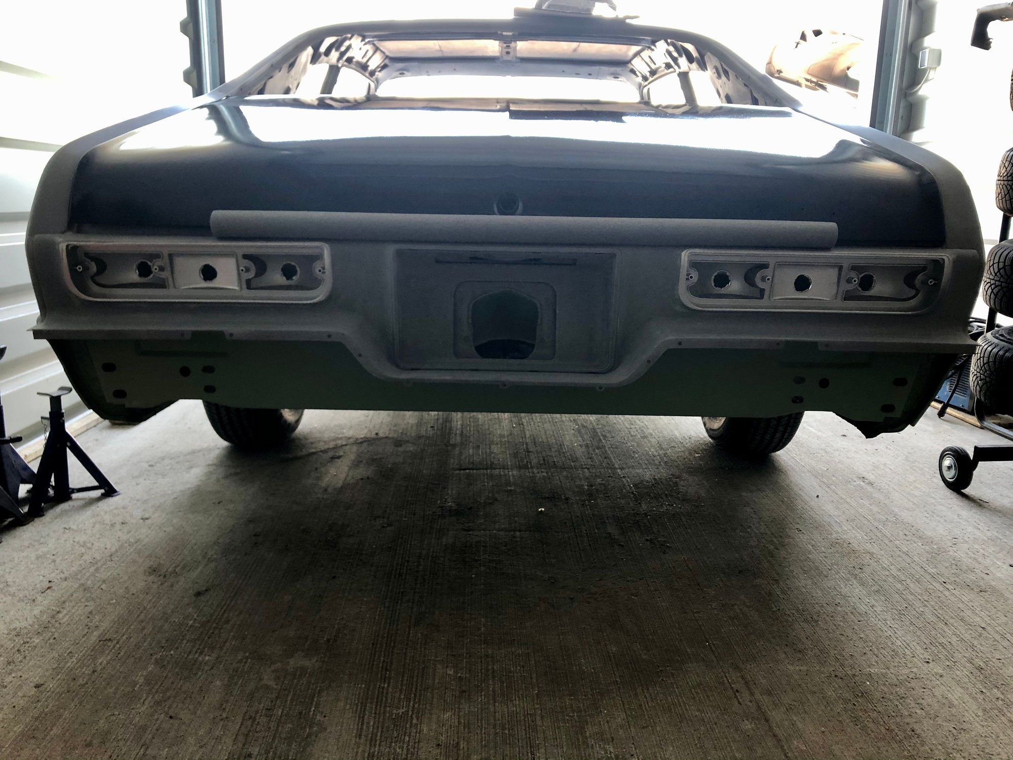

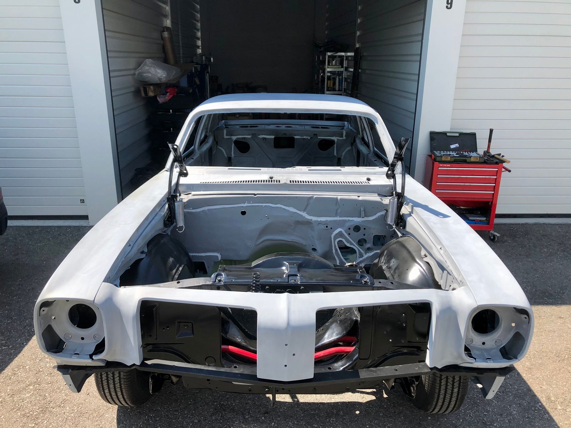

Alignment is challenging!
Old Jun 19, 2021 | 05:41 AM
  #166
olds 307 and 403's Avatar
Out of Line, Everytime😉
Posts: 10,104
From: Melville, Saskatchewan
Looking good. It is easy to forget when panels are removed, it can take many hours to get thr alignment right. Also on a frame off like this, you are probably shooting for better than factory panel gaps.

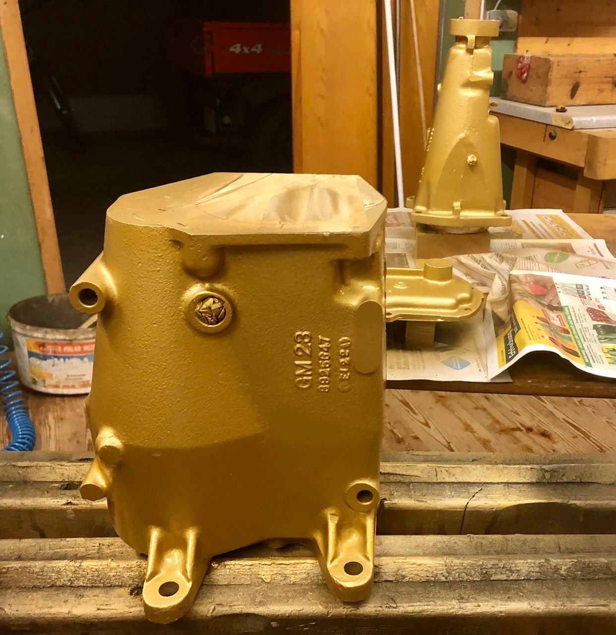

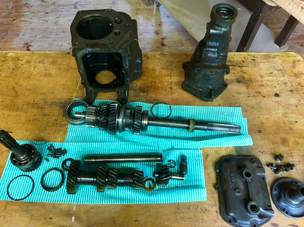

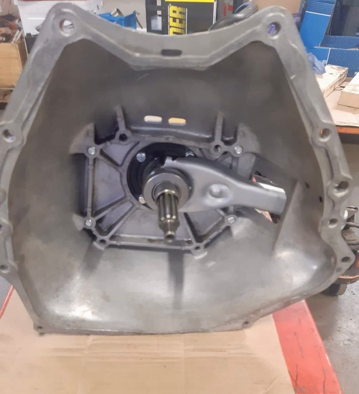

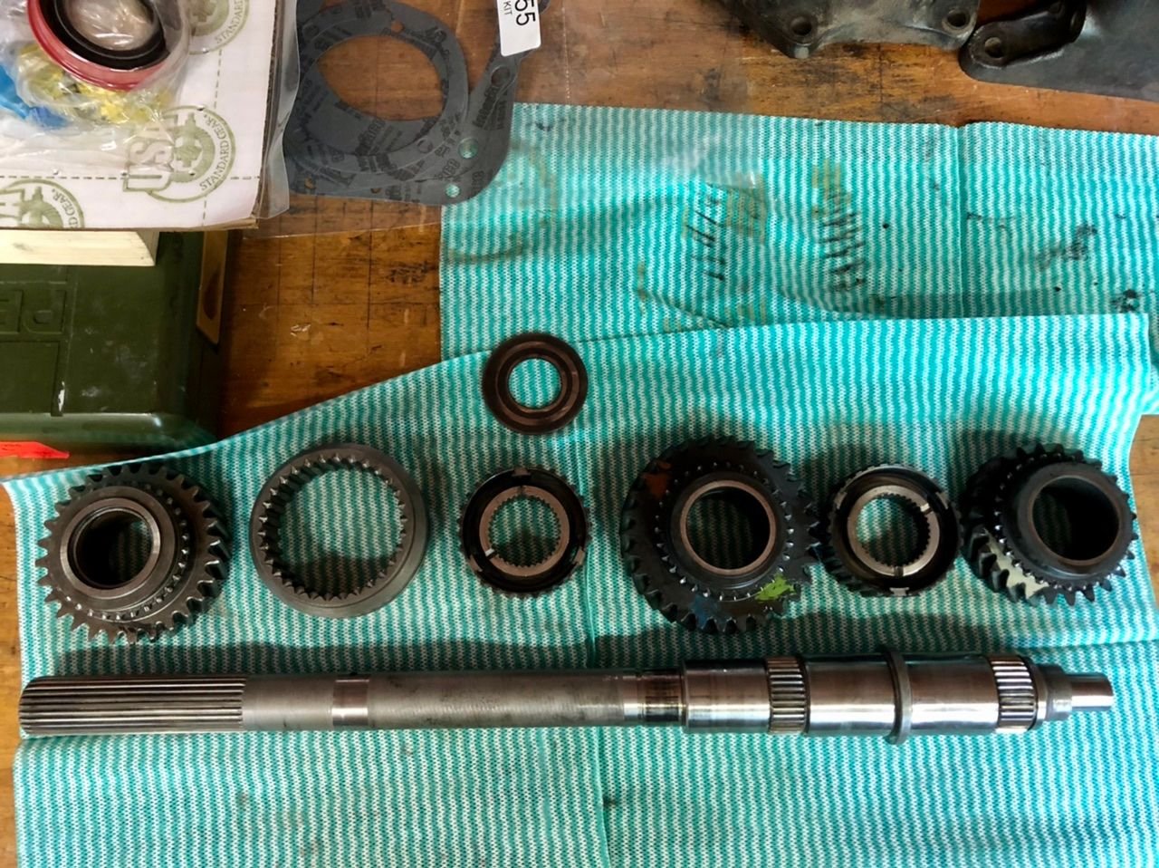

Rebuilding the 3 speed Saginaw trans and paint it to match the engine. And got it new bolts!
Old Jul 18, 2021 | 05:28 AM
  #168
Posts: 10,104
What first gear ratio is that Saginaw?
Old Jul 18, 2021 | 05:55 AM
  #169
exotec's Avatar
Olds Omega
Joined: Mar 2019
Posts: 426
the 6 cylinder version is 2.85:1

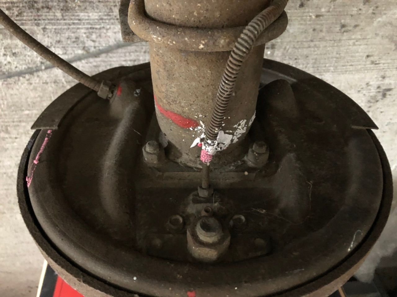

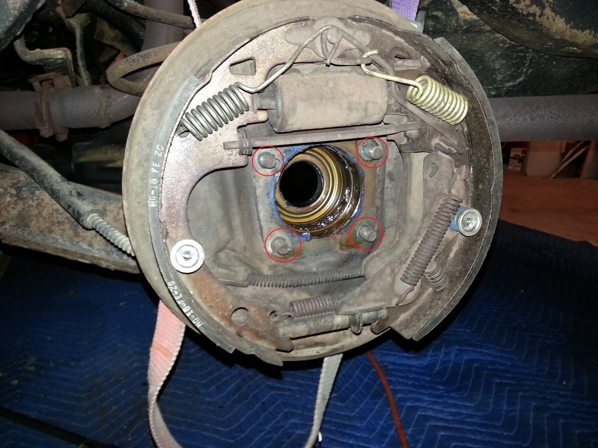

I've missed a few updates so am going back through your thread. I notice on the picture below from your May 19 update, that the brake backing plate-to-axle housing bolts appear to be in backward. I don't know about Omegas, but on A body cars they go in from the backside of the axle housing and protrude outboard through the backing plate. You may want to take another look at this. They are oriented that way so that the oval head of the bolt can bear against the axle housing, thus preventing it from turning while the nuts are loosened or tightened.
Your picture.
My passenger side during disassembly. The nuts have been removed, but the bolts are still in place.
Awesome project!

my brother was asking this as well, if I didn’t install the bolts the wrong way.
my 73 service manual doesn’t say anything about and as my dismantle pic did show it that way, we keep it as is.

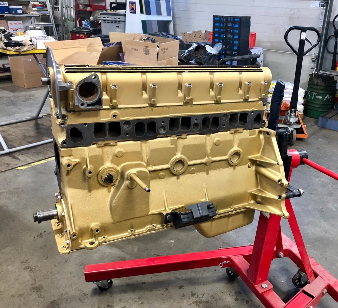

SSS - sideshotsaturday!
some progress and heading towards paint jail

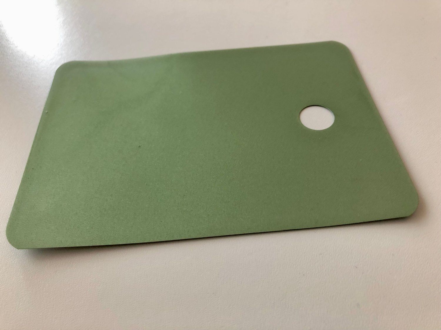

with the help of some members it looks like we found the correct color I wanted! 1970 Oldsmobile Aspen green 45 - tomorrow my mate will paint a sample.

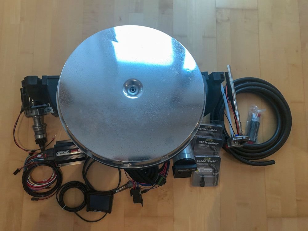

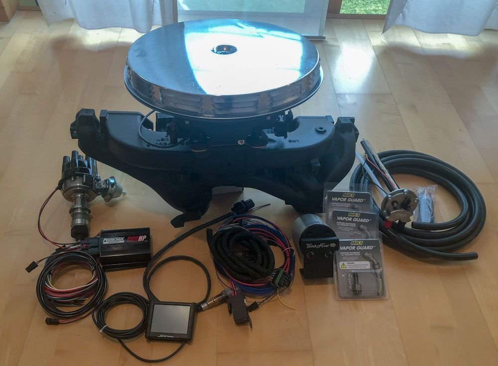

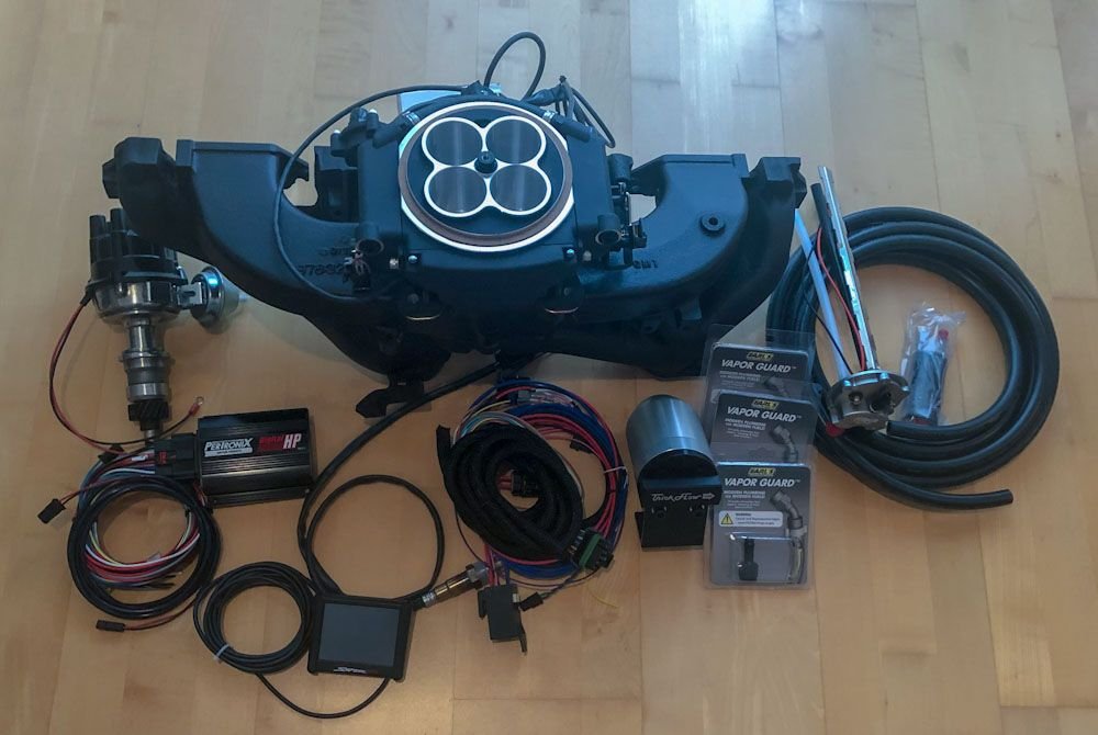

pull the trigger on EFI with Holley Sniper on the Pontiac ohc6

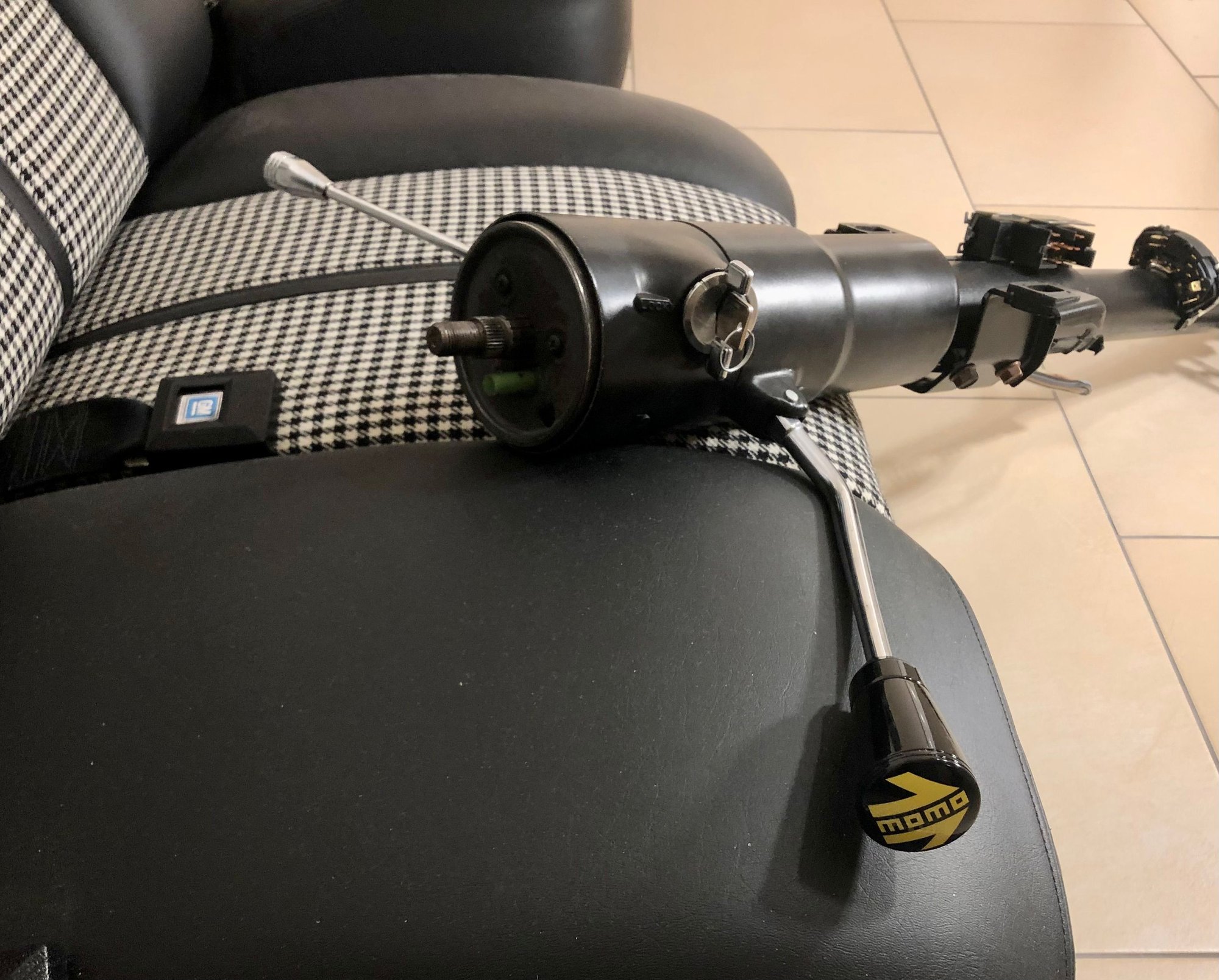

ordered the MOMO Etna wheels in 18x8.5 with 35mm offset and 6.1BS - should go with 245/40R18 Falken tries. most likely I'll need to run a 20mm adapter per side. was a Black Friday buy 3 get 1 for free. shipping to Austria will last....
But what I received already is a small color touch to the ThreeOnTheTree

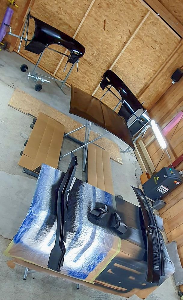

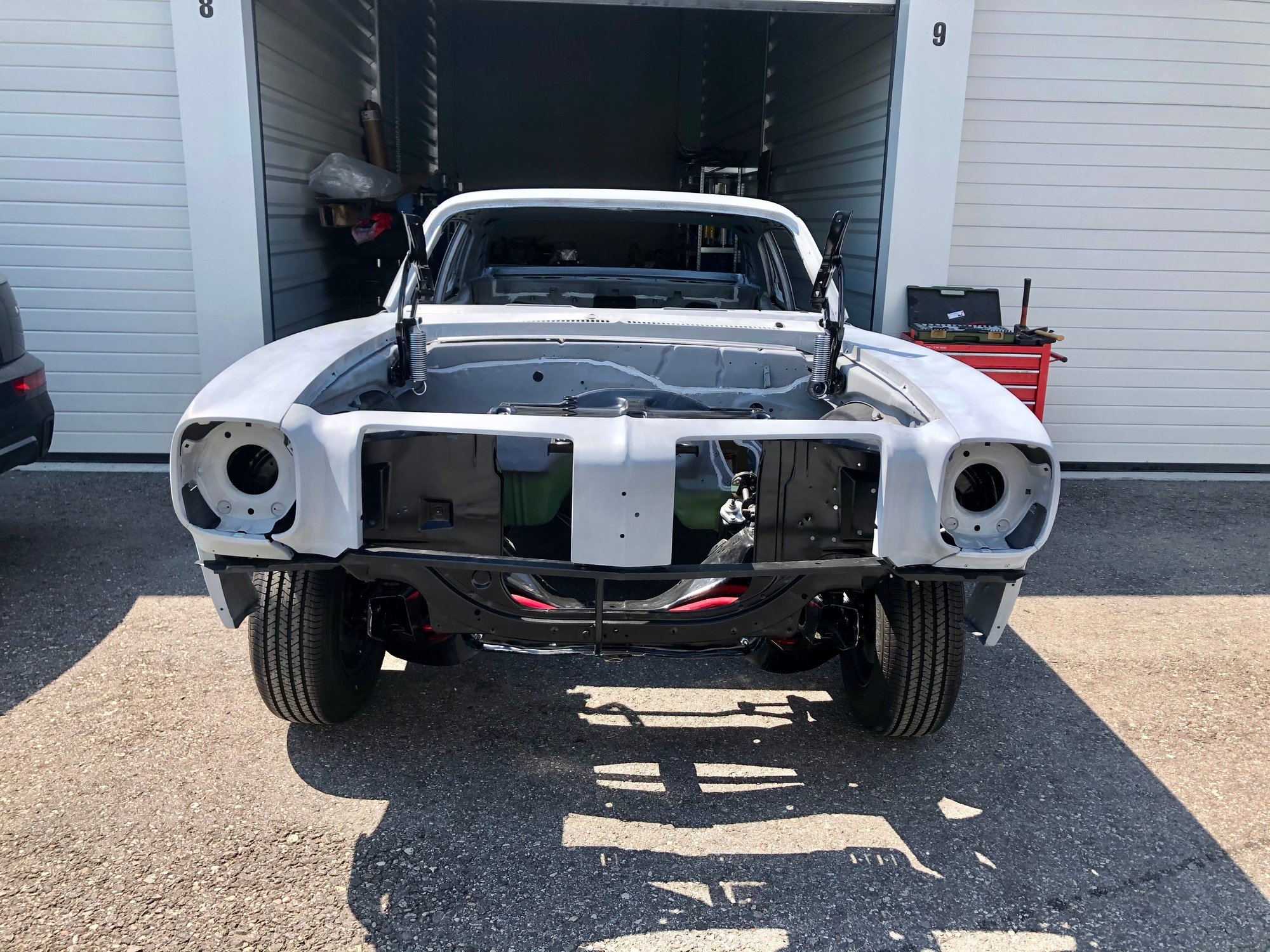

some progress in the paint jail!

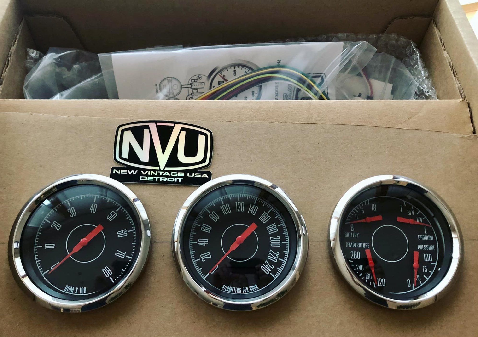

Old Dec 17, 2021 | 09:46 AM

Nice gauges.

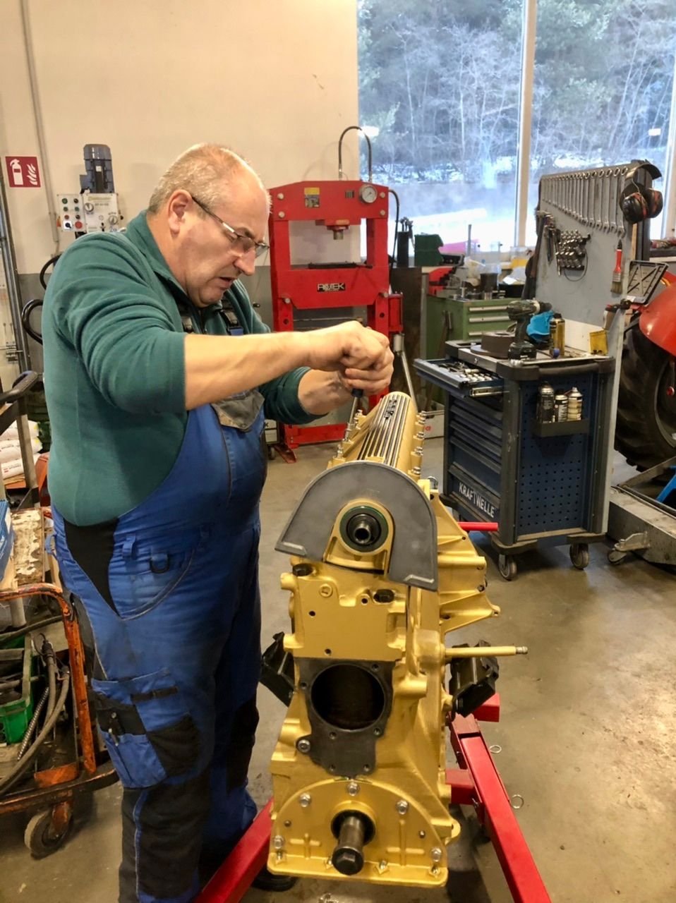

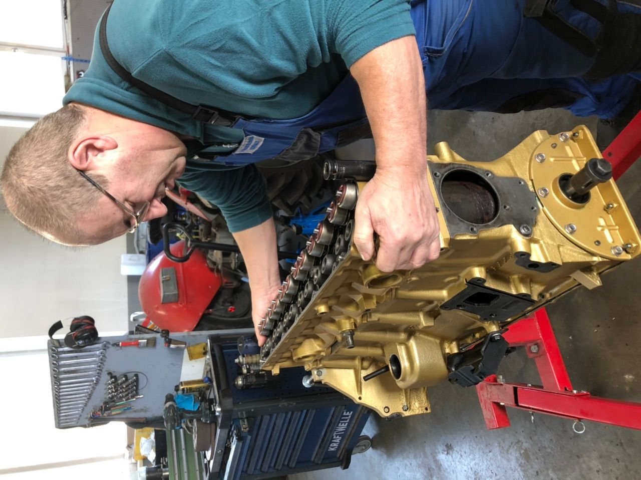

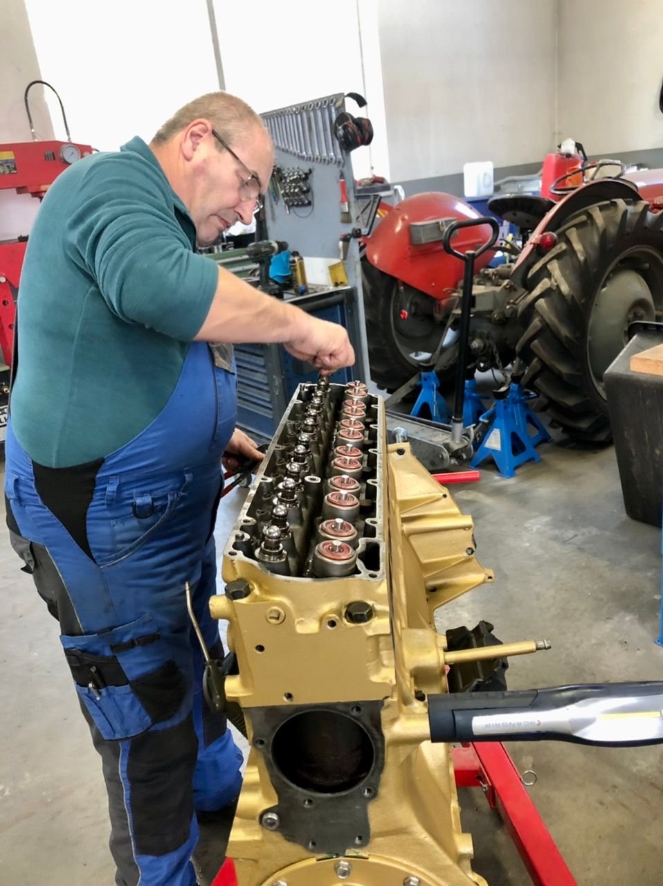

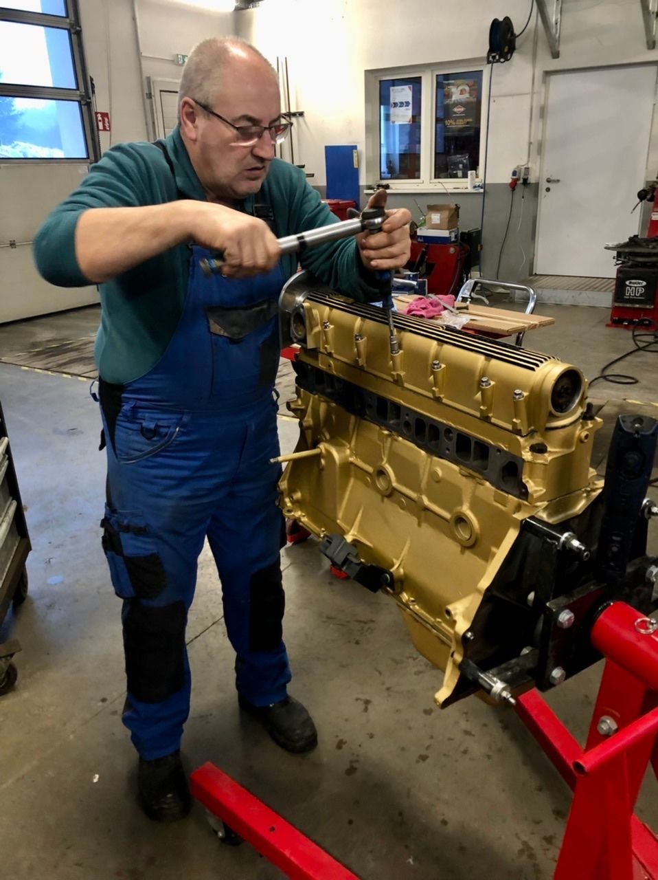

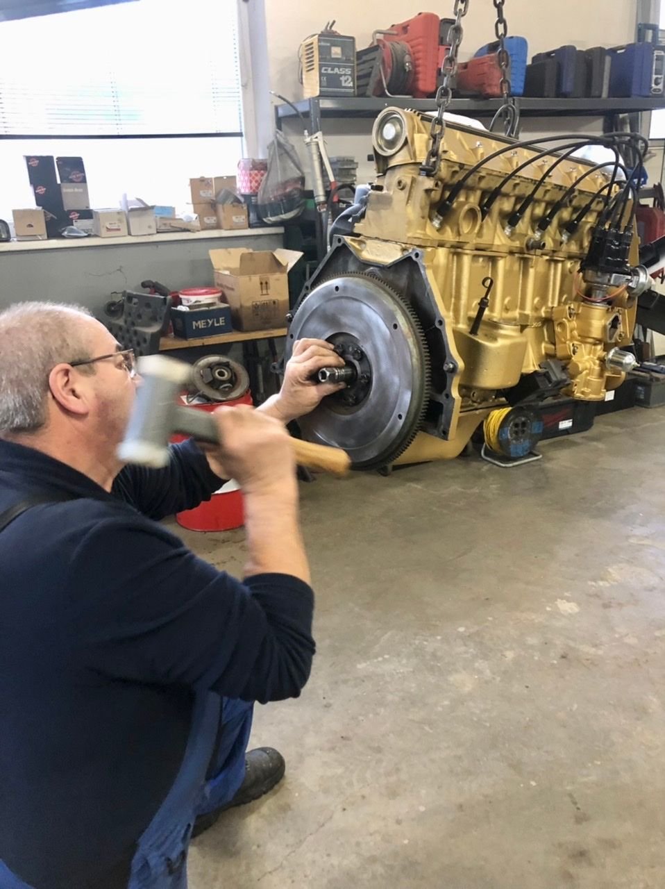

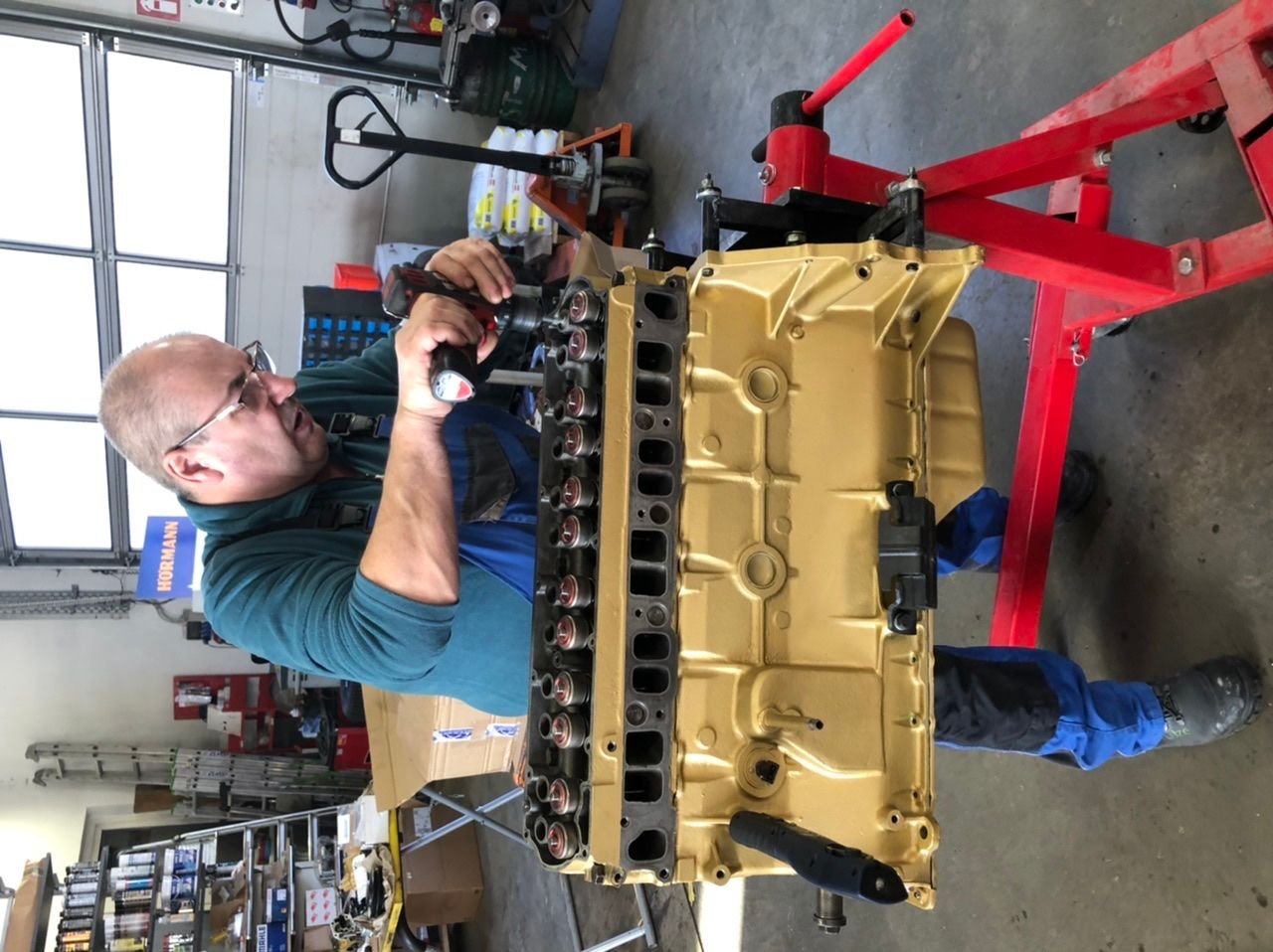

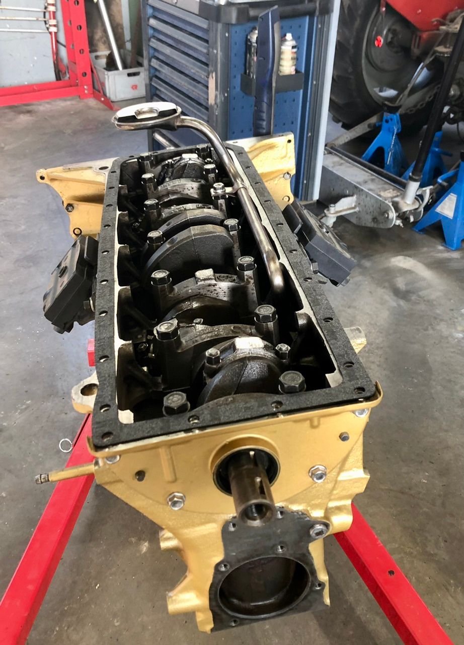

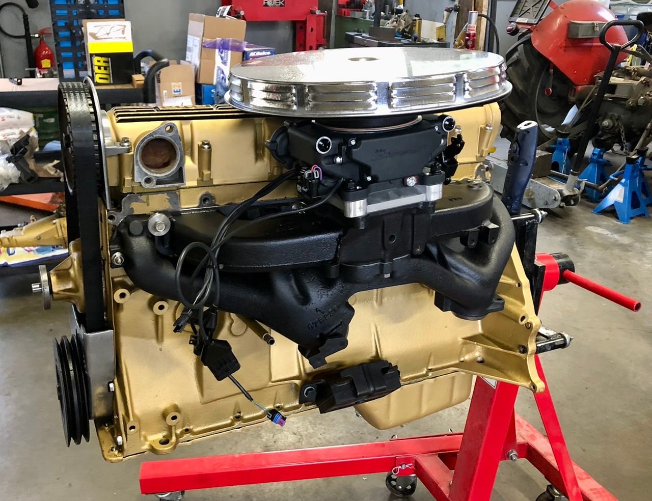

Engine building progress - my brother in action! I’m really impressed by his skills gained over the last 45years

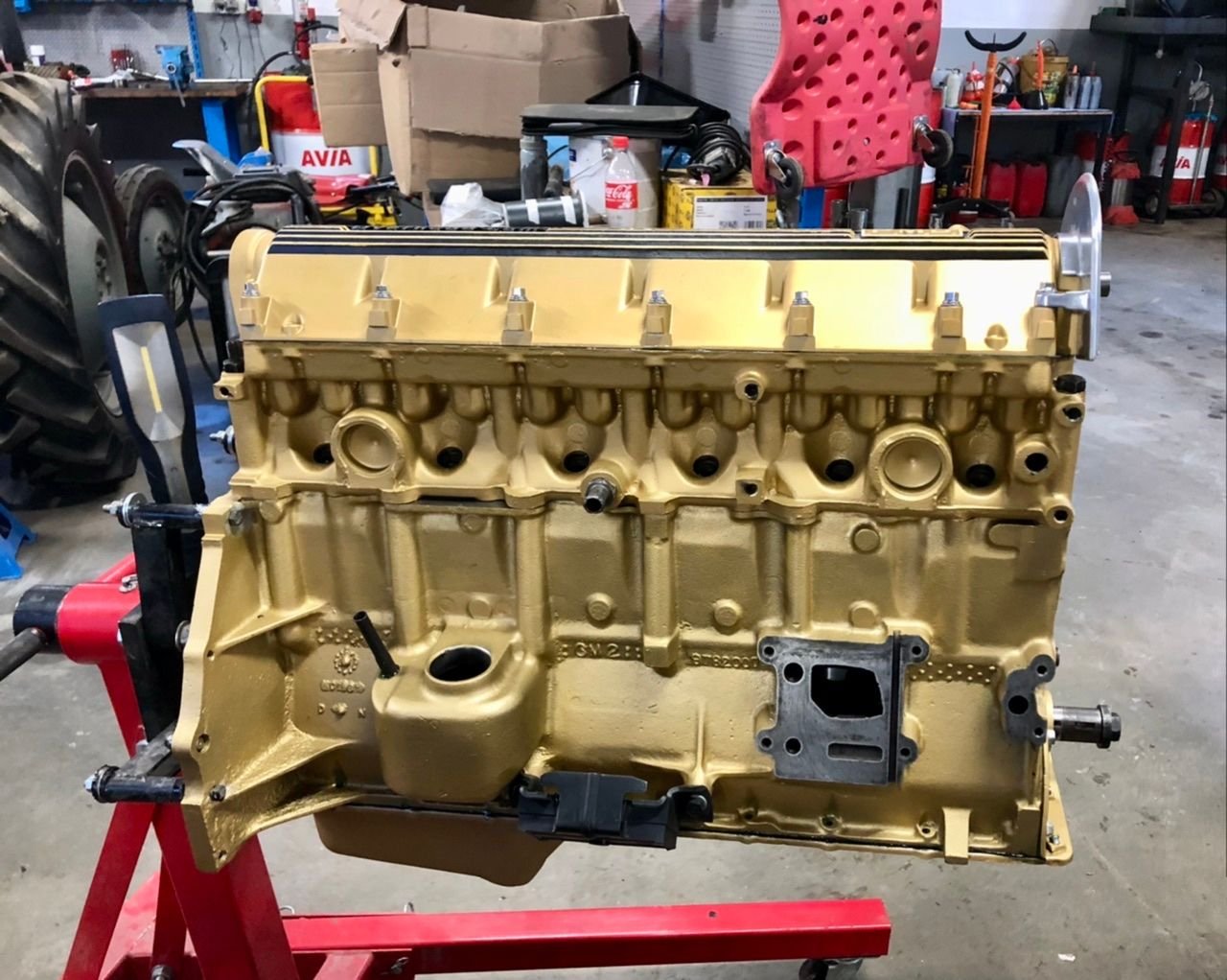

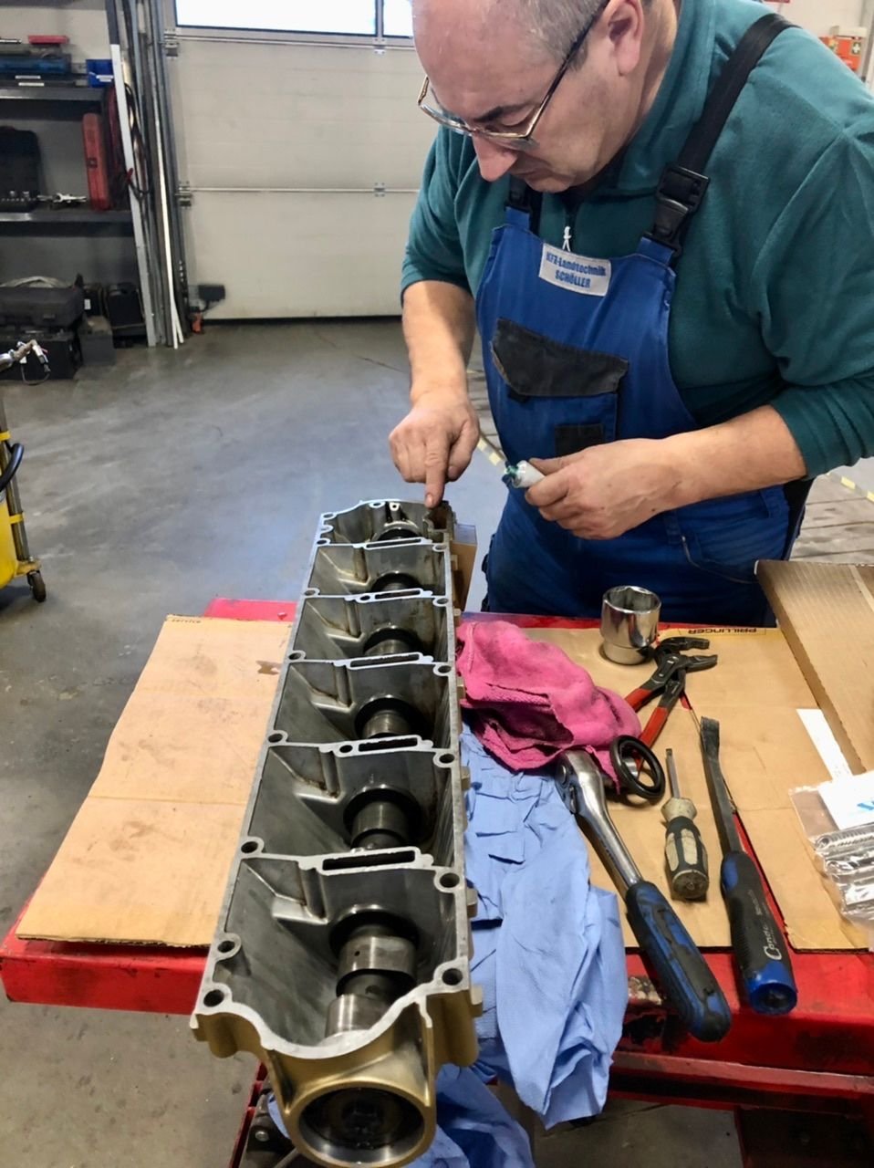

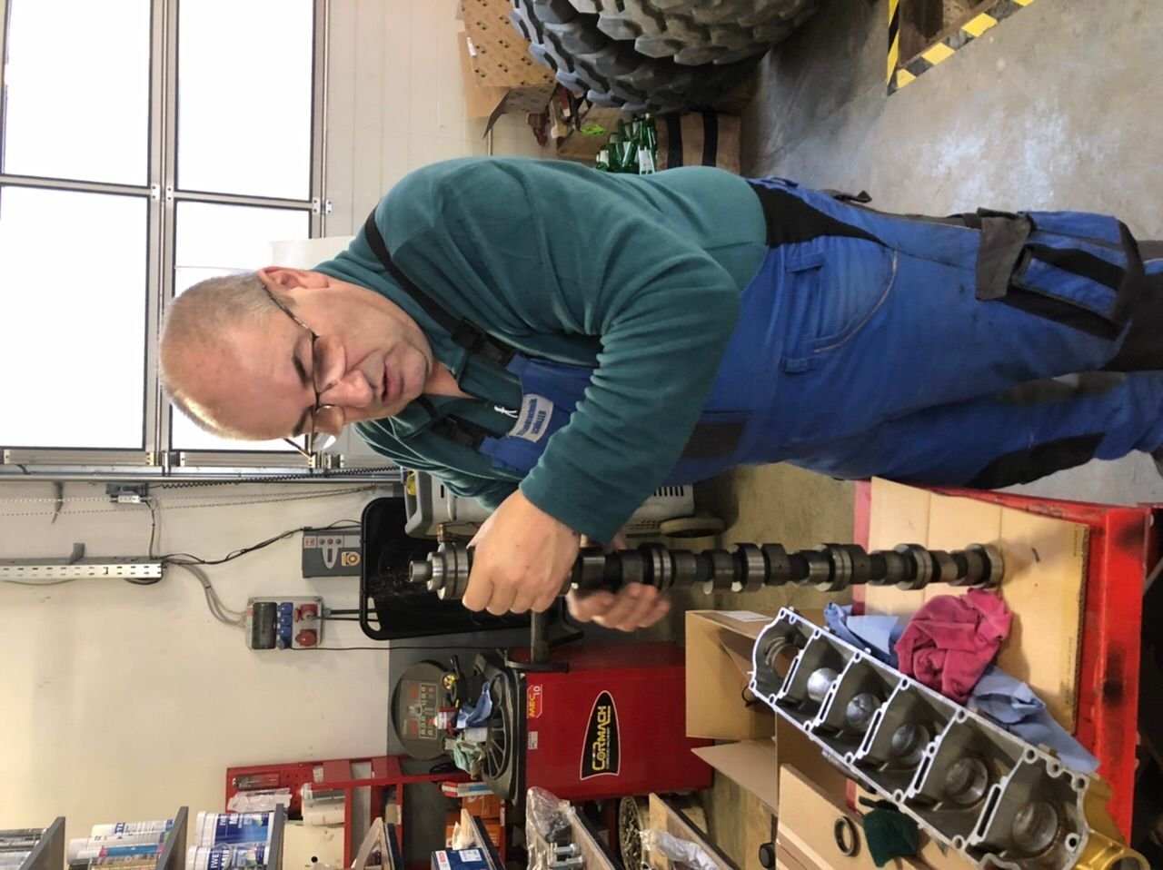

When Franz was looking at the cam he said: wau, this is a sharp one, very steep! Will be a challenge to turn the cam. And he was right.
his first inline 6 he was working on back in the seventies was the Datsun/Nissan Laurel 2.8 and with the hundreds of rebuild engines since then, he can’t remember such a hard to turn only the cam like the ohc6
Old Dec 29, 2021 | 11:36 AM
  #188
exotec's Avatar
Olds Omega
Joined: Mar 2019
Posts: 426

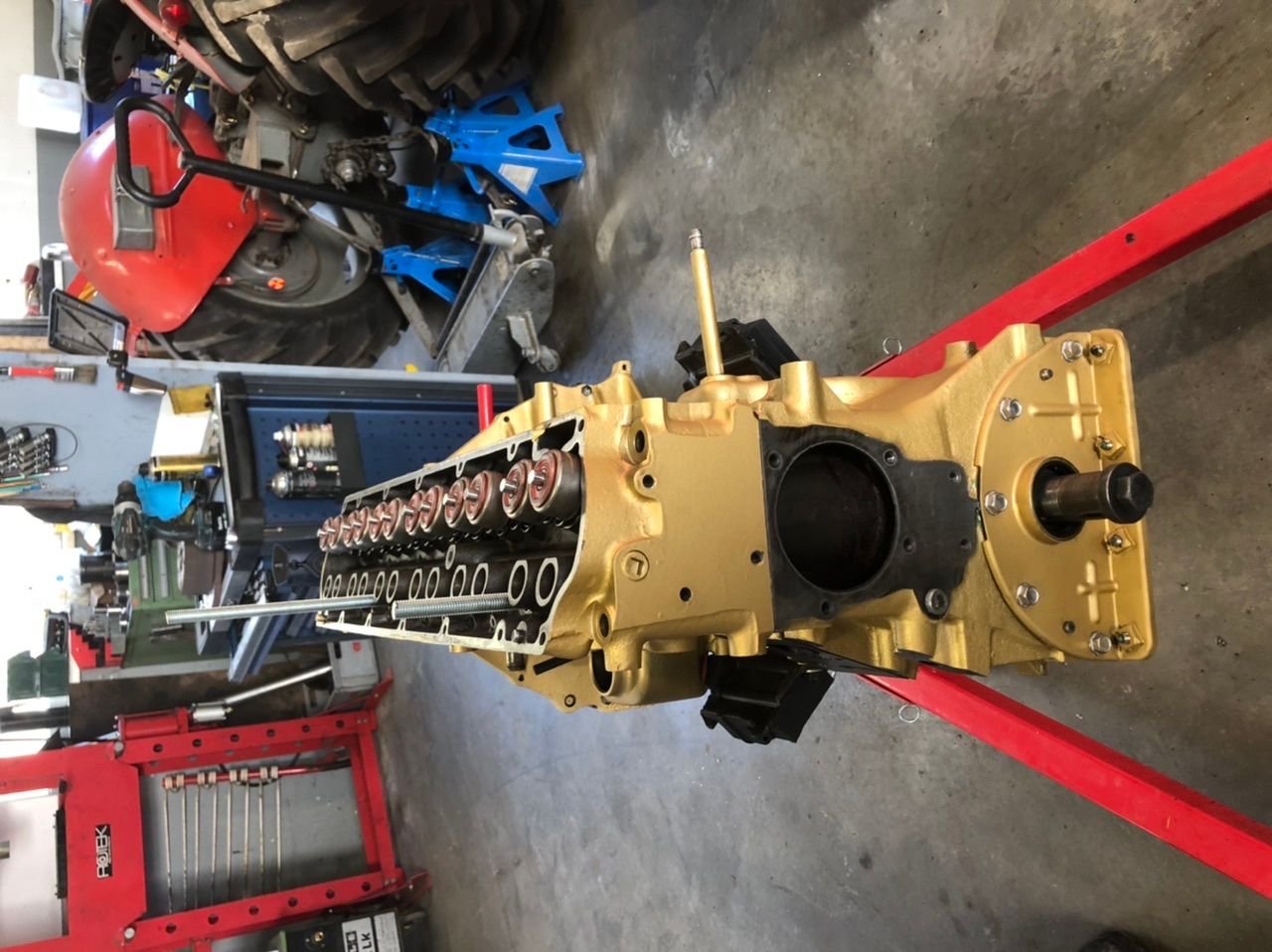

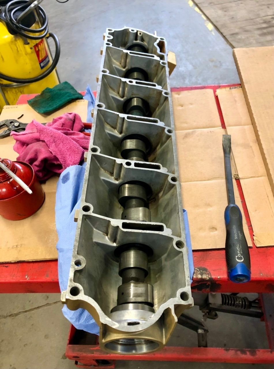

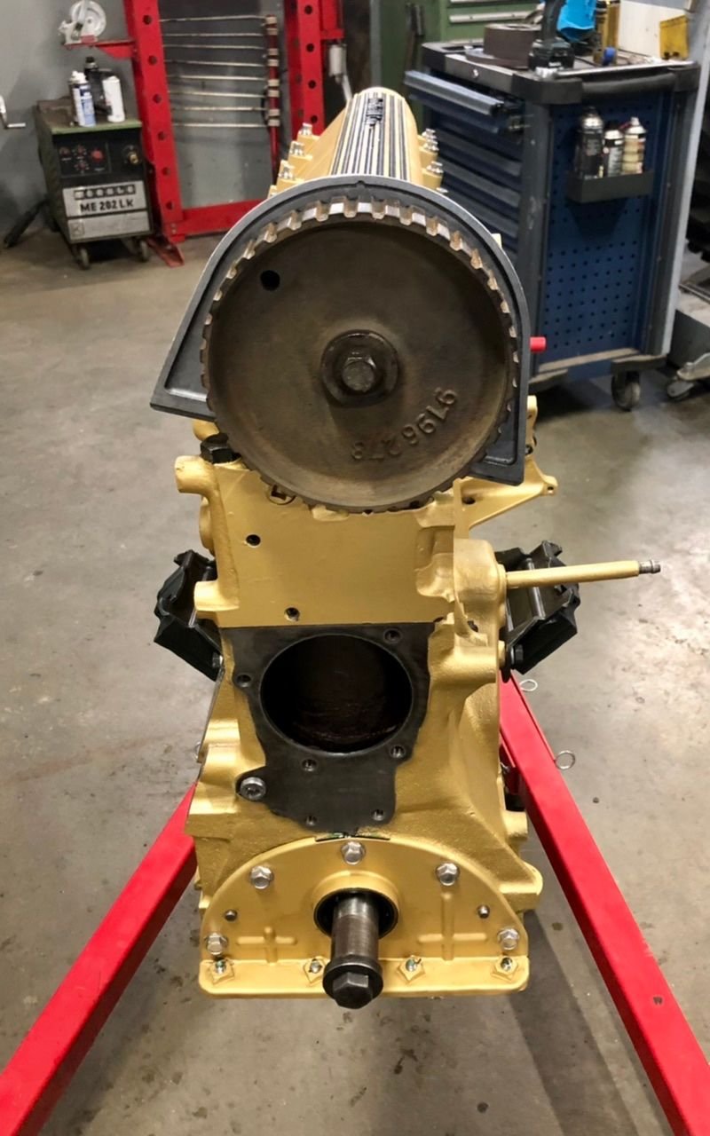

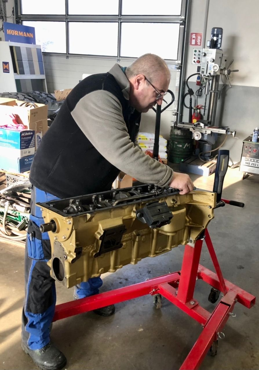

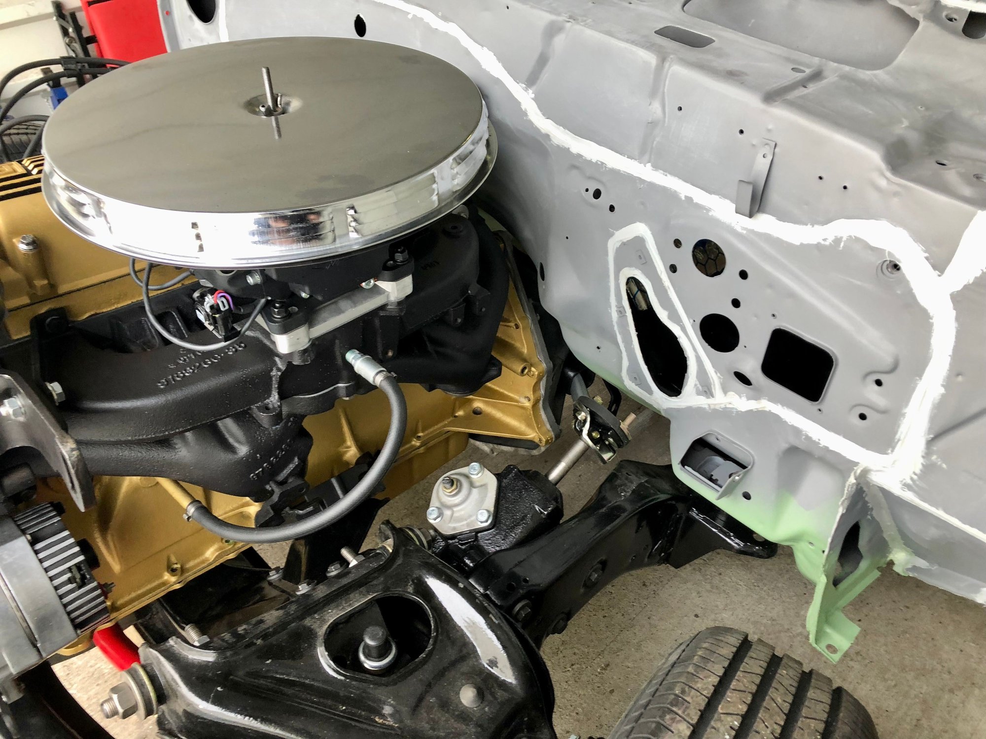

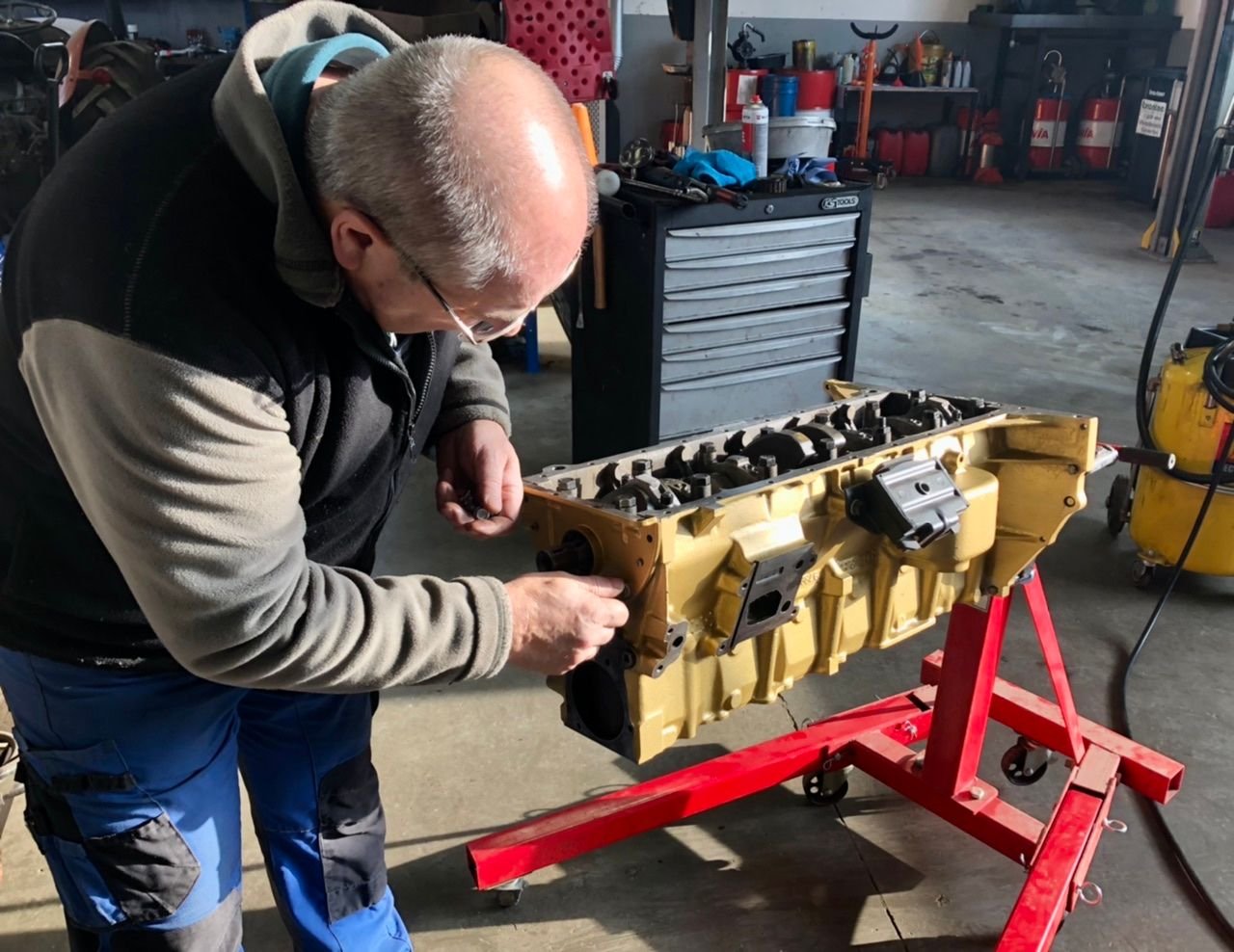

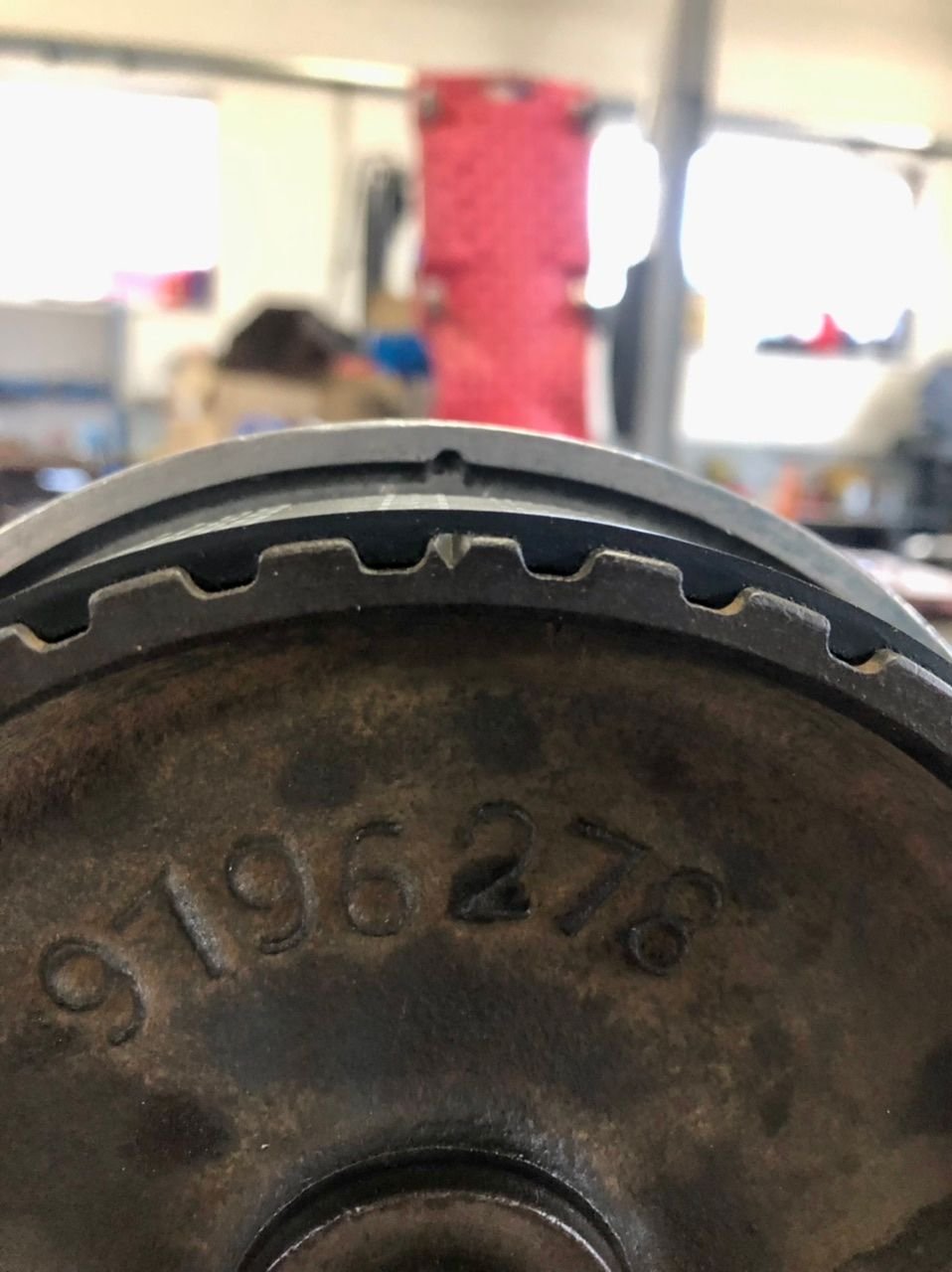

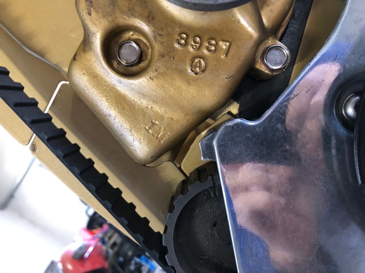

Day 2 of the Pontiac ohc6 build – a setback!
My brother still was not happy with how the cam turned around. So we installed the accessory housing, the crank cog pulley and the belt. With the first turn the snout neatly and completely snapped right off!
Ok, cam tower must go off again. Let’s measure some numbers according to the rebuild guide Jeff B. Hamlin once provided us.
✅ Cam tower rail surface and top of the valve steams 0.850 and within the tolerance!
✅ Lash adjuster can be compressed all the same value!
🛑 Valve lift exhaust 0.444 and intake 0.375 --> this is much to less!
Then let’s uninstall the valve springs and see what’s the reason for. Unfortunately, the motor shop didn’t take care about the valve lift when they installed new valve guides. They installed the new ones to be flush in the head on the camber side but didn’t check the lengths on the spring side.
We called the shop owner and discussed our findings. My brother and the motor shop founder a friends since ages, his twins (run the shop meanwhile) and my nephew as well – the engine shop does a lot of motor overhaul for my brothers business. The shop is closed till January 3rd, then my brother will stop by and they will fix the valve guide length.

Yikes, good catch and a good case to always inspect the machine shops work.

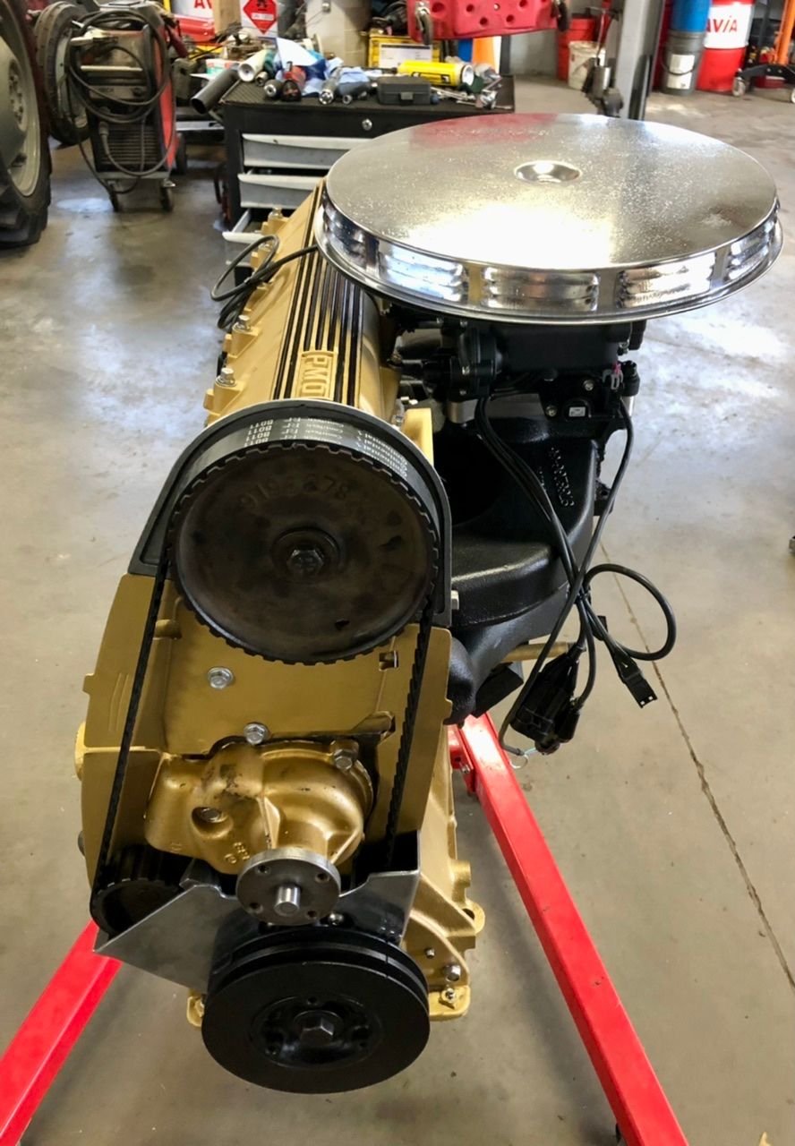

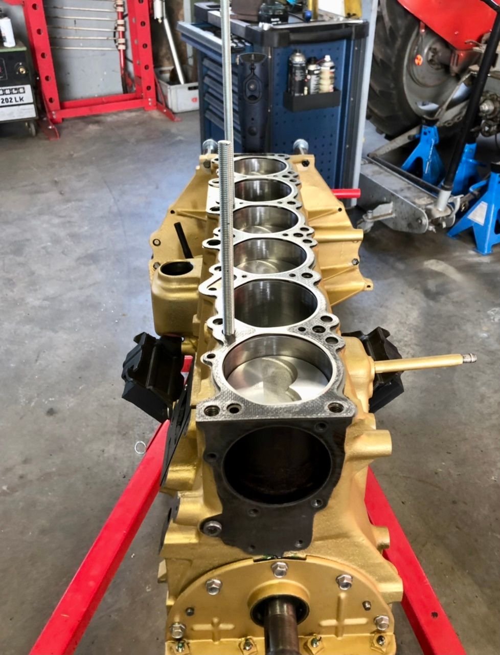

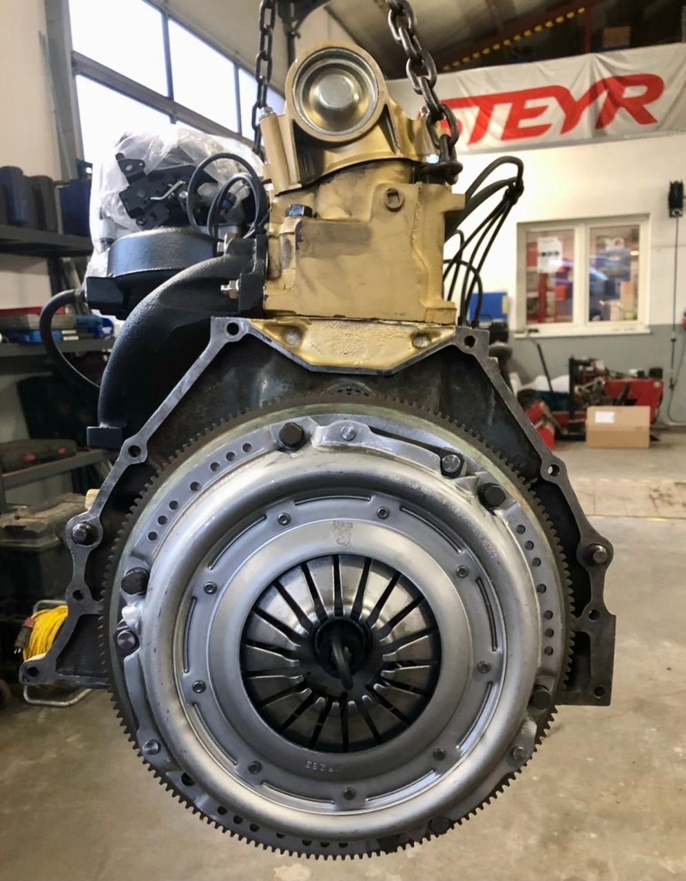

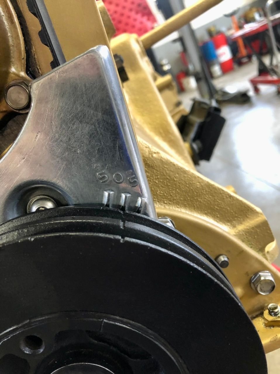

successful lineup!
Motor shop cut the valve guides to the correct length and my brother and I could proceed with the assembly of the Pontiac ohc6 sprint with Holley Sniper for my 73 Oldsmobile Omega!

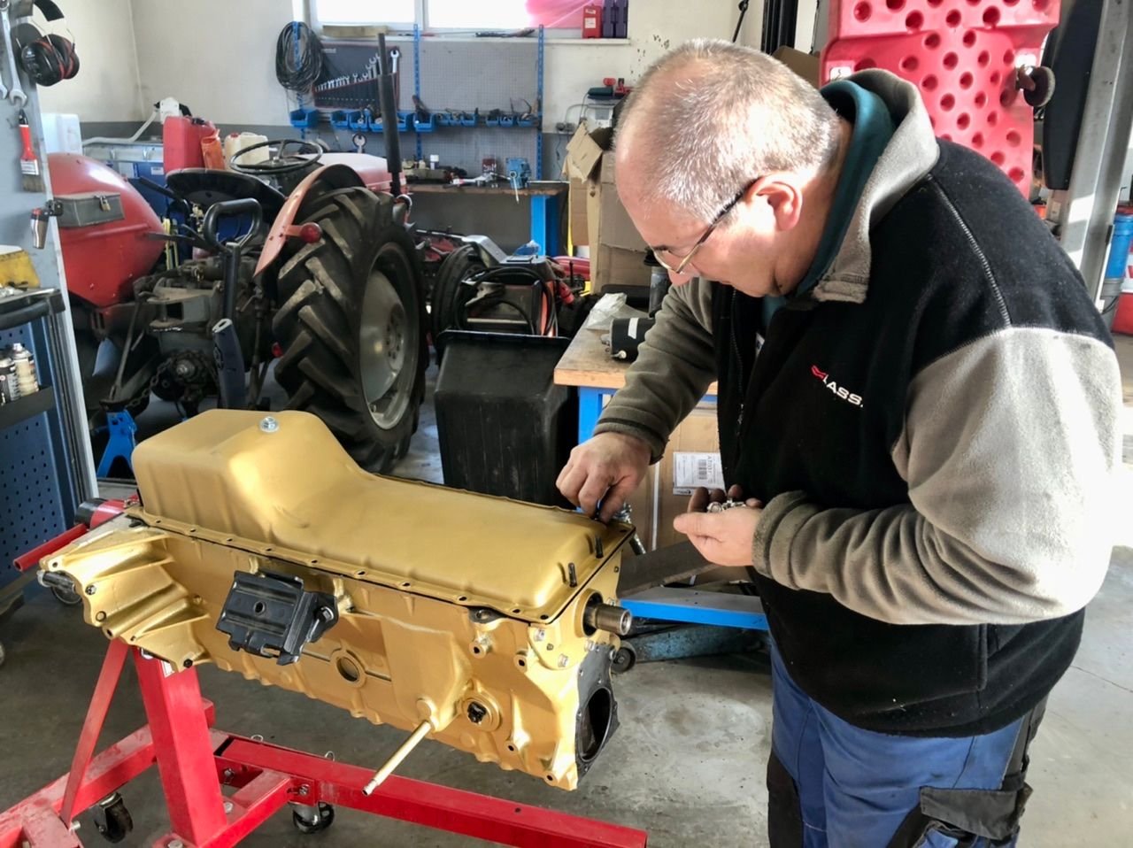

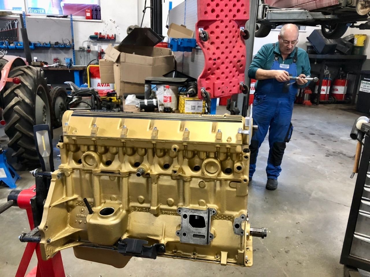

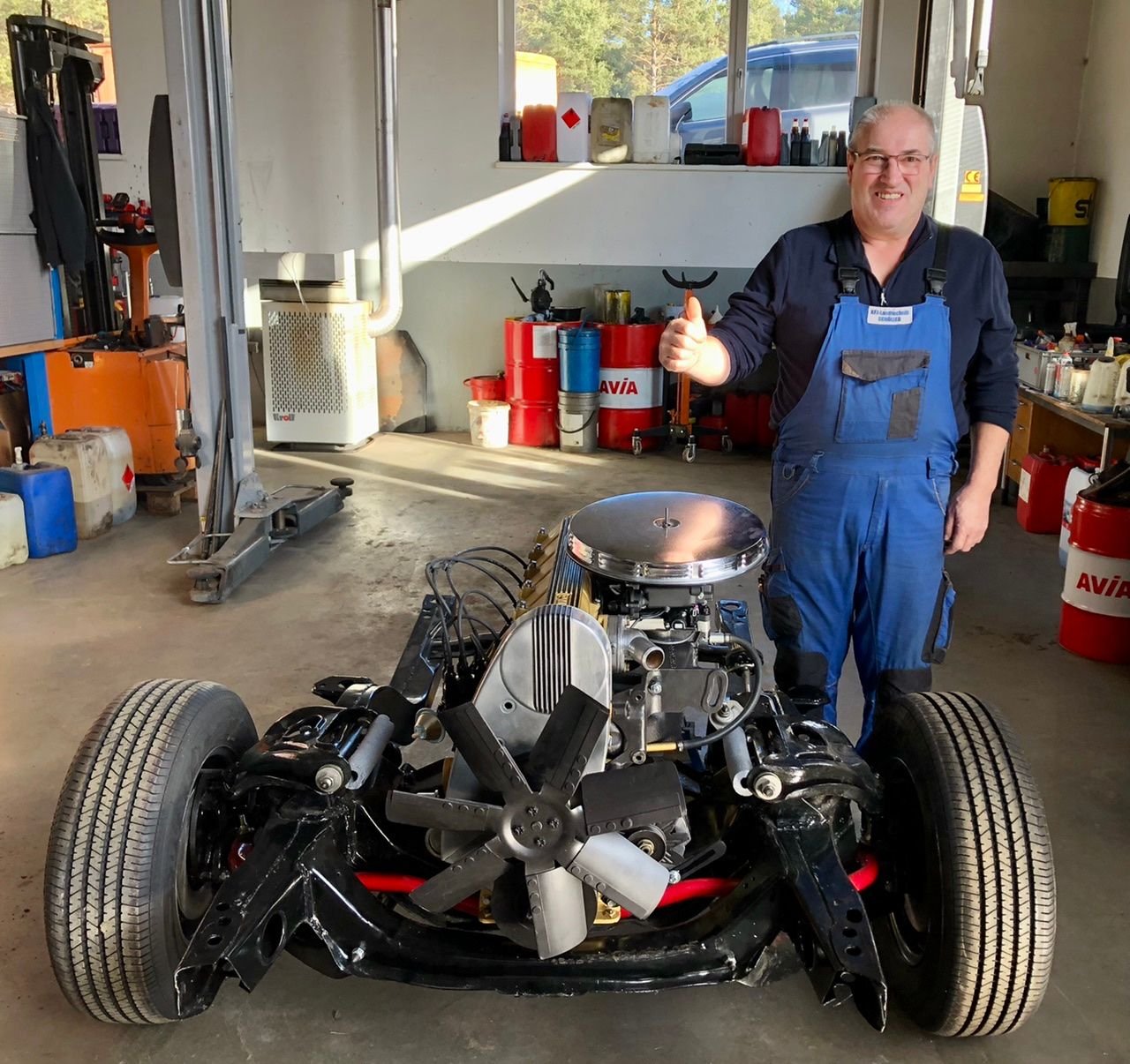

Day 4 - allmost done
To have a pro mechanic brother and been allowed to used nephews shop for a view days is priceless!

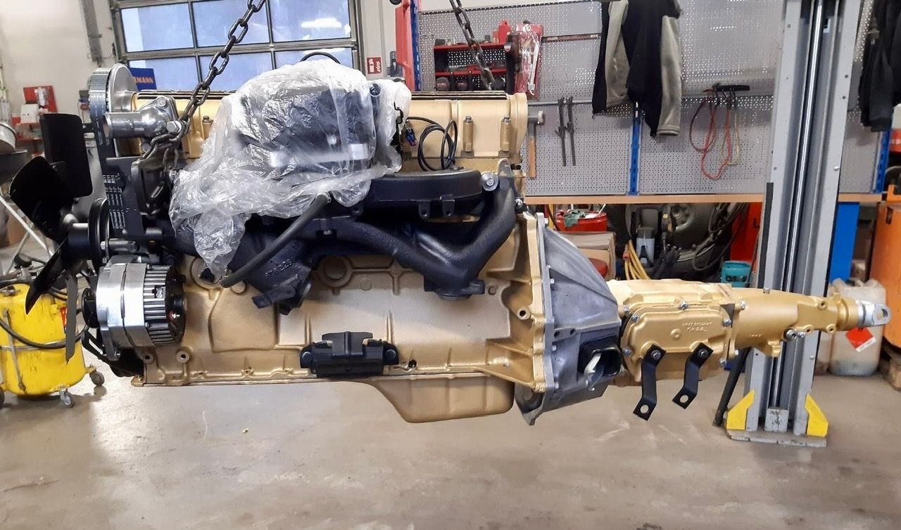

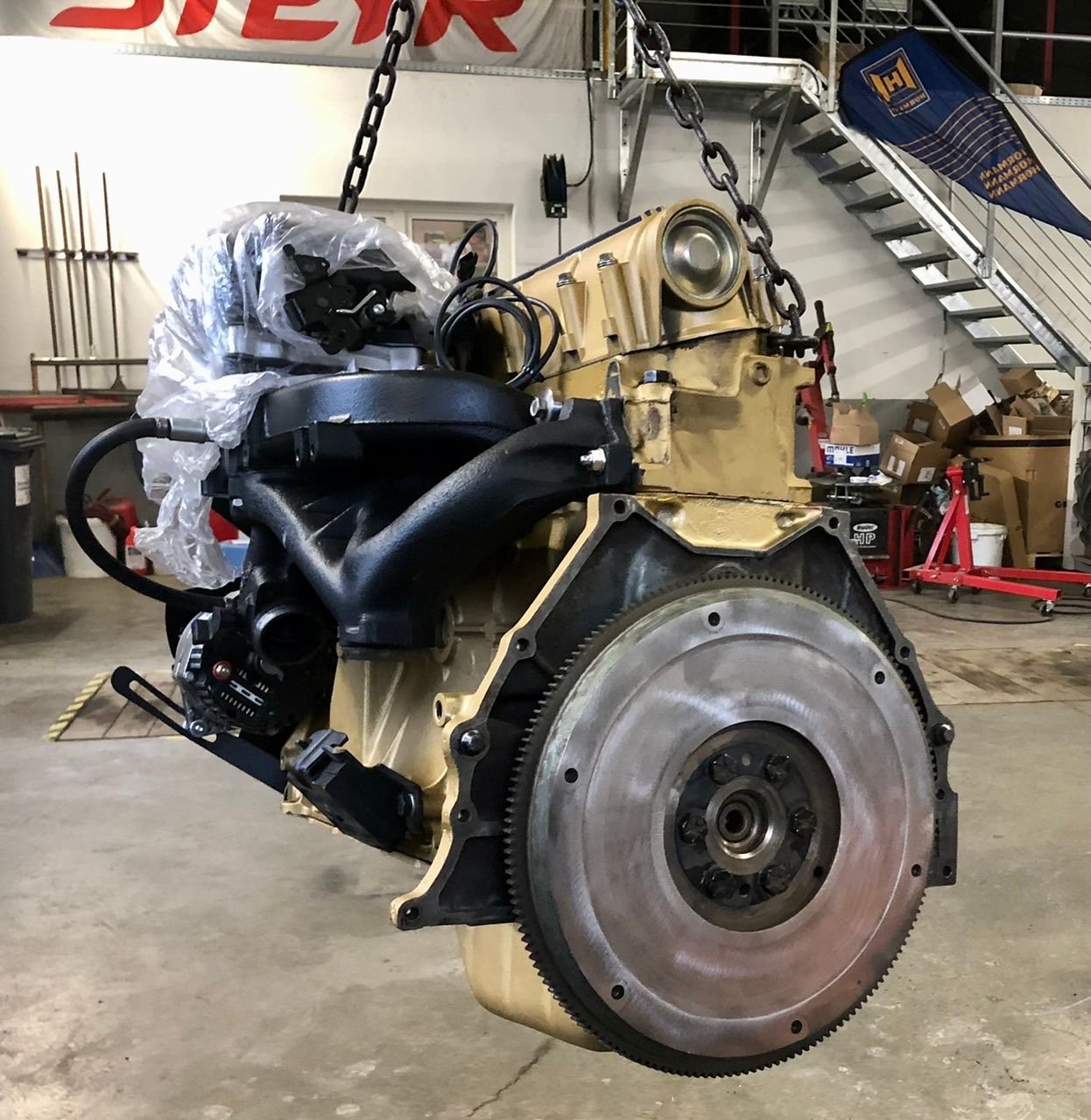

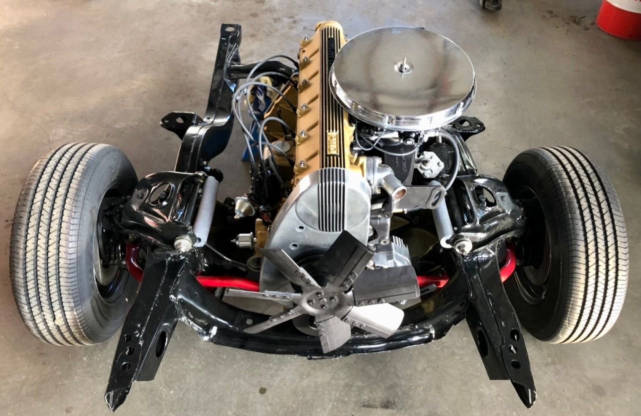

Today engine and trans mounted on the subframe
and finally with my pro mechanic brother Franz!

That looks real nice Karl!!! The belt cover and cam cover remind me of the old cast mickey thompson / holley valve covers for v8s
can you do a dual exhaust w that manifold or will it be a Y pipe to a single exhaust?
Old Jan 7, 2022 | 06:13 PM
  #195
exotec's Avatar
Olds Omega
Joined: Mar 2019
Posts: 426
It will get a dual exhaust

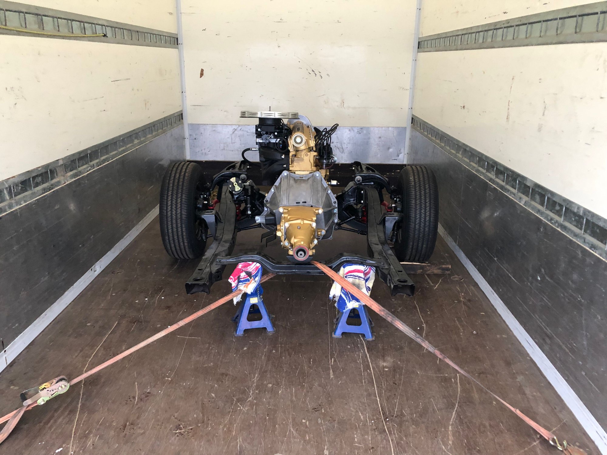

Old Jan 11, 2022 | 03:24 AM
  #197
exotec's Avatar
Olds Omega
Joined: Mar 2019
Posts: 426

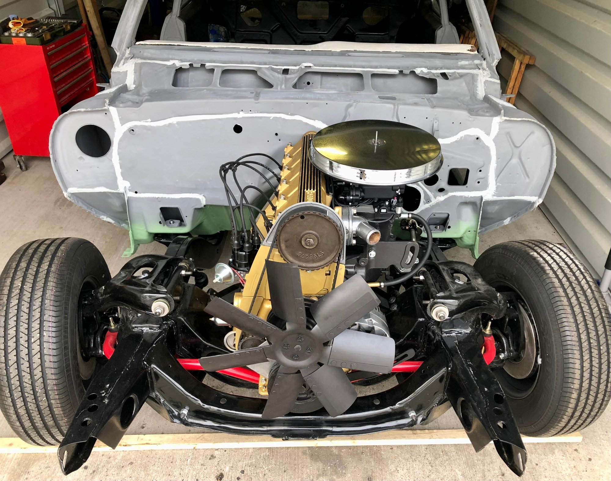

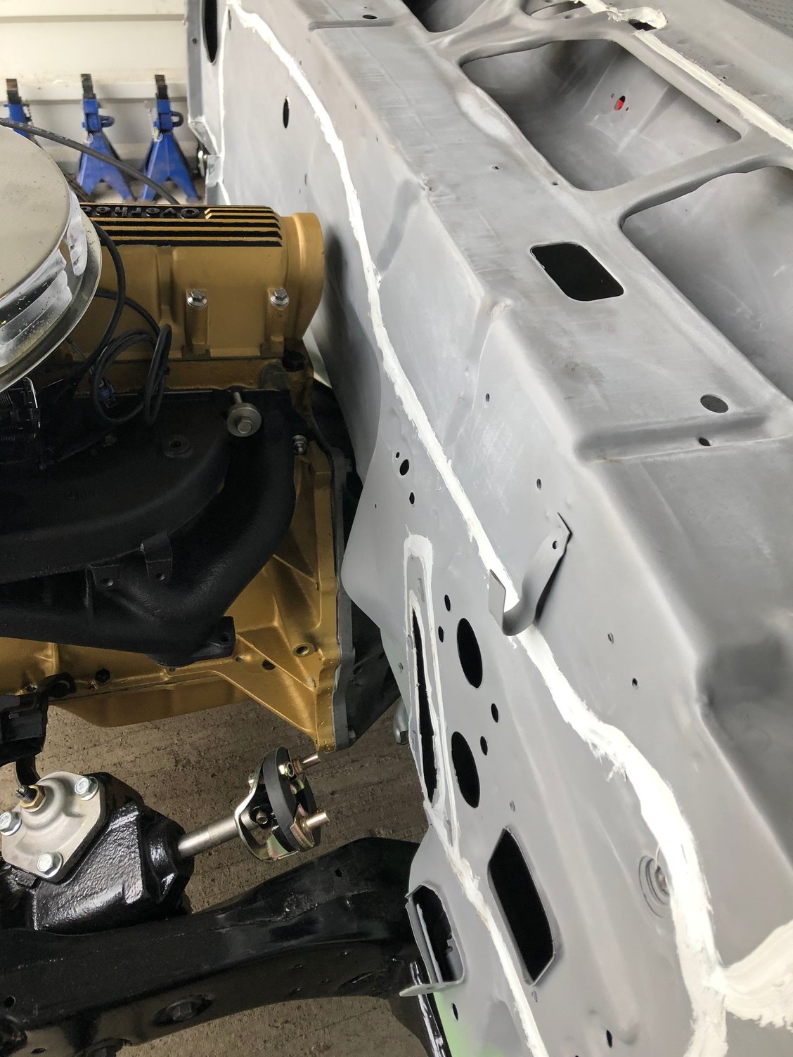

all back home and installed the subframe - fits like a glove!
Old Jan 11, 2022 | 03:58 AM
  #198
Posts: 5,568
Wow, Very nice!!
Old Jan 11, 2022 | 07:58 AM
  #199
Posts: 10,104
That cam cover makes it tight. Most twist should be sideways thankfully. Awesome build.
