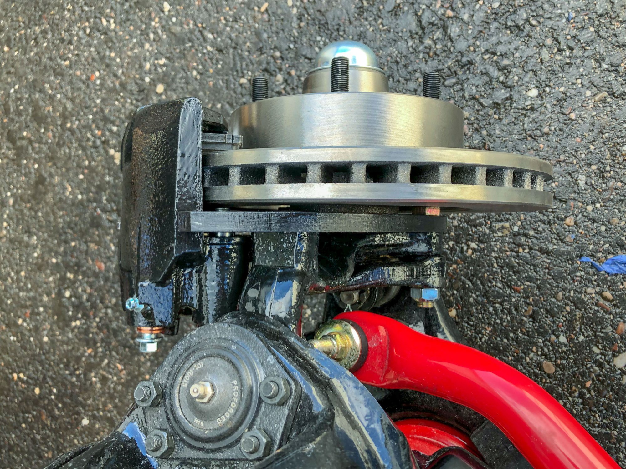

The disc brakes for the front should come on Monday - I will now used the Right Stuff Conversion Kits for 14 in. Wheels for the orig Drum Brake Spindle
Then I'll screw the front frame together including the steering linkage. It's great that almost every screws are available newly.
Next week also all parts for the rear drum brakes should pop up. I will than paint the disc caliper, drum and carrier plate black with Por-15 Disc Caliper Paint.

painted the parts from the Right Stuff disc brake kit for 14 inch. wheels the last days with POR-15 caliper paint and today finally got it installed! was a quite easy fast forward job.

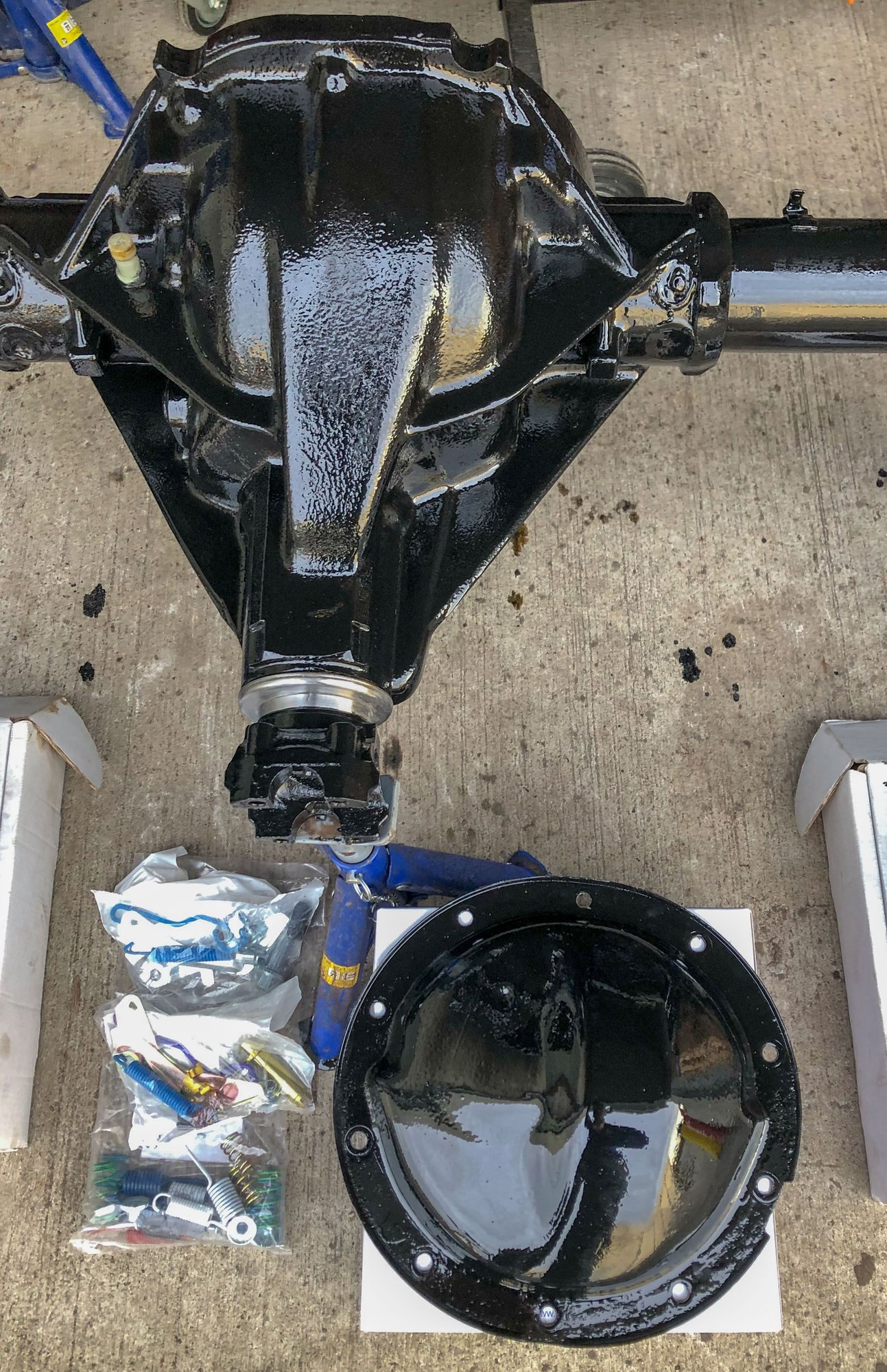

national holiday programm - cleaning the rear end!

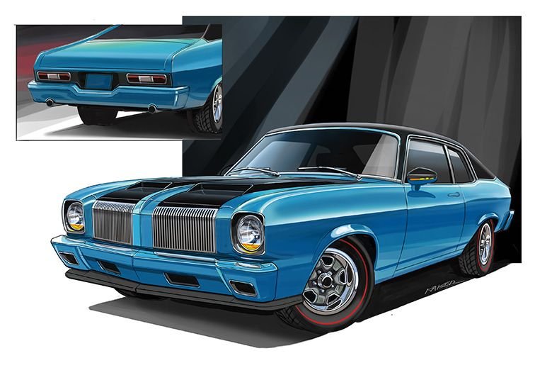

More or less final design

I think it looks good, with the relatively flat hood and grill / scoop width being close to thesame along with the black stripe extending to the grill it looks sharp.
the tucked in bumpers, front splitter/spoiler and blinkers in the headlights and mirrors modernises the look with out taking away from the classic appeal.
will you paint it blue black like that or something else?

Will be painted wedgewood blue with black vynil top
the headlights with integrated blinkers and the sport mirrors with integrated blinkers I will maybe not get legalized in Austria. If not, than the Omega will have 7" Hella H4 headlights, blinkers in the bumpers and fender and the sport mirrors from the SX package.

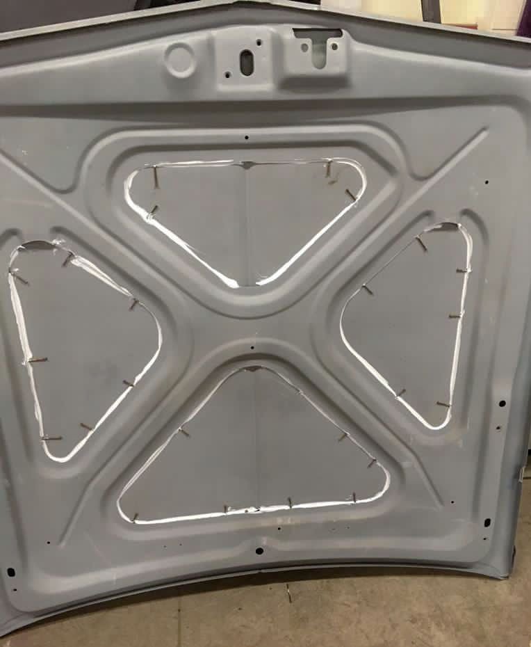

stabilize and seal the hood

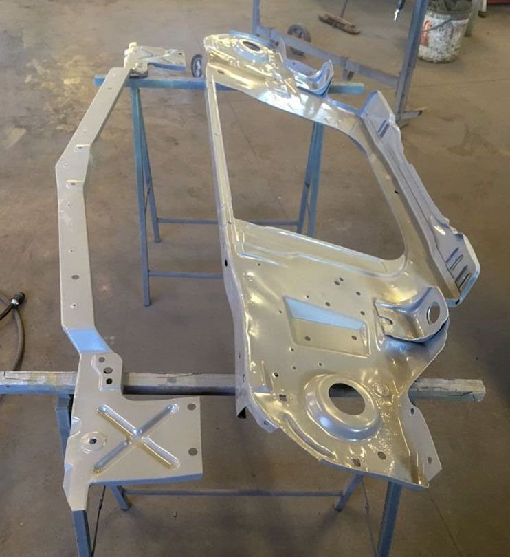

a view body parts are ready

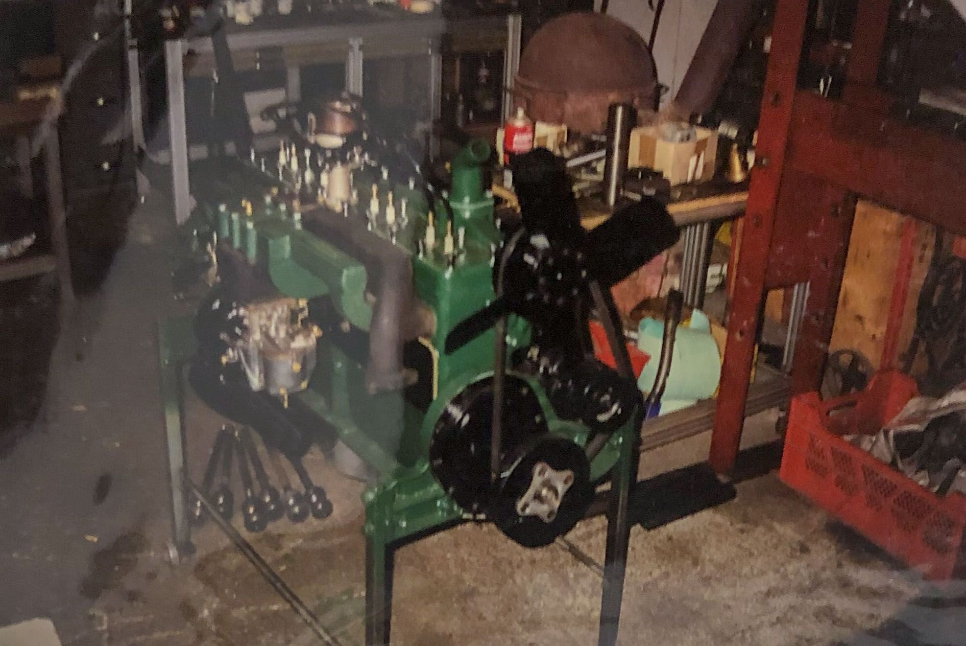

Spent a couple of hours today in West's workshop and then while we had a garage beer he came along with some pictures oh his vintage US car
1929 Studebaker Commander with a inline 8 flathead.
Imported in the 50s by a Viennese master butcher and rescued from a barn by Werner 24 years ago and started a complete restoration. Frame completely dismantled, every single rivet opened and renewed, rims dismantled, got rid off the paint from wooden spokes and set back in just nature, etc.
Unfortunately, the project has been dormant for 8 years since he became self-employed - it just had to be put together and the 6V electrics made new.

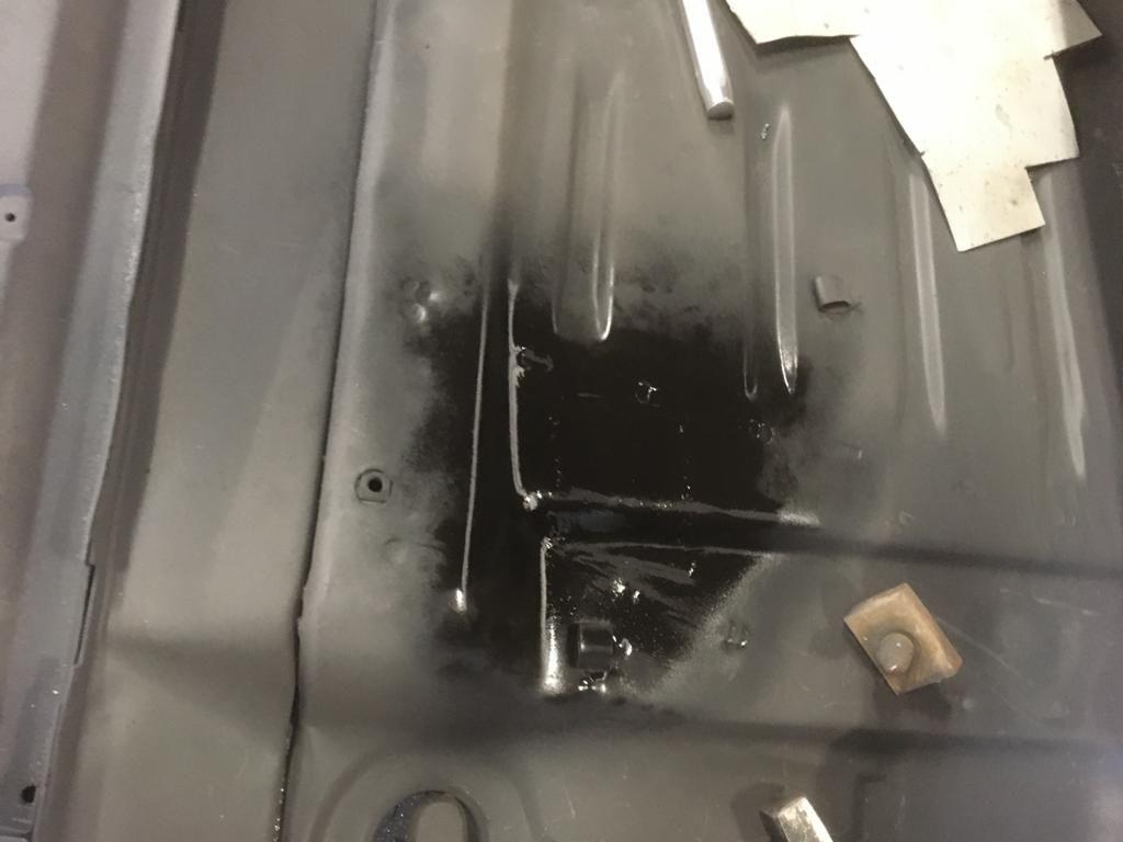

fixing the passenger side subframe mounting points

That's why I oil every thread, as well as keeping them as short as possible
