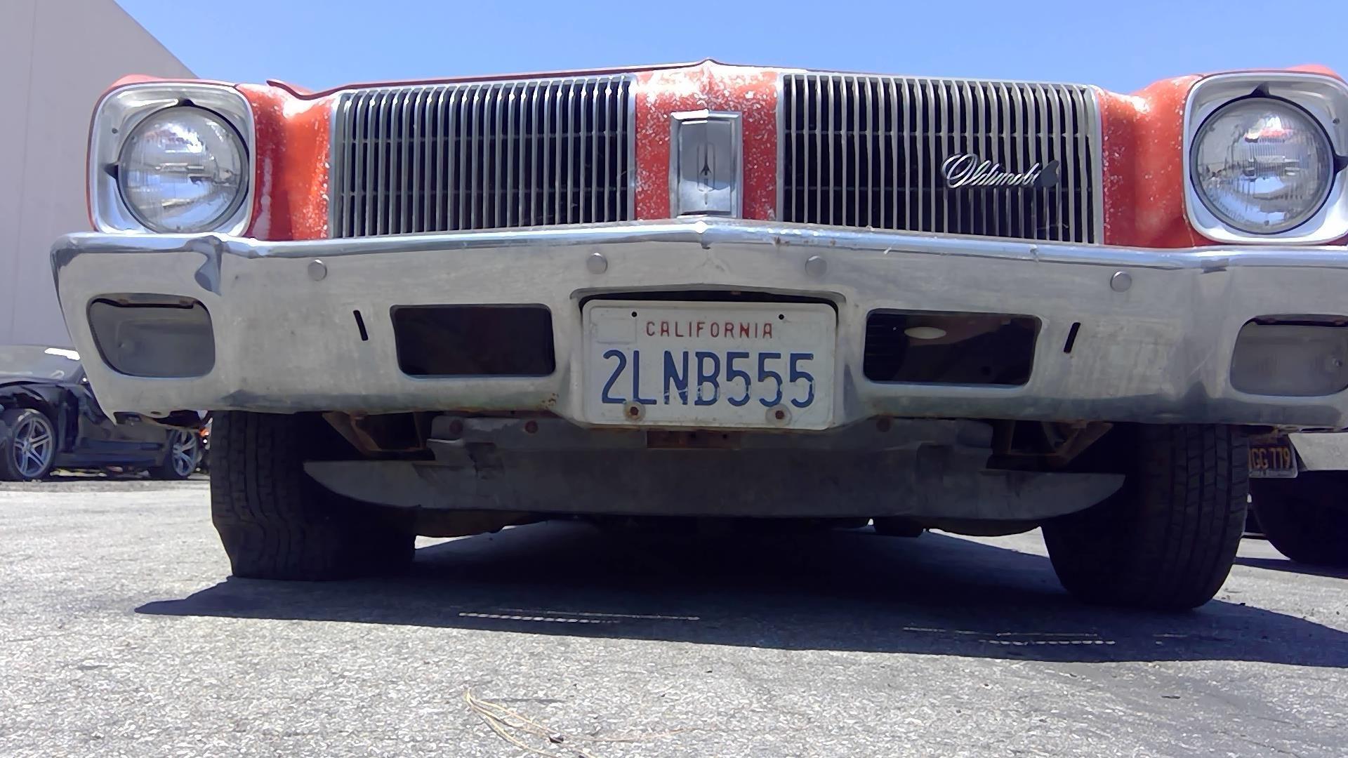

Than a view weeks ago I run across an Oldsmobile Omega 1973 in craigslist. A fellow member of stevesnovasite helped me to get in touch with the seller. When I saw the VIN I was clear I have to swith my project from the Nova to the Omega. The VIN ending with 1868 which is the year of birth from my granddad, whom I never met. He became nearly 100, but died years before I was here. His name was like my fathers name Franz.
So I bought the Oldsmobile Omega 1973!

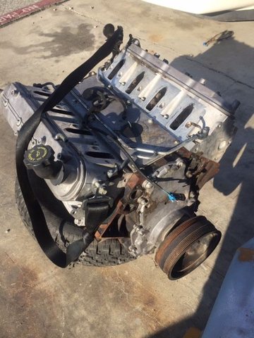

So I more and more question myself if this LS swap and all other modification I planned will honor this car as it should do? My oldest daughters opinion is to keep it as original as possible. However in Austria it will be a real rarity on the street. This exact model is therefor listed on the list of worth preserving vintage cars of the Austria federal ministry of transport! And if I will have an Austrian title as a vintage car than anyhow will be forced to keep it in the original conditions.
Than I maybe only will have the S package from 74 installed – lowering the car about 1,5” with the rally suspension and the sport bucket seats.
What would you do?

In the states being that it is a 6 cylinder car its just not that desirable. and as such, not worth a ton of money. I would do the swap and make the car much more fun to drive, and to be quite honest, more reliable.

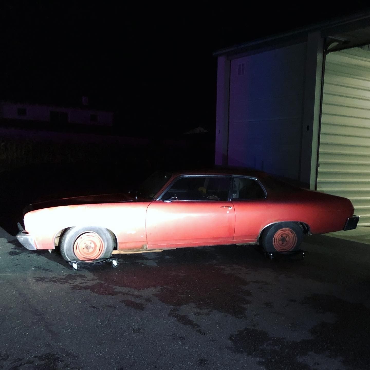

Finally arrived in my shop last night!!
