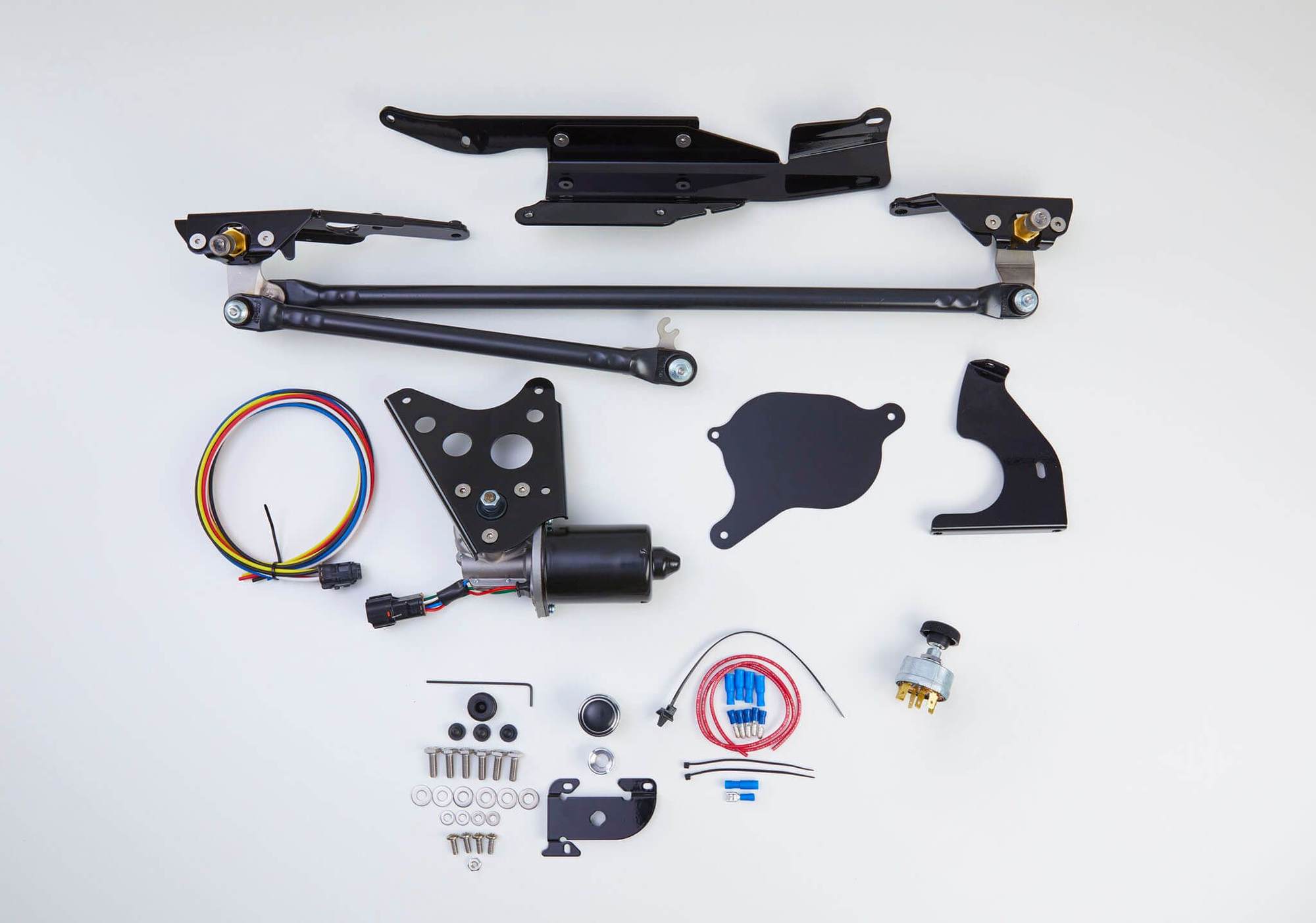

will be a clean firewall! vintage air and rain gear will be hidden
The A/C is easy enough with aftermarket kits. Very curious how you are going to hide the wipers and get the right sweep and function. I don't think there will be another Omega like your car on the road.

From: Mautern, Austria
wipers will stay visible, just hiding the motor with a raingear system In Austria it will be for sure unique car!

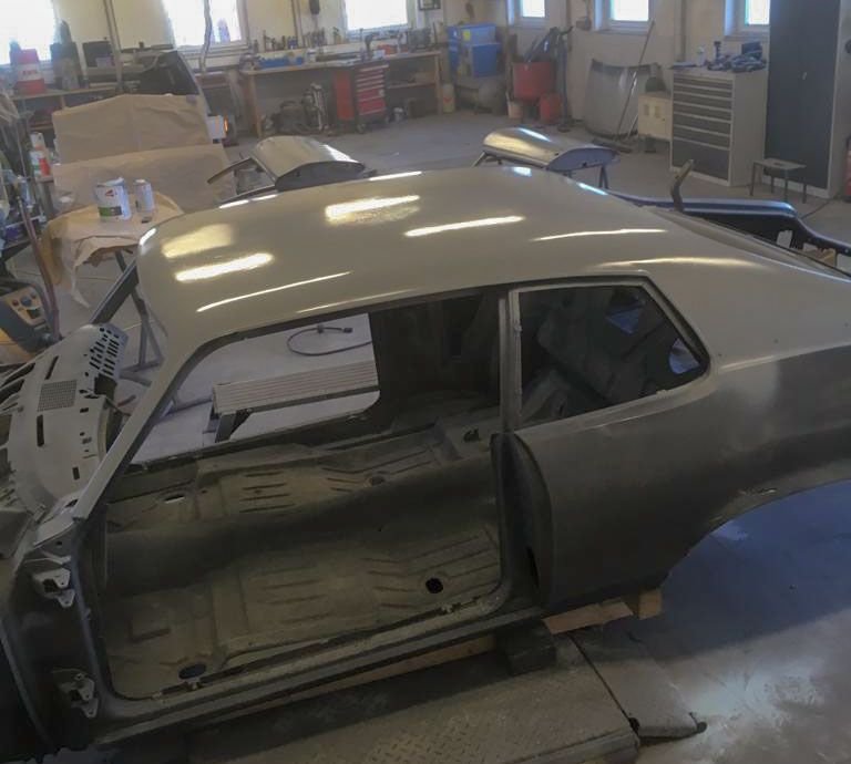

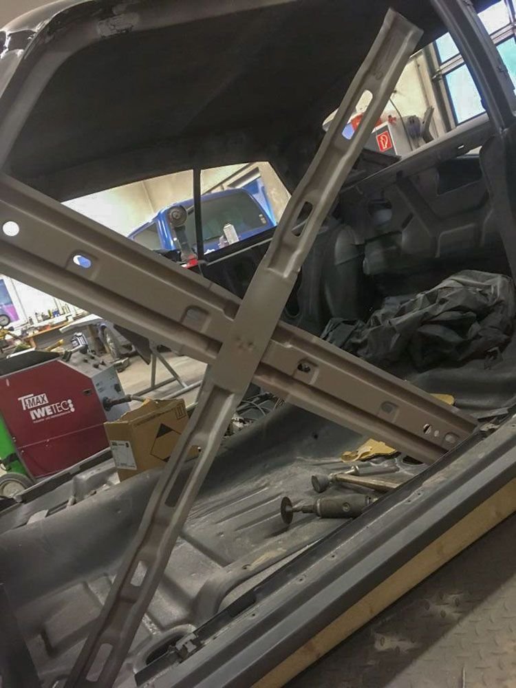

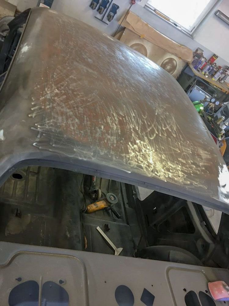

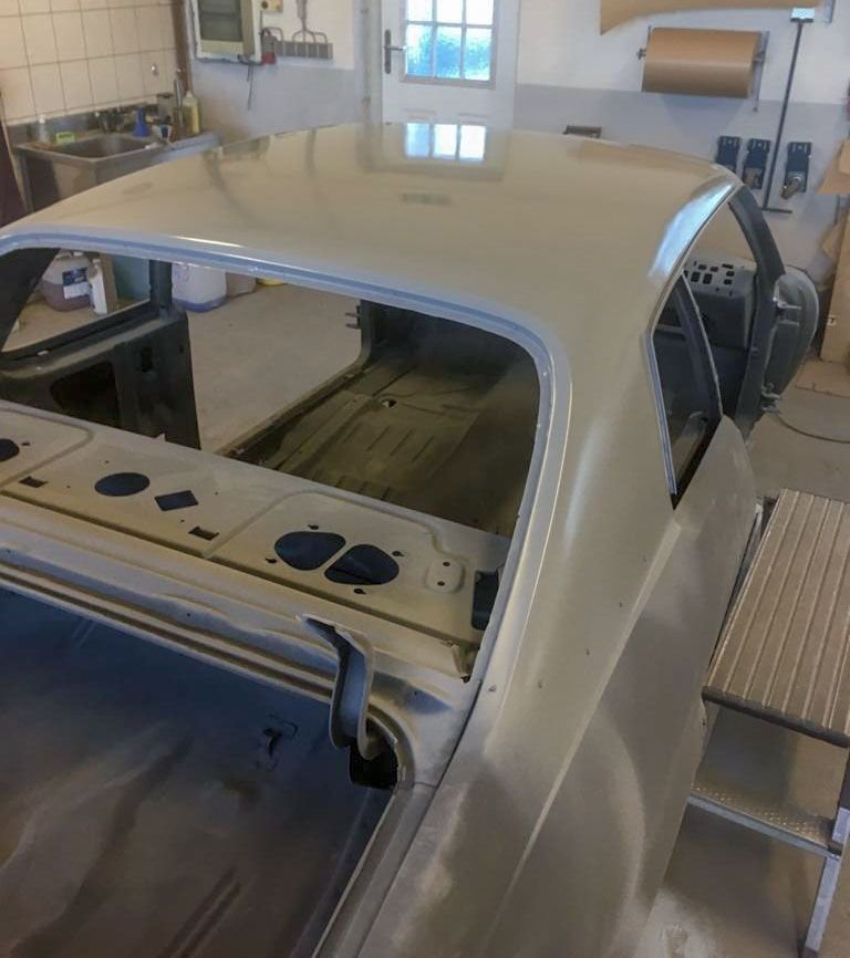

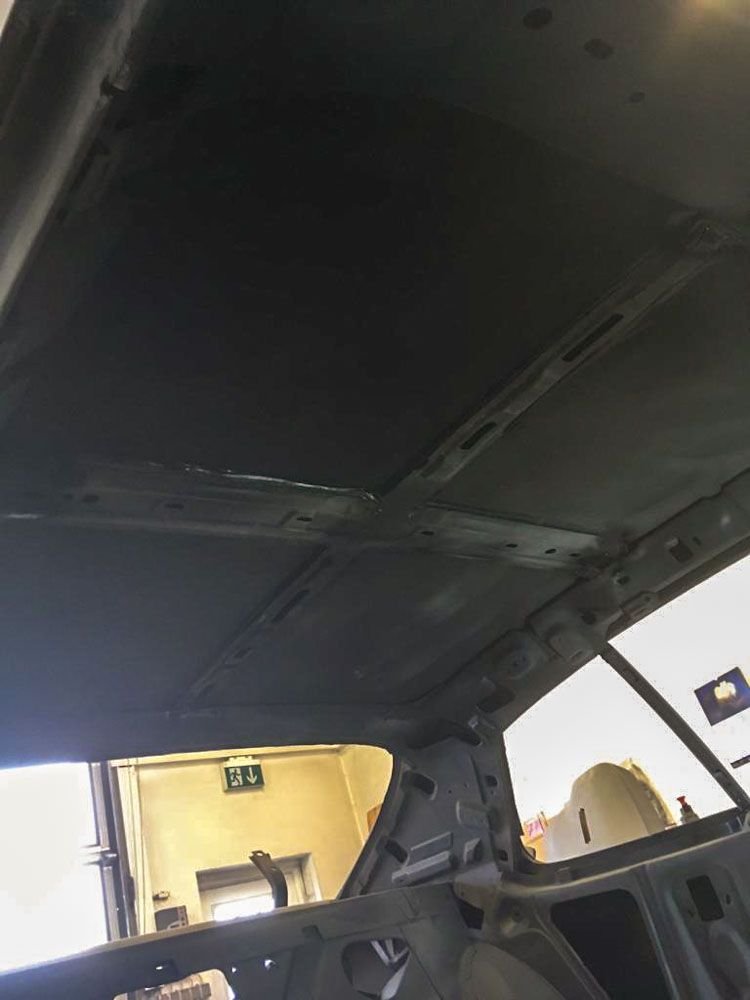

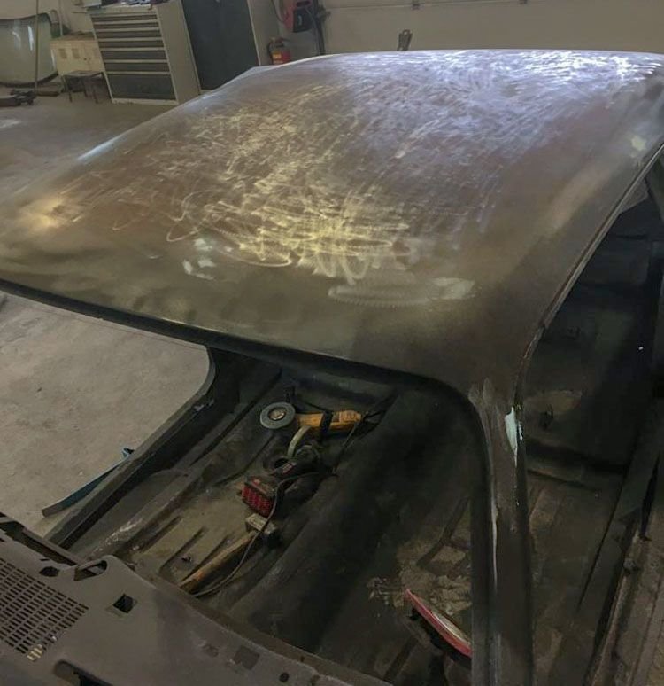

fixing the roof!
In order to get the dent out and to achieve reasonable stability in the roof, the reinforcement is cut out, the roof sheet is shaped and then stiffness is brought back to the sheet metal with many welds in a beautiful pattern. Then the cross is straightened and shaved and welded back in again.
and the hours count and count
Very cool, never knew such a thing existed, a very nice touch.

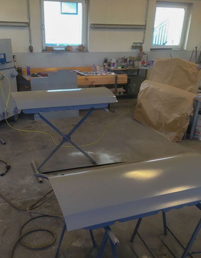

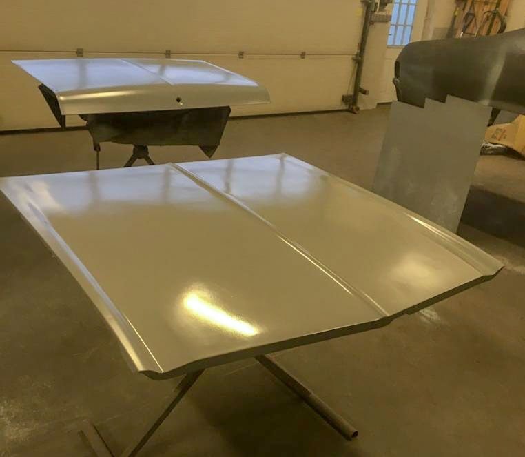

hood and trunk lid ready for paint!
before

olds 307 and 403's Avatar
Out of Line, Everytime😉
Posts: 10,104
From: Melville, Saskatchewan
Those already look painted, should look great when done.

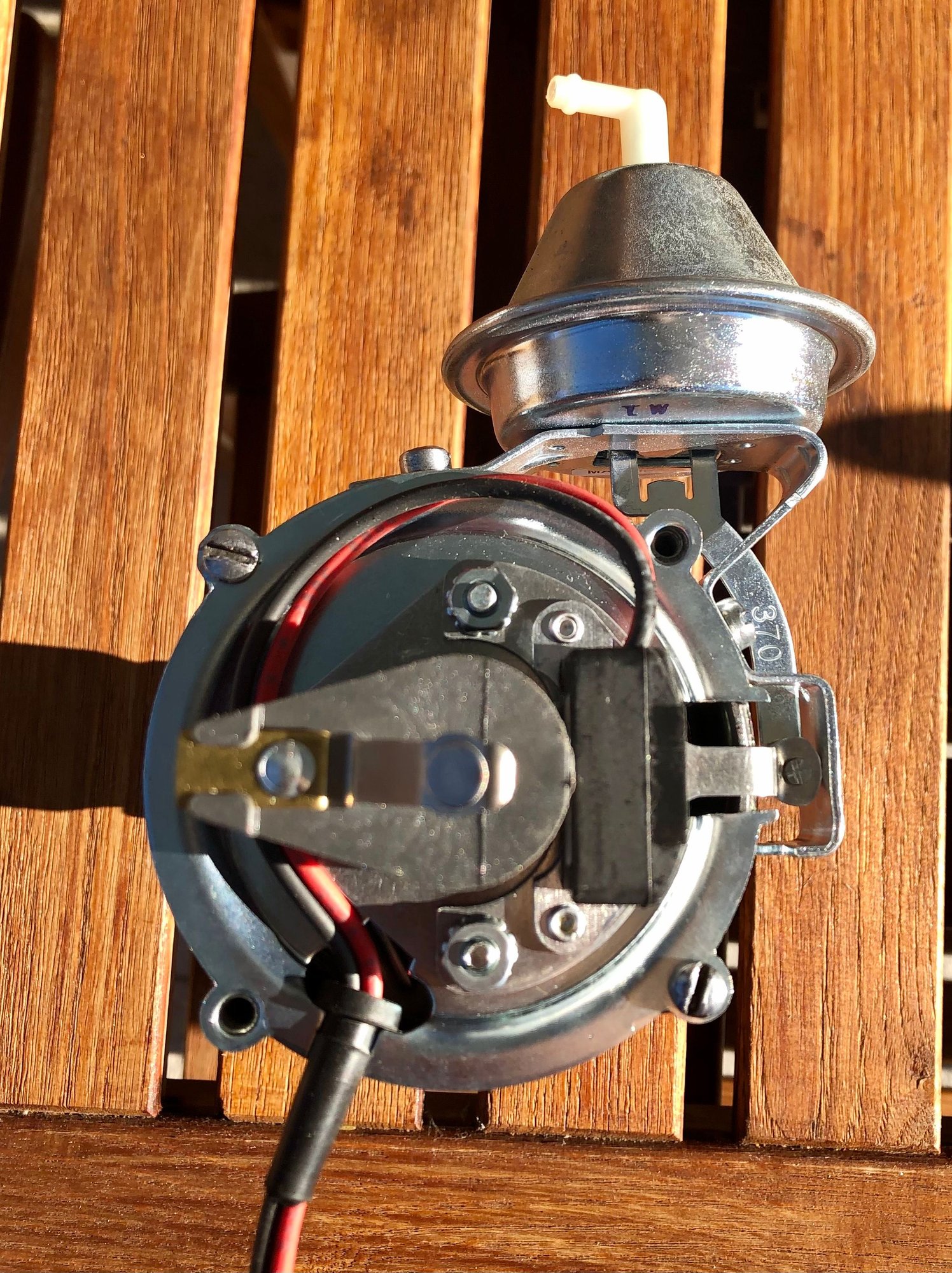

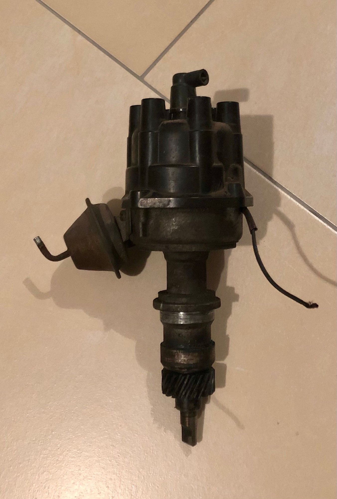

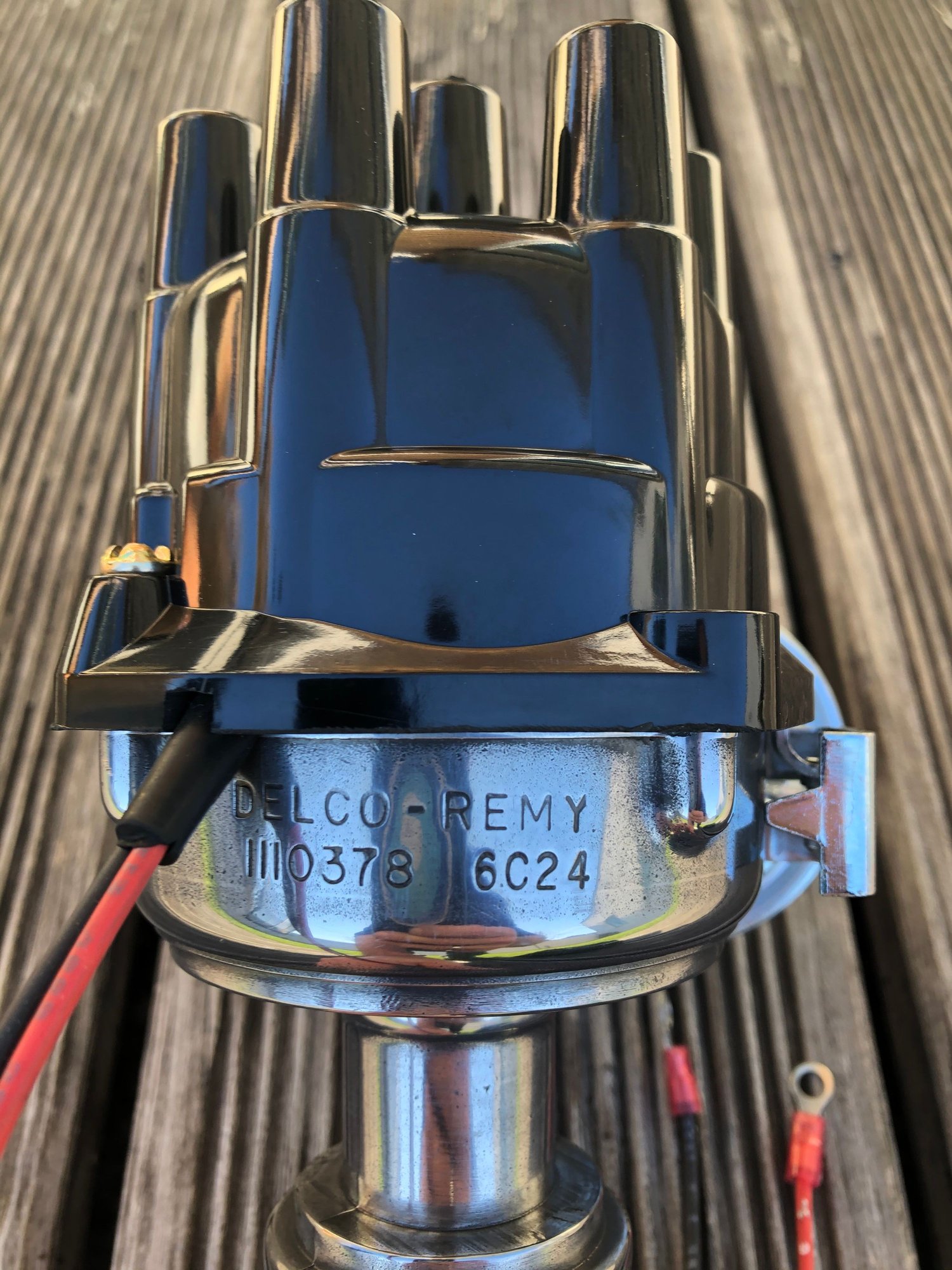

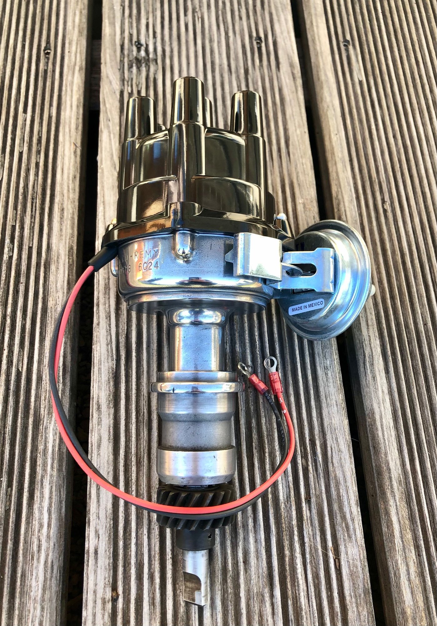

rebuild and converted the distributor from the Pontiac ohc6 engine
before
after
roof is fixed!
very good progress with the body work - roof and doors are paint ready

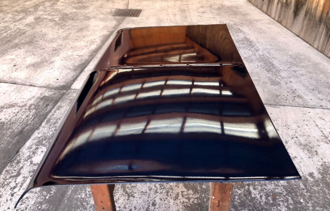

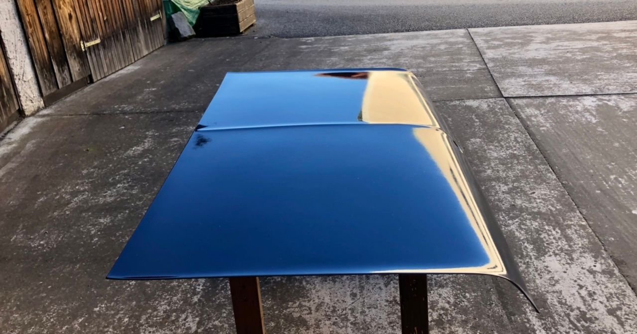

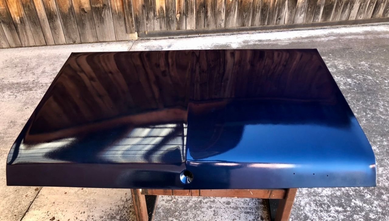

Test painted the trunk lid with 2 results!
1)The color gm pacific blue GA0 is very close to the original paint code 29 eclipse blue and is an awesome color!
And 2) the paintjob must be done by a pro in an professional environment! even I have done it in a clean and heated room, much too much dust enclosed!
Old Feb 14, 2021 | 10:53 AM
  #138
RetroRanger's Avatar
72 Olds CS
Posts: 6,657
I like the color Karl. Any stripes in the plans ?
Old Feb 14, 2021 | 03:47 PM
  #139
Posts: 10,104
Agree great colour. I guess we know why a booth is necessary.

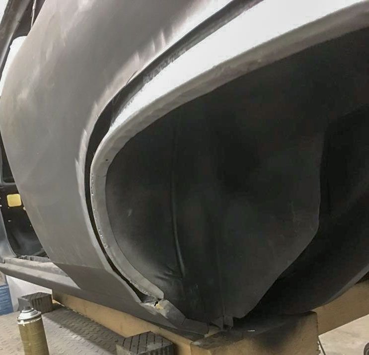

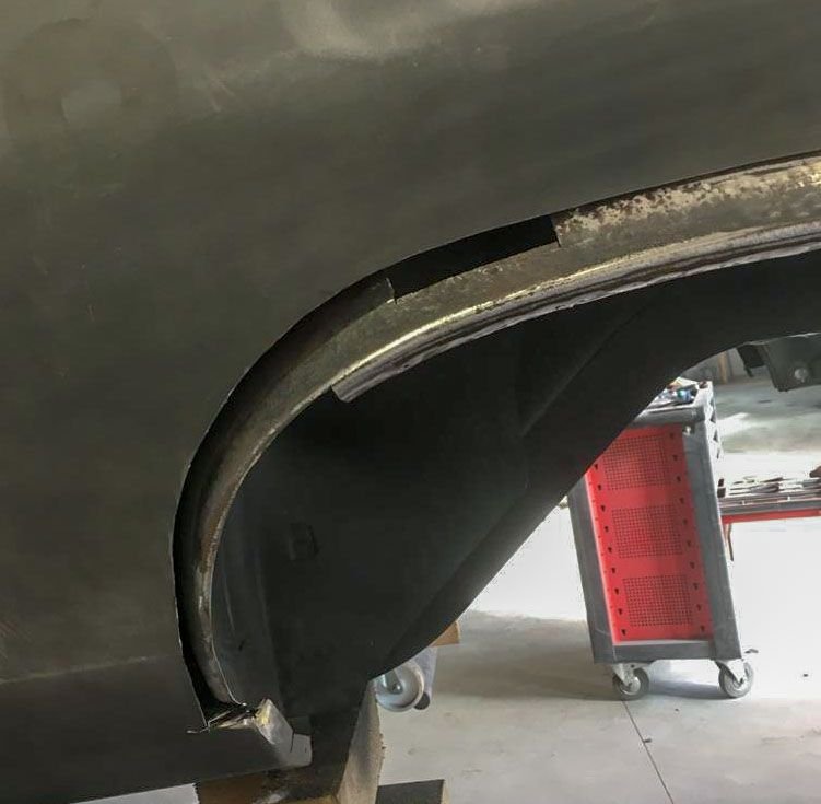

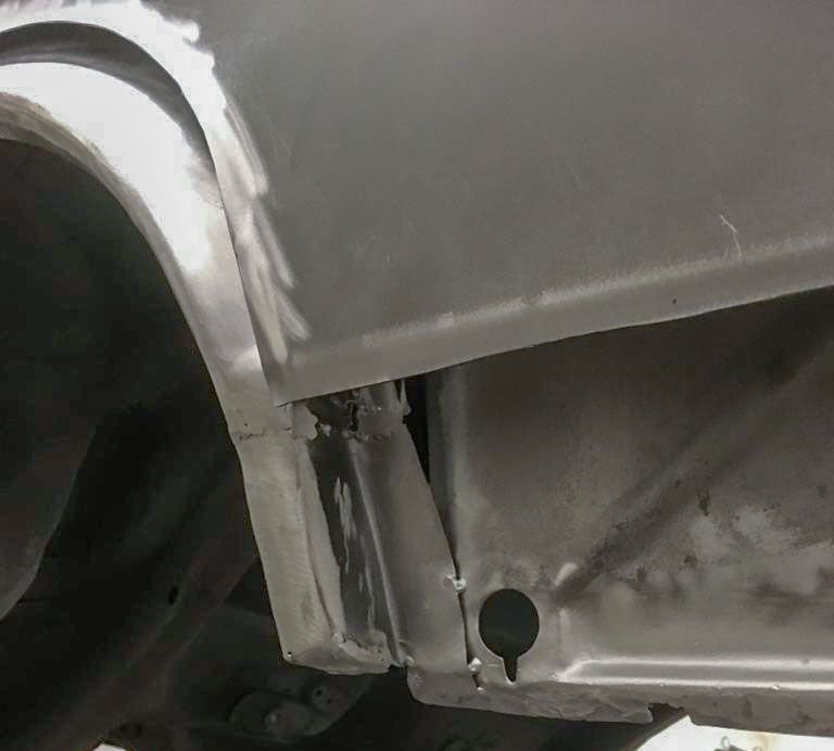

some more body work

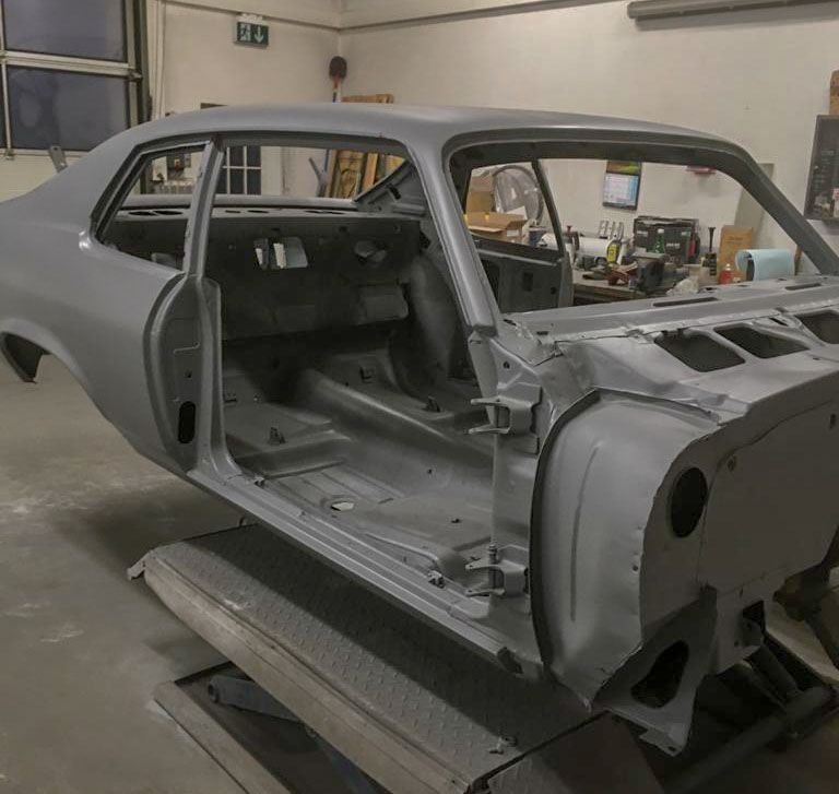

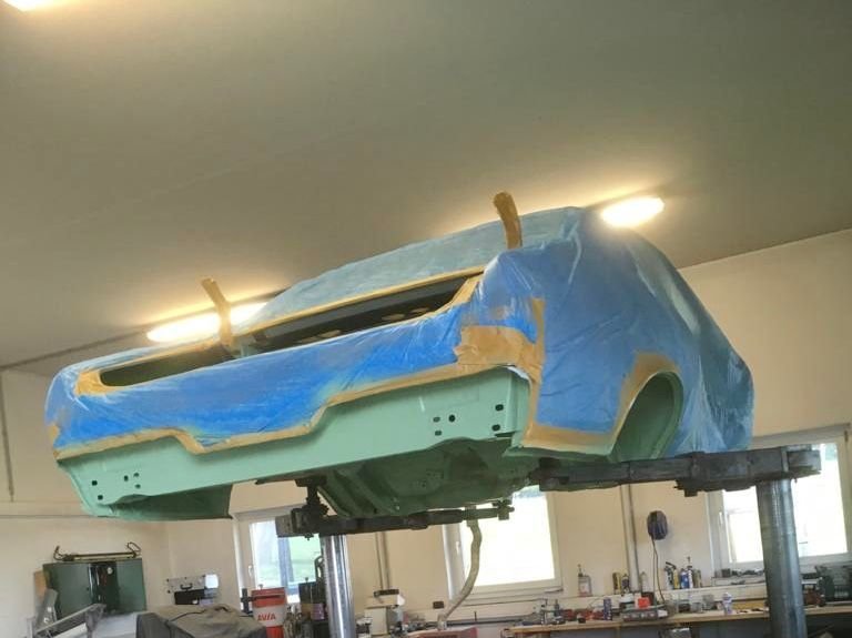

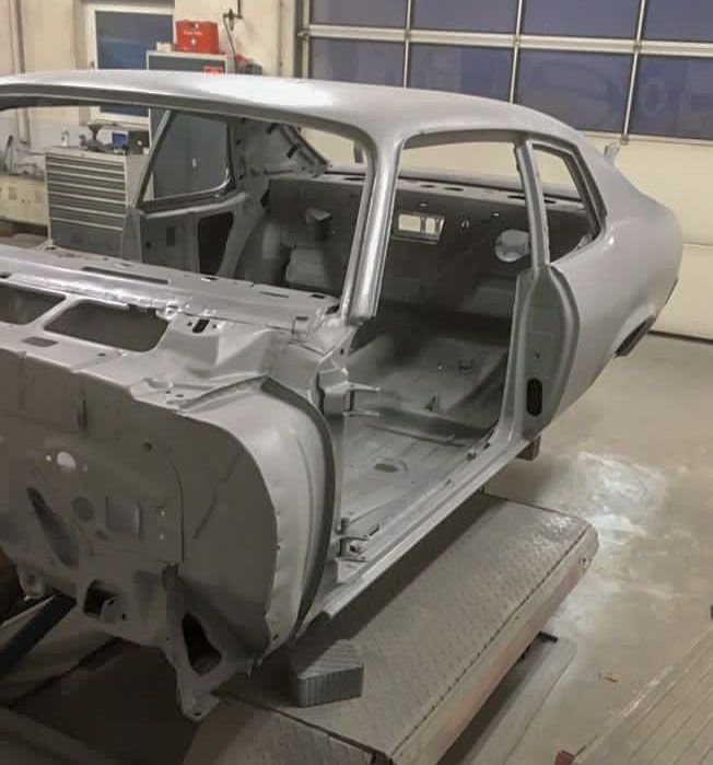

body is paint ready! gorgeous job by my mate Werner in his shop WeSt

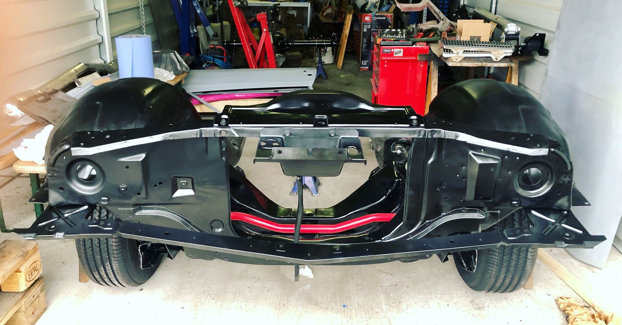

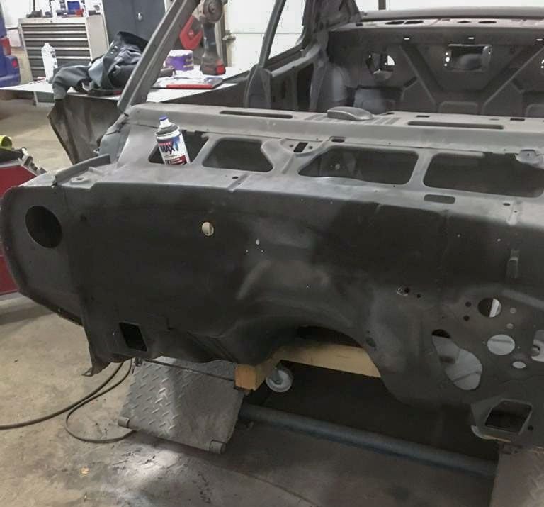

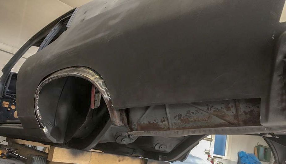

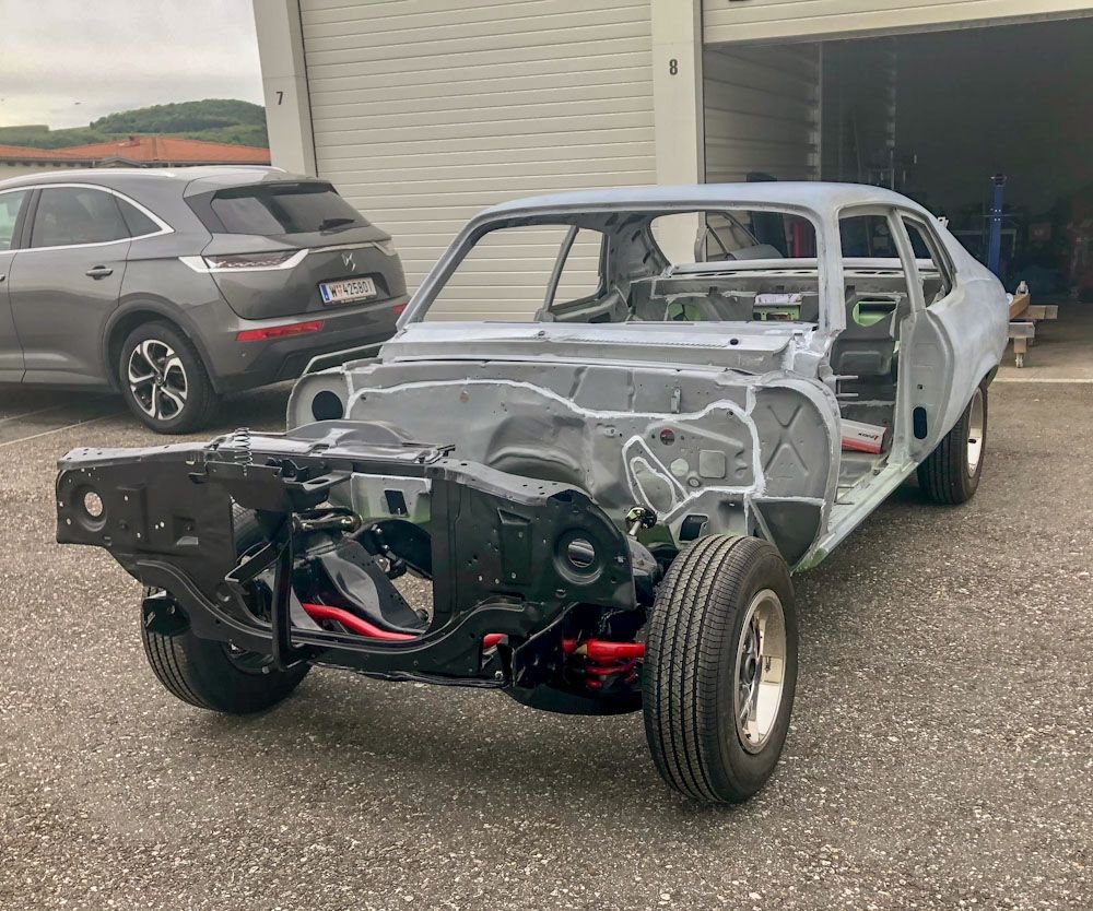

underbody done!

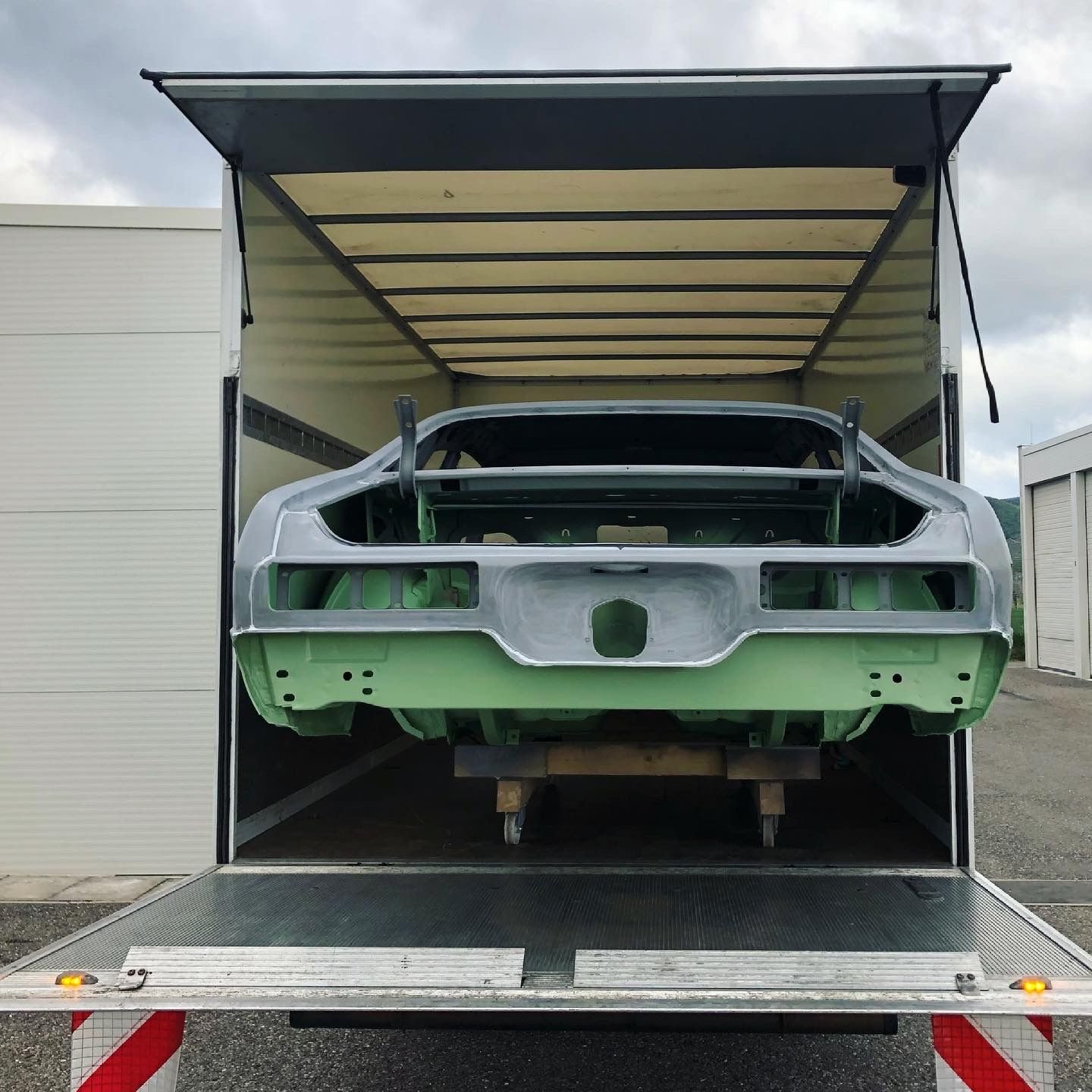

Francis is back home!

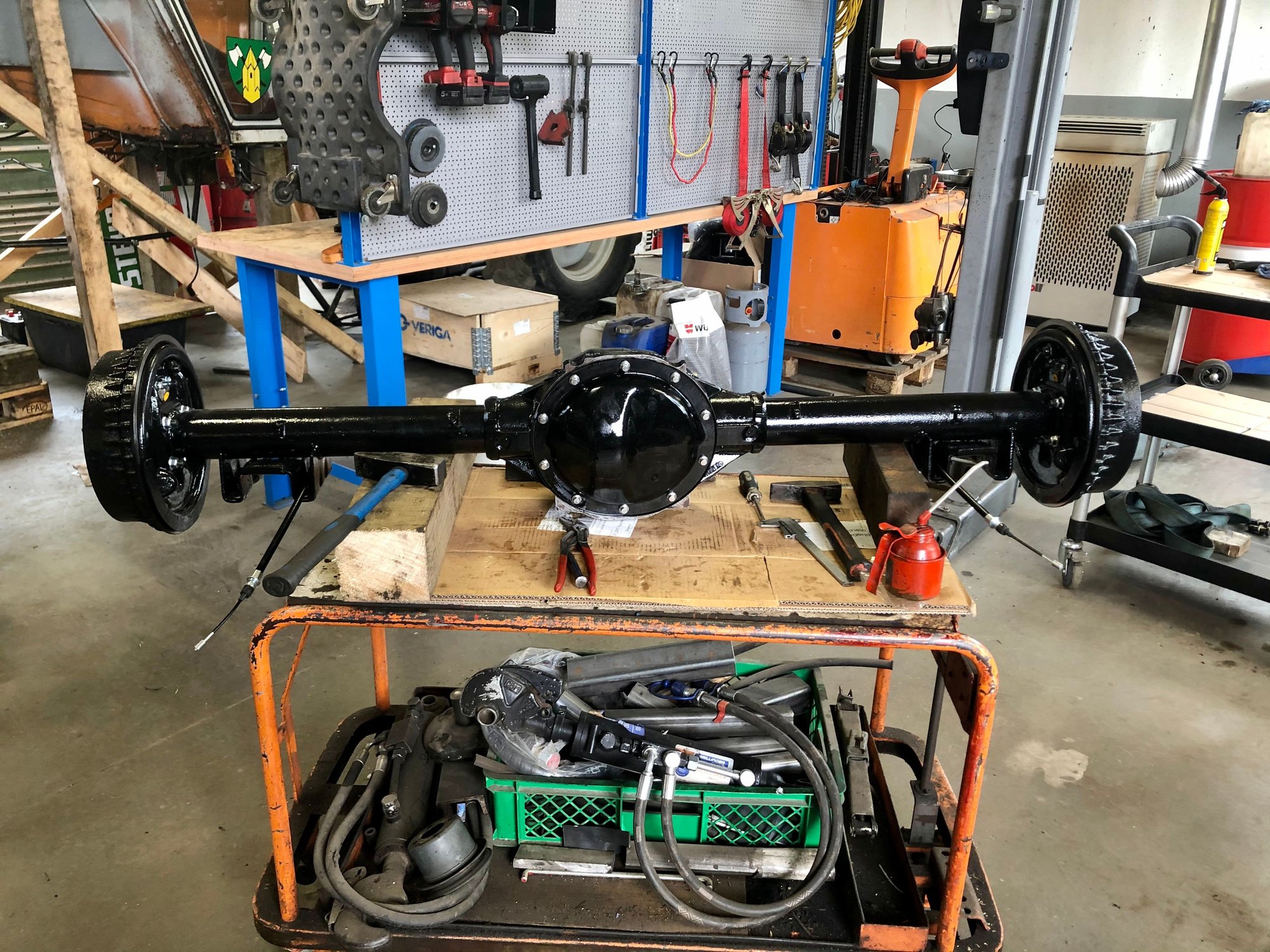

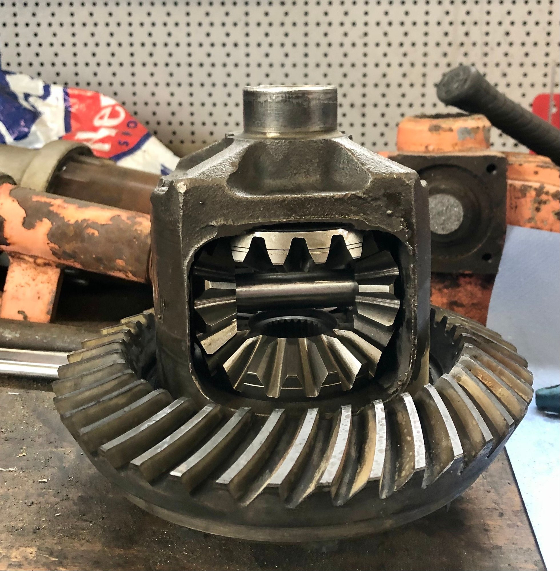

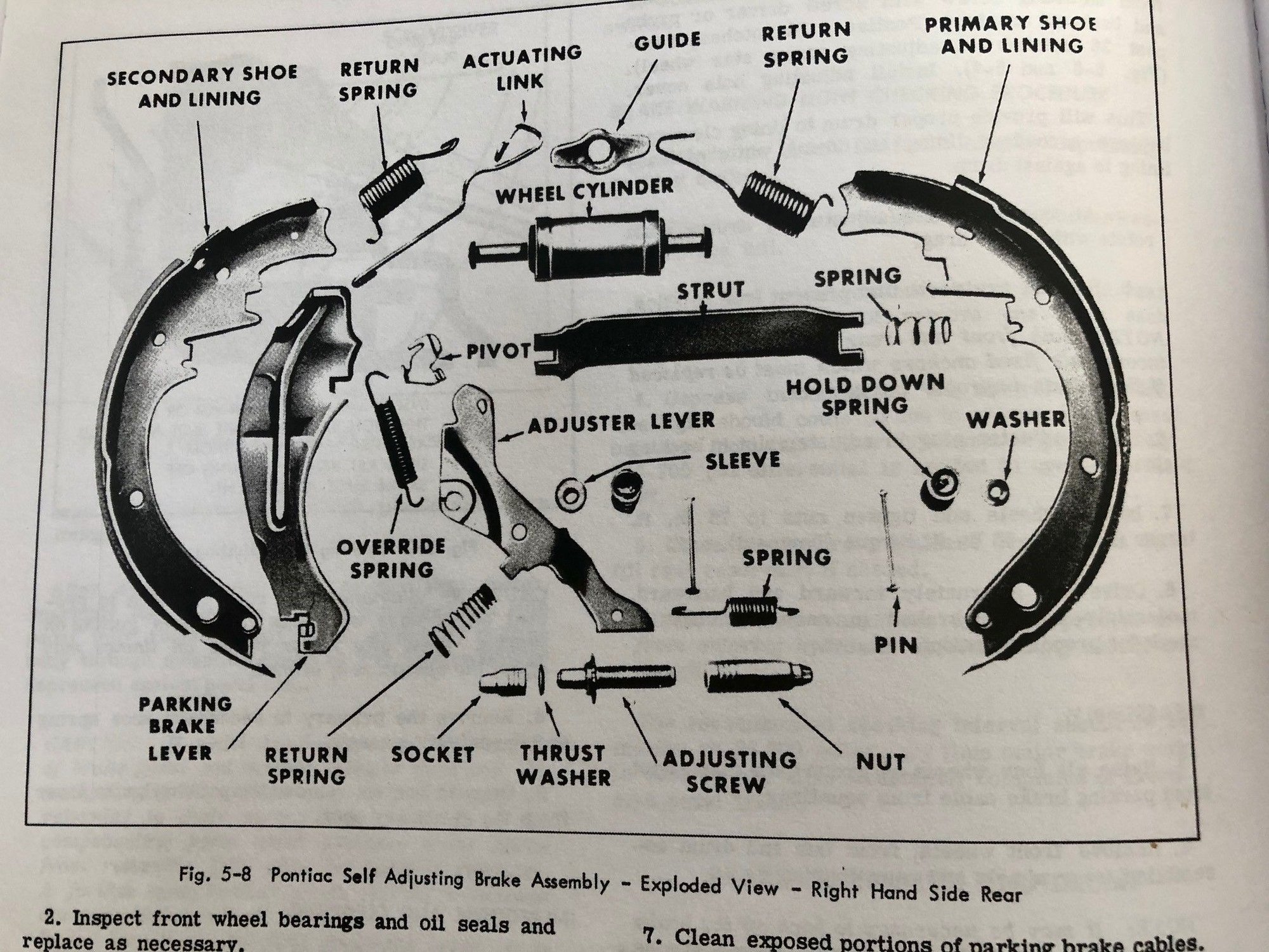

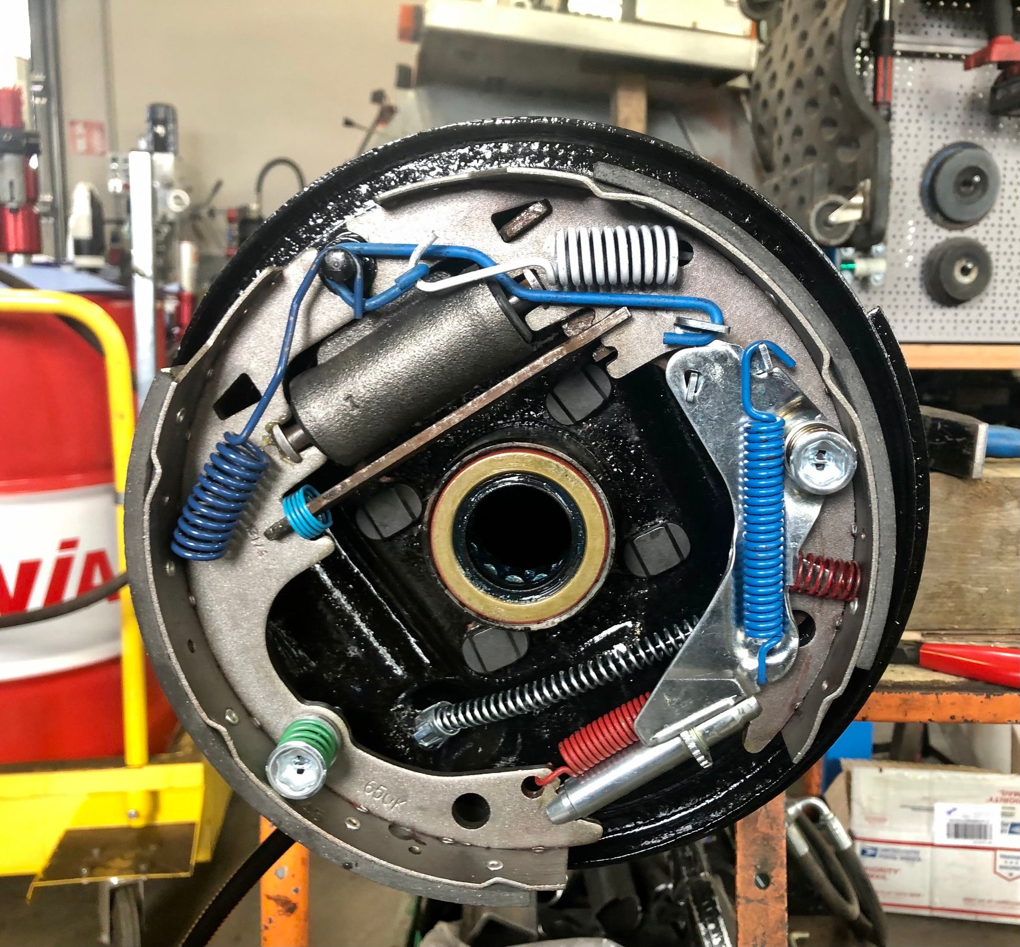

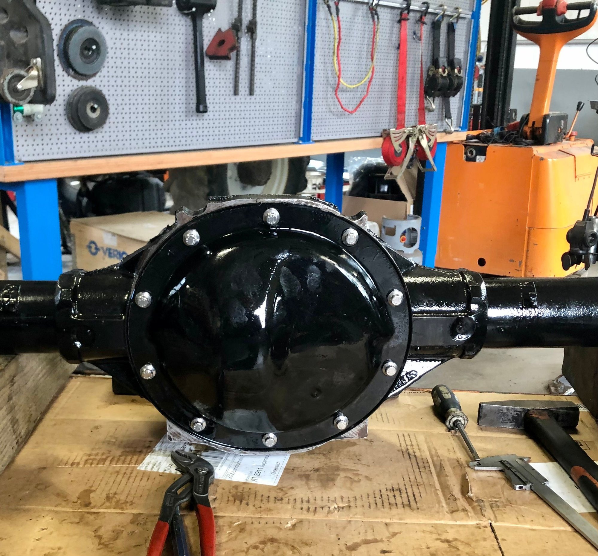

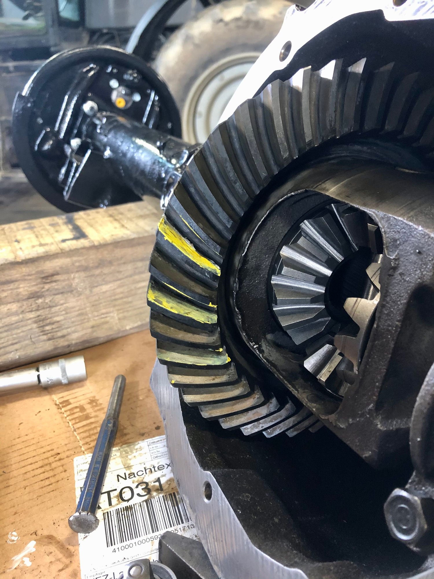

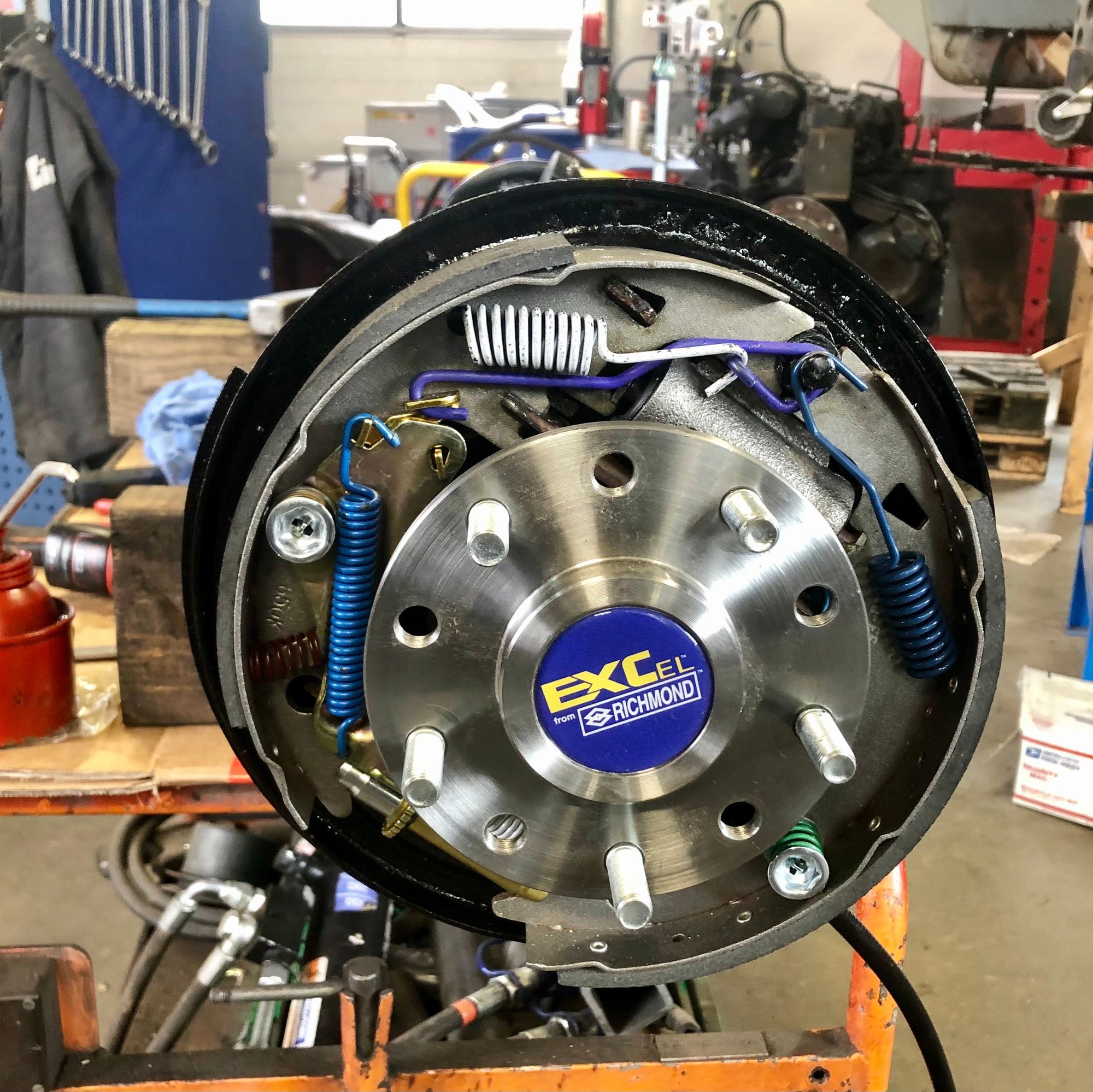

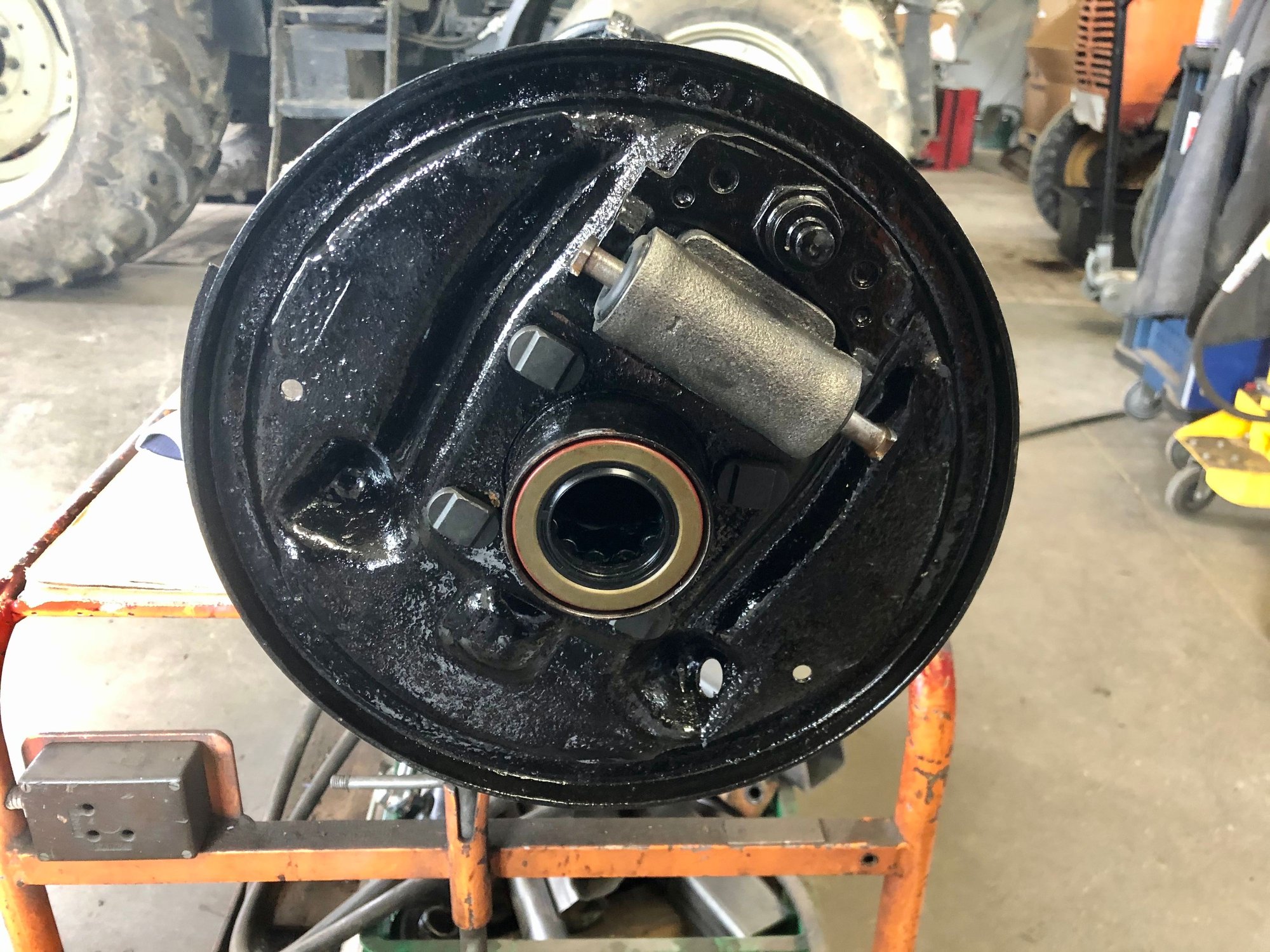

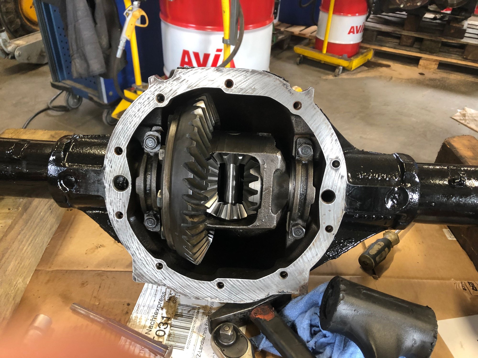

10 bolt rear end rebuild with my brother in his shop! to work with a pro is just fun!

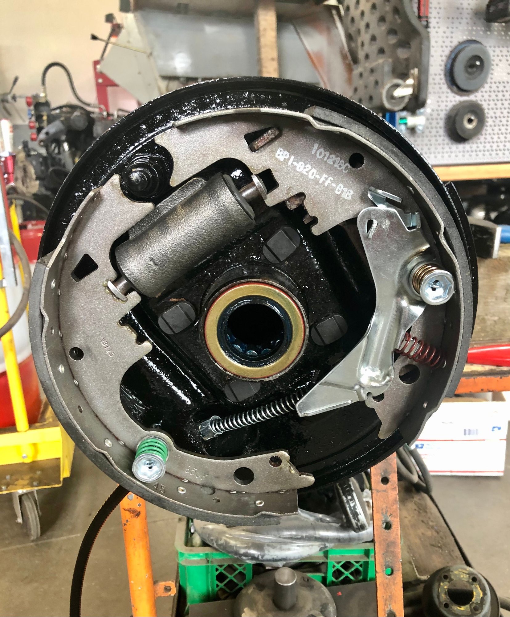

From: Ohio
Great project! Love the OHC motor! If I'm looking at your pics correctly you might have the brake shoes on wrong. The shoe with the shorter lining goes towards the front, the long one towards the back.
Old May 21, 2021 | 03:53 AM
  #157
exotec's Avatar
Olds Omega
Joined: Mar 2019
Posts: 426
Thank you!
according to the service manual the brake shoe with the longer lining should be opposite to the adjuster lever - which would be correct for both sides

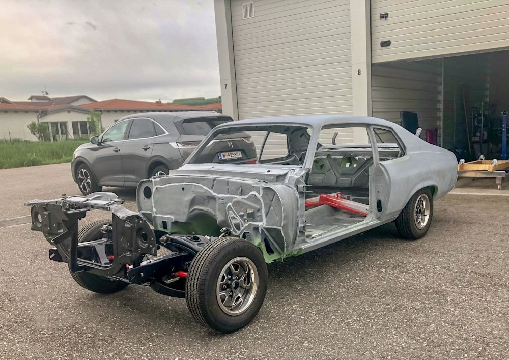

  #158
exotec's Avatar
Olds Omega
Joined: Mar 2019
Posts: 426
still a drafty ride but finally it moved on its own wheels!

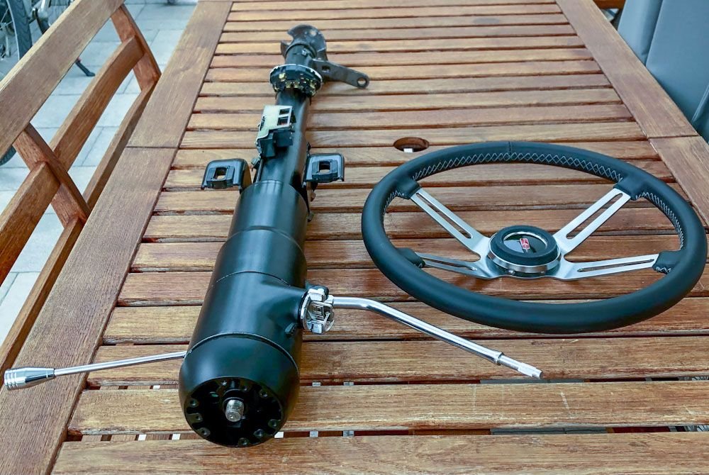

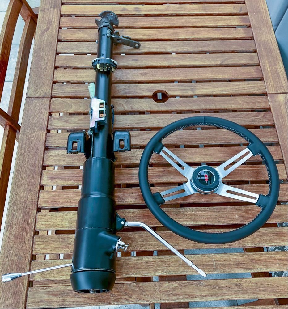

rebuild the steering column
