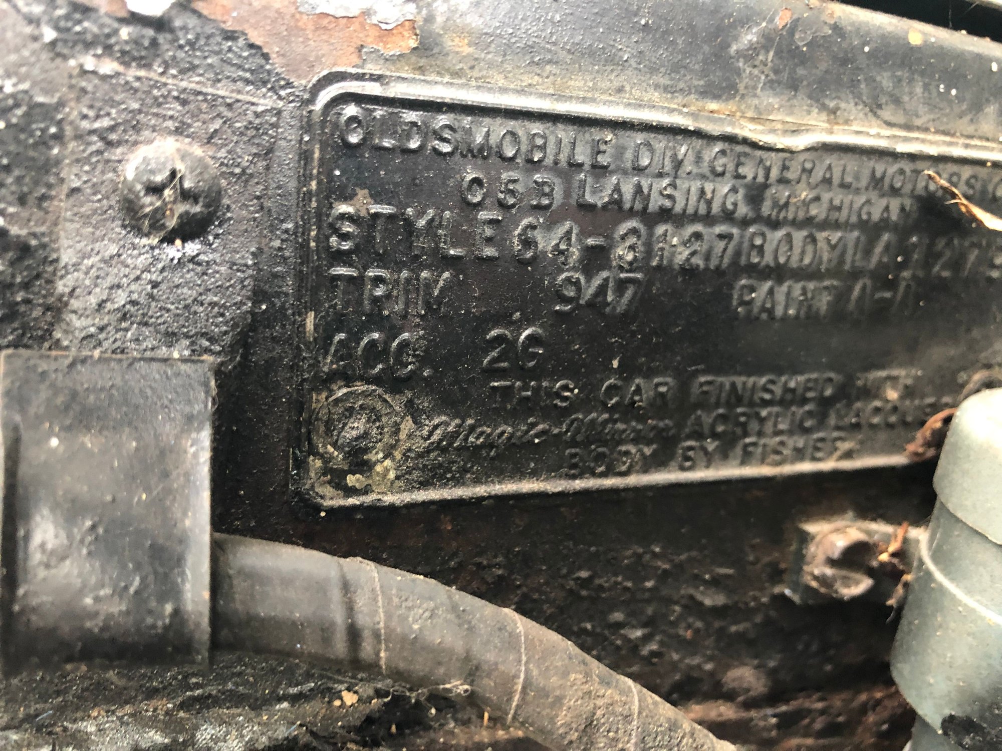

I am new on here and looking to buy my first restoration project. If everything lines up like I think it does this should be a semi rare car. I know it’s a 64 f85 2dr from what the owner believes it’s a deluxe sports coupe. He believes it has a b09 “police pursuit” now he did show me towards the firewall a head code of b2 unfortunately he has not found any build codes. From what I found it is an ebony black car with white vinyl interior. By visual it is a floor counsel shifter car and it has to be a factory tach in that counsel. From people looking At the car he was told it does not have a factory trans but how can I verify option and find a build sheet. I haven’t finalized the purchase yet but really like the car

B-09 would be the 442/Police car. Its not a 442, no 4speed, no dual inlet air cleaner. I am not sure if the Police package could be had without being a 442. Whatever he is telling you about a head stamping smells fishy.

B09 in 1964 was the 442 package. It would have a 2L on the cowl tag for the 4 speed trans. That cat doesn’t have it so it’s not a “police pursuit” B09.

As for your particular car, Style Code 3127 is an F-85 Deluxe V6 Sport Coupe, however there have been documented cases where the 3127 style code was used on a real 1964 442. We'd need to VIN to tell if this was originally a V6 or V8 car. Obviously a V6 car could not be a real 442. More to the point, your ACC codes only show 2G, which is the code for the CONSOLE brackets (a COUNSEL is a lawyer...). If this were a real B09 car, it would have ACC code 2L for the cutout for the four speed shifter, as required on all 1964 442. Since that is not here, it's not a B09 car. And FYI, RPO B09 was the option code for the 1964 442. The police packages were either B01 City Cruiser Equipment or B07 Highway Patrol Equipment. The difference between the two is that B07 came with the rear sway bar. Neither package was available with the 310 HP motor that was central to the B09 package. In fact, the B09 442 package was essentially the B07 package with a hotter cam and a mandatory 4spd. Since your car doesn't have a 4spd, it's not a B09.

You've got a Cutlass Sport Coupe. It's well documented that the VIN and Fisher Body cowl tags didn't match on the style code in a handful of times. This is one of those times. The 1968-69 442s are another. The VIN takes precedence, even though the cowl tag here says it's an F-85 Deluxe and not a Cutlass.
