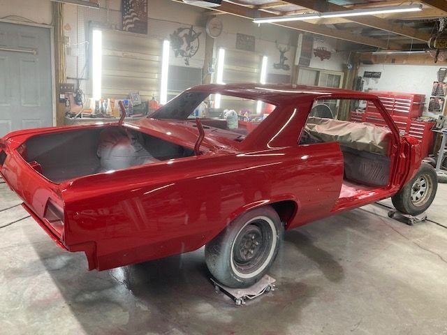

Here is some picture of the finished body that will be swapped over in the coming weeks. I have red and black slightly custom interior (mixture of 64 and 65) already finished as well.

That red really pops, looks great!
