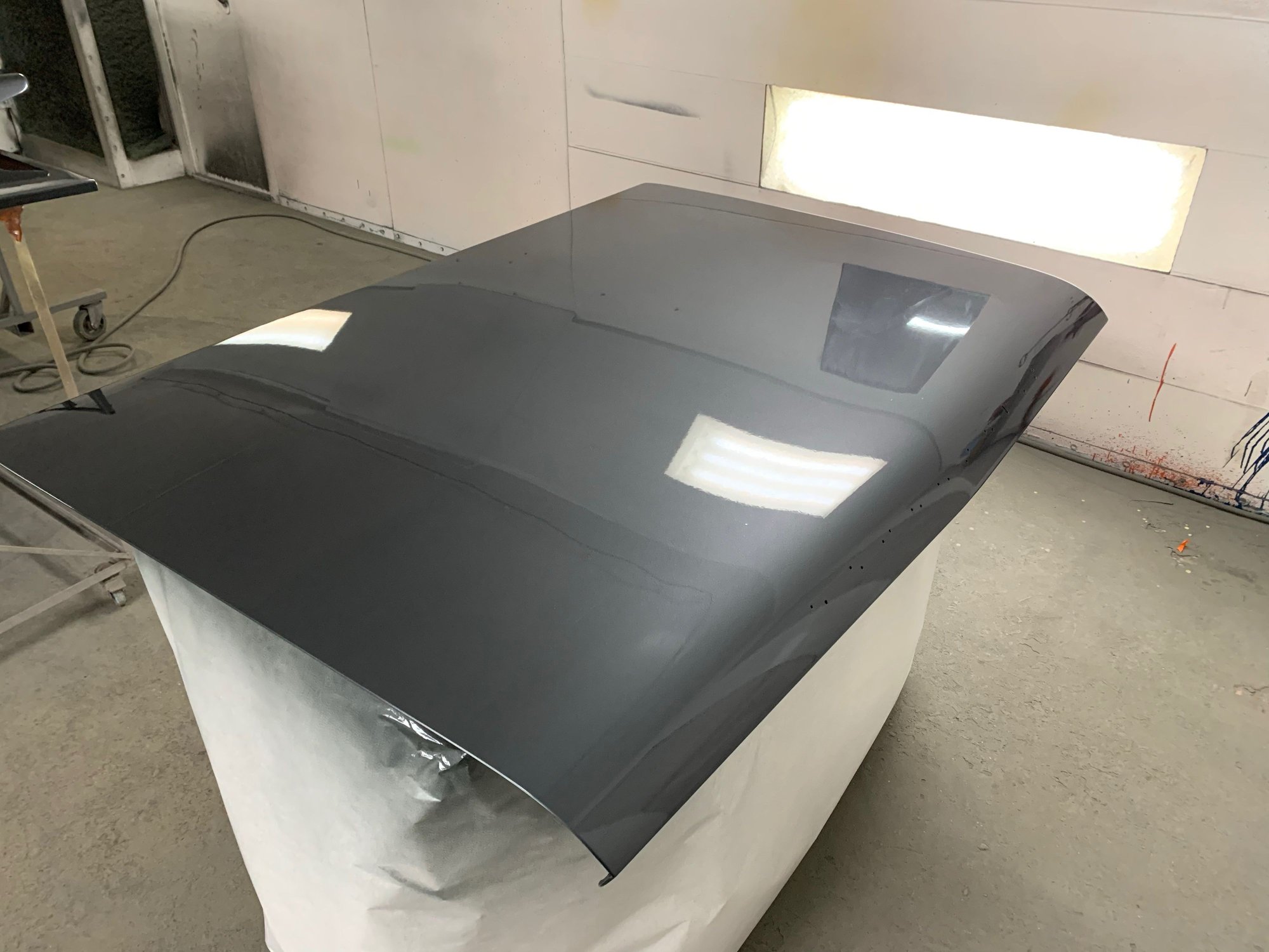

1. The roof was rotten. I found a man in AL that had a 65’ Cutlass that parted out his inventory so we used a Sawzall to cut the roof off and that’s what we used for our new roof. Worked great and you’d never know the difference!

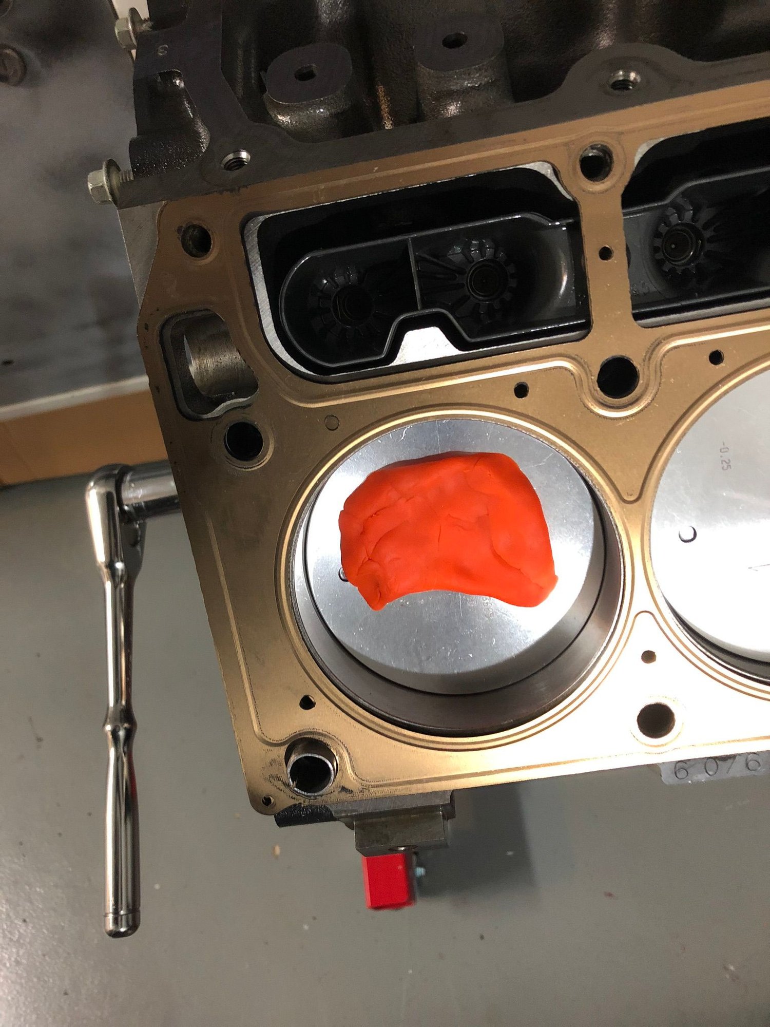

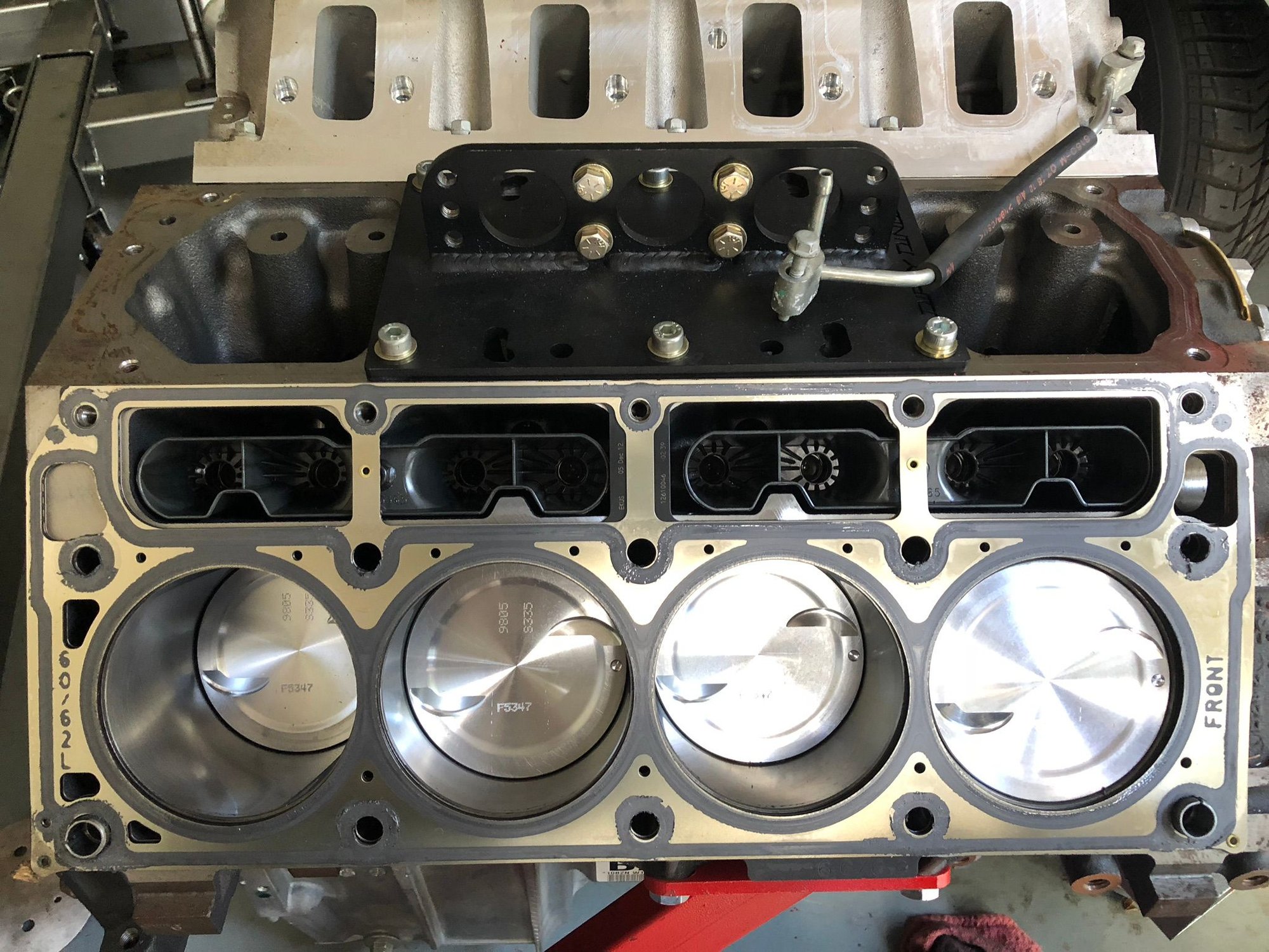

I did not like the low compression of the L96 (9:6:1), so we removed the dish pistons and replaced them with some Mahle flat tops. We also installed a pair of .040” BTR Head Gaskets. Compression is right around 10:6:1. Below is a link to my review of the Mahle Pistons.
https://ls1tech.com/forums/generatio...n-iv-6-0l.html

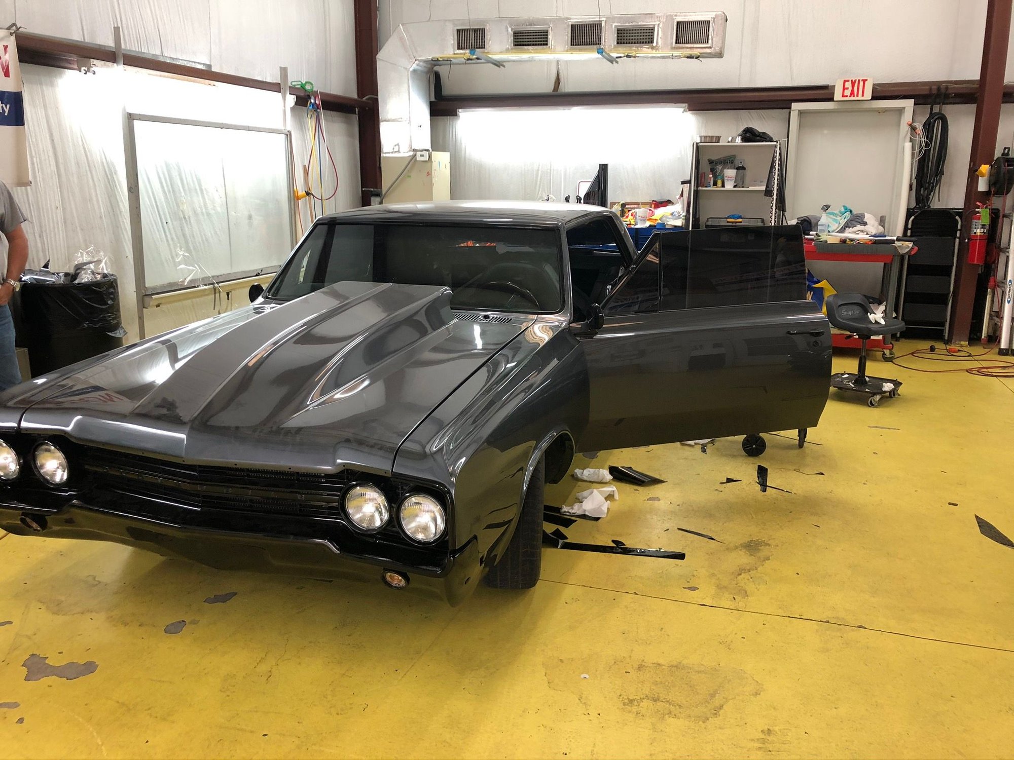

Just a side shot
Body is at Danny's Custom Creation and now its time for the wife, our 2 kids and I to get to work removing the old suspension.

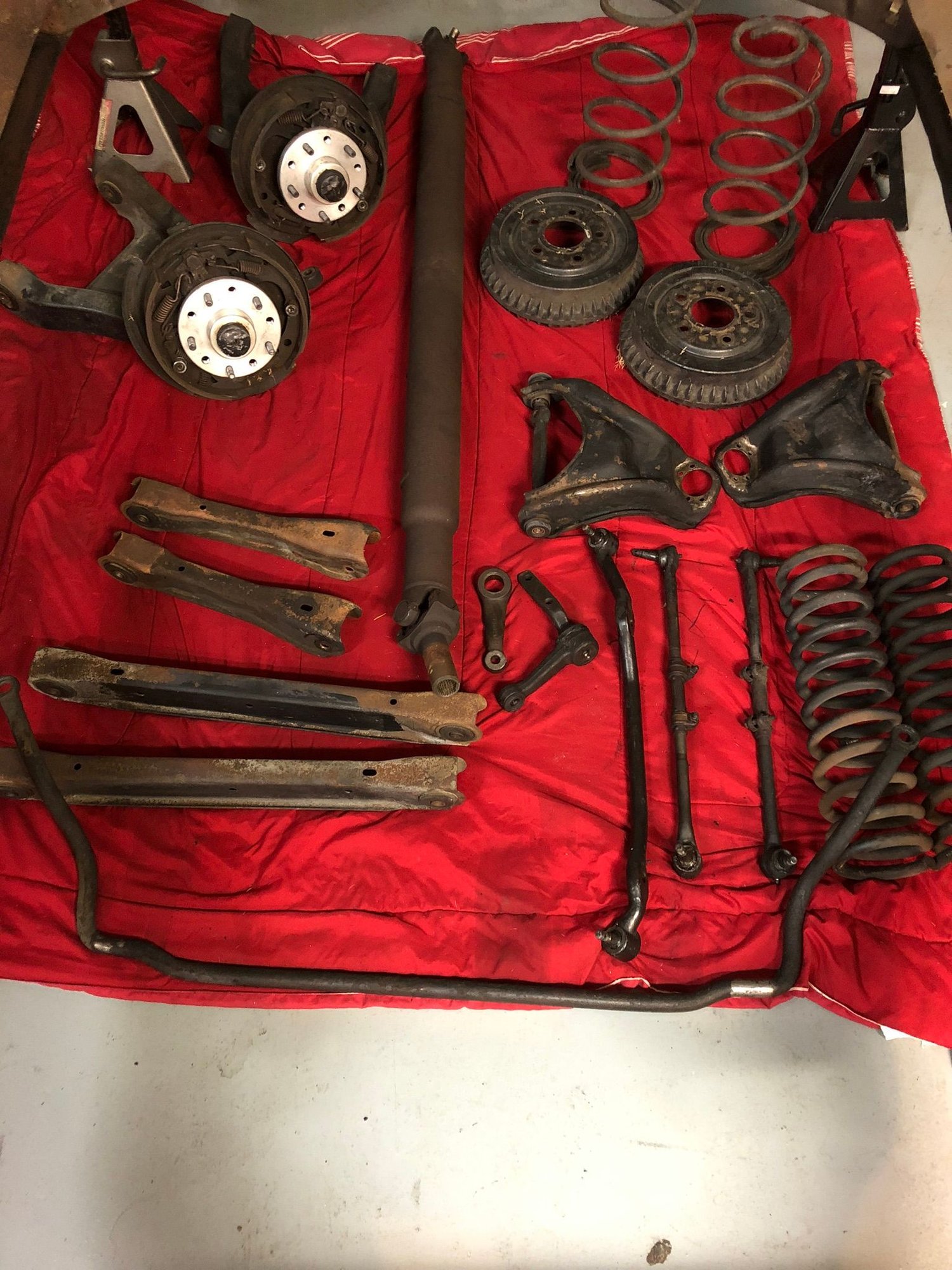

Old suspension is off

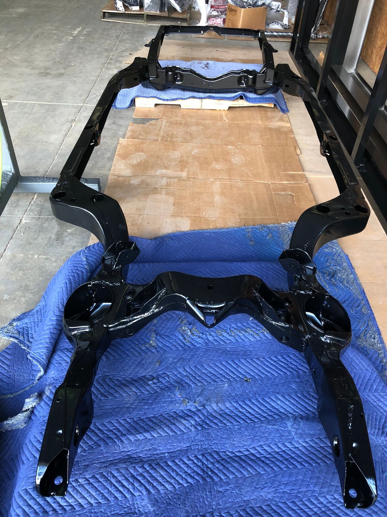

Time for the frame to get powder coated gloss black.

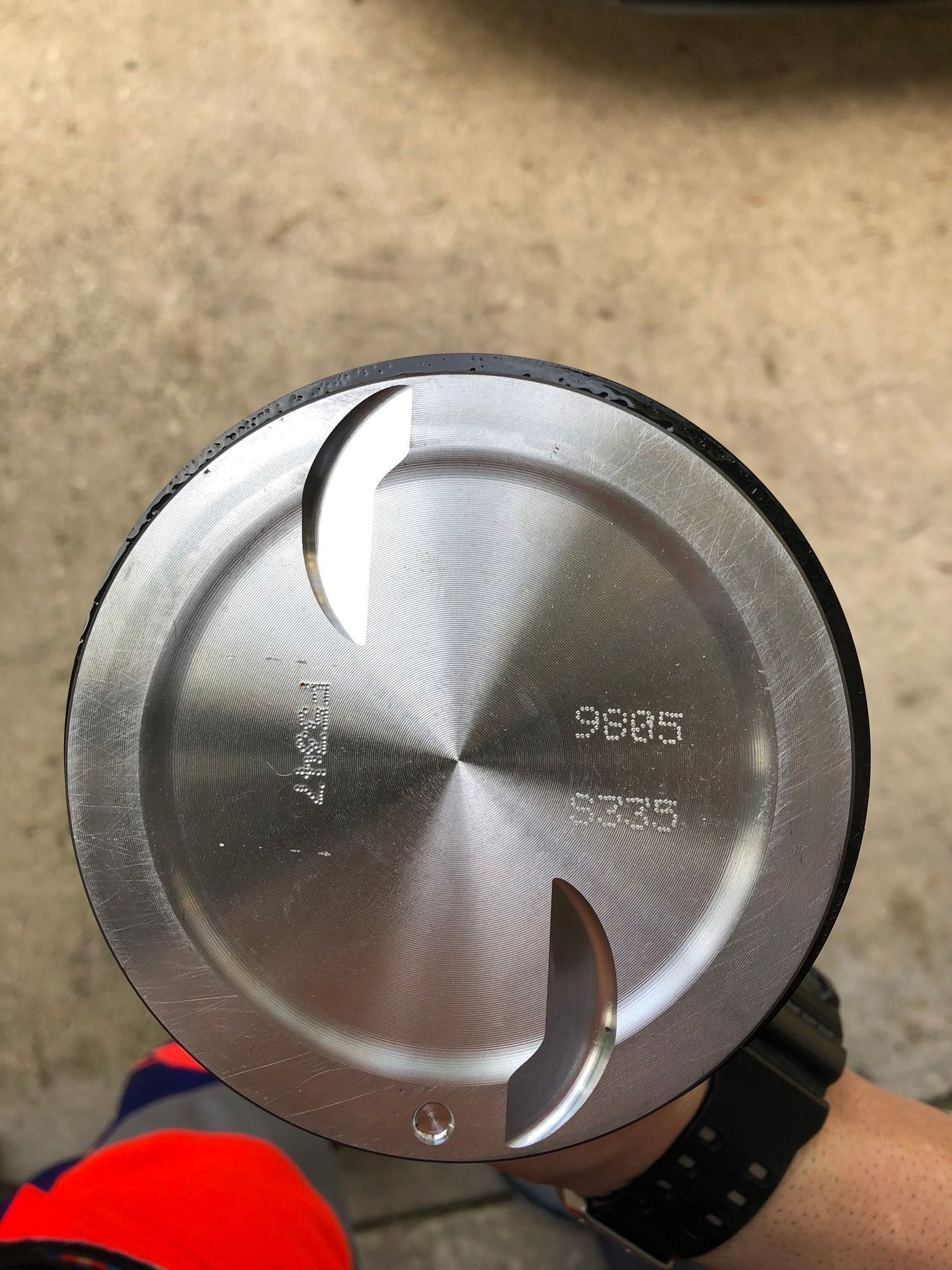

Dish pistons with valve reliefs. I sold these to buy the flat tops.

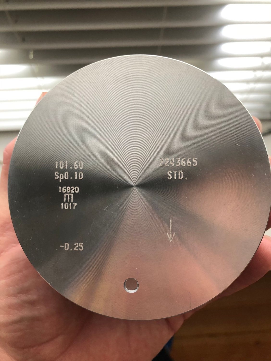

New Mahle Flat Top pistons. Good quality. My next build I will probably use the Summit Brand.

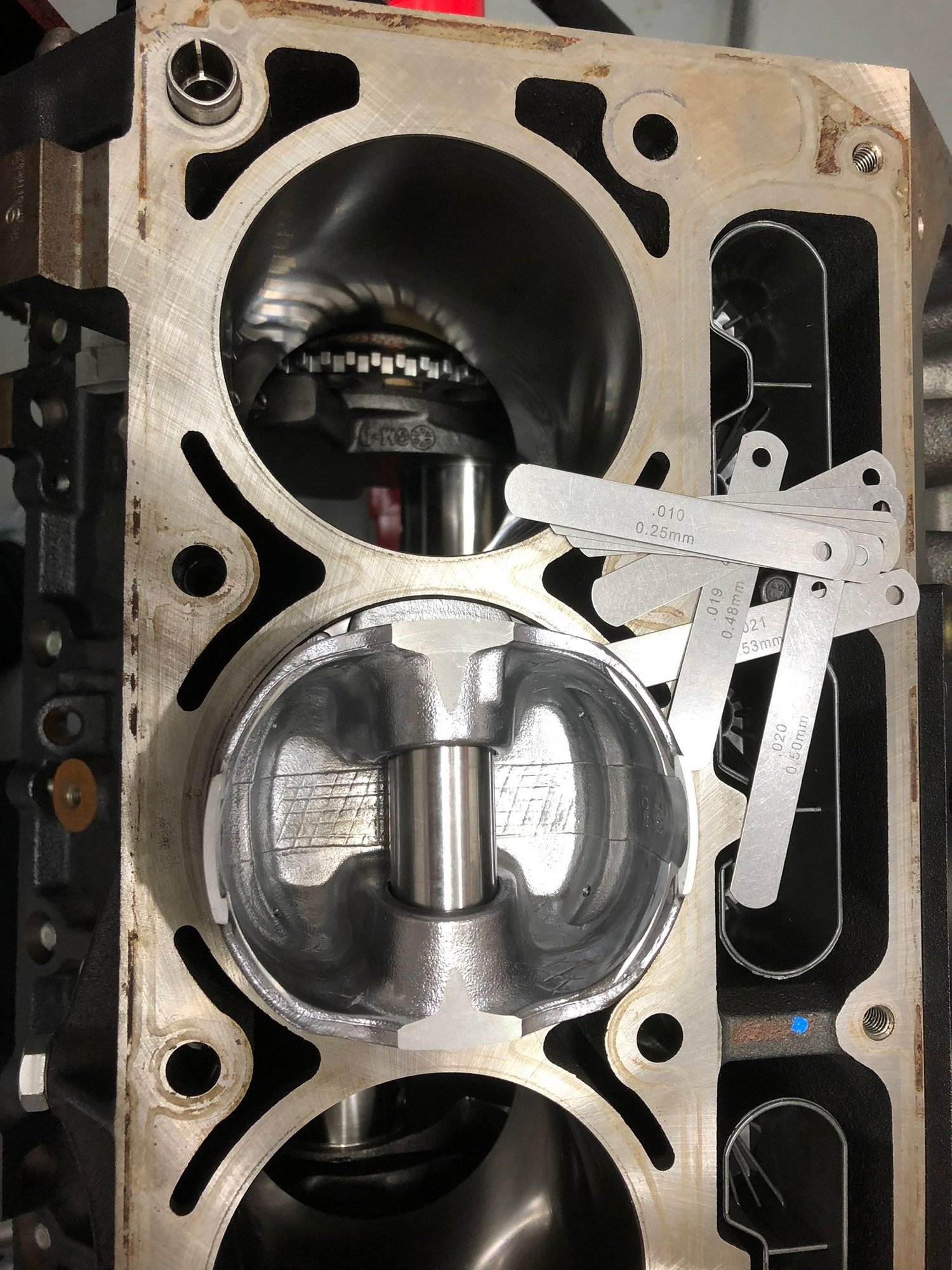

Measuring ring gap. Very time consuming

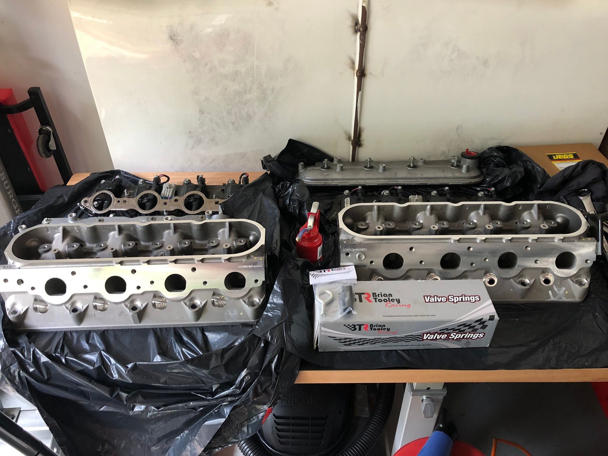

Removing the LS3 (823) Heads
Installing .660" Lift BTR Platinum LS Spring Kit; Titanium Ret., .505" ID .060" Thick Loc., Brown/Black Seals, 1 x BTR Chromoly One Piece Pushrods; 7.400" Long, 5/16" Diameter, .080"

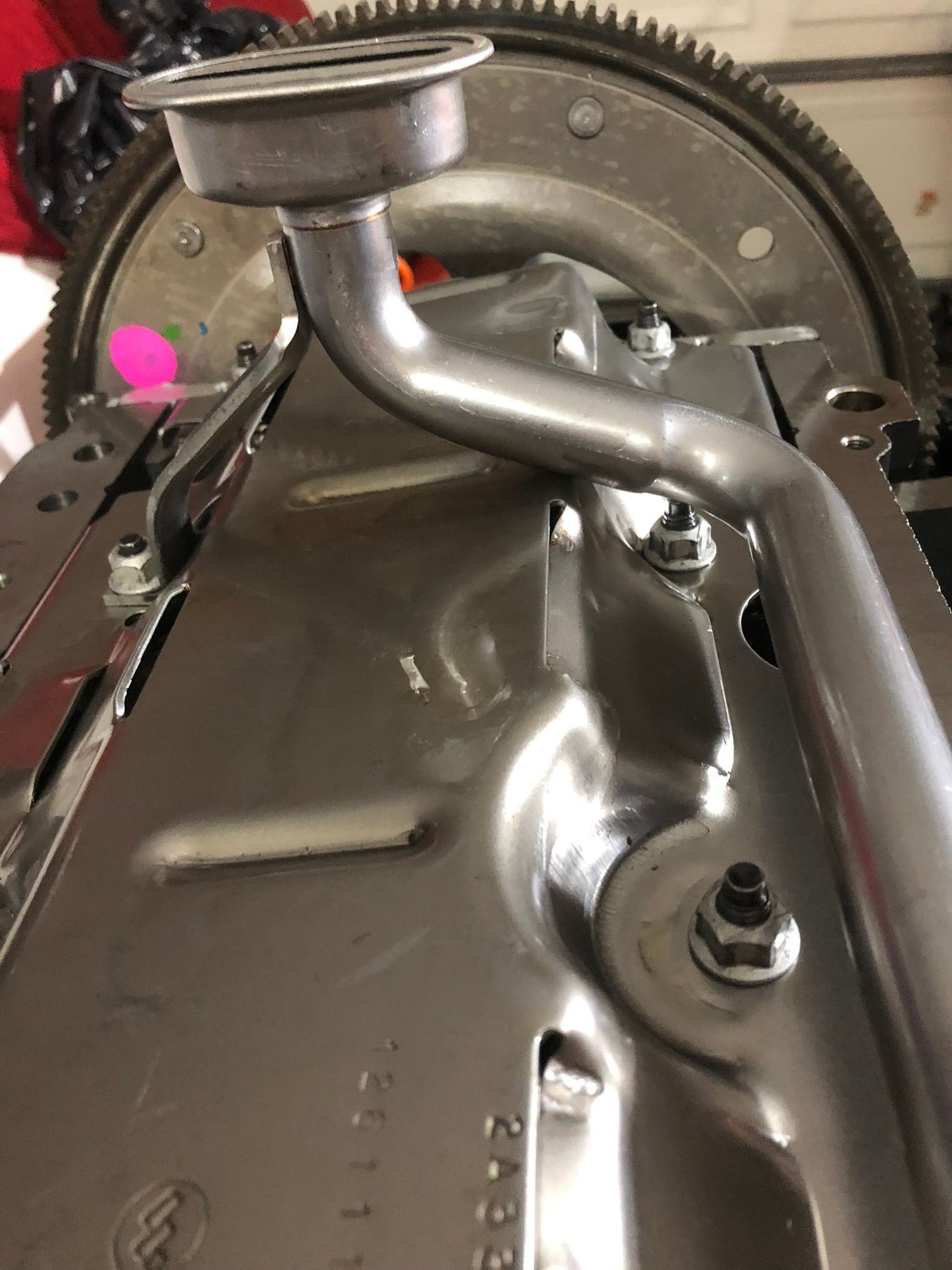

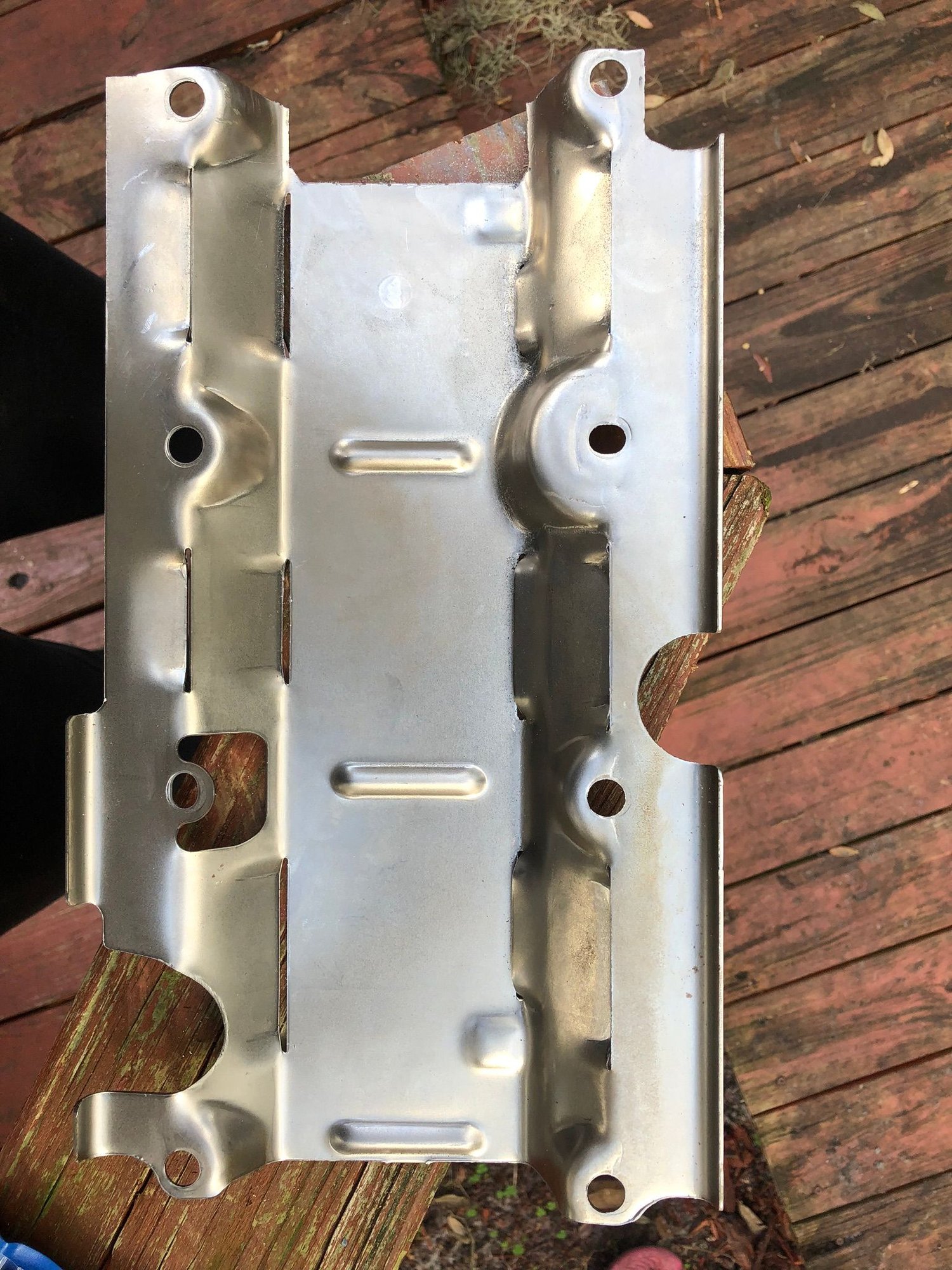

Making modifications for the oil pump pickup tube to fit along with the Holley 302-3 Oil Pan.
Modification complete
Checking PTV Clearance

Frame is back from powder coating.

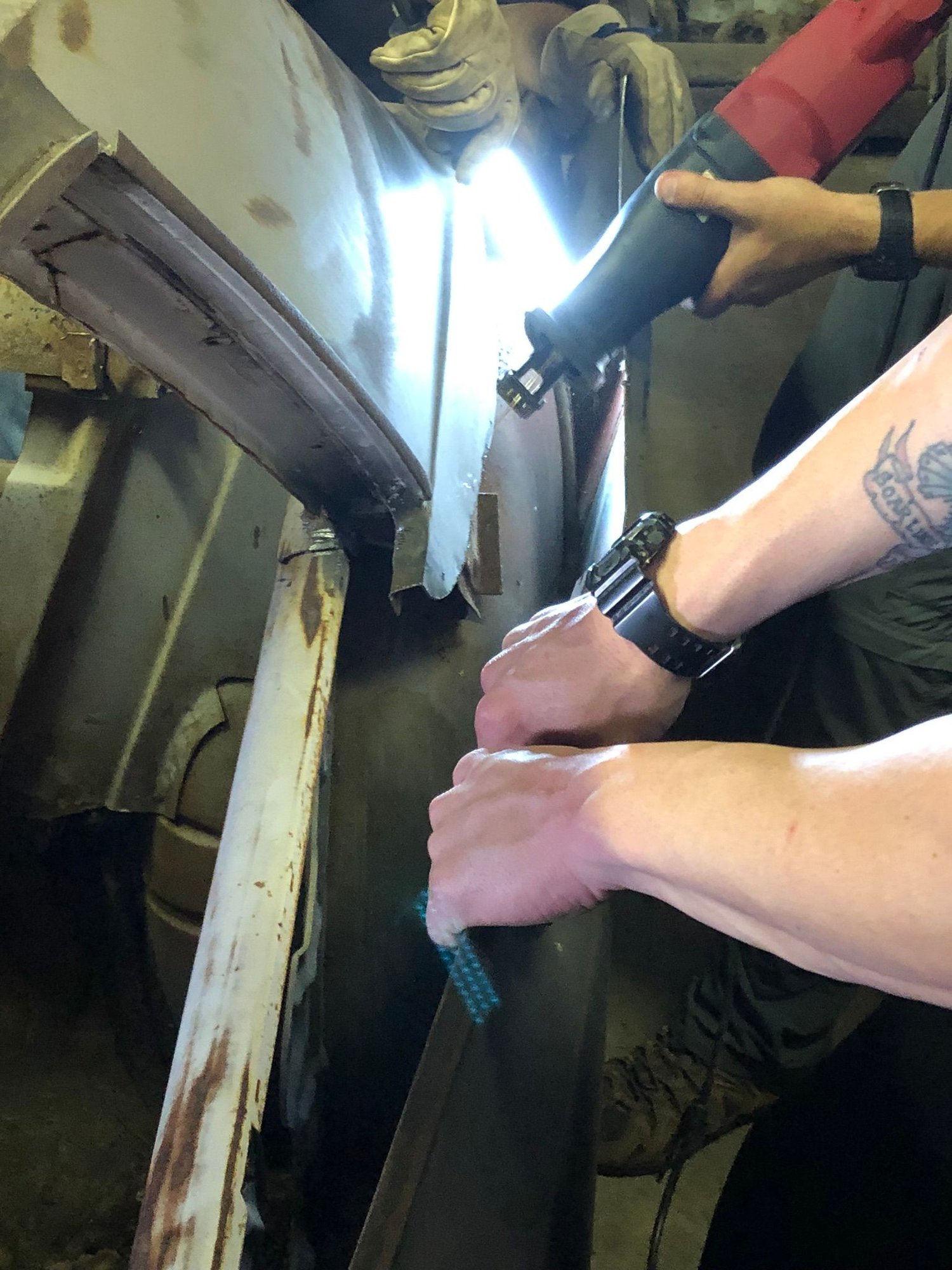

Using a sawzall to cut a roof off an 1965 Cutlass to use on our car due to it being rotten.

Trunk Lid

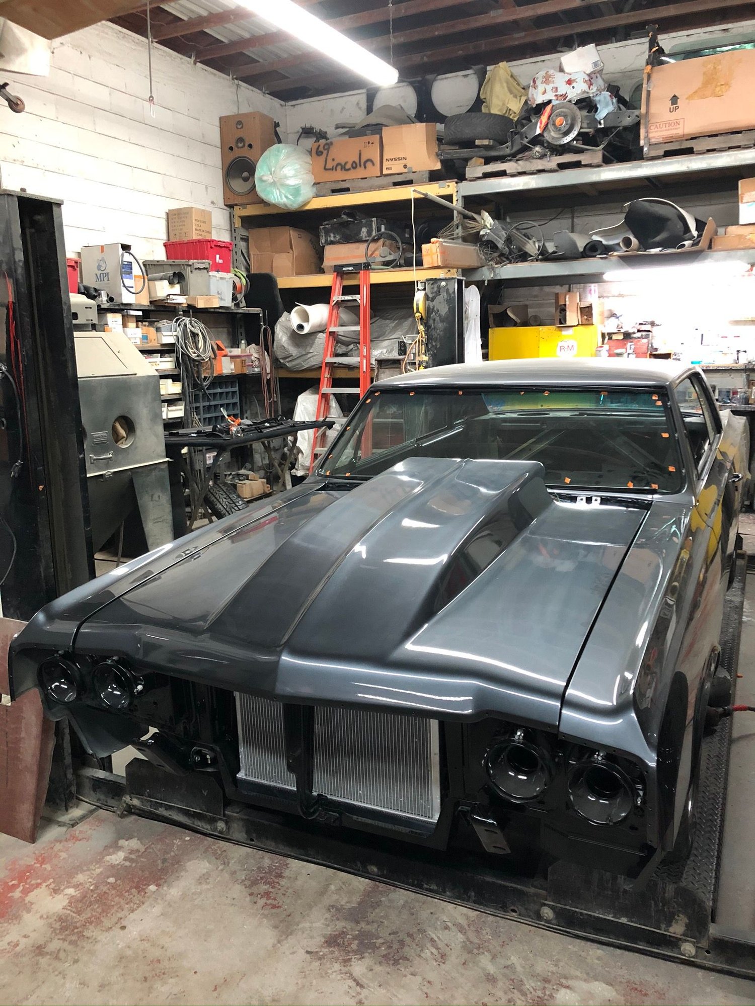

VFN Cowl Hood

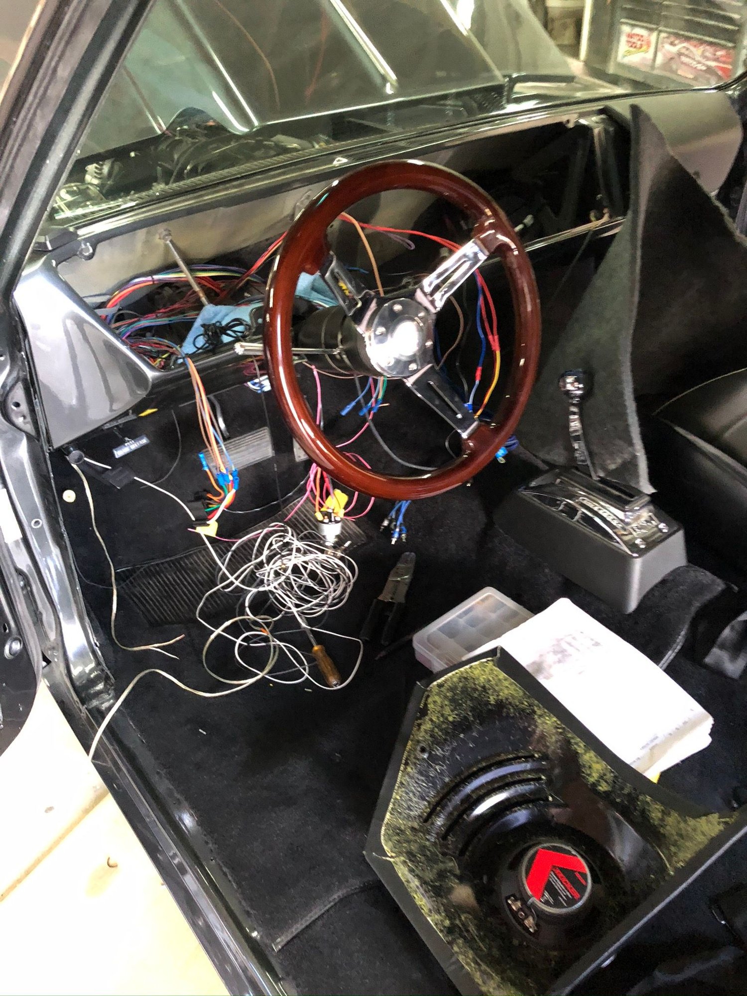

Let's start working on the miles of wiring.
More wiring

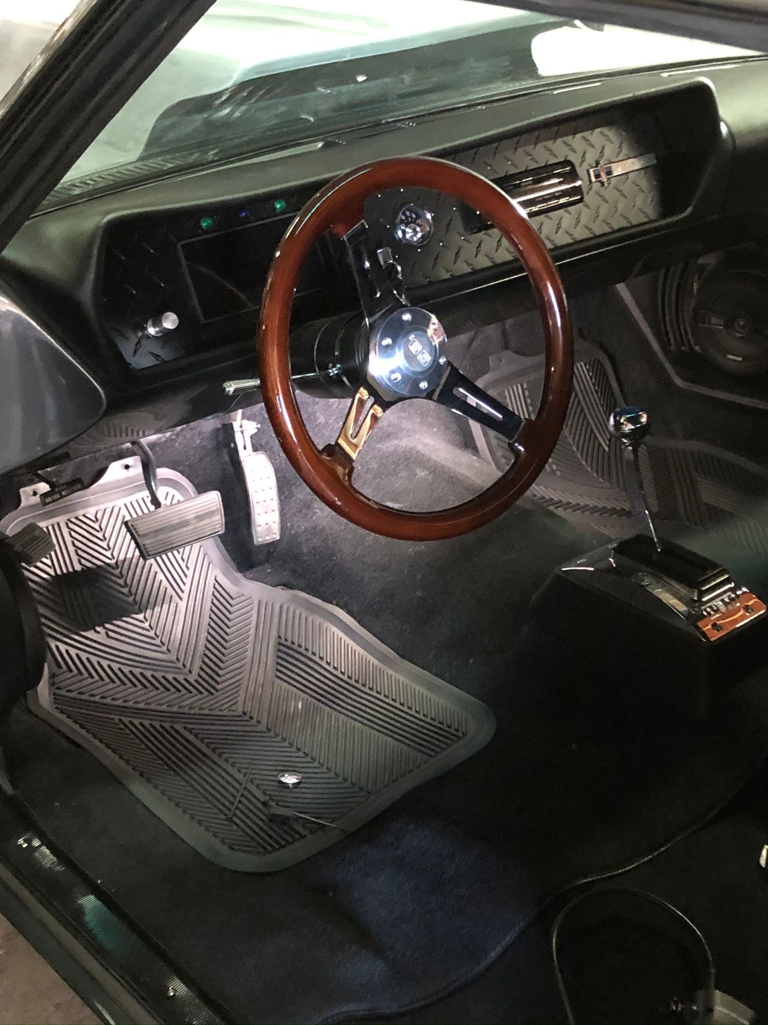

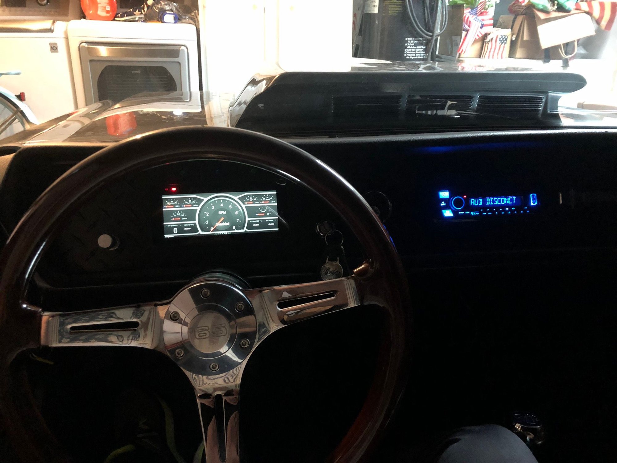

Making the dash.
The dash with the Holley 6.86 Pro Dash
Forever Sharp Steering Wheel. Engraved 65" in the middle
Hood looks real good.

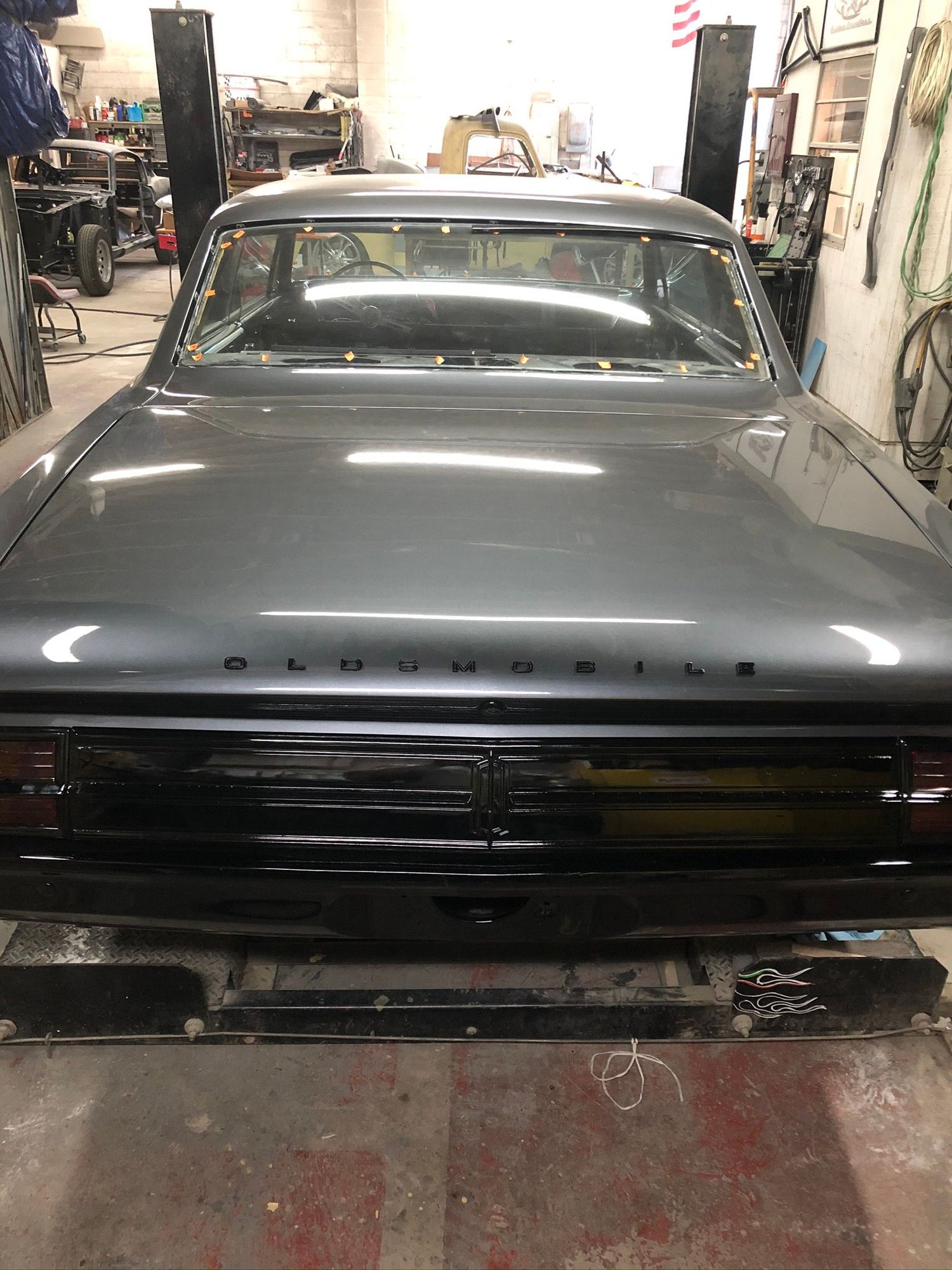

Installing the OLDSMOBILE letters

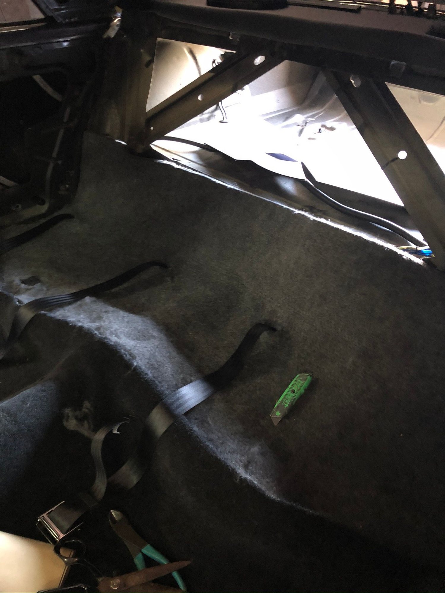

Installing insulation for the back seats
Installing back seats

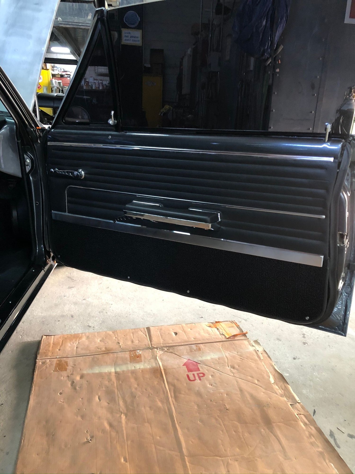

Installing front door panels
Installing rear door panels
Front Pass door panel
