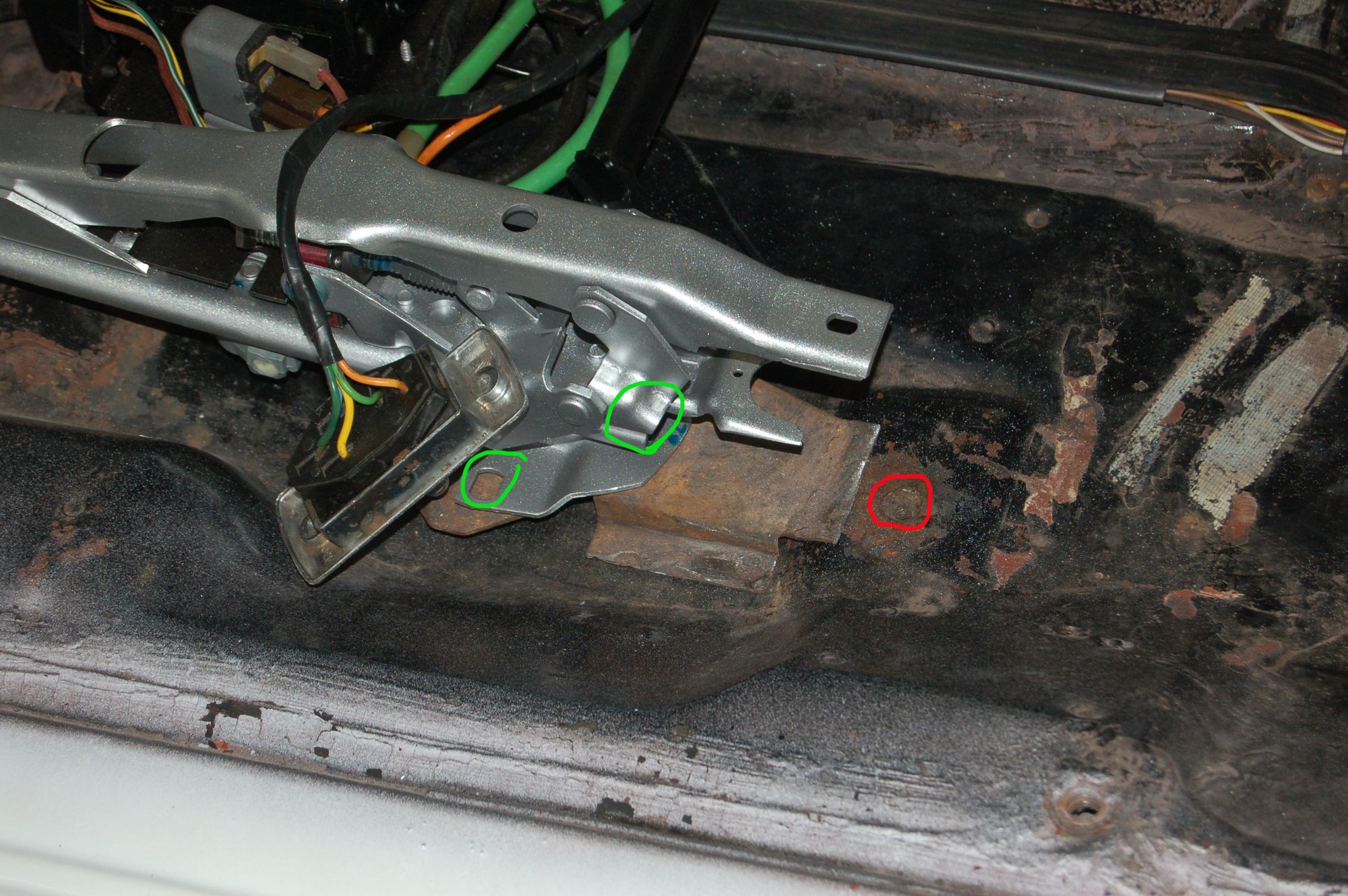

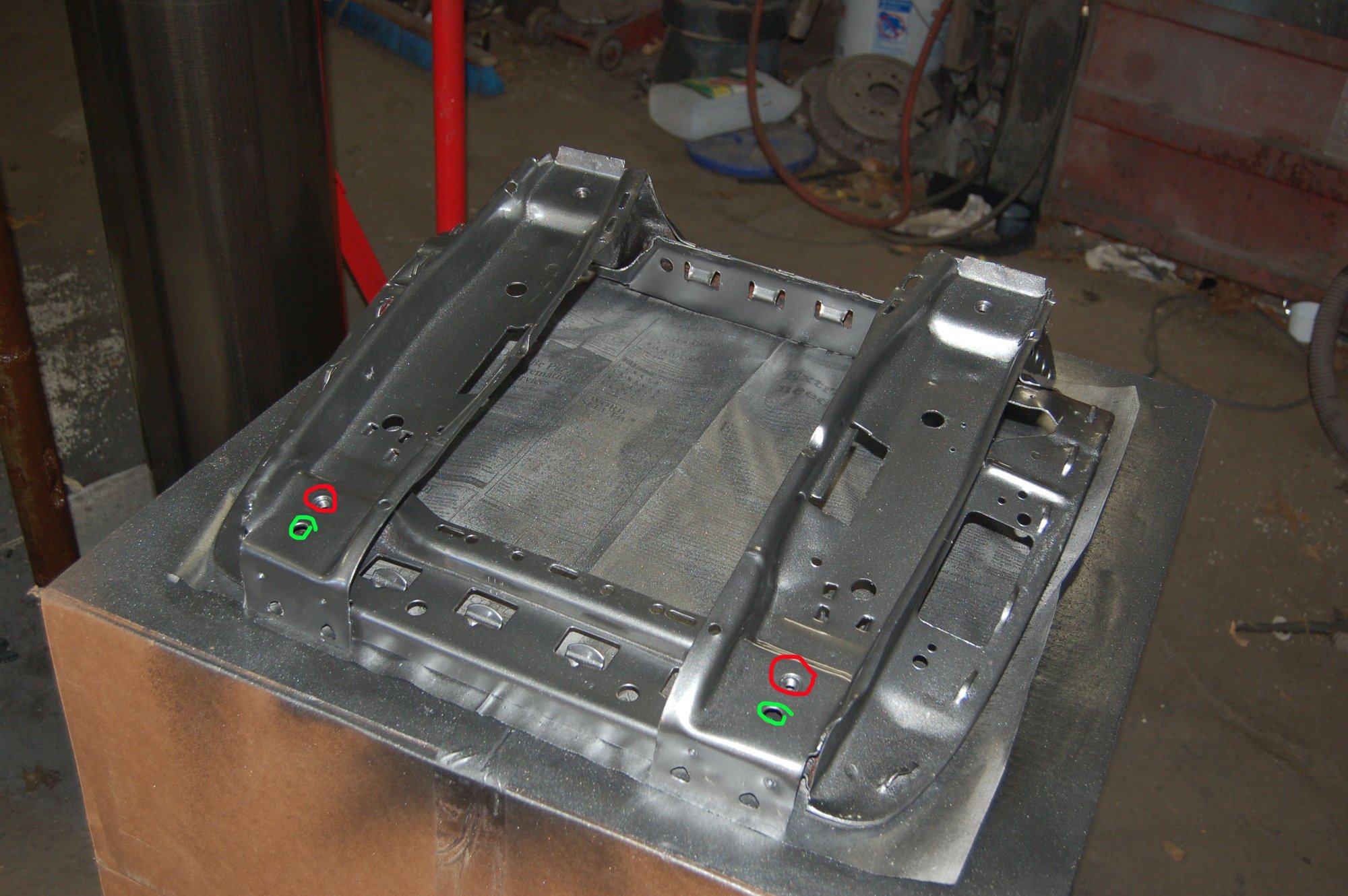

By "base" do you mean the bottom of the seat or the mounts on the floor. The seat bottom is the same, but the later power tracks use different front mounting holes than the manual tracks. The rear floor mounts are completely different on a power seat. The power track rear floor mounts are several inches further forward than the manual track mounts.
In the photo below, the red circles show where manual tracks would bolt to the seat bottom. The green circles show where the power tracks bolt to the seat bottom.
In the photo below, the red circle shows where the rear mounting bolt would be on a manual track. The green circle shows where the rear mount is on a power track.

I showed that in photo 2 in my post. The rear power seat FLOOR mounts are about 3" forward of the manual mounts. The outer rear mount is also 1/2" - 1" lower than the manual outer rear mount so it cannot be easily moved back.
