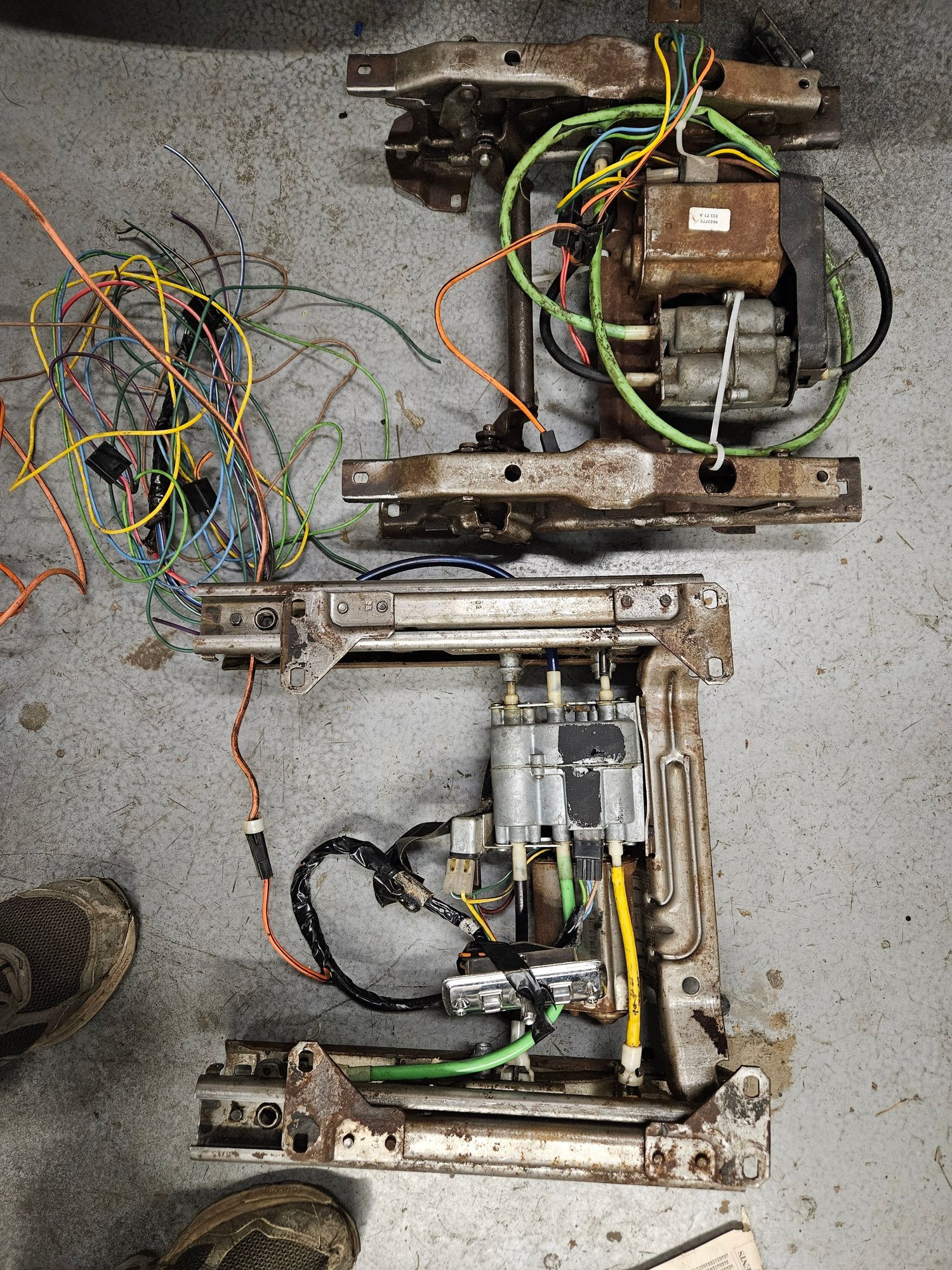

I just acquired a couple power seat bases and I'm curious as to whether they'll work and what's involved. My car is a '70 Cutlass setup for bucket seats. The two bases I have are not the same - one appears to belong in a 71ish Cutlass while the other is marked as being from a '71 Toronado.
First question is whether the Toro base can even be made to fit/work in the Cutass?
Second question is whether the mounting points need to be changed for power seats or do they use the same mounting stud?

The Toro chassis will not mount without heavy modifications. The A body chassis will work, but you’ll need to install power seat brackets.

The cutlass seat track is actually 72 one-year only 3-cable unit. Someone cut the rear extenders off to make it fit on 66-68 seat bottoms, but it will bolt up to the 69-72 seat frame. It will just sit about an inch and a half closer to the steering wheel. It will fit your cutlass, but you will need an outer power seat floor bracket. The front seat mount studs in your car will work as is. The rear inner stud needs moved to the front hole already there. You will need to cut the factory rear inner stud off and weld a new one in the forward hole. You could also simply drill a hole in that location and put a bolt through the bottom of the floor. The rear outer mount needs welded in. You can buy a set of new power seat mounts and cut off the back half of the outer to weld in.

Thanks for the details! I'm done with welding and drilling on the floor so will be sticking with the manual sliders and will try to sell the power tracks.
