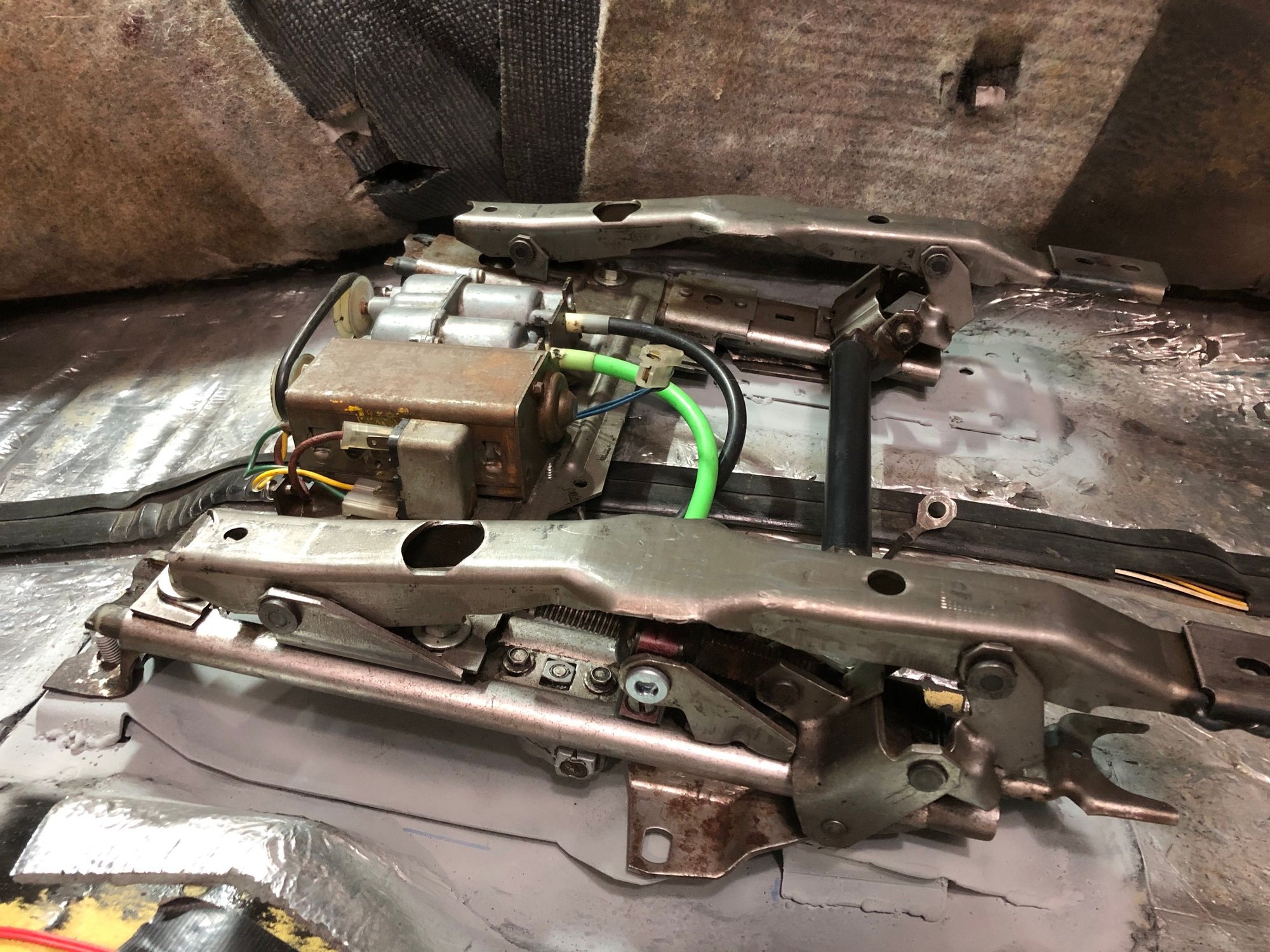

These pictures are not very good for what you need but maybe they will help. These were taken from the passenger side but this car had the power driver seat in it and the tracks are how they should go. Just hard to see them. Sadly, I don't have any better pictures of the driver side.
Old Dec 27, 2019 | 04:53 AM
BSiegPaint's Avatar
Joined: Nov 2017
Posts: 1,527
From: North Royalton, OH
Those are VERY helpful, thank you, Both brackets follow the contour of the floor pan - the right has a distinct bend in the center. And the left follows all the dips on that side... I have some serious work to do to make these reproductions work - if I get this right I'll write up a post on how to do it. Wow - I can't believe the companies are selling these items that are so incredibly wrong.

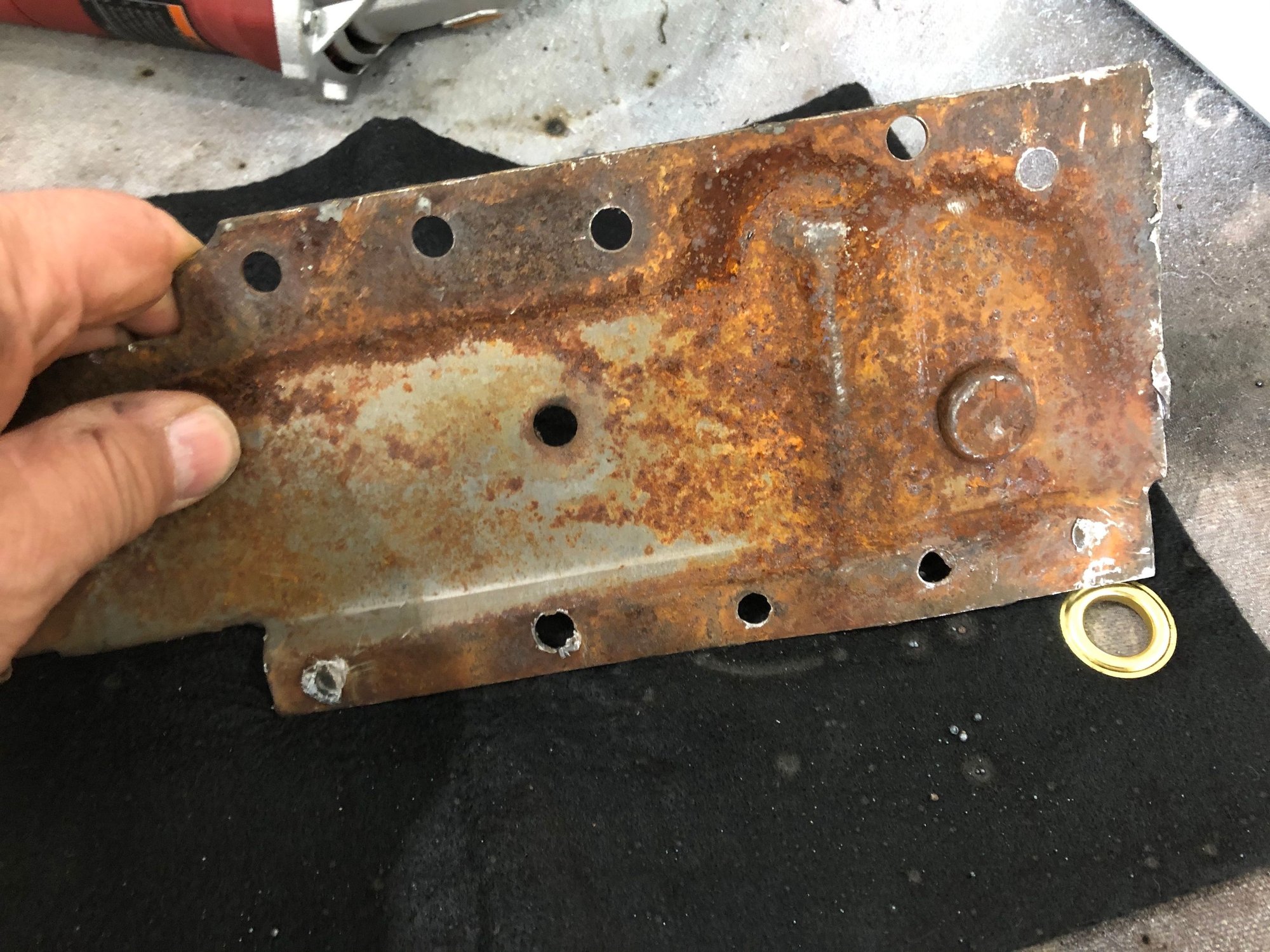

Well, well, well.... learning as I go. After making the comparison above, I noticed the forward hole in the rear half of the bracket. Compared it to the power seat mount and it matches. So the only difference in the power seat versus the standard bucket seat mount is the positioning of the rear stud. It seems like a lot of work to remove to change the stud location, and I'm sure no one would have noticed if I had come up through the floorboard with a carriage bolt. But, I'd already sawed off the bracket, so I ground off the spot weld on the rear bolt and moved it forward, tacking it in place.
Then I set the bracket back in it's original spot and tack welded in a dozen different places, got it primed, and now I only have to do the left side before I can get the seat installed. Of course, that's the hard side....

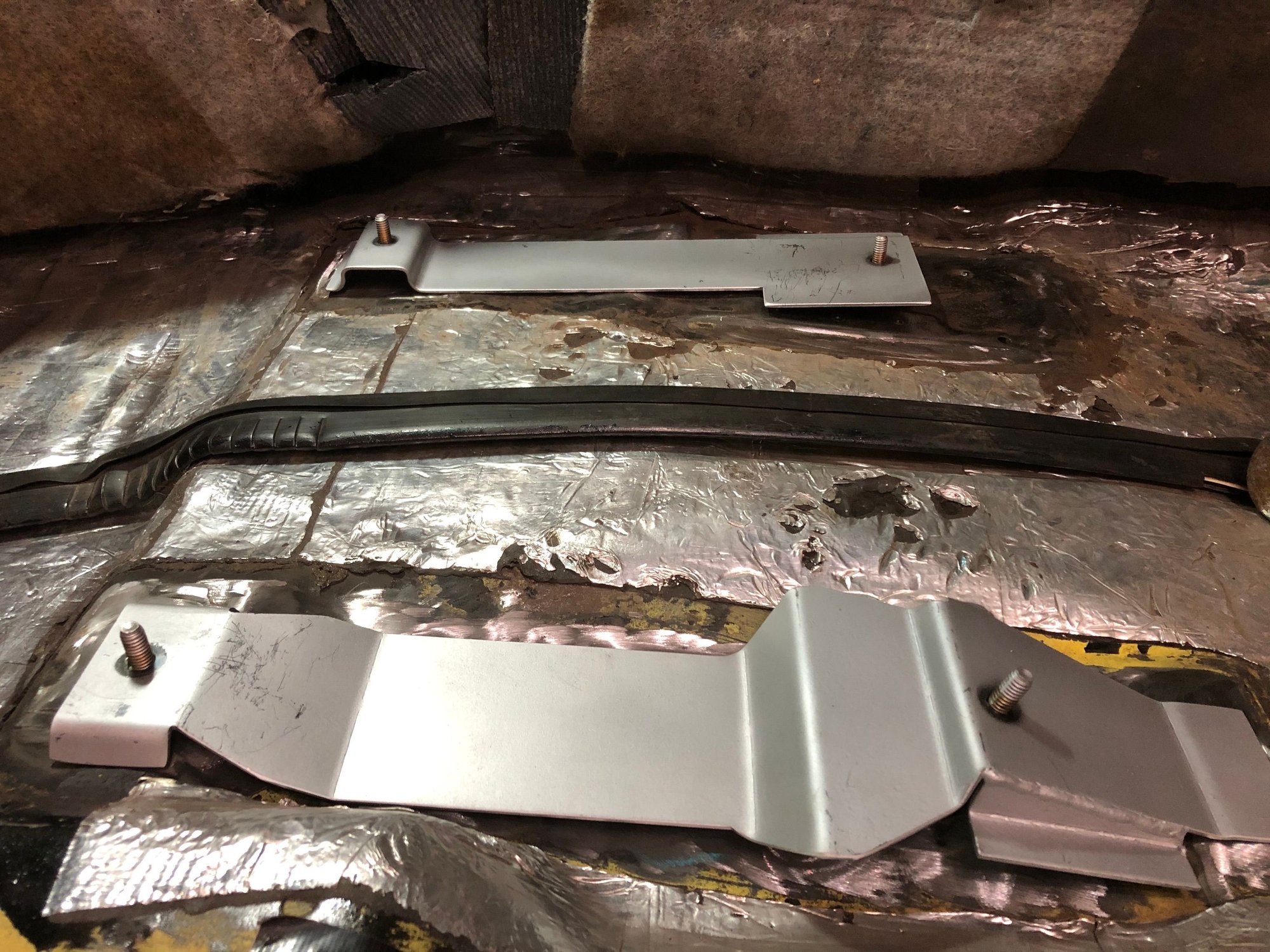

I installed a power seat in my factory 71 Cutlass bucket seat car and welded in the outside factory bracket, but just welded a stud to the inside factory bracket, if I remember correctly. I also left the original stud in place.on the inside bracket. On the outside bracket I put a bolt down through the bracket into the original non power bolt hole in the floor. I'm going from my pictures and all this happened 26 years ago, so I'm a little foggy on the details. These pictures may confirm the results you've determined.

Wow - your pics really show the difference between the correct factory brackets and the crap that OPGI and others are selling. And THAT'S why I'm having such a hard time installing this dang seat. Here's a pic of the current brackets available for installing the power seat. After bending and smashing the left one to the point where it will actually touch the floor pan, I find that the left rear mounting stud is a full 1/4" lower than the right rear stud. I'm going to have to figure out how to raise the bracket tomorrow so I can get this seat installed. THANK YOU for these pics.

You're welcome. Repro parts are a real hit and miss, thankfully more hits than misses. You wonder if people making these parts ever actually try to install them.
It's unfortunate so many who pull power seats out of parts cars are unaware you need the welded in brackets. You are somewhat fortunate to have these brackets to work with for the drivers bucket, but nothing is offered for the passenger side floor for the power bench seat, making the seat uninstallable. Good luck with your install. Please show your results when completed.

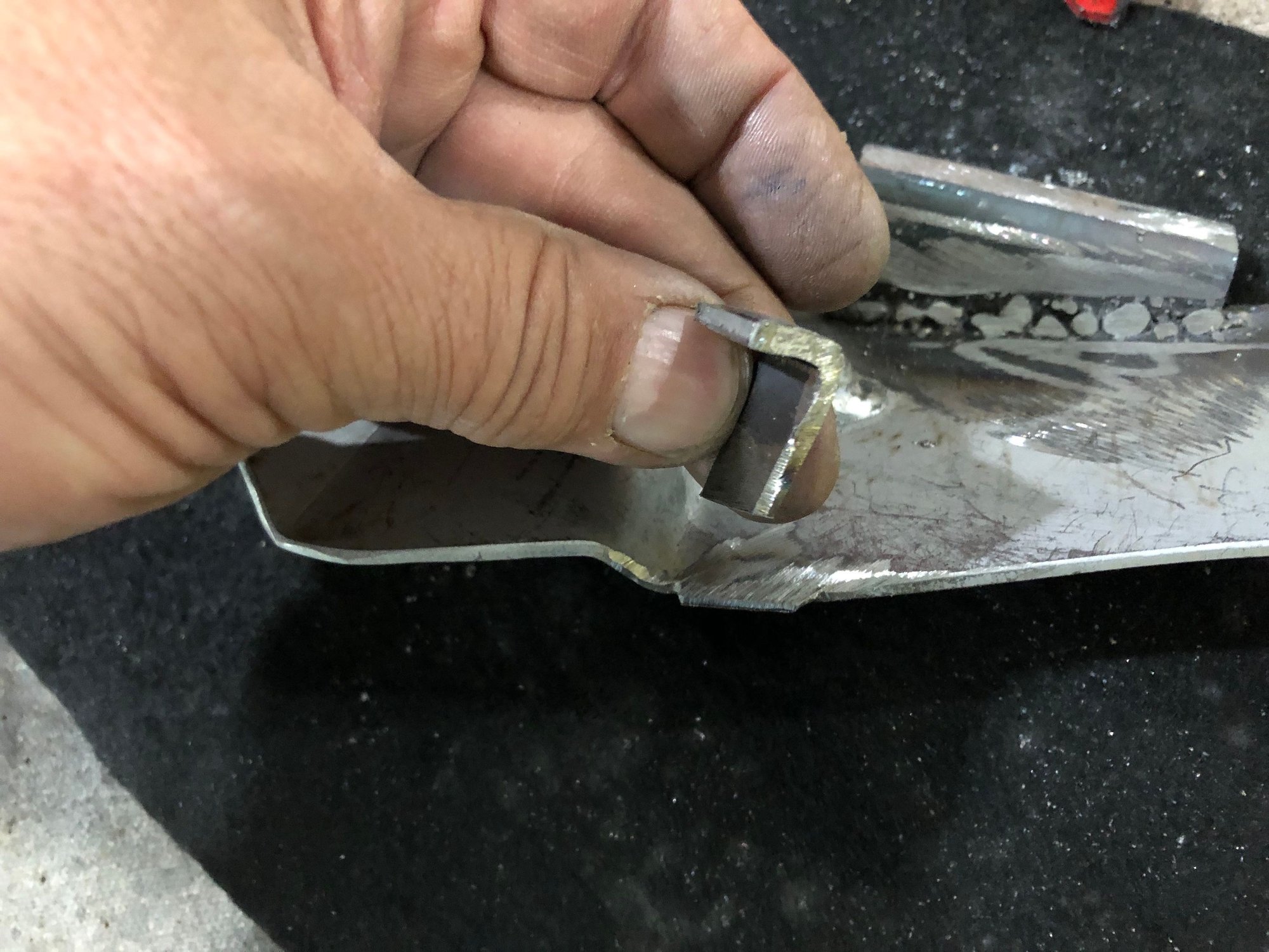

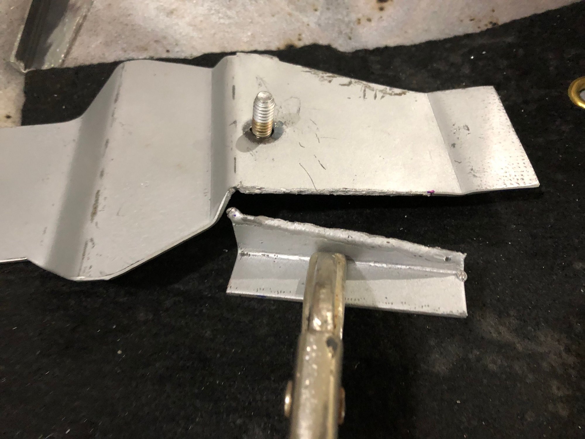

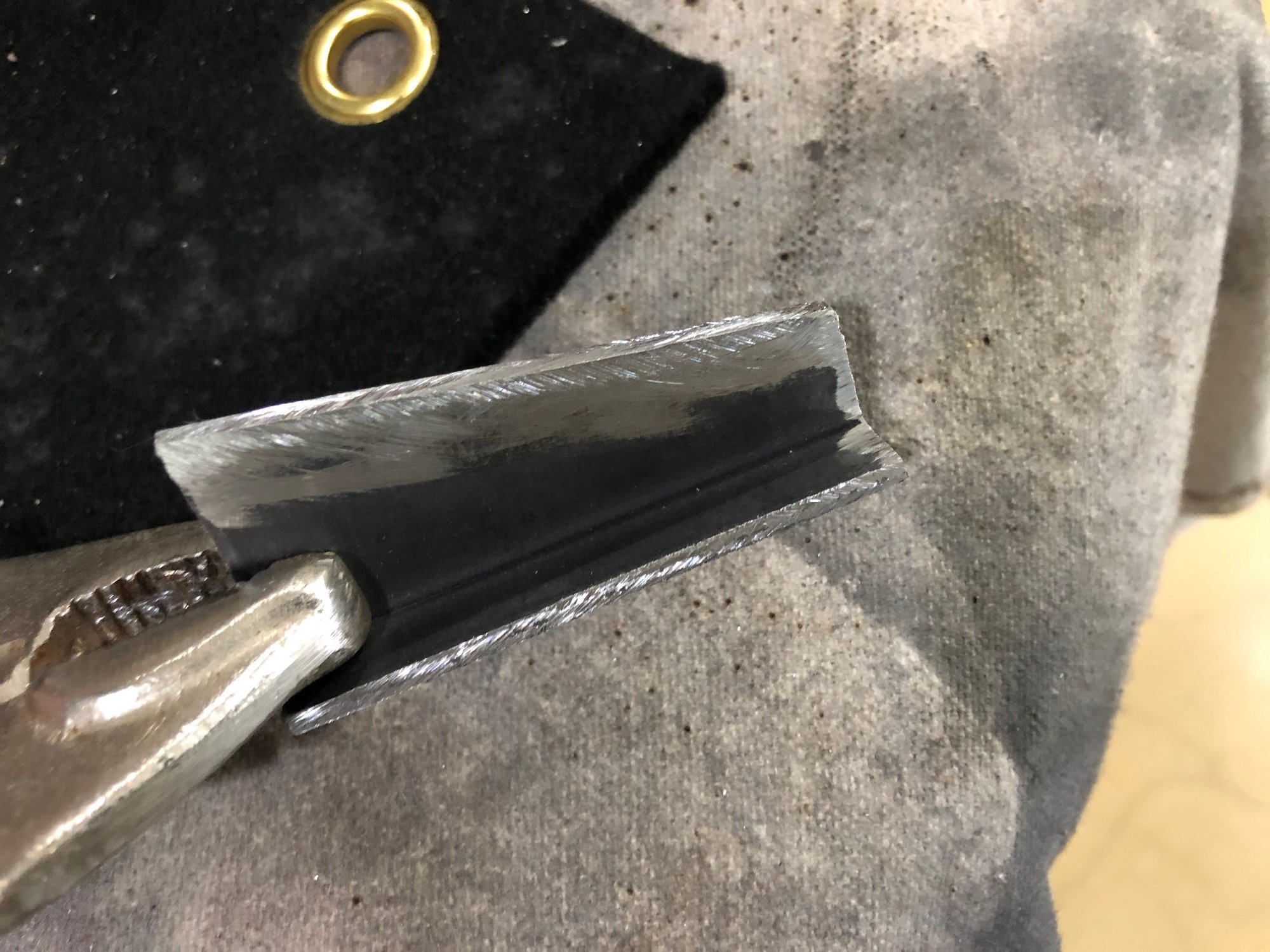

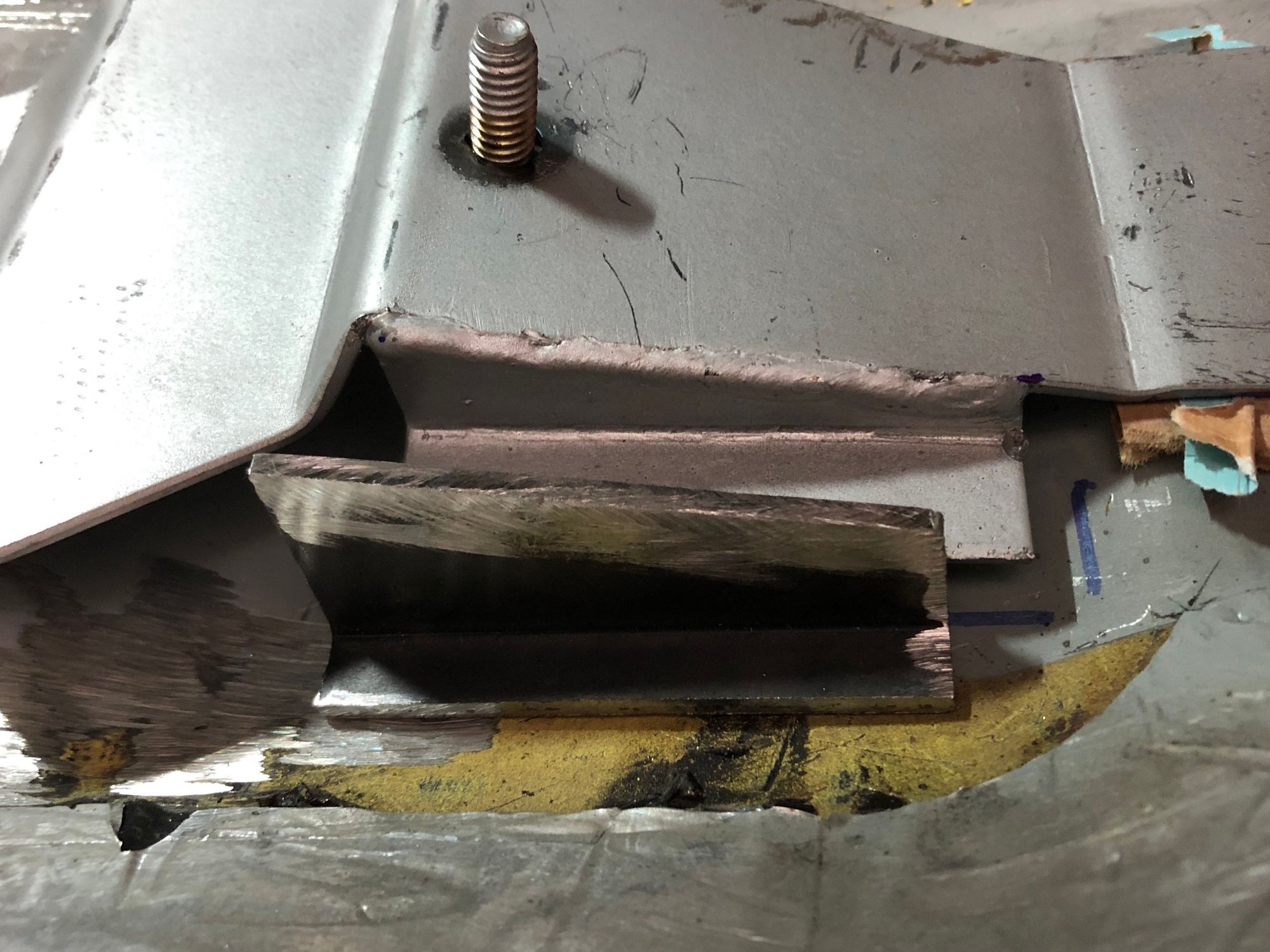

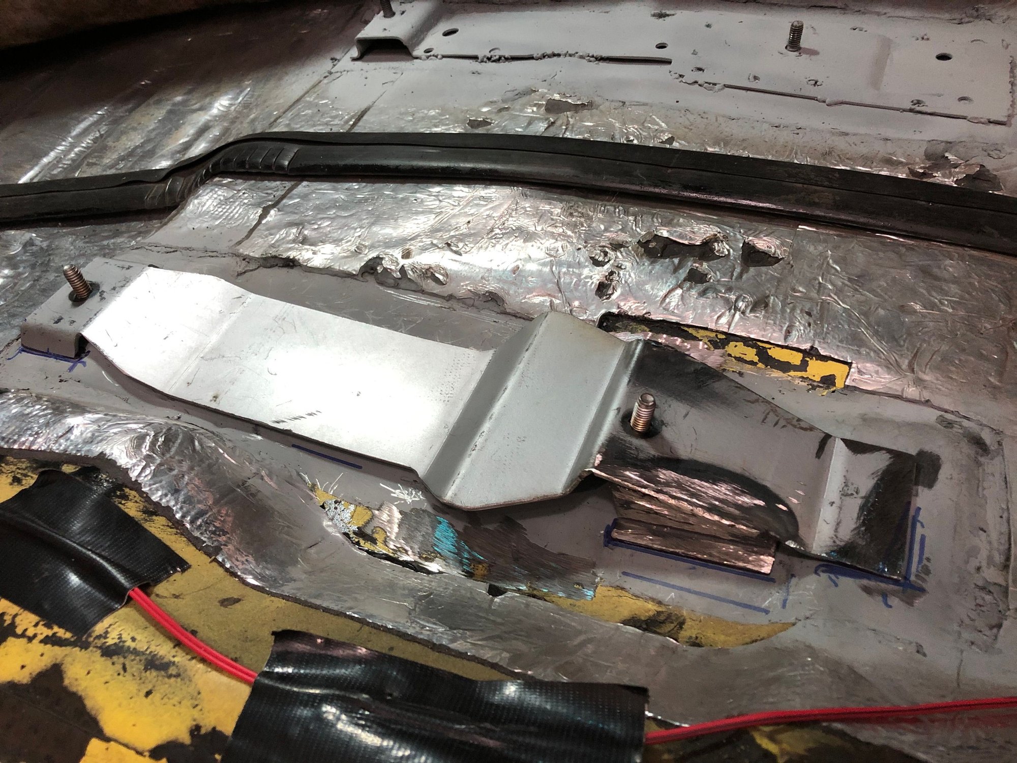

Here is my final solution to this mess. I had to get the brackets in place where the front and rear bolts were level and parallel to each other. There was too much space between the rear legs and the floor, obviously. I was both pleased and disappointed that the welded "feet" on the reproduction bracket snapped off with very little effort, but it made the fix that much easier.
I went to Home Depot and bought a length of C channel steel and used it to make two new feet. The one for the left just needed to be taller, while the one for the right needed to be trimmed, angled, and bent further than 90 degrees for proper alignment with the floor.

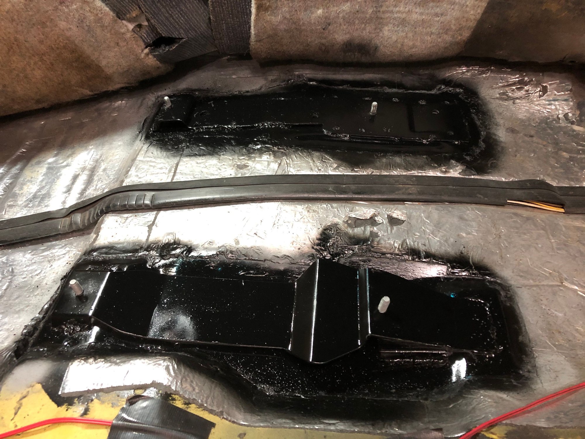

Then I welded the feet into place and welded the brackets to the floor after confirming that all the bolts were level with each other. A shot of primer and topcoat with chassis black and now all I have to do is run the wiring and get the seat installed.
This was not one of my "have fun with the Cutlass" projects. This really sucked, and there is very little info out there on how this install should go. Bottom line, and those with bench seats who want power know this, you really need the factory mounting brackets - at least the left side, since you can make the right side work or reuse it, like I did.
Hope this helps anyone who is wanting to do this upgrade - lots of things to consider when deciding that a power seat is the thing to do....
NOTE: The primer I used as I went along here is a zinc weld-through primer you can get at most automotive stores, not a generic spray primer.
