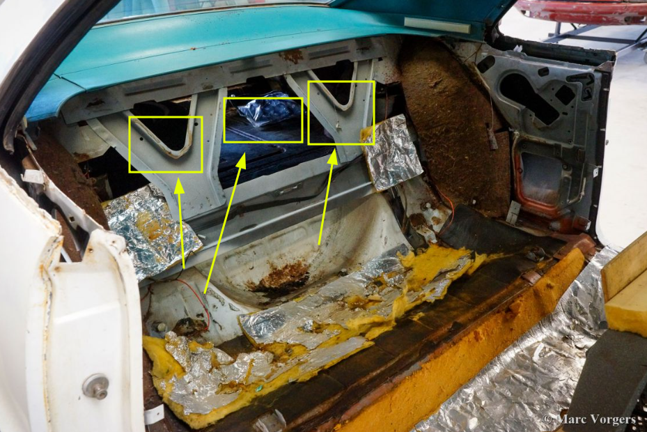

I’m currently using Fatmat to line my car. It’s working out well. One question, should I cover the holes in the partition that separates the back seat from the trunk? —Billy
No one answered you
What did you end up doing?
Getting ready to do mine
Any tips appreciated

Do you mean something similar to these areas highlighted below?
Old Dec 13, 2024 | 03:55 PM
Candyman68's Avatar
Joined: Jul 2021
Posts: 167
Yes, exactly
Can you just put a solid piece across all of that?

You can put strips of Dynamat or equivalent on the metal braces to reduce vibration noises but the large openings would not benefit from it. Some years had a cardboard layer between the metal and the seat back. In the '80s there was a very thick blanket of jute with a layer of tar that was used for soundproofing. A cardboard/jute barrier would be easy enough to fabricate. If you are going for a complete resto, best to research what came factory on your year.
