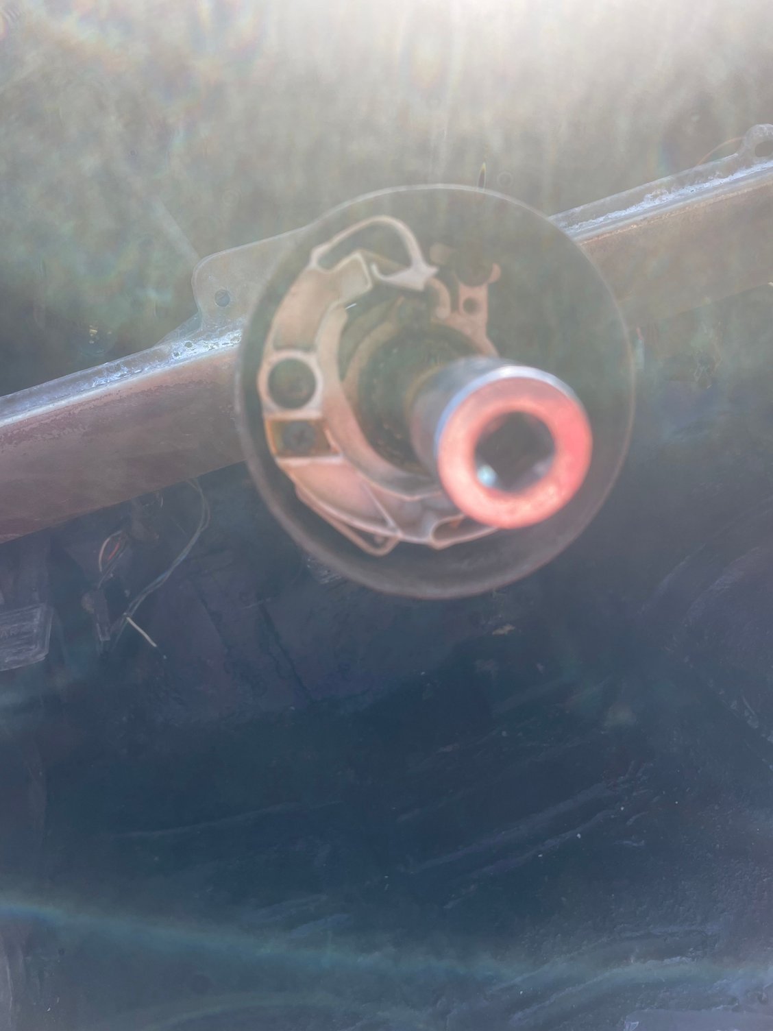

Trying to tackle ta steering wheel install on my 65 cutlass. The original wheel was just hanging on with a loose nut. It looks like I’m missing parts. I’m just not sure what parts I’m missing. The new wheel and hub are from forever sharp. If someone can walk me through this that would be great thanks.

You are missing the turn signal cancellation cam and spring , also the turn signal lever
thank you. I was looking for something like this. Im putting a list together now.

Yes those are part numbers.

All of the parts are available through multiple sources.
yeah I just ordered a new turn signal switch. New to get the rest of the parts.
