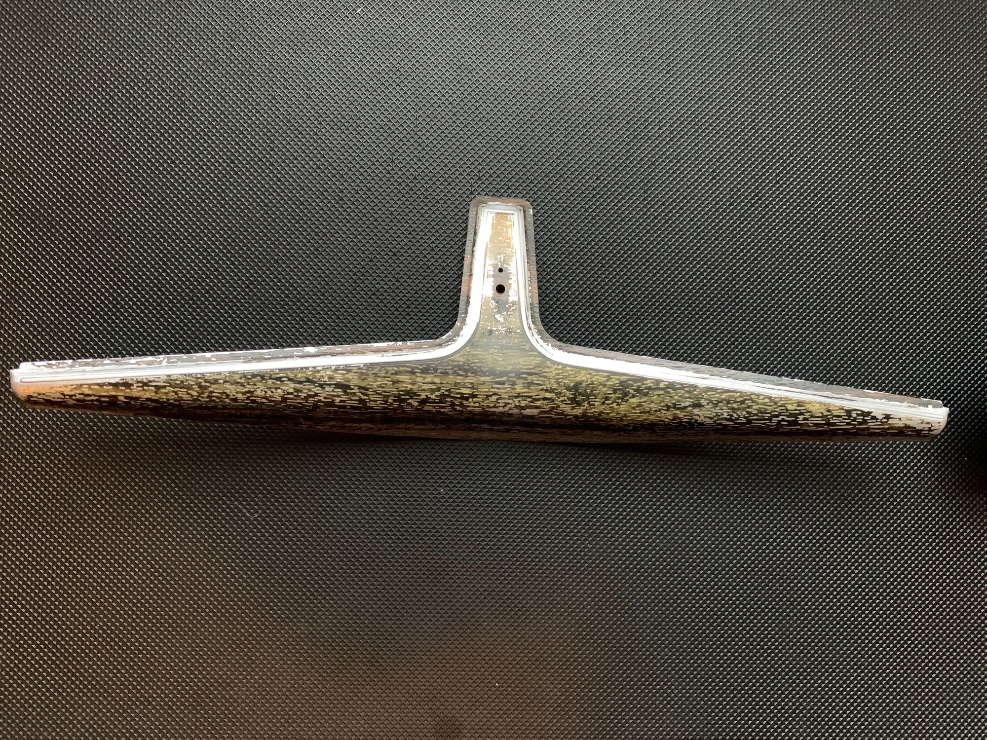

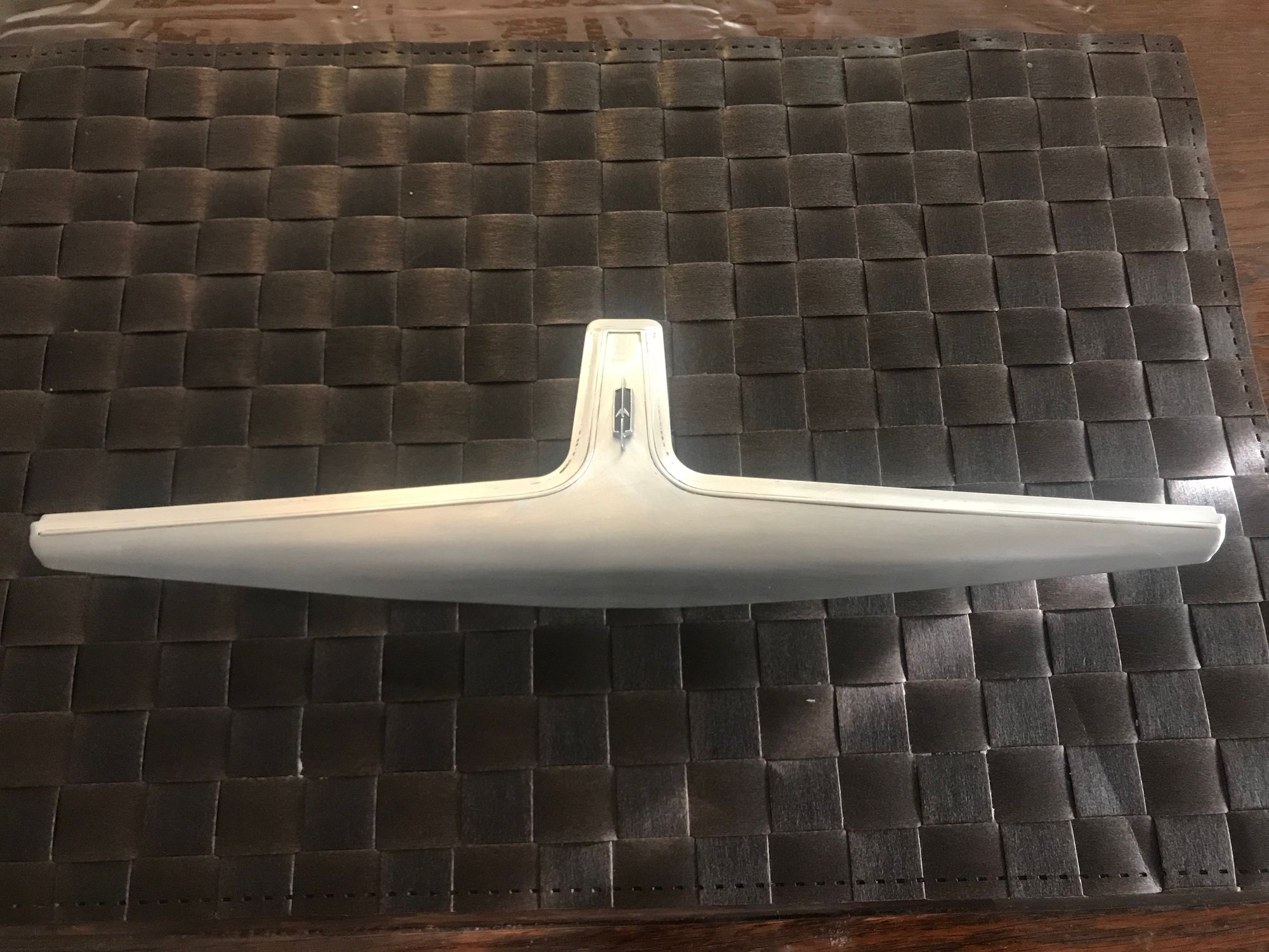

Has anyone ever restored the faux wood finish on a steering wheel insert? Below is a pic of my insert and a pic from the internet of a similar insert from a 72 Olds 98.
My plan has a few options since I cannot find this insert anywhere:
  1. Prep the insert with a cleaner, light sanding, tape off raised edge aluminum bar in center and prime in a light color to accent under the stain color
  2. Stain the insert with a close color that takes well to metal finishes, ex, ZAR brand stain. Their color availability is limited. I'm guessing I'm attempting to recreate Rosewood?
  3. Use a wood grain tool(s) to brush faux grain
  4. steel wool the raised aluminum bar
  5. Spray poly or otherwise lacquer or varnish. Somebody here might tell me the pitfalls of each
Option 2
  1. apply a rosewood automotive interior decal (or make a water slide decal) over top the insert. Issue here is that it will be near impossible to decal over the insert and not the raised aluminum bar in the middle. I'm not that good
And, if anyone has another idea, I'm all ears.

The steering wheel in my 71 98 is identical to the 2nd picture. The faux wood grain is starting to wear at the edges. If I were to attempt to restore it I would try to locate the faux wood applique and recover the center piece. From my understanding, it's a sticker. Not a water slide decal or painted. You might have to use a razor and trim the applique around the raised parts of the center piece.

No luck finding an appliqué online. I have a roll of rosewood decal paper coming in the mail but, it sure would be nice to find an appliqué to buy.

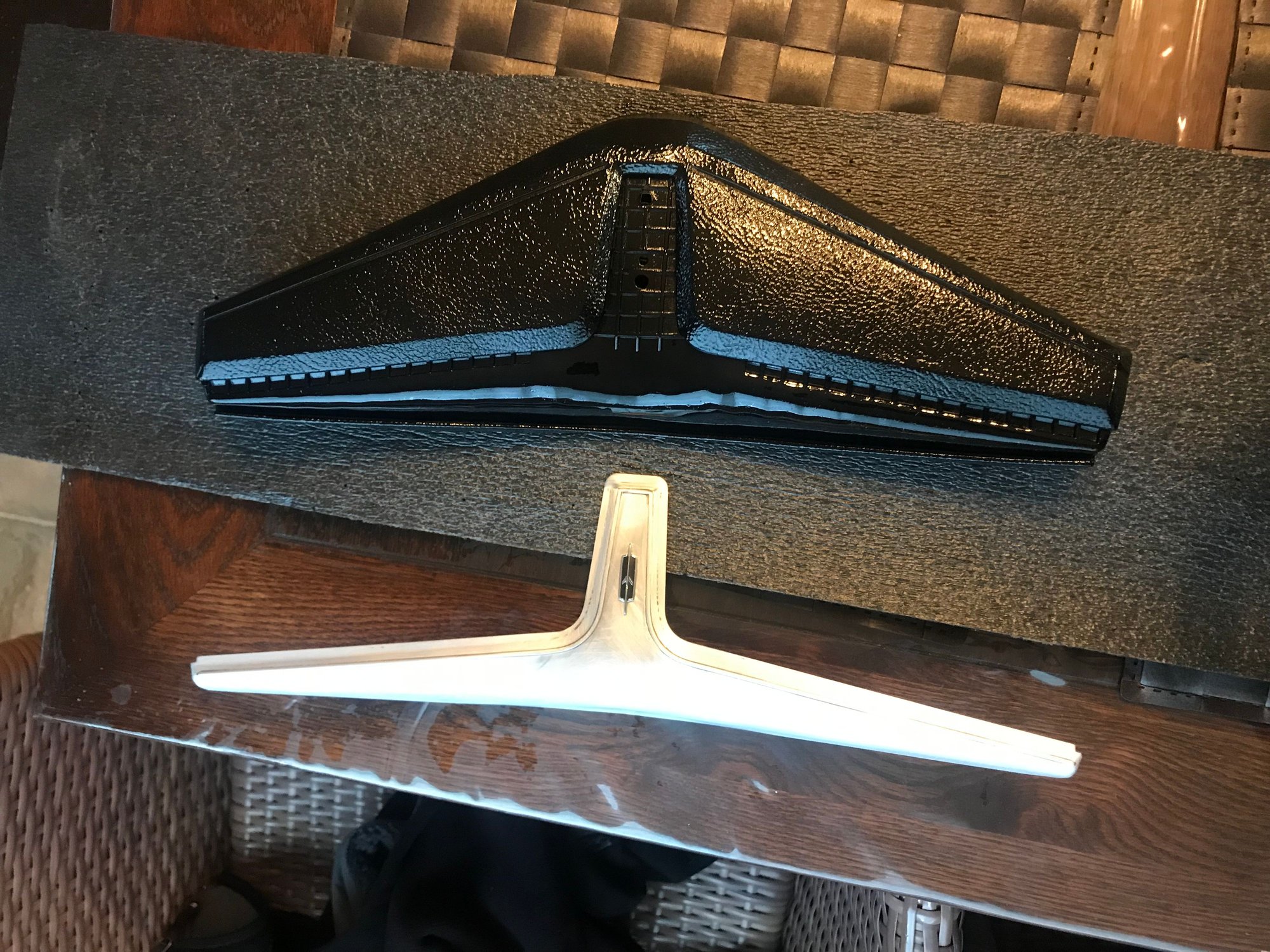

I’m actually restoring the identical steering wheel now. I’ve started some posts on my build. I was thinking of going with the vinyl or now that I have it stripped I might just polish the aluminum and go that way. Here’s my instert.

Your insert looks to have been in better condition to start than mine. When I laid down the vinyl, there was no discernible edge to trim along the aluminum... so, I just covered the aluminum bevel for now. Ultimately, I might need to find a better condition insert to start with. I used a darker brown vinyl but, have bulk rosewood vinyl coming. The vinyl for cars I used does not lay down well over curves and the Depot stuff pictured a few posts above looks pretty nice.

You have to use some heat from like a hair dryer to allow it to stretch in some areas. This vinyl is prob a little thinner than the stuff you ordered if it’s not laying down on some areas. I decided just to throw a piece on mine and I did it in 5 min with no heat or 3m glue just utilizing the glue on what I think they call Mac tac? The color has faded quite a bit in my car but I took a pic close to the glove box and it’s pretty close to original.

I just put that on quickly to see how it would look. With no 3M spray glue on it it comes off easily. I’m still debating on going with a modern look with the aluminum and get rid of all the faux wood in the interior. Not sure yet.
