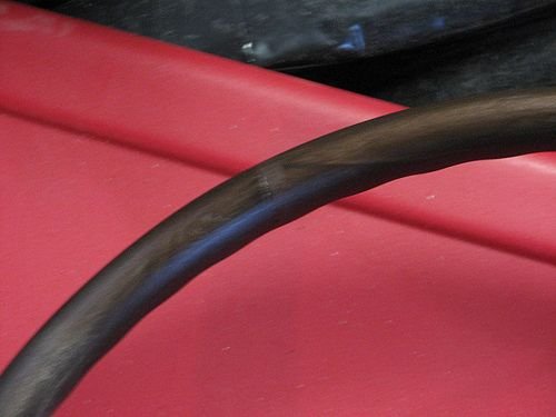

ive done it...
I agree with Joe, but I have done the repair on a simulated wood wheel it takes some work, I used the PC7 stuff from eastwood, and I added powdered pigment
https://www.amazon.com/gp/slredirect/picassoRedirect.html/ref=sspa_dk_detail_6?ie=UTF8&adId=A0002342OYHMVZGJOYUK&qualifier=1551707565&id=5960726863926743&widgetName=sp_detail&url=%2Fdp%2FB071SB48Z7%2Fref%3Dsspa_dk_detail_6%3Fpsc%3D1%26pd_rd_i%3DB071SB48Z7%26pd_rd_w%3Dybp8R%26pf_rd_p%3D733540df-430d-45cd-9525-21bc15b0e6cc%26pd_rd_wg%3DwGKgt%26pf_rd_r%3D3GCXR1GRRJGJ30XM54VE%26pd_rd_r%3Dc9d3b2c2-3e84-11e9-94c5-5bb9f7fee677 https://www.amazon.com/gp/slredirect/picassoRedirect.html/ref=sspa_dk_detail_6?ie=UTF8&adId=A0002342OYHMVZGJOYUK&qualifier=1551707565&id=5960726863926743&widgetName=sp_detail&url=%2Fdp%2FB071SB48Z7%2Fref%3Dsspa_dk_detail_6%3Fpsc%3D1%26pd_rd_i%3DB071SB48Z7%26pd_rd_w%3Dybp8R%26pf_rd_p%3D733540df-430d-45cd-9525-21bc15b0e6cc%26pd_rd_wg%3DwGKgt%26pf_rd_r%3D3GCXR1GRRJGJ30XM54VE%26pd_rd_r%3Dc9d3b2c2-3e84-11e9-94c5-5bb9f7fee677
it came out pretty good, not concours but fully serviceable for me. I did have to add some grain with paint etc to blend in, but after clearcoating it looks pretty good
steering wheel after first application
steering wheel repair
