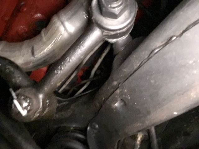

Thanks so much for your quick response. I'm a novice in this area (first classic) so please bear with me. Attached are four photos, three of the 1967 Olds Chassis Service Manual and one of the Idler Arm in question. The literature details the Series numbering I noted in my original thread and drawings of the three 1967 Steering components. The fourth is a photo of the Idler Arm needing replacement. As information my 67 Delta vehicle number is 358677MXXXXXX. If I'm reading this correctly, the idler arm depicted in the diagram (bottom half of the Steering Diagrams" photo) labeled 33 thru 38 series resembles the photo of the idler arm currently on my car. The one shown for the TRW and Saginaw component is curved and butts up against the manifold thereby constricts steering.
I wish to fix this problem and hope a possible solution may be provided by you or other members of this forum.
The enjoyment I get out of driving the Olds far exceeds the hunt for this idler arm and I refuse to give-in to the frustration. Also, it's folks like you who add to this enjoyment.

The "3" in your VIN just means Oldsmobile Division.
The "58" means that it is a Delta 88. 58 is the "series" you keep talking about.
The "67" means that it is a convertible
The next "7" means 1967 model year
The "M" is Lansing, MI assembly plant
The remaining digits are just the sequential build number
Your car is a 1967 Delta 88, period. The straight idler is not correct. I own a 67 Delta. Once again, no regular auto parts store sells the correct idler arm any more. You need to get one from a specialty house. The center link is also not available from normal sources - Rare Parts is about the only source. I suspect a previous owner, faced with non-available parts and needing to fix the car, forced Impala parts into place.
THESE ARE NOT CORRECT, THEY WERE NOT FACTORY INSTALLED, AND ARE NOT SAFE.
I had the same problem when I got mine and had to replace all the steering linkage parts. The idler I showed in the photo above is the ONLY correct idler arm for a 1965-1970 Delta, period. Nothing else is correct. Your exhaust looks new. Do you know if it is a factory pipe or something that was custom bent by a muffler shop? If the latter, it may or may not mimic the exact routing of the original, which can also cause fitment problems. Despite the size of the car, the clearance between the exhaust, starter, and steering is very tight on these cars.

You learn something new everyday! You are correct. I'm not sure about the exhaust being modified, but am going to take your path and see what can be done to replace all steerage linkage parts to factory specs and correct exhaust issues if applicable,
