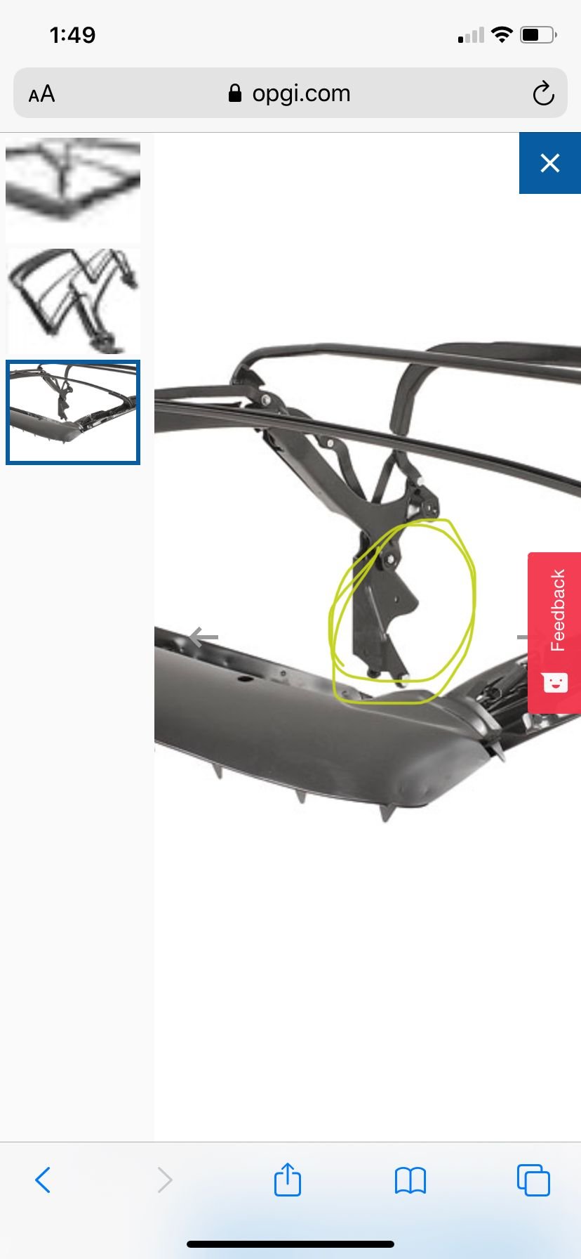

Pic of the convertible shoulder belt rear attachment location:
https://classicoldsmobile.com/forums...cation-137972/
that IS the convertible top frame though like I said.
Old Jan 25, 2020 | 11:30 PM
Posts: 15,310
No, it is not part of the top frame. Maybe we're just calling parts by different names.
The belt attachment point is below the top frame, actually connected to the bracket where the top frame is connected to the body. I have removed the entire top frame assembly from my car and that part remained attached to the body.

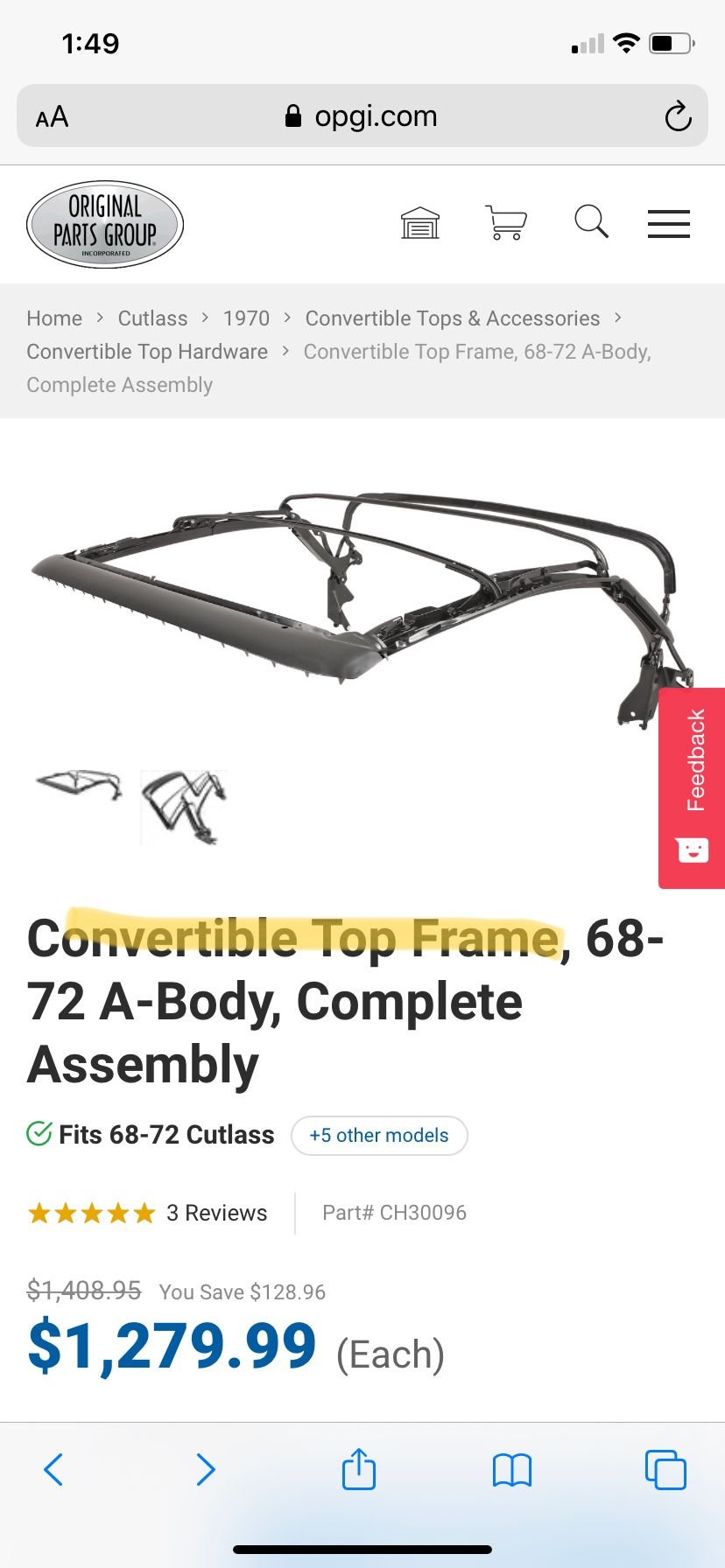

Old Jan 27, 2020 | 10:50 AM
CuttyShark's Avatar
Joined: Feb 2015
Posts: 356
It IS the Top Frame!! I
