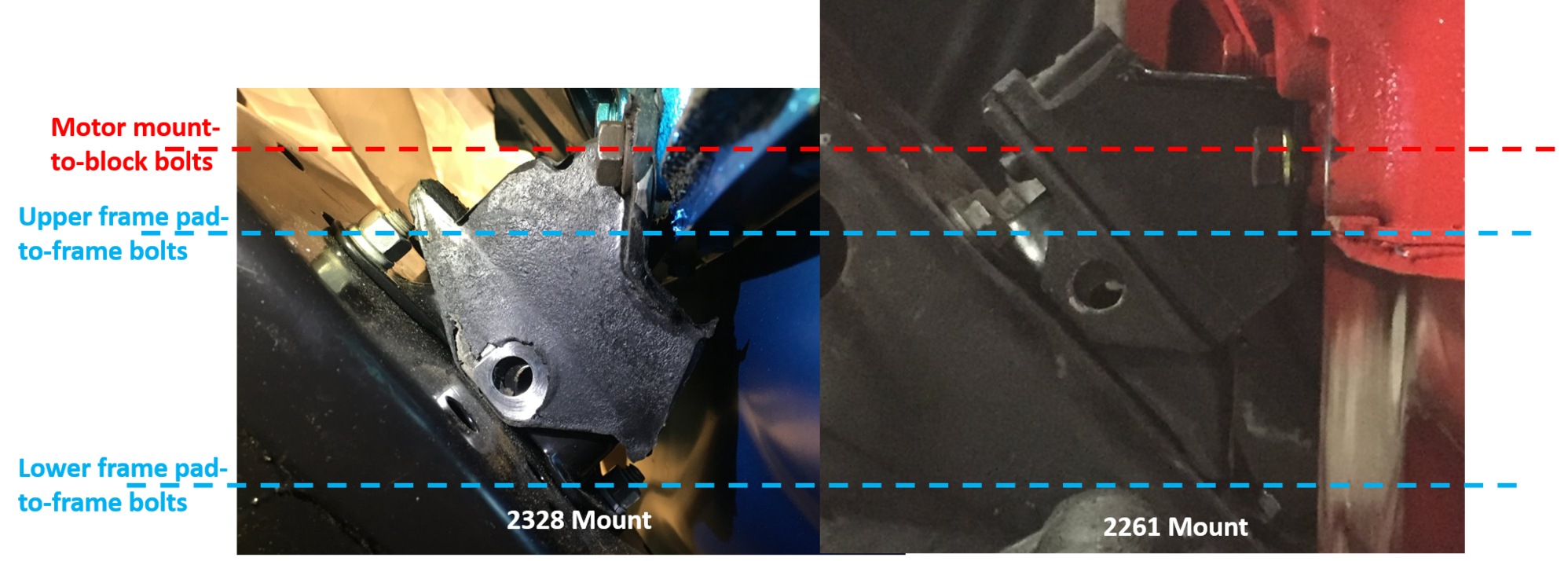

2328s will NOT have the same clearance on the original frame pads, so again I note that 2261s are only correct with the OEM pads. And as an example of why I don't trust Anchor's application info, 2328s are correct for all 1969-72 Olds A-body big blocks in cars with the OEM frame pads. The photo below shows that when the mounts and frame pads match, the crank centerline is in EXACTLY the same place relative to the crossmember. Also, you have to force the 2328s to fit the early frame pads, so if they just bolted in, I question which ones you have. Note the second photo that shows the differences in the bolt hole location on the frame pads.
That's a great illustration Joe. Should be helpful to him.

What I find really interesting is that the 2328s wrap under the oil pan rail, whereas the 2261s are completely outboard of the rail. That suggests that using 2328s and matching frame pads on an SBO might free up room for headers.
