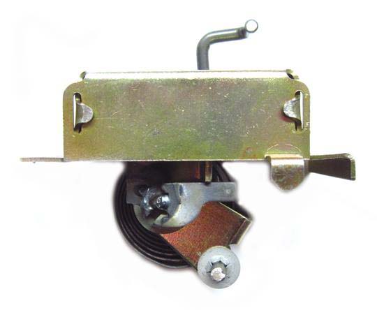

Is this the correct one?
https://www.thepartsplaceinc.com/ima...os/CB1519T.jpg
It appears The Parts Place has just started to sell these chokes that are supposedly for a 68/69 4 BBL at what appears to be a more reasonable price.
Before I make the purchase can anyone verify this is the correct one? I can't verify from the schematics or part numbers I have.
Thanks,
Randy

Randy, Pretty sure that is the one.
The red one in the pic is from a 69 400.
The other is from a 66-67 to be used with
the shallow pocket manifold.

I agree. The red one in the picture, and the one in the previous picture, both look like the correct '69-'70 unit.

Taller unit with angled top part is 66-7
From the PN database [actual stamped-in number in bold type]
Group 3.750
The taller angled-top unit:
PN ???????
COIL Choke Coil Thermostat,
. Stamped RP (Rochester Products) "33762".
1967 V8 330 with C.C.C. (Climatic Combustion Control) all trans.
Quadrajet 4bbl Carburetor
1967 V8 400, 425 with C.C.C. (Climatic Combustion Control) all trans.
Quadrajet 4bbl Carburetor (exc. Toronado)"
The shorter flat-roof type
PN 7029094
COIL Choke Thermostat, 1968 Oldsmobile All Models with V-8 engine and 4 Barrel Carburetor Except Toronado
Stamped "35038"
PN 7036095
66-67 Toronado
Stamped "29984" - RP 29984 B-1
1966 V8 330 all transmissions (exc. Jetaway with A/C) 4bbl Carburetor
1966 V8 330 A/T Jetaway with A/C Rochester 4bbl Carburetor
1966 V8 400 A/T (exc. Jetaway with A/C) Quadrajet 4bbl Carburetor
1966 V8 400 all trans. (excludes F-85, A/C, & 4-4-2 with Jetaway) Quadrajet 4bbl Carburetor
1966 V8 425 A/T (exc. Jetaway with A/C) Quadrajet 4bbl Carburetor
1966 V8 425 A/T 4-4-2 with Jetaway and A/C Rochester Quadrajet 4bbl Carburetor
The above info is only as accurate as I can get from collecting off parts cars and looking up applications in the 1972 PN Manual. I had identical PN's for the first two, so that much at least needs to be corrected. The '094 PN comes from a recent epay ad 12/2013.

Just to clarify the post above,
The red unit is RP pn 35038.
And the 66-67 has RP pn 33762
