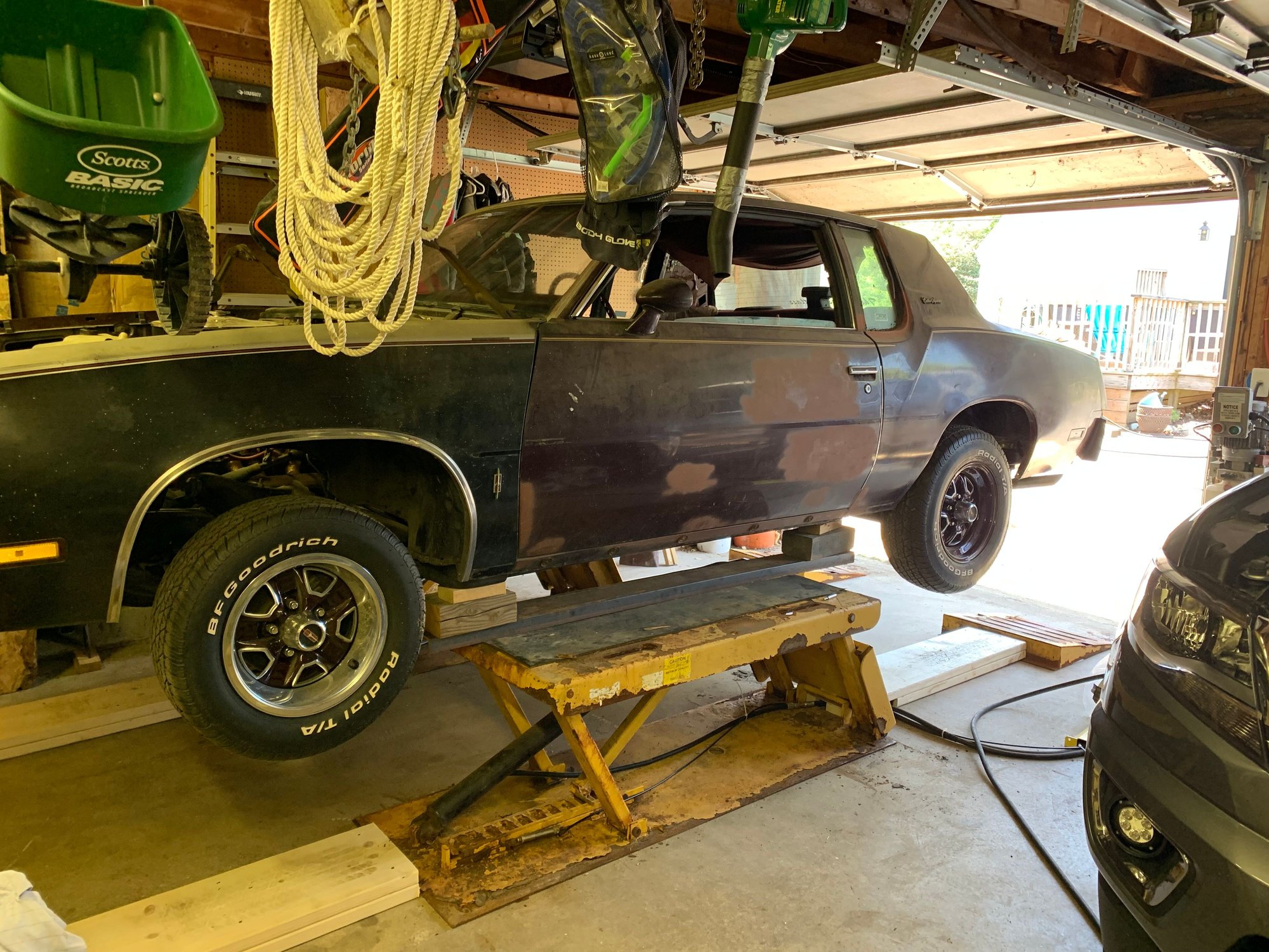

Originally Posted by old80cs
That lift is way better than getting the floor jacks out. I have a pit lift, similar design, and I lift my car almost 3’ in the air. I wish I had ceiling height for a four post with sliding air jacks but can’t so the pit lift is better than nothing.
That red car is beautiful!
I'm working in a barn. I don't have 240V service, only 110. I don't have a pro quality compressor. I considered a 2 post $5K lift, but that's beyond the scale of my operation, and waaay more money than I wanted to spend. And yeah- dude with the red car has a really nice ride!

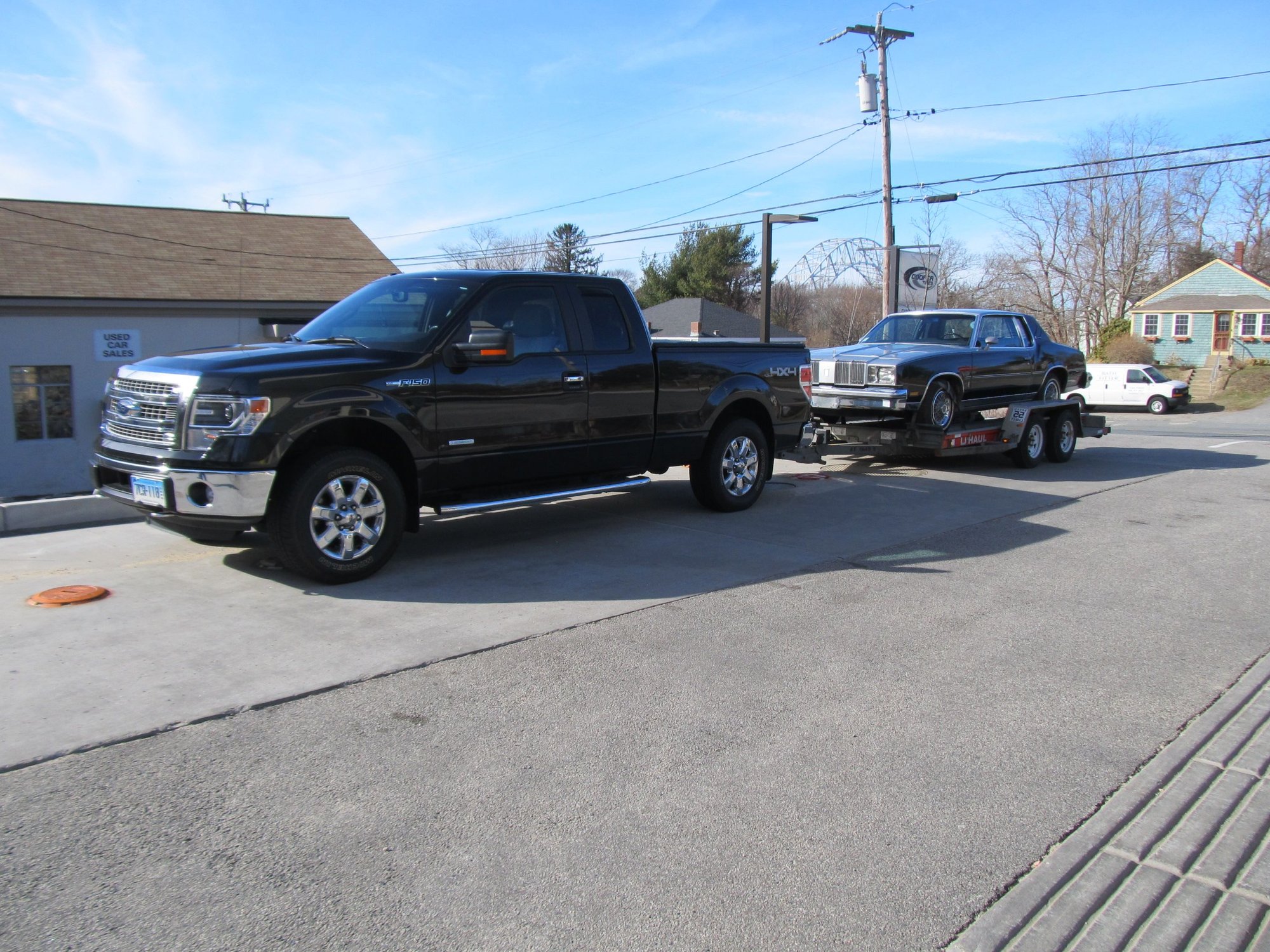

Gene, I pulled that fender out of a wrecking yard a long time ago. That photo is from 5 years ago. Lol
I had no appreciation for the rarity of that color combo when I grabbed it, I just needed a fender for my car as it got damaged in a minor collision when I was daily driving it back in 1990 or so.

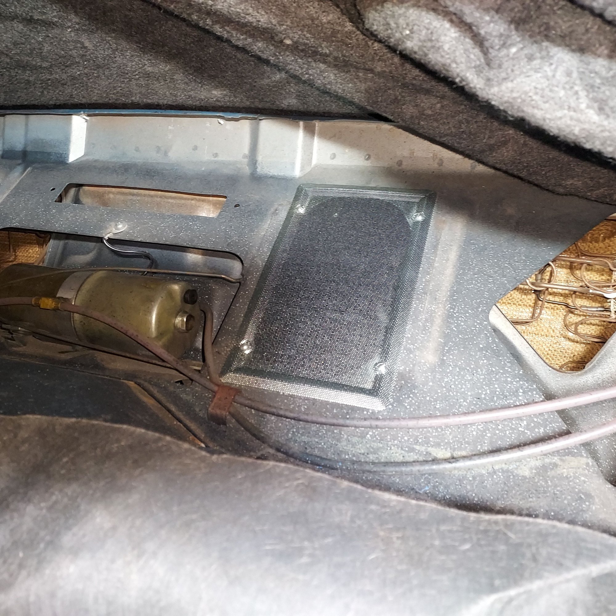

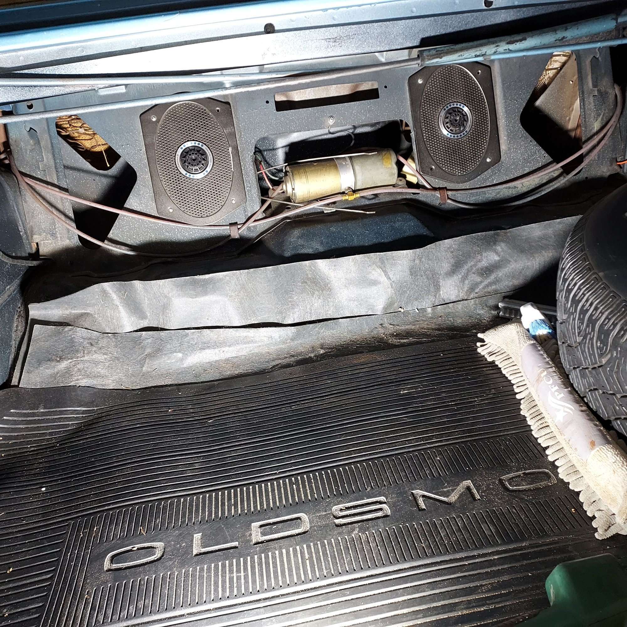

Working on a '71 Cutlass 'vert...This is a great thread, I'm gonna join! This winter I decided to remove the CD Stereo I had in the glove box along with the 4 speakers and go back to a factory style AM FM stereo. While doing that I decided to replace the wood grain trim across the dash because it had been enlarged slightly for a aftermarket stereo back in the day. Last fall I took out the aftermarket rear speakers that were behind the seat, and the kick panel speakers up front. Also removed the original AM radio and front speaker in dash. Then removed the center vent and duct and broke it! Luckily found another one here on CO. So now it is spring and started to putting back together.
This was what was in the rear, hooked up to cD player in glovebox.
This is the new speaker only in right rear position as factory would have done ( nearest I can tell)

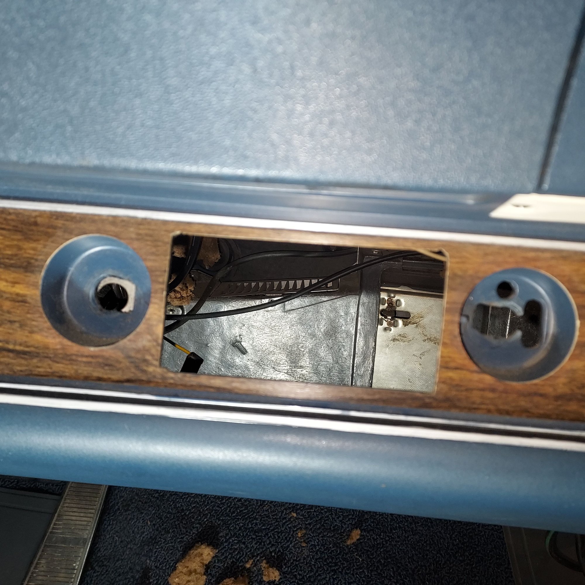

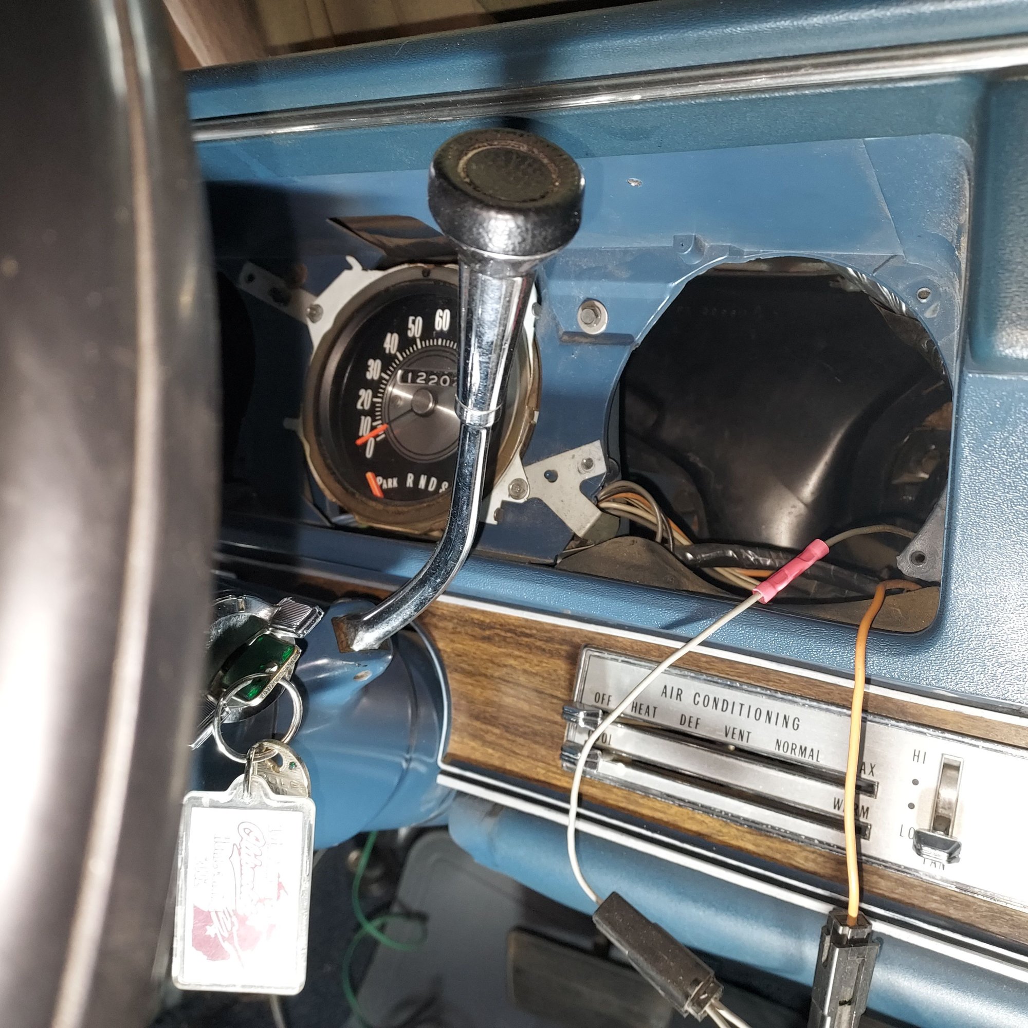

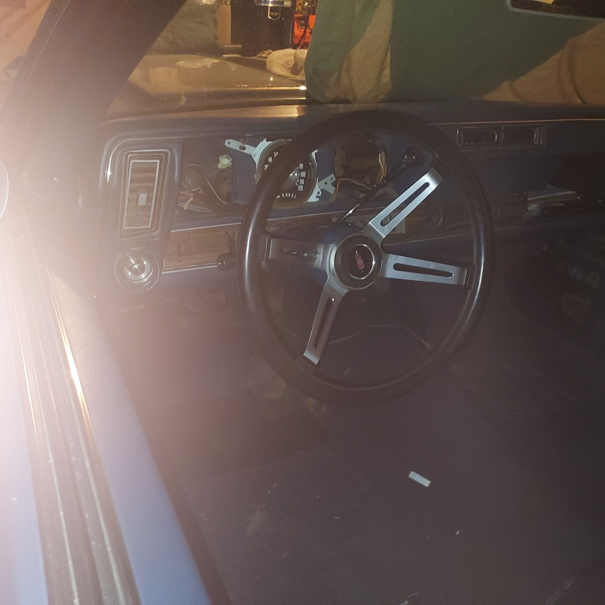

Didn't know how much hassle it was to remove wiper and top switches so I can replace wood grain trim! But finally did get apart. I ordered new trim and factory style 8 ohm 6x9 rear speaker last fall.
Roll up sleeves- right arm thru clock hole and left arm thru gas gauge hole a real PIA. Telescoping mirror and forehead light-- UGH!
This is opened up opening. Most people wouldn't even notice but I did and decided since radio is being changed I will replace it. I may not have done it if I had known what a hassle it is to get out switches!

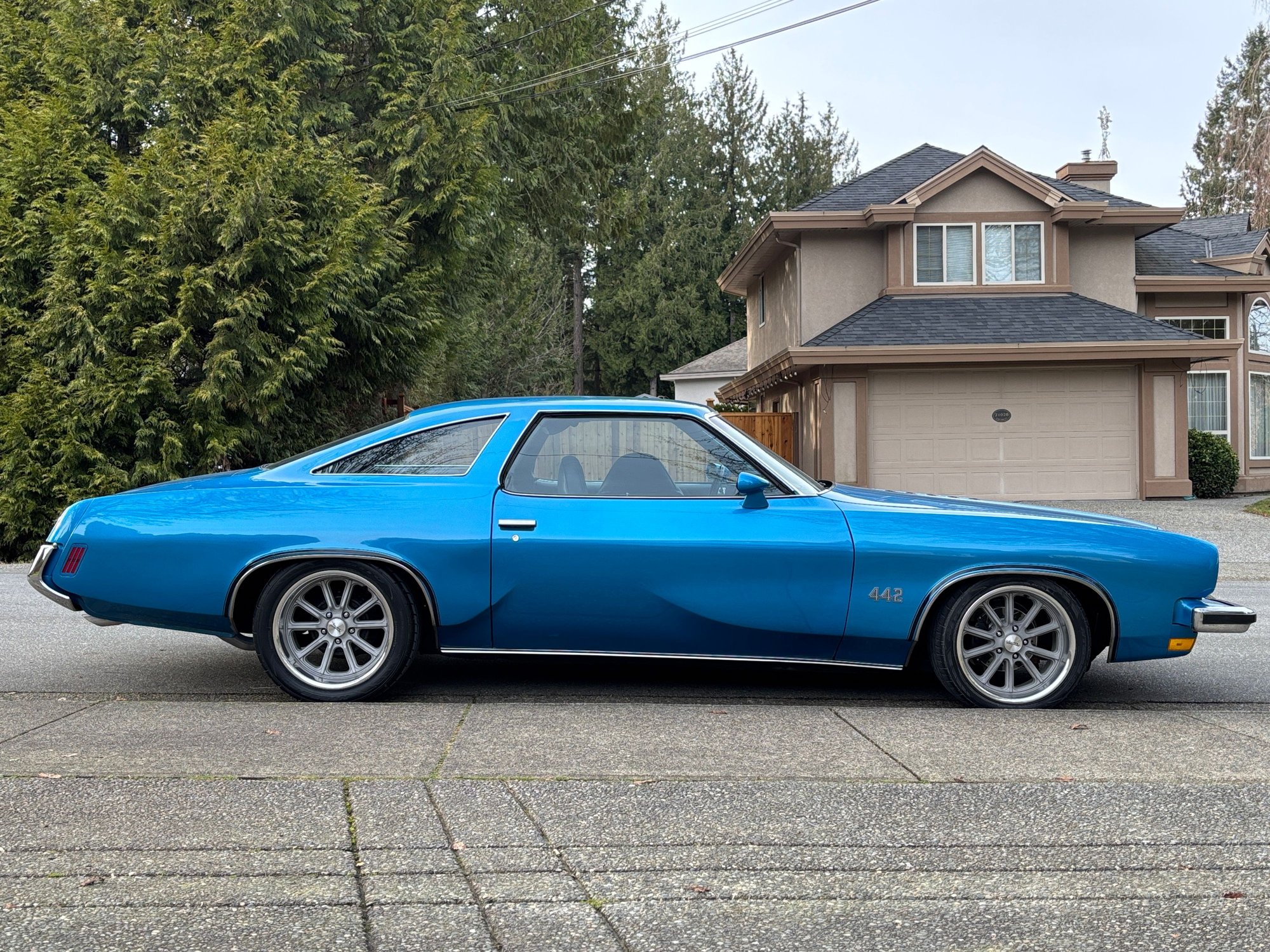

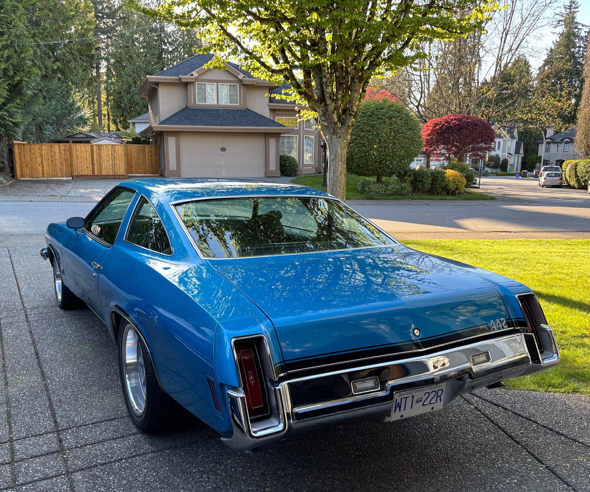

I finally drove my 1973 442 home yesterday after purchasing it in January. It was a 4 hour drive through the mountain passes with the windows down and music cranked. Glad to have it home.

I usually take lots of photos but I needed to make good time on this trip. My wife got a video of me pulling in the driveway though.

Man, that thing is AWESOME!

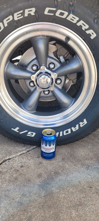

Finished up installing The Right Stuff front disc brakes and all new brake lines.
Thanks! I’m looking forward to cruising it this year.

The car looks great, nailed the stance!

I dig it. I've been thinking of upgrading my fronts. Are they 1 or 2 piston? Got a part number for the kit?

Thanks! yeah, the stance looks great. A little rougher ride than I’m used to as I usually have 15” rims and stock suspension on my classic cars. It looks awesome though.

Car looks great! Those were nice driving cars back in the day.

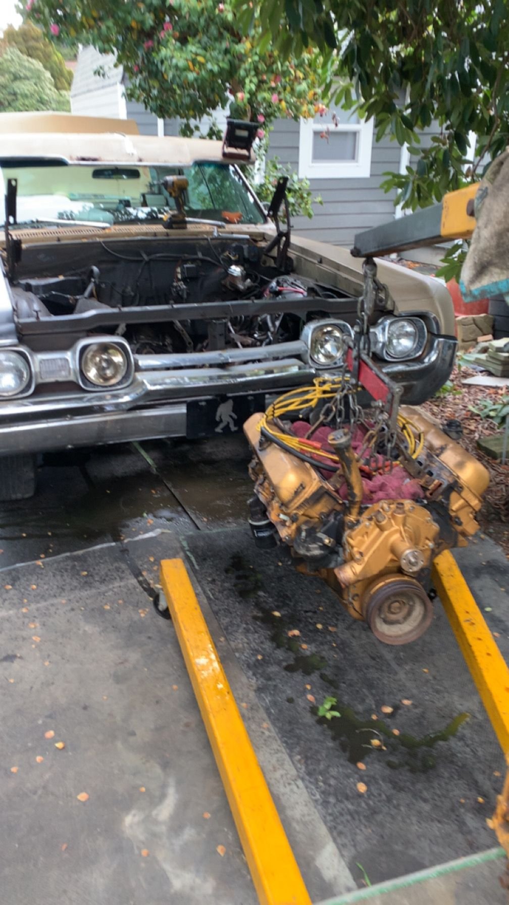

I removed the engine from my 67 today
These are "The Right Stuff" single pistons discs. This is for the brake conversion kit that I purchased - AFXDC14.
This is for the brake lines - AOP67H2.
Just a heads up, if you go with the pre-bent lines, they are made to order, not "in stock" like the website may show. So it'll take 10 days (roughly) to get them. Also follow the directions where it says to keep the lines loose until everything is together. It was a pain in the a$$ getting the lines between the master cylinder and the proportioning valve to line up if things are snug.
Originally I wasn't going to install new brake lines (which is time consuming) but I noticed that the factory distribution block on my car was mounted on the frame so I was going to have to go to the auto store a few times and guess at what I was going to need to adapt the factory lines to the new stuff. It was just a better idea (for me) to go new lines and reduce the headaches. LOL
If you email The Right Stuff sales, they team is great to work with.

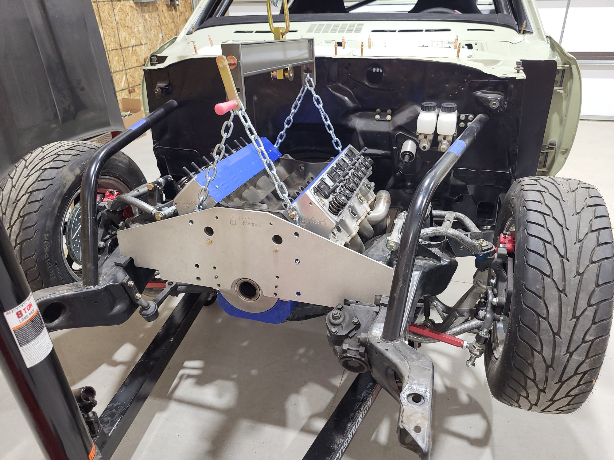

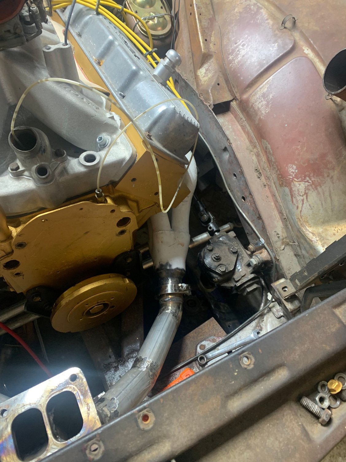

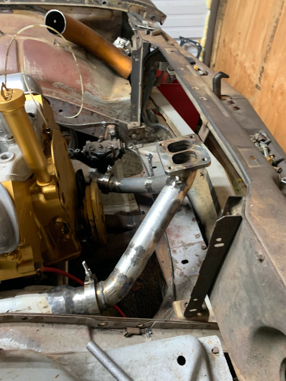

I started mocking up the engine in the old turd.

Cool, thanks. I already have all their stainless hard lines, and will probably do braided hoses.

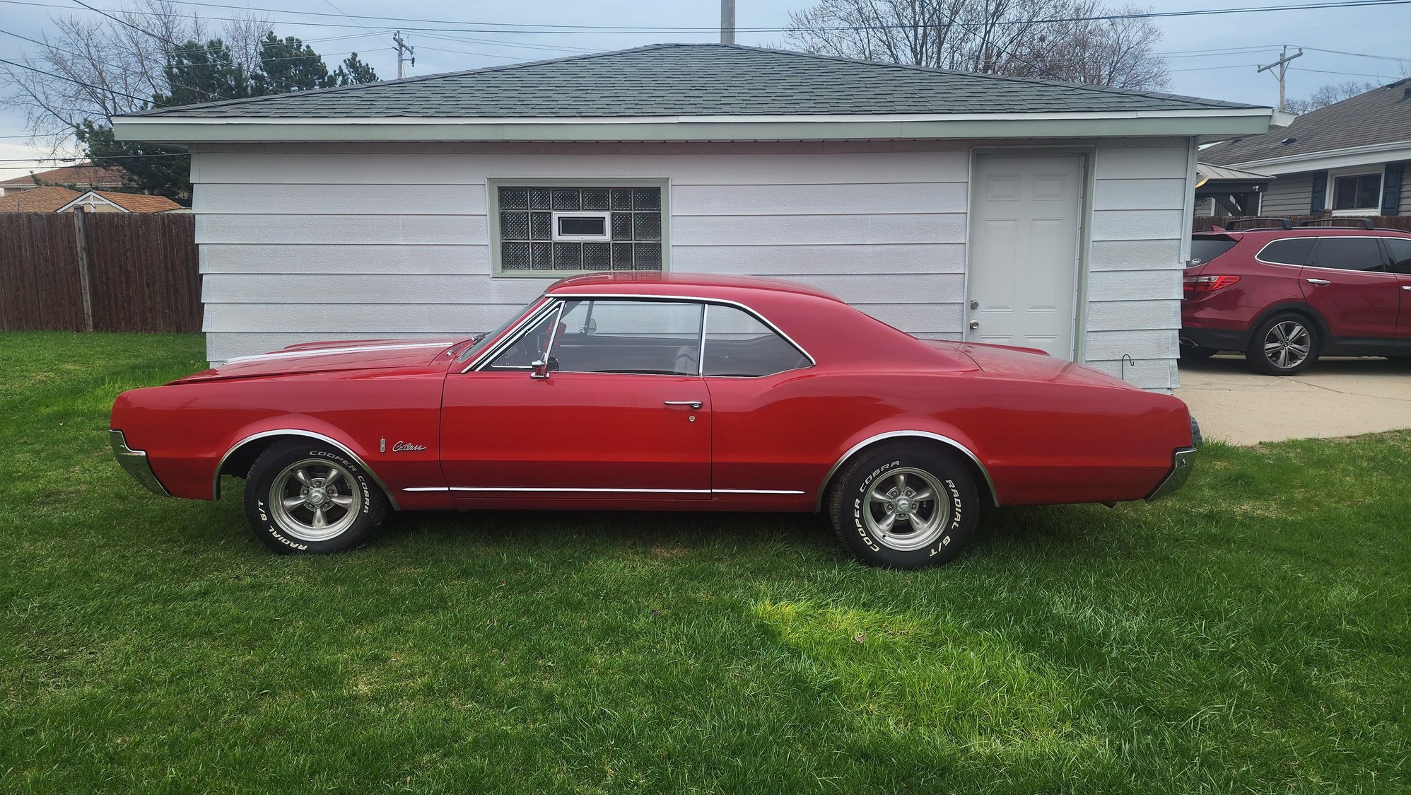

Dusted off the cob webs
Started her up for the first time in a few months. Moved from back of garage to side. Also put on my old collector plate from a 76 Caprice I used to own. I loved that car.

Originally Posted by mrjasenr
Beautiful car, I love the '67's, but I'm extremely biased!

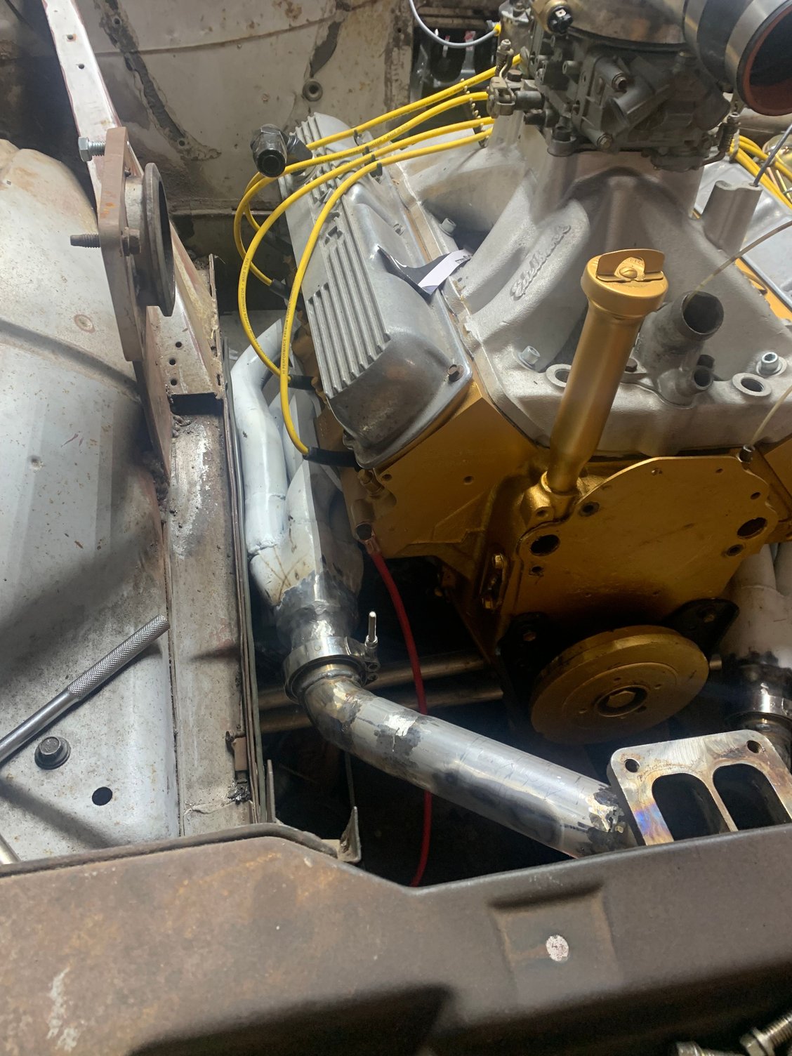

Didnt do much but I worked on the exhaust on my 62 this morning

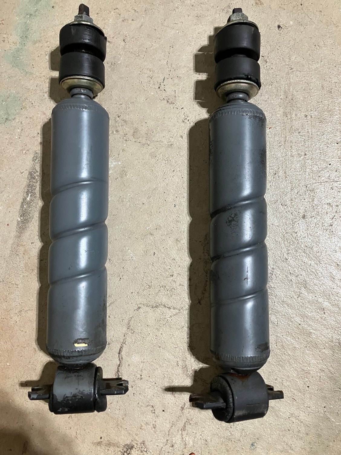

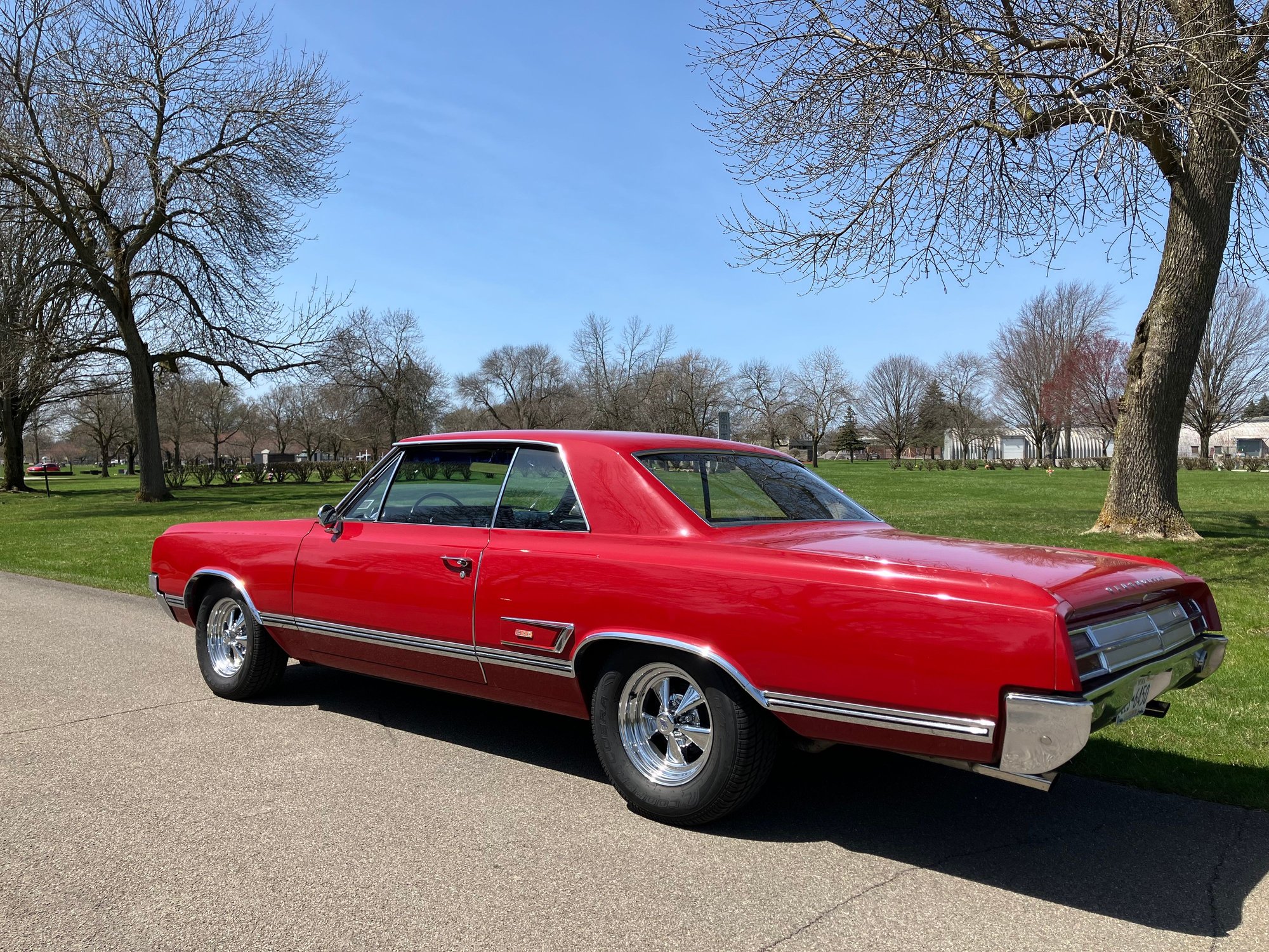

Went for a test drive this morning after installing a set of KYB gas adjust front shocks.
These are the ones that I pulled out. They look original, but after 60 yrs I doubt it!

Maybe I don't see it but why is your exhaust coming out the front?
Old Apr 21, 2025 | 07:36 AM
  #2949
Rowboat's Avatar
Joined: Aug 2024
Posts: 25
From: Wi
Looks like for a turbocharger setup

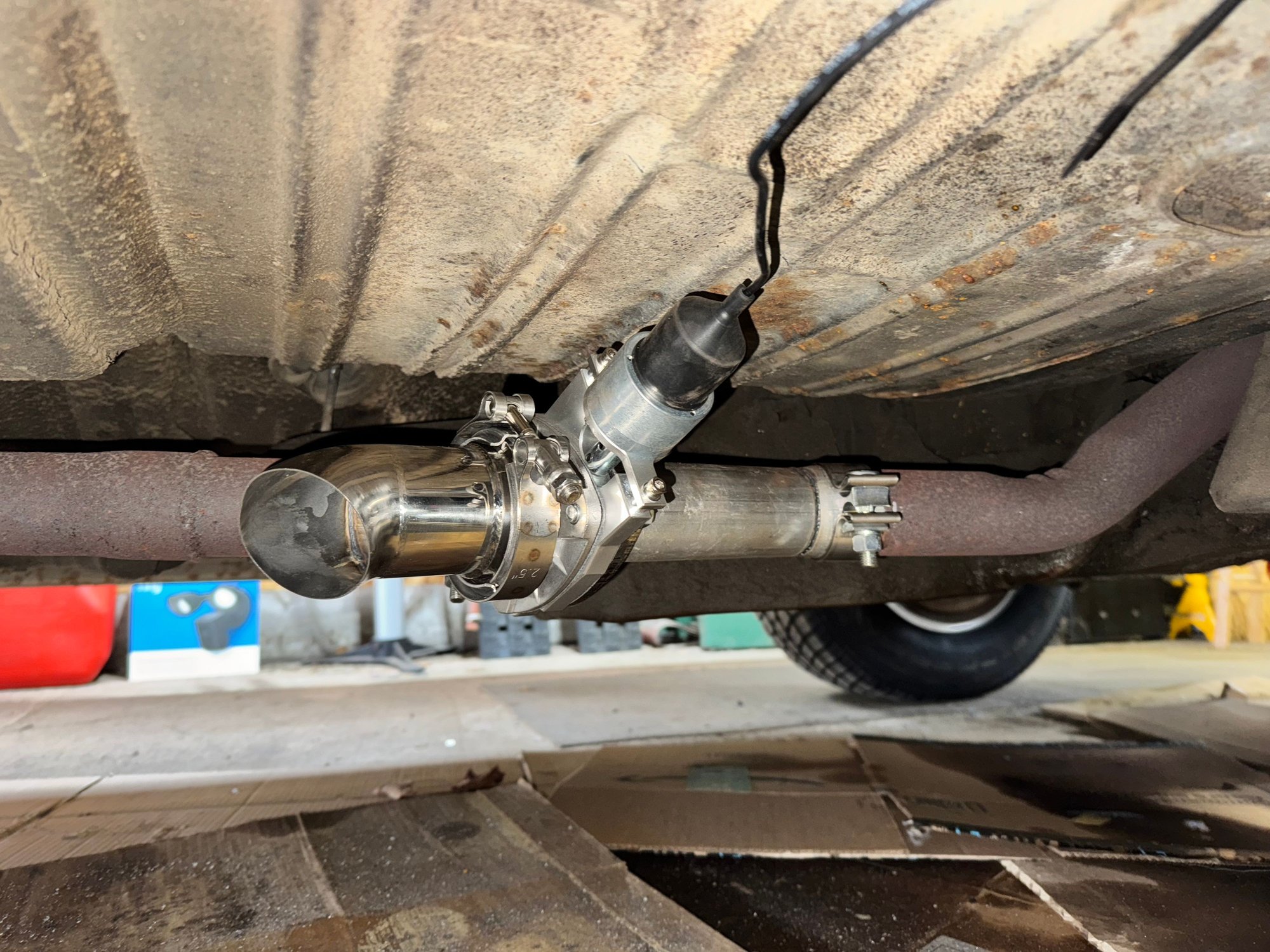

The Boy and I bolted on the electric exhaust dump that I bought him for Christmas.
just to give the 394ci a bit of character when rolling into the cruise night.
Sounds pretty good at highway speed too!

That thing looks really good and the 73 up cars have really started to grow on me. The one thing I always wanted see done was doing some Foose work and tucking the enormous bumpers on those cars. I'd love to see what it would look like with the front bumper as flush as the rear.

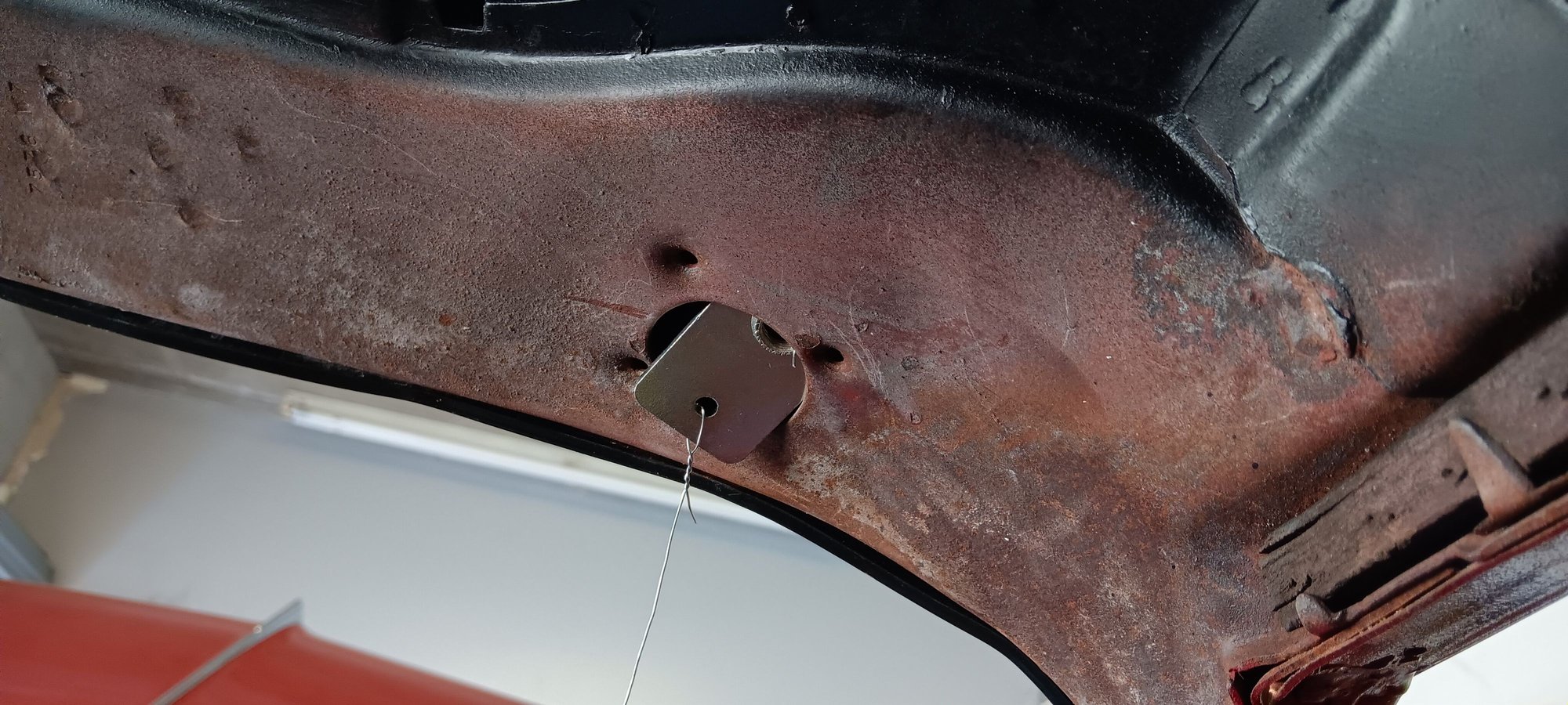

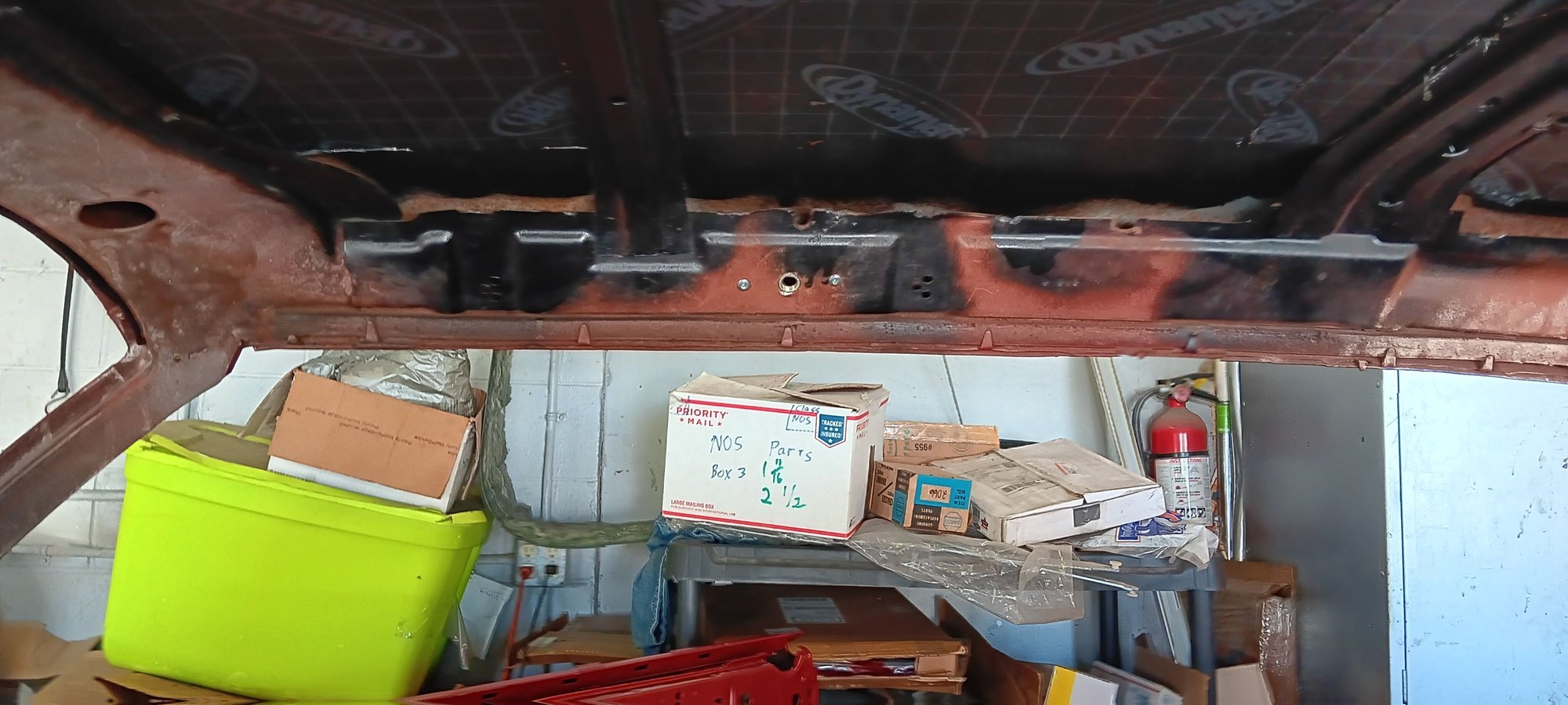

I got my shoulder harness mounting plates installed in my roof rail.
I had to slide them into the structure from the sunvisor hole using fine wire. Then guiding them in to place and riveting them in.
Now that is a cool and sensible upgrade that you hardly ever see done on and old car project.
