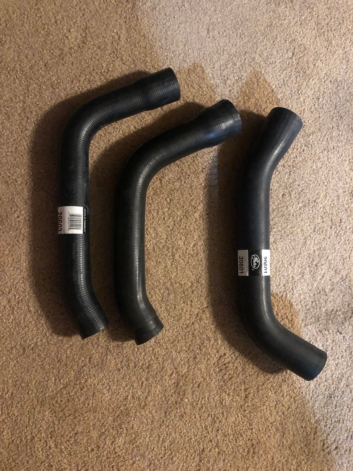

Old Sep 8, 2022 | 07:23 PM
AK71CutlassS's Avatar
Joined: May 2014
Posts: 152
Here’s what I got 603 on left. The one I need in middle. 601 on right

Old Sep 8, 2022 | 07:49 PM
Posts: 15,409
Maybe you can trim the 601 to fit? That may be what I did in the past. It looks as if the lower end is trimmed a bit that it would match the middle one.
