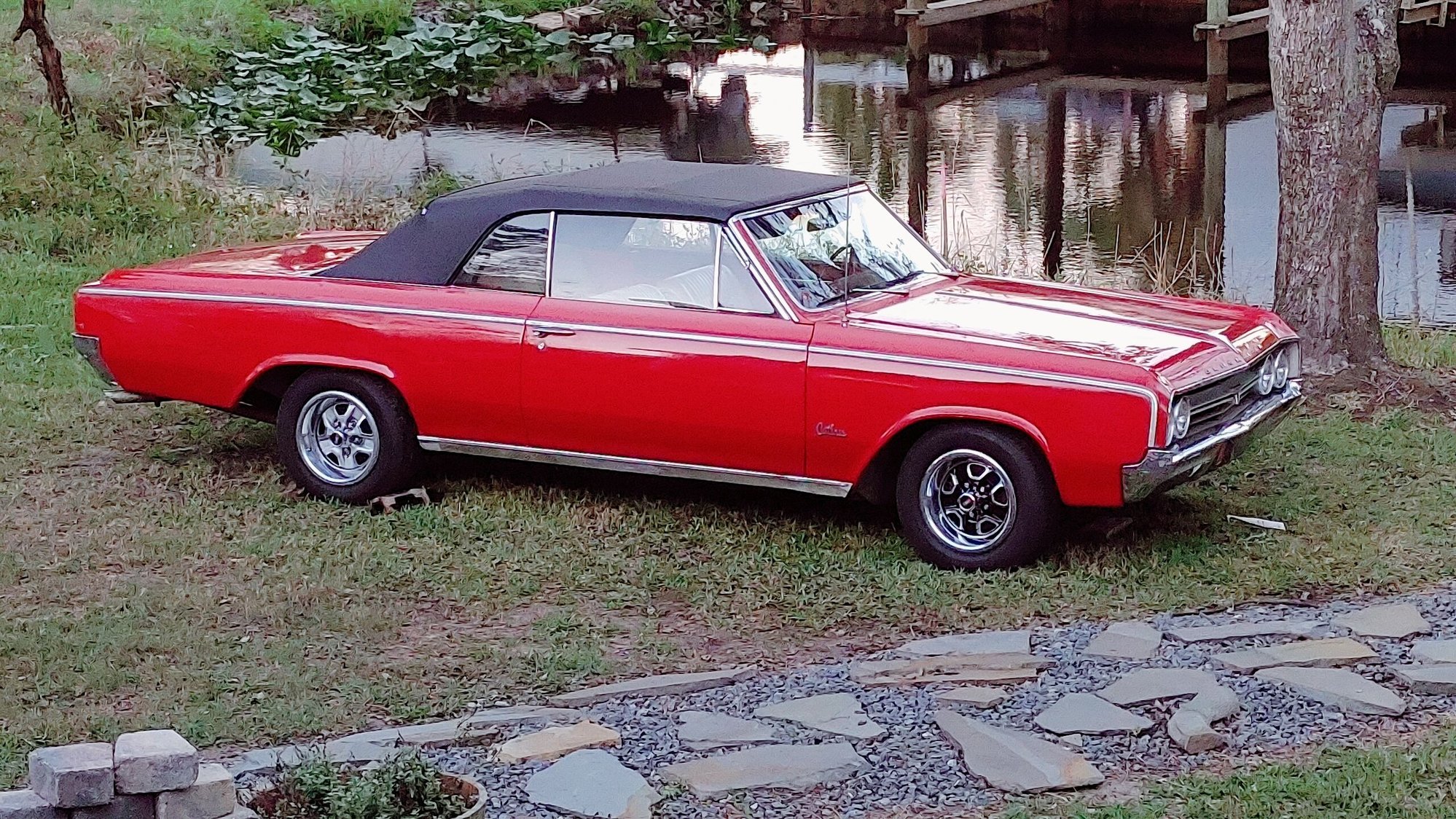

It was a beautiful day today so I decided to paint one of rally wheels black. I'm pretty sure I'm going to paint the other three!

Very appealing...I like.

no question. looks great.

Looks cool! I like it!

Looks great paint the others

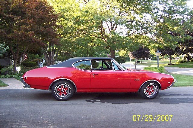

Try red before you settle on black I think you will like it.

The black looks great against the red.

Black! They look great with the black top. Nice ride!

Having a problem with the paint scratching off easily on the wheels. I'm pressure wash them and use degreaser to clean them before I painted I'm very surprised at how easily the black is scratching off. Any suggestions before I paint the other three? I used Rust-Oleum Auto enamel gloss black. Is there a better paint that I should be using? Should I be prepping the wheel differently. I really don't want to take the tires off the rims... but if I have to I guess I will. Thanks

Are you sanding them first? You need to scuff up the paint that's already on there, then prep / wipe with mineral spirits. THEN paint. That's likely why you're not getting good adhesion. Also, the paint needs to cure at a temperature that will allow it to properly set up and dry. If you're doing this in cold weather, then your paint isn't curing. I discovered that temps in my basement last spring weren't good enough for a few underhood components to cure properly, so I had to bring them upstairs.
