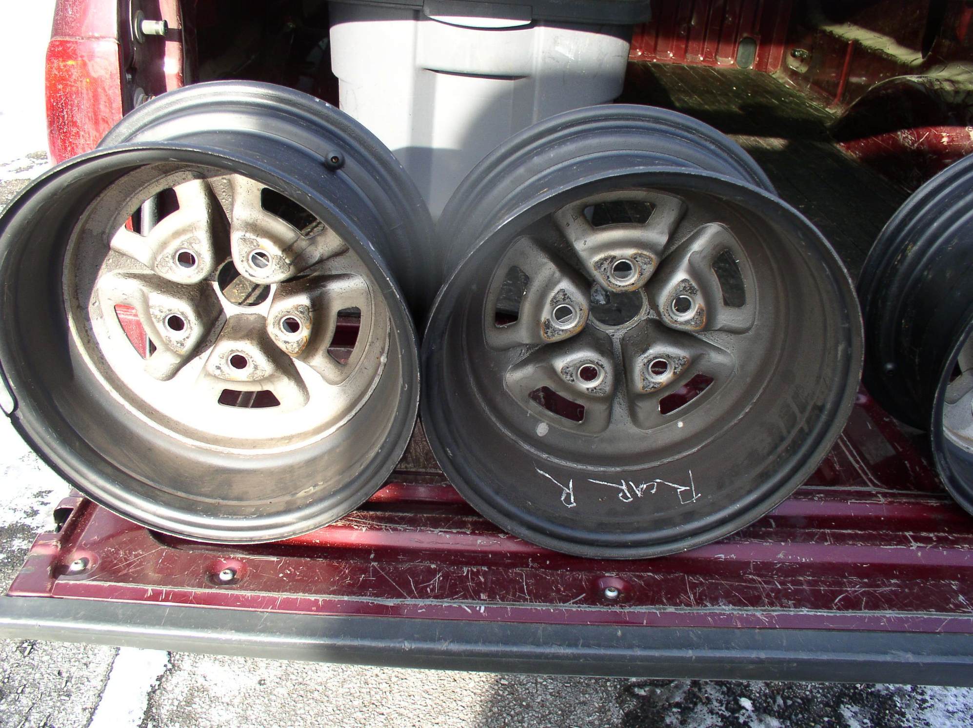

Just picked up a set of 5 SS1 wheels and the wheels need some help, paint has chipped off and looks a bit discolored etc. When I repaint the wheels do I use flat, semi-gloss or gloss black paint.

Semi or reduced gloss. The flat will not clean or wax well. Make sure the surface is prepped good and it's really clean before painting. Don't skimp on the paint quality.

The way I did the SSI wheels on my '68 and '69 was to use spray-on paint remover to take off all the old black paint. I cleaned the wheels after that, taped them off, and then used Zero-Rust black primer and Seymour GM chassis black, both out of a spray can (the GM chassis black color has a bit of a shine to it), and sprayed away. I thought the wheels turned out quite nicely and have received compliments on them from others as well. Those earlier SSI wheels are less labor-intensive to do as the only painted parts are the 5 segments in the center of the wheel - the rim is chrome inside and out.

If you're looking for something you can pick up at the local parts store, try Dupli-Color Engine Enamel with Ceramic - DE 1634 Low Gloss Black. Looks great on those rims and in the engine bay. I'm sure we all have our preferences and that's mine! Also, I've tried the masking kit to mask off the spokes when painting the centers but have had just as much luck with blue painters tape and a fresh razor blade.

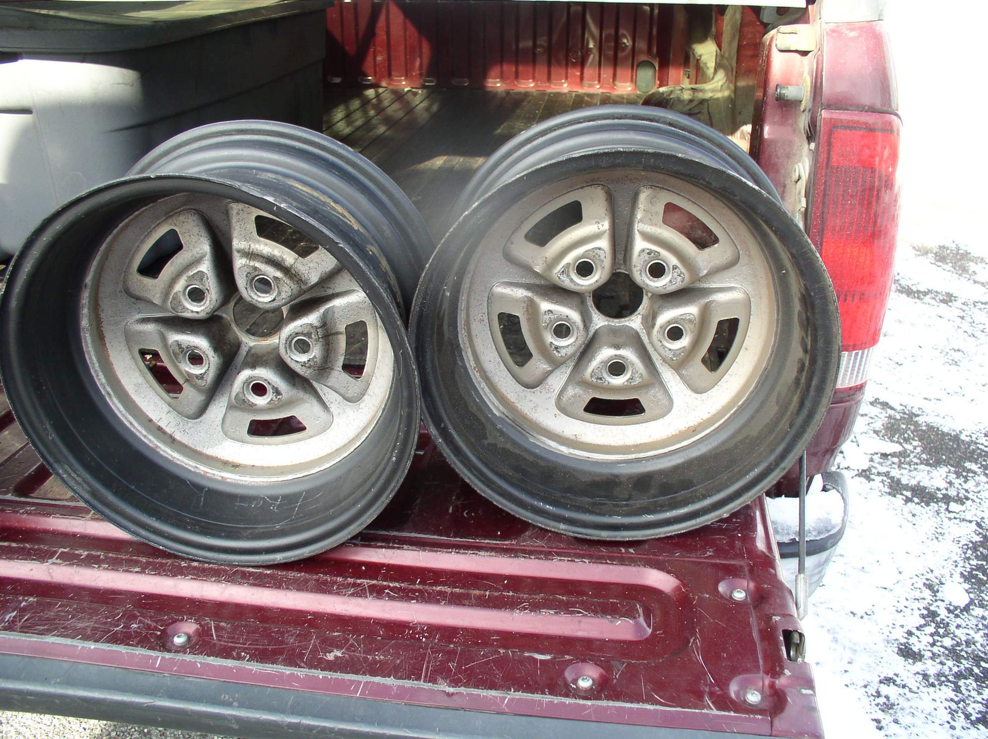

Here is what I did to mine SS1 wheels:
1. Two layers of duct tape on the spokes, carefully trimmed
2. Light sandblasting to remove all of the original paint
3. Cleaned thoroughly with soapy water and dried.
4. used wax and grease remover on sandblasted areas.
5. Two coats of Duplicolor self etching primer
6. Two coats of Eastwood Rally Wheel black.

If you are looking to "have it done" I would recommend that you consider having them powder coated. It will last forever.
