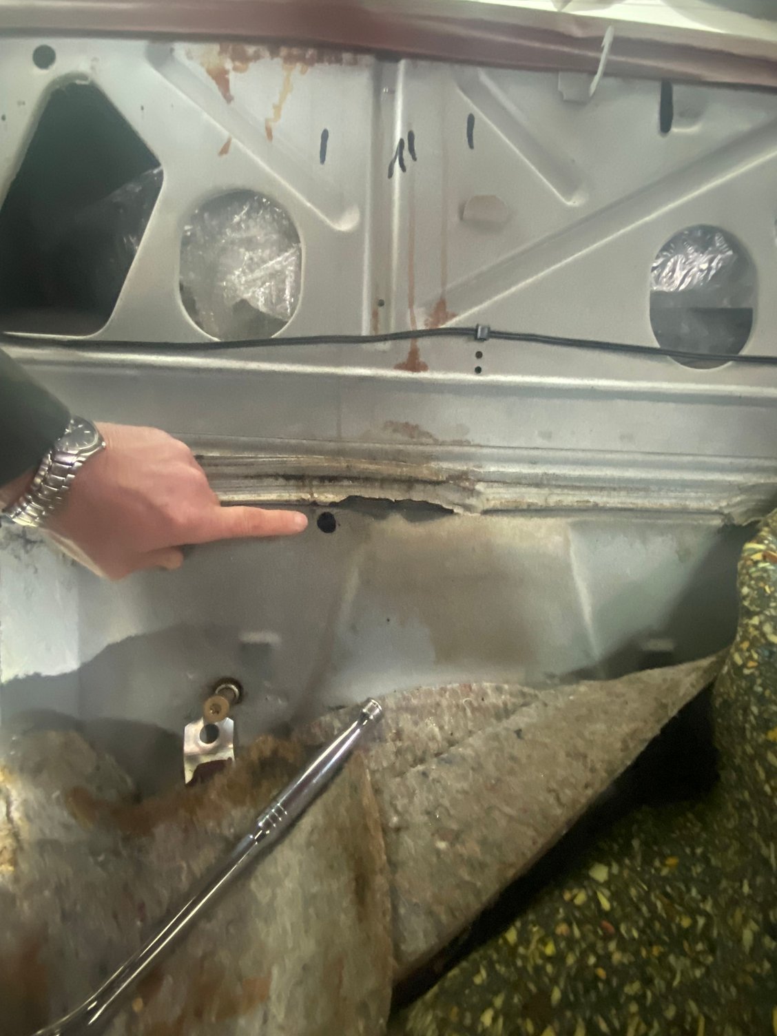

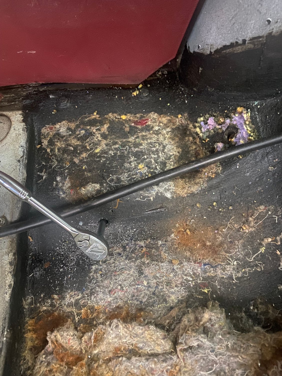

Old Feb 16, 2025 | 12:32 PM
Tuffnut's Avatar
Joined: Jan 2011
Posts: 277
From: Paris, Ontario, Canada
Here are the holes I drilled to remove the bolts out of the clamps. Used 1/4” drive 1/2” socket. Pushed the 1/4” extension through into the 1/4” drive 1/2” socket.
If I can’t get the clamps back on those 2 areas, they may have to wait until I or someone else puts them when they do the body mounts sometime.
