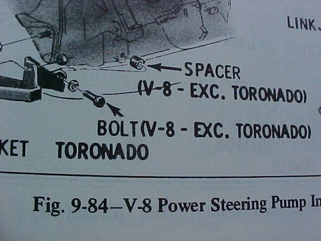

Old Mar 20, 2014 | 08:43 AM
You have apparently failed to properly install the two spacers between the PS pump bracket and the block. One goes on the lower stud on the front cover and the other goes under the tab that bolts low on the side of the block. This is a common problem and a frequent question here. Search will turn up photos and diagrams.

The lower PS bolt and spacer is hard to access and hard to see unless it's on a lift, and easily lost when the bolt is removed.

spacers- plural

Originally Posted by Octania
spacers- plural
thank you this is really going to help i have been looking for something like this for a while but couldnt find one
