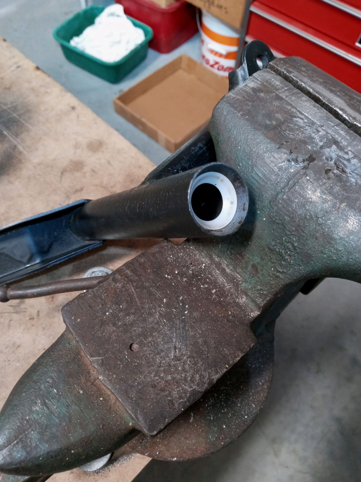

Anybody ever have this issue? The Z-Bar is too long to fit.
'72 VC, 455.
Z-Bar is for 70-72, measures 7.75" long.
Z-Bar pivot stud measures 2.41"
The frame bracket seems to be where it belongs.
I am thinking about cutting the tube down and attempting to replicate the bevel on the inside diameter.
Old Oct 1, 2024 | 01:21 PM
Blue442's Avatar
Joined: Dec 2010
Posts: 125
From: Maryland
Excuse me if you know this already. I put the Z bar on the engine stud first, then feed it into the frame bracket. If I remember correctly the threaded part of the Z bar that fits into the frame bracket is flat on the sides to fit into the slot on the frame bracket. I think I thread the star washer and nut on last. I also grease the engine stud and any areas where there is movement. Never had a problem installing the Z bar though it is tight going on the engine stud. Also note, I think the white “washer” inside the Z bar should sit deeper in the Z bar to match the ball stud inserted depth.
Scott
Old Oct 1, 2024 | 01:34 PM
Blue442's Avatar
Joined: Dec 2010
Posts: 125
From: Maryland
I should have also pointed that, fully seated, the ball stud should extend out from the block about 1 3/4”. From the picture yours seems correct.
Scott
Old Oct 1, 2024 | 01:38 PM
oletrux's Avatar
Joined: Sep 2018
Posts: 156
Thanks Scott. I wondered if the ball could go deeper into the tube but didn't want to end up with not enough pivoting angle.......I'll see what others recommend for now, but I am not opposed to trying to get the nylon bushing deeper into the tube.
Old Oct 1, 2024 | 02:42 PM
Blue442's Avatar
Joined: Dec 2010
Posts: 125
From: Maryland
It’s been awhile since I did a Z bar, but I think I remember a raised area/ledge inside the tube that the bushing rests against. You might want to remove the bushing and look inside or feel with you finger for confirmation.
Scott
Old Oct 1, 2024 | 05:14 PM
Loaded68W34's Avatar
Joined: Jul 2020
Posts: 1,942
From: Pennsylvania
The block side of the z bar does not get a bushing at all. Both bushings go on the frame side. The frame side keeps the bar from moving left to right. Pull the bushing out of the block side and it will go right on.
Old Oct 1, 2024 | 06:36 PM
oletrux's Avatar
Joined: Sep 2018
Posts: 156
Thanks Tom. Raises another question: The z-bar does not line up very well with the engine stud. Is that a normal issue, or is it an unforseen problem?
The transmission isn't installed, but I'm pretty sure I have the engine jacked back up where it normally lives when the crossmember is installed..........
Also........the frame bracket is an aftermarket part, and is made from 3/16" or so flat bar. Is the original equipment that thick?
Thanks guys, I need the education.

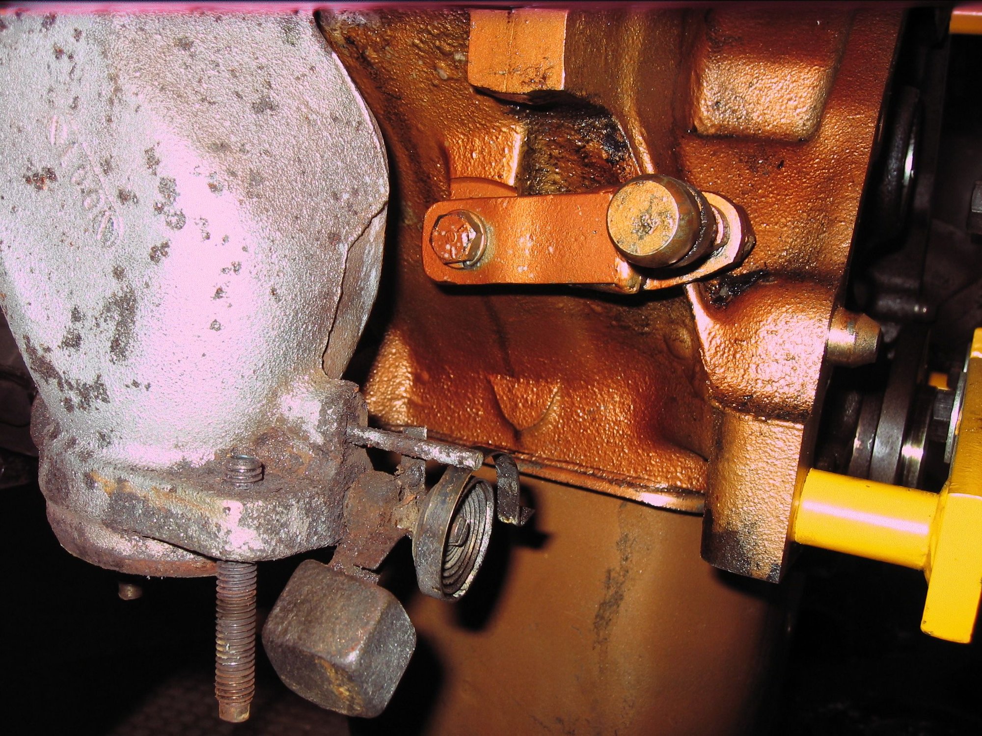

Z-Bar stud on 76 455
This setup was on a 76 455 in my 69 442 when i bought it. Looks simple and worked fine.
