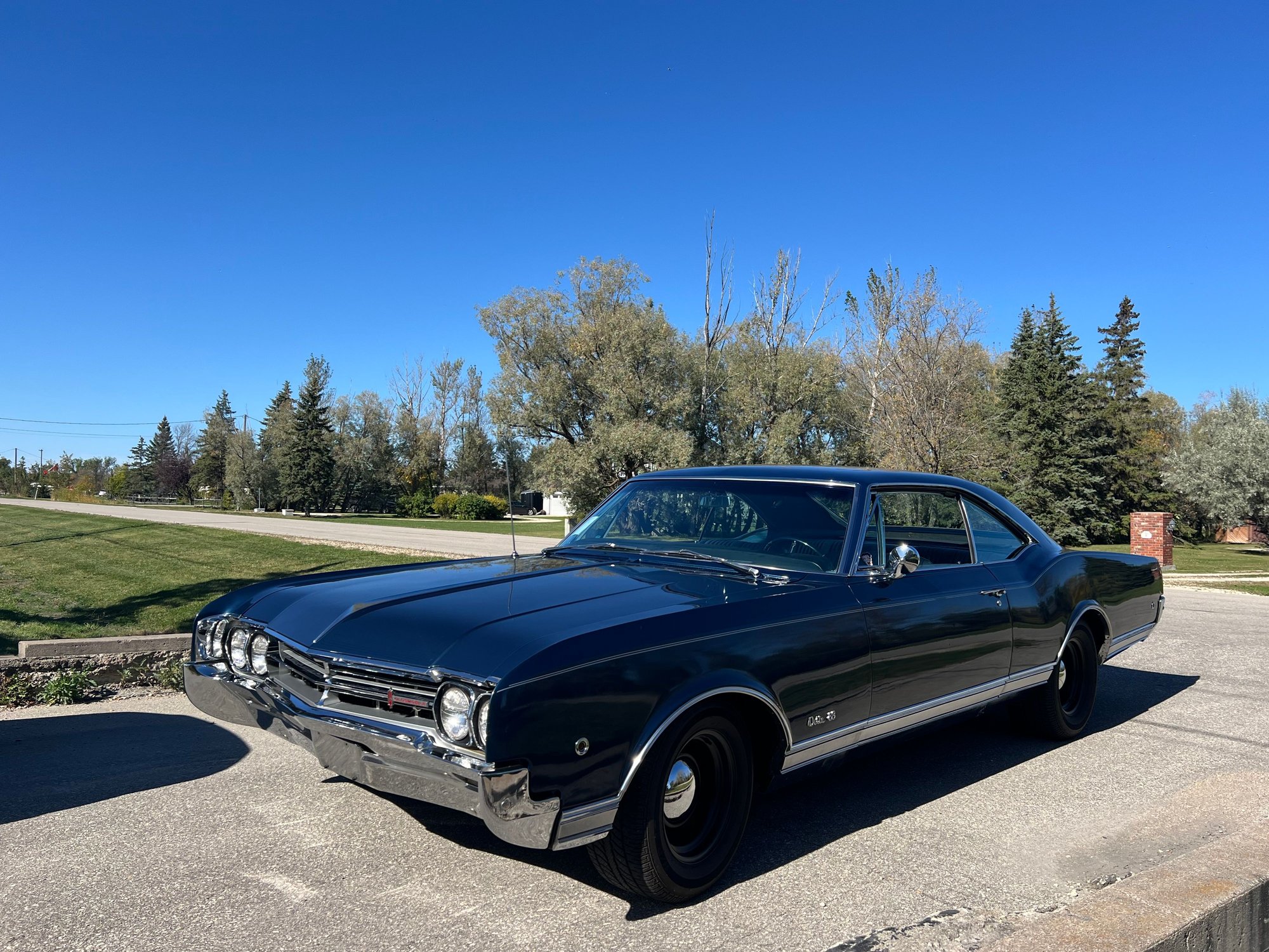

My son and I recently purchased a 1966 Delta 88 Holiday Coupe
with a 425 cu in 4 barrel engine in it. As far as we know the engine is stock with a rebuild done a few years ago. We have been told it was bored out 0.30 over and that’s about it. When sitting for a day or two it’s requires about 5-6 kicks on the gas peddle to start, even then there’s some cranking going on. Once it does start it stays on high idle for quite sometime. Seems to idle okay but after driving for a bit and the engine is warm while in gear it gets really rough. Because all we’ve done so far is drive and enjoy it we haven’t really dug into anything yet. The car seems very sluggish, when driving and under hard acceleration the trans kicks down and it really doesn’t go anywhere. Off the line it’s also a dog. We are looking for a starting point as we will be starting our work on it this weekend. Wish I could offer more information but we haven’t delved into anything yet.

Oh man, that is a good lookin' car!

Agree with both responses re: a tune-up and it is a GREAT looking ride!

Awesome Olds!

I also concur with the others that it's a very nice car.
