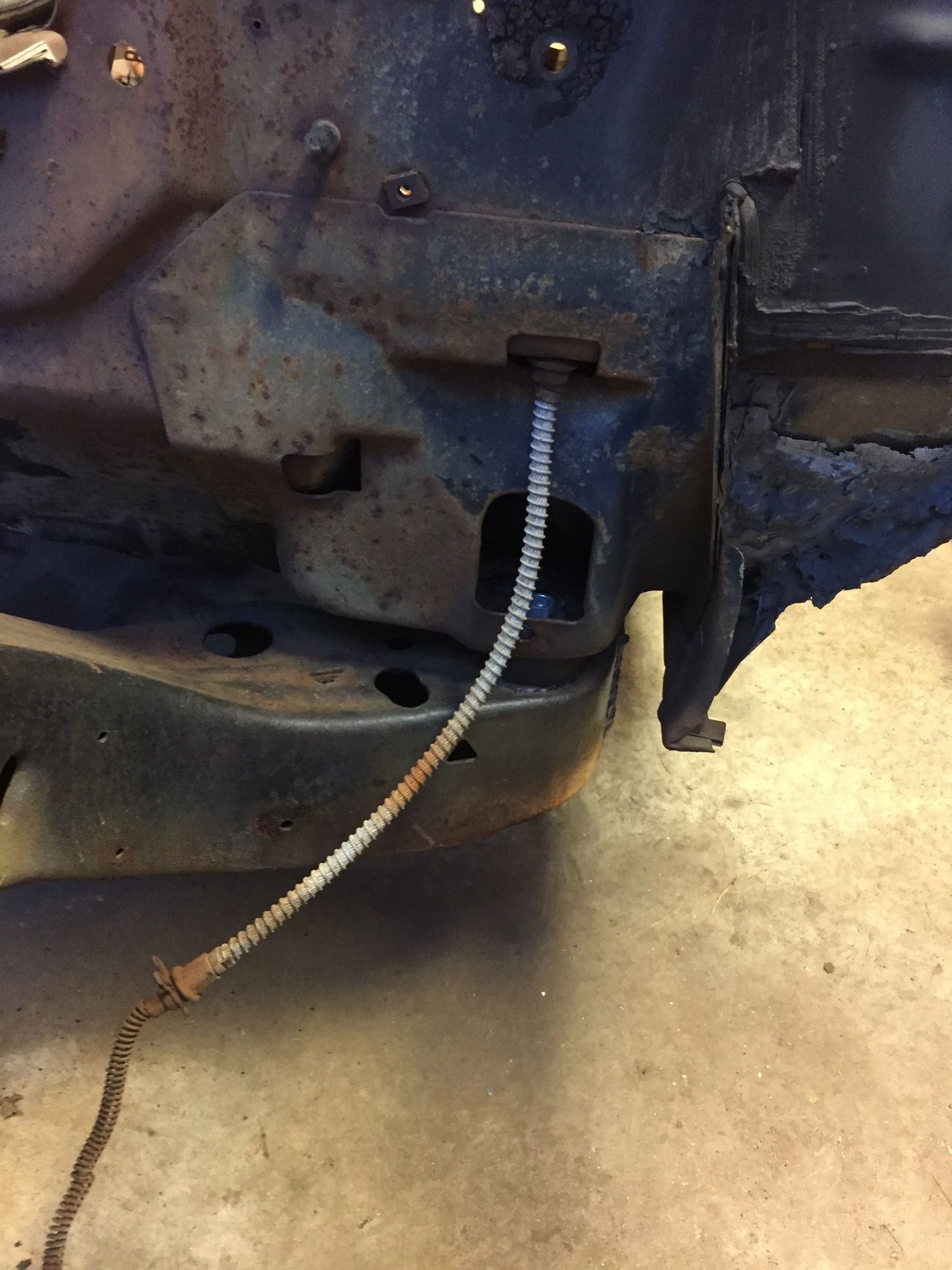

Anyone have a remedy for taking the emergency brake cable out of the firewall on a 71' A body? I tried sliding a 9/16 12 point socket over it and i tried pliers. No luck.

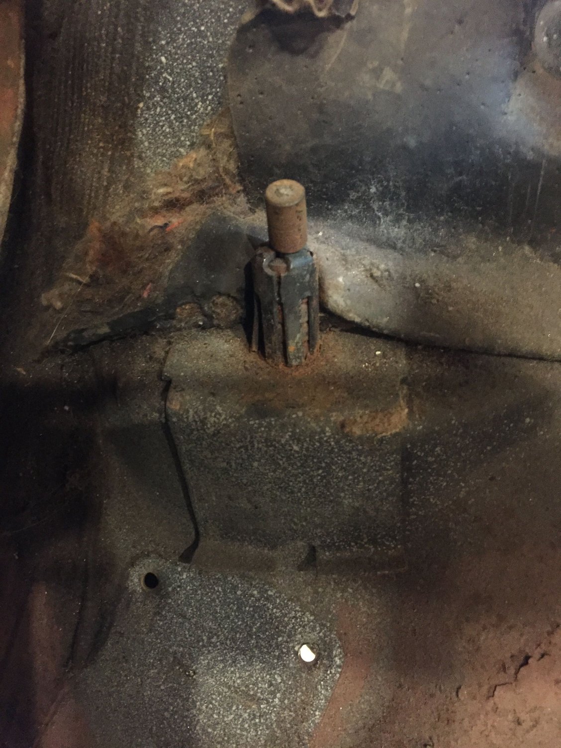

Small Hose clamp or pry with flathead screw driver as you pull

Tried screwdriver. But I didn't think of the clamp, thanks. I'll try that tomorrow.

Quick71442 the clamp worked, Thank you.
Roger I'm in the process of tearing it down for a frame off resto. Not sure what I can still get so I'd rather not destroy anything if it can be avoided. I had a tread someplace but it was moved to newbe and I can't find it so I haven't posted any pics. I think it was something called ''1971 442 back from the Abyss''.

I think the 12-pt socket was part of the problem, I used a 6-point deep well (on the rear backing plates too) just fine. A little WD-40 helps too.
