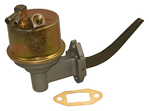

Hi everyone,

More importantly, the issue with E-brock heads hitting the fuel pump only comes up on SMALL BLOCK Olds motors. The shorter deck height of the 330/350/403 motors causes this interference. I'm not aware of any such interference on big block Olds motors like the 400 or 455.
The fuel pump is installed correctly as you describe it. The ones you have been looking at on the web are Chevy motors, which are completely different.
Check the block casting number on the small shelf above the water pump, where the oil fill tube goes into the block. That will tell you what block you really have.

Thanks for your response. I double-checked everything and called Dick Miller Racing and Rocket Racing for advice several time this week. Got great info. However the problem with the Edelbrock 60519 head hiting the stock mechanical fuel pump is apparently well know in the Oldsmobile racing community. There is no other mechanical fuel pump that will solve my problem. Most people apparently have the abutting part of the head ground down. I do not want to do that. Thus it looks like my only solution is to go to an electric fuel pump.

Note that there are different style "factory" fuel pumps that have different size bodies:
Large body Airtex 40736:
Small body Carter M6109:
Well, at least not one that you know of. The RobbMc pump was specifically designed to fit:
http://www.robbmcperformance.com/products/olds550.html

Thanks for your input. Had checked online before and rechecked today. Also read multiple forums on lack of clearance between the Edelbrock big block heads and the stock mechanical fuel pump, specifically on the 1970 Olds 455. There are absolutely no mechanical fuel pumps that can be used without grinding down the head for about $200 and possibly weakening the water jacket in the head or deforming the fuel pump, neither of which I'm going to do.The first two pumps you mentioned all have the same clearance issues and will not solve the problem. The third, the RobbMc, specifically states in the link on the second line under specs that is does NOT clear the Edelbrock heads. It looks like I will still go with the external electrical fuel pump. Thanks again.

I found this info in a quick search. Sounds like a few folks were able to install a Holley mechanical pump with no clearancing and others used a Carter pump with no/minor filing. The mention of dimpling the pump sounds interesting.
https://classicoldsmobile.com/forums...gh-volume.html
https://classicoldsmobile.com/forums...mer-heads.html
https://classicoldsmobile.com/forums...endations.html
https://classicoldsmobile.com/forums...der-heads.html
Same with mine with a Carter muscle car stock style pump. Just a little filing was done.

Thanks for everyone's input relative to the Edelbrock 60519 cylinder heads abutting the stock mechanical fuel pump. I talked with Edelbrock today. They had no internal Edelbrock solution other than notching the pump and/or the head, which I think is ridiculous on their part. However, reluctantly they said that Mondello made just the pump that does not abut. I called Mondello who, in fact, state that they do make the mechanical pump that fits without abutting. Actually, if you buy the heads from them, the pump is included in the sale. Consequently I just ordered the pump ($110) from them which will be here tomorrow A.M. In the future I will probably just deal with Mondello and not Edelbock.

I did have to notch the head just a tad. Nothing extreme, maybe an 1/8 inch and just on the edge, you can barely see it. Also it is down below the alt of which hardly anybody will see.
