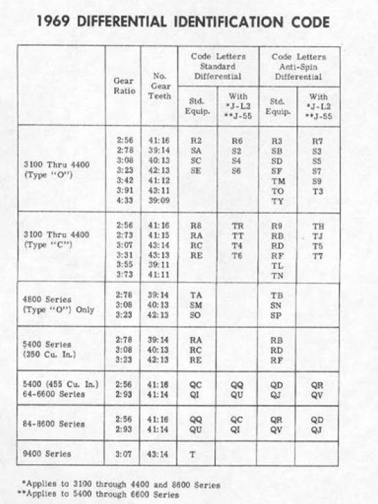

Download the 1969 442 info kit from GM.
Code for 12 bolt 3.73 appears to be "TN"

I don't know. The JL2 breakout only seems to be listed with Type "O" differentials and not with the Chevy 12 bolts. You need to get a copy of the 1969 PIM.
What code is on your differential?
Here's another chart from Oldsmobile Rear Axle Id
