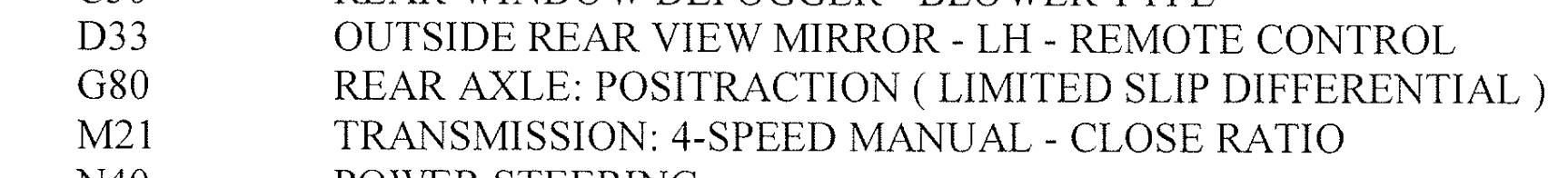

So I forked up the $$ and just got the results back.
Unfortunately, I believe I need the code off the axle to get the ratio unless I am missing something. (G80)

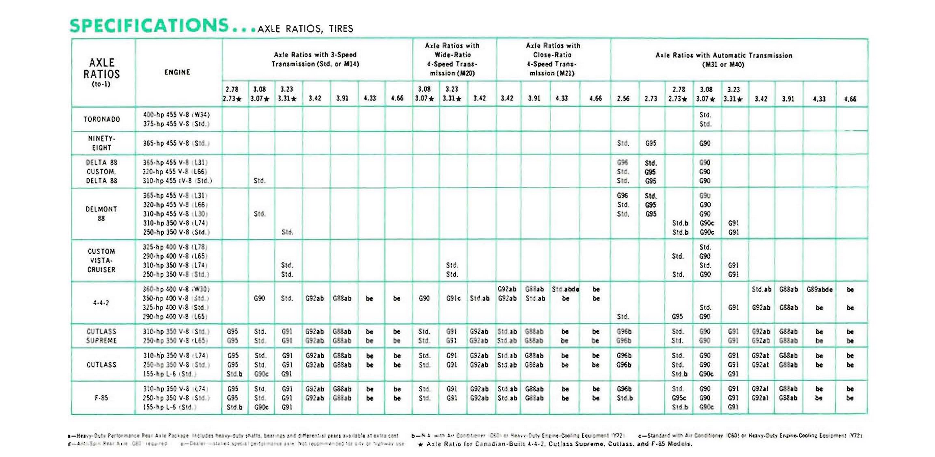

If there is no RPO code for the rear axle ratio, it would be the standard equipment ratio, which would have been 3.42:1 with M21 trans, as seen in the chart in post #4.
Old Mar 18, 2024 | 11:56 AM
tkcutlass's Avatar
Joined: Jan 2020
Posts: 1,277
From: CT
I know I am old and senile but doesn't that chart show the 3.42 is std for the M20 and 3.91 for the M21?
Old Mar 18, 2024 | 11:58 AM
You're right, sorry, I was looking at the wrong column. That's what I get for posting when I'm supposed to be on a Teams call...
I think Canadian built 68’s with M20’s got 3.07’s as the standard gear or 3.31’s if it had a/c.
it may have 3.31’s or 3.55’s if it’s still got the original rear

Does this apply to the "Type C" as well or does the G80 mean it's a Type O?
I have seen info that states 2:56 2:73 3:07 3:31 as the ratios available for the type c
Old Mar 18, 2024 | 12:51 PM
CANADIANOLDS's Avatar
Joined: Sep 2013
Posts: 2,928
Those gear ratios are for type C only as it’s Canadian built. G80 only means it’s posi traction

Just noticed the fine print on that chart with the star indicating the Canadian ratios.
of course, there is no star for the M21.

the 69 Canadian built 442’s seem to have a clearer explanation of matching gear ratios to their U.S. built ones..
2.78 U.S. = 2.73 Can
3.08 U.S. = 3.07 Can
3.23 U.S. = 3.31 Can
3.42 U.S. = 3.55 Can
3.91 U.S. = 3.73 Can
