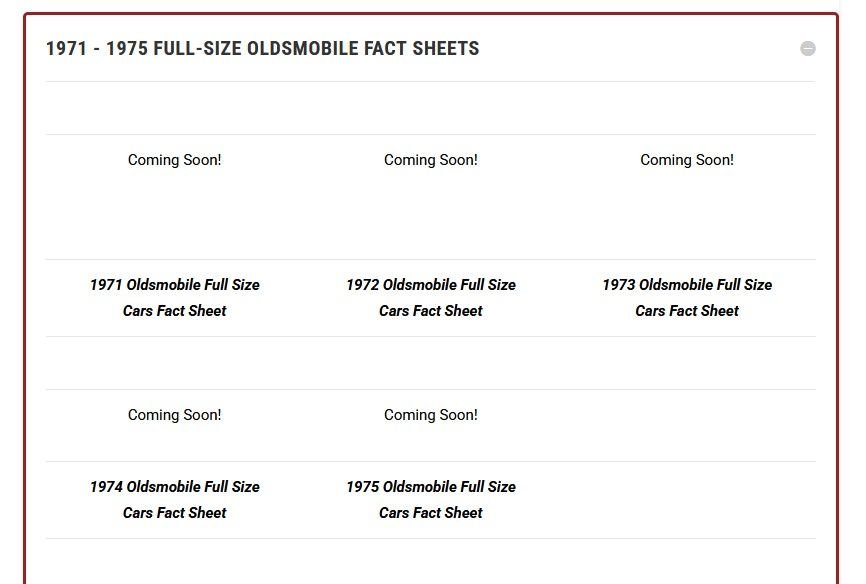

Awful lot of "coming soons" on there. I wonder how soon "soon" is.
