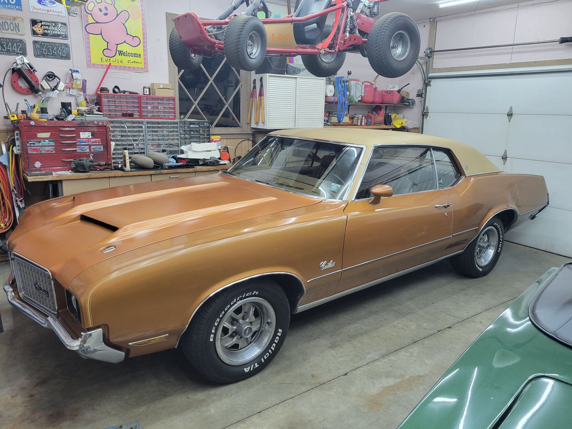

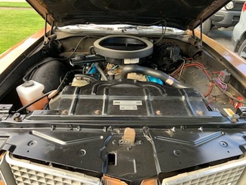

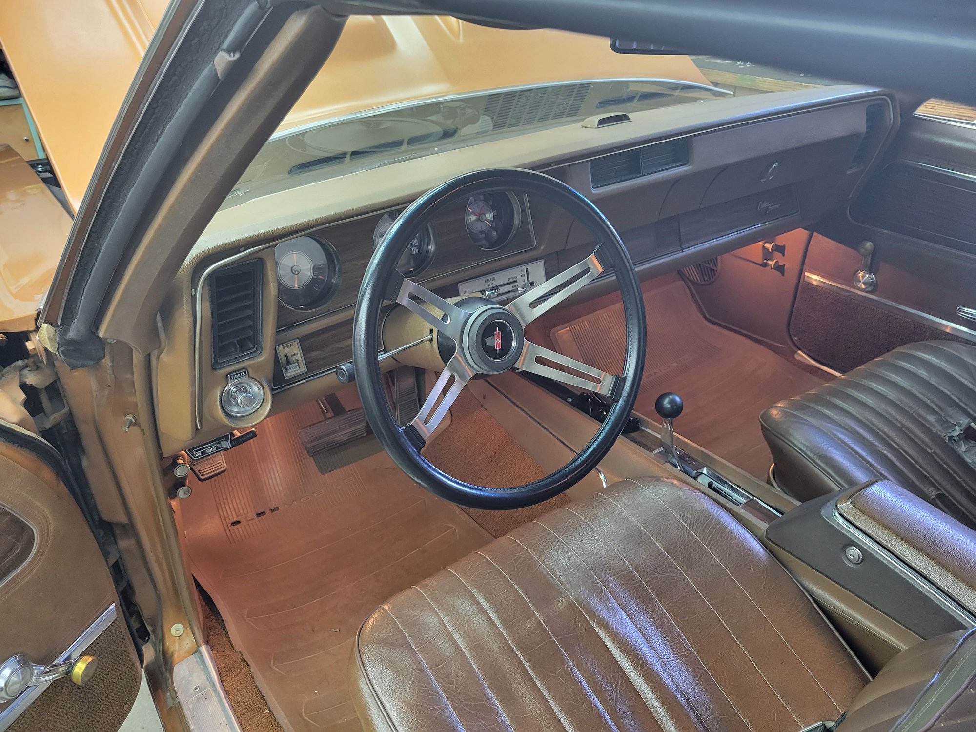

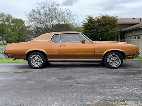

Old Jan 9, 2022 | 10:34 AM
Got pictures of your car etc?
Old Jan 9, 2022 | 10:56 AM
GN1220's Avatar
Joined: May 2020
Posts: 665
From: Kansas City, MO
Factory U code with Saddle buckets, dual gate and rally pak, posi and added OAI hood before I got it. Super solid and rust free car, other than the panel behind the window, which I do have and will be installed in the coming months.
