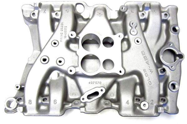

Here's a pic of an OEM W 455 for comparison

One thing I've noticed about these repro W-30 intakes is that apparently they have only one mold and use replaceable plates to change casting numbers from 1970 to 1971-72 and to change from OLDS to OLDSMOBILE on the first runner. The result is that there is a noticeable ridge around these two areas from casting flash in the gap where the plate goes. I guess if you cared, you could carefully remove this flash then glass bead the intake for looks.
That's interesting information. However I also see the 1970 is different in casting by the #3 port. Do you know what the purpose of the square cut notch is? I don't know if that is machined in or cast that way. You can just see it in the second image, but it matches the OEM pretty darn close. What I did notice is the difference in position of the lettering for the W-455 not being centered under OLDSMOBILE. The repop even has the 'snoflake' casting between the 3 & 5 ports.

Posts: 50,624
Allan,
Your comparison photos show a number of discrepancies. Not only is the W455 mislocated, but so is the FIRING ORDER. The fonts of the numbers on the runners and the firing order appear to be slightly different on the repro. The "dogbone" boss on the no. 3 runner also looks different. Admittedly some of these differences may be due to lighting issues. By the way, the square notch is machined in after casting, so it is unrelated to the mold used. You can also just barely see the casting ridge and texture difference around the W455 on the repro.

Yeah, I thought the firing order was slightly out of position and the fonts were different sizes, but I wasn't really sure so I held back on that. I couldn't tell on that boss issue, but I see what you're saying. Basically I think for the most part we're seeing the same things.
I had to look at the 70/71/72 CSM to figure out the reason for that machining - it's for an intake bolt. I didn't see it at first on the 71/72 pic from PP.
So a repro intake like the PP one would get a deduction on a concourse judging right?
