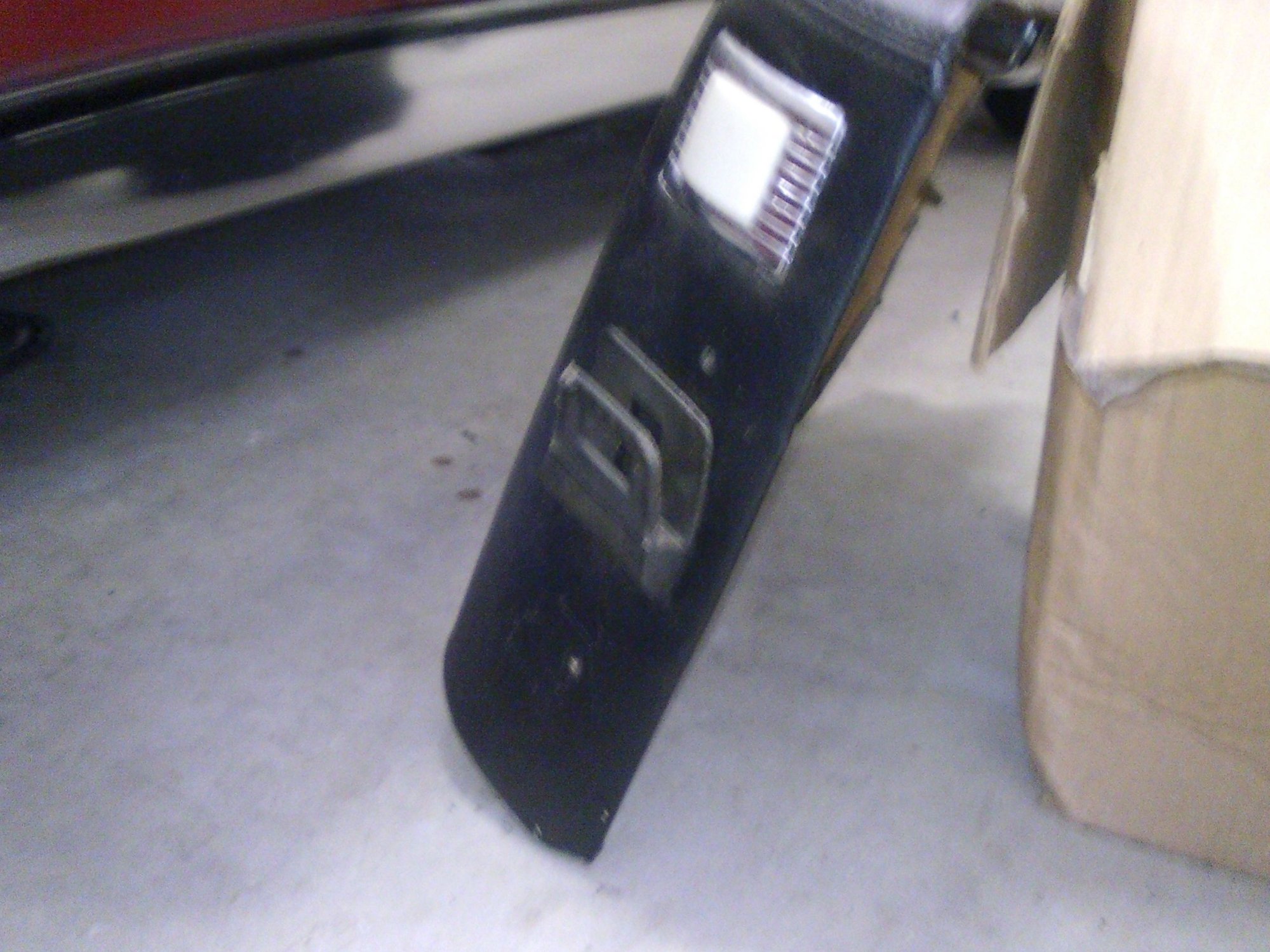

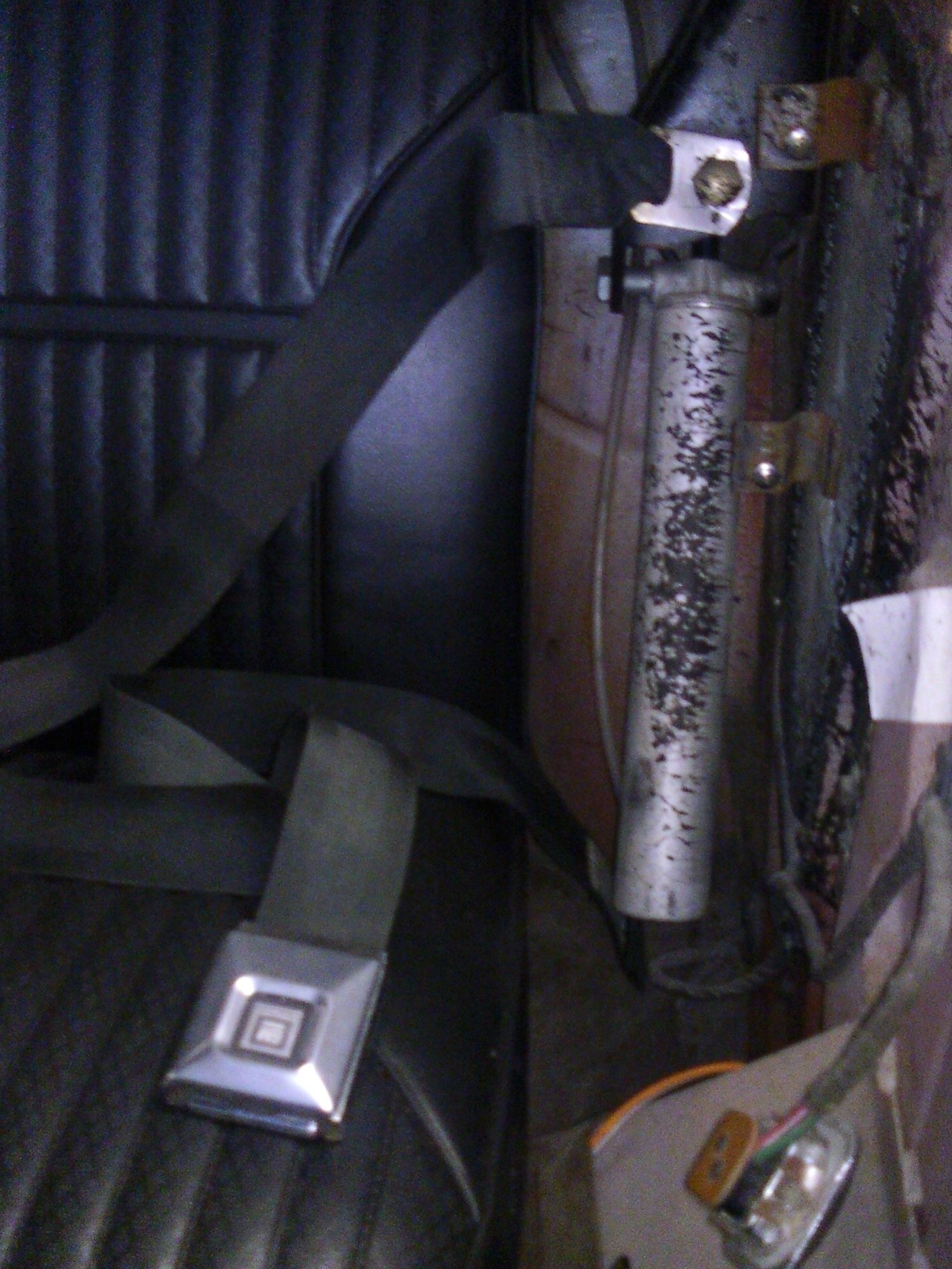

My '69 4-4-2 convertible has the optional front seat shoulder belts. Here's a couple of pictures of the driver side when I had things apart; (1) on how the shoulder belt is attached, and (2) the clip the shoulder belt hangs on when not in use. I find this set-up to be cumbersome at best. I've hardly ever used it.
Note this setup is similar to the hardtop shoulder belts in that they do not have ratcheting self adjusters; you manually adjust the belt length and then are effectively trapped against the seat back. This is a main reason why I rarely used the shoulder belts in my 70 Supreme hardtop - simple things such as reaching over to change the radio station were difficult due to the fixed restraint, and rolling the passenger window down or reaching the glove box was impossible without removing the belt.
looks like a pain to deal with. A special panel for the clip/belt holder as well?
Old Sep 27, 2024 | 08:48 AM
Posts: 26,063
Dan - It's a kludge.
