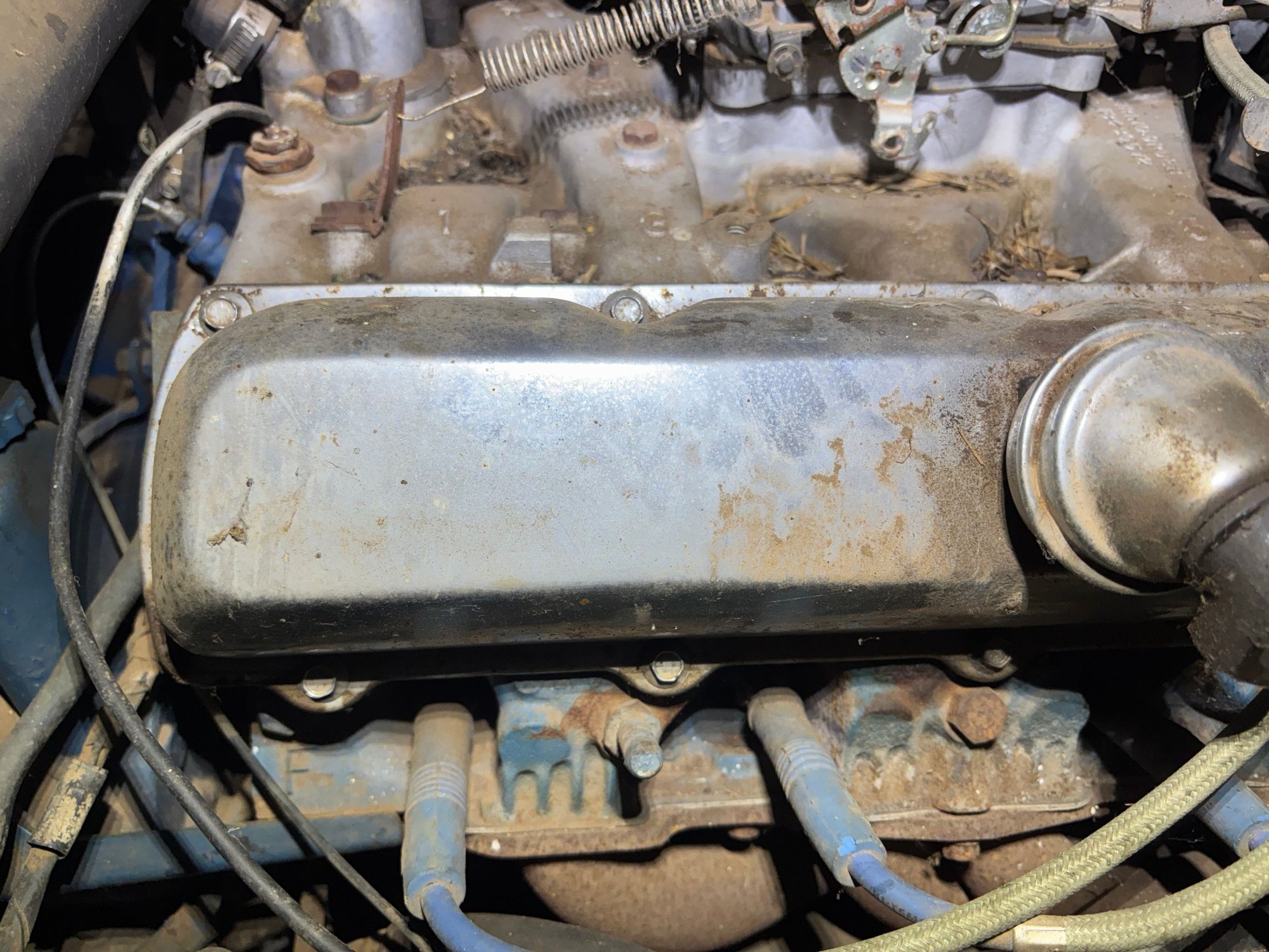

Old Nov 16, 2025 | 08:02 AM
  #58
Posts: 16,710
Looks like an F to me. Looking forward to updates when they come.

Here is the thing..signs definitely point to this car having a strong possibility of being a true, but incomplete 70 w30. There may or may not be a broadcast card stuck somewhere. Be great if there was but buy it like it isn’t a possibility. If the body is solid, the car is complete without a ton of rust go after it. There is a guy who verifies these cars for a fee..It doesn’t 100% say the car is a w30 but his rocket report does have credence. Like I said before if it’s solid, check that engine derivative to see if it matches the car’s vin, if that’s a yes, find that rear end tm code, if that’s a yes, pay the guy his 20 grand. If you want it, if not work out a finders fee and someone on this site will pay it.. F heads alone are 4500-5500 a pair.. with the red fender wells and f heads, now if the vin derivative matches, then the date code of the head matches cars build date your definitely on the right path.

Originally Posted by chevyiiguy
I don't guess I figured this forum out on how to properly respond to multiple comments. What I had just thought I posted was that I had nothing recently to add. someone asked again if they were F heads.Hopefully, I can make some progress toward the sale this week and I can share some more information with you guys
thanks again
thanks for the reply
I read about that guy. Stephen Minore? I read the hot rod article on him. At some point $1000 per car evaluation plus travel expenses?
Yep. Verified engine block last numbers to the title vin. first thing I will/would do is check/verify the rear end. Again, body looked good. I will try to bring a magnet this week if I get to see the car soon.
