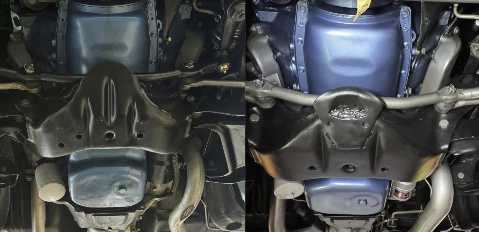

What's up with the frame front cross member??

Old Jun 29, 2024 | 06:34 PM
Posts: 12,655
Maybe he added that for floor jack use, looking at the oil pan, that's my guess.
[/QUOTE]
Hit a rock? Hard?

I believe that "dent" in the front of the oil pan is there from the factory/original production....not the result of an accident, etc.

The center frame mount, that must have hit something pretty good to cause that huge dent. Curious what that was. Big *** dent in a strong piece of metal.. The valve cover bolts to me is no big deal, easily replaced. It would be a pain in the *** to remove fenders and straighten out emblems but doable no doubt. In reading it this morning, car was restored in Canada, maybe they didn’t have access to correct valve cover bolts? Who knows. It’s a beautiful car, be interesting to see where it hammers at. Whether people like it or not cars, like anything else are not immune from inflation and collection. My cars are my hobby, not an investment tool. If they go up, fine, if they go down fine. However many big money folks buy and sell as a hobby only, it’s all about the flip. Nothing wrong with that no more than wanting a return on any investment. My opinion only obviously.

you decide
you decide
My gosh!!

[QUOTE=steedaq;1579247]My gosh!![/QUOT
Looking at the pics.. compared to that photo it doesn’t even look like the same front lower frame piece? Whats up? Anyone know
