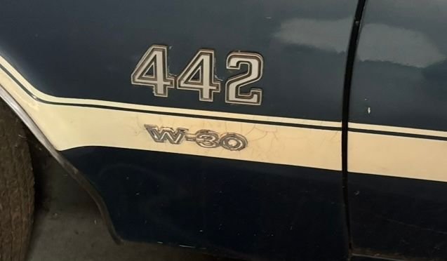

You say the car has good original paint. I would check the stripes closely. Any indications the wide W-30 stripes were painted over the thin standard 442 stripes?

not sure where the rest of my post went...

Car has been repainted as the stripes aren't close to correct.
wow!
thanks for the knowledge!

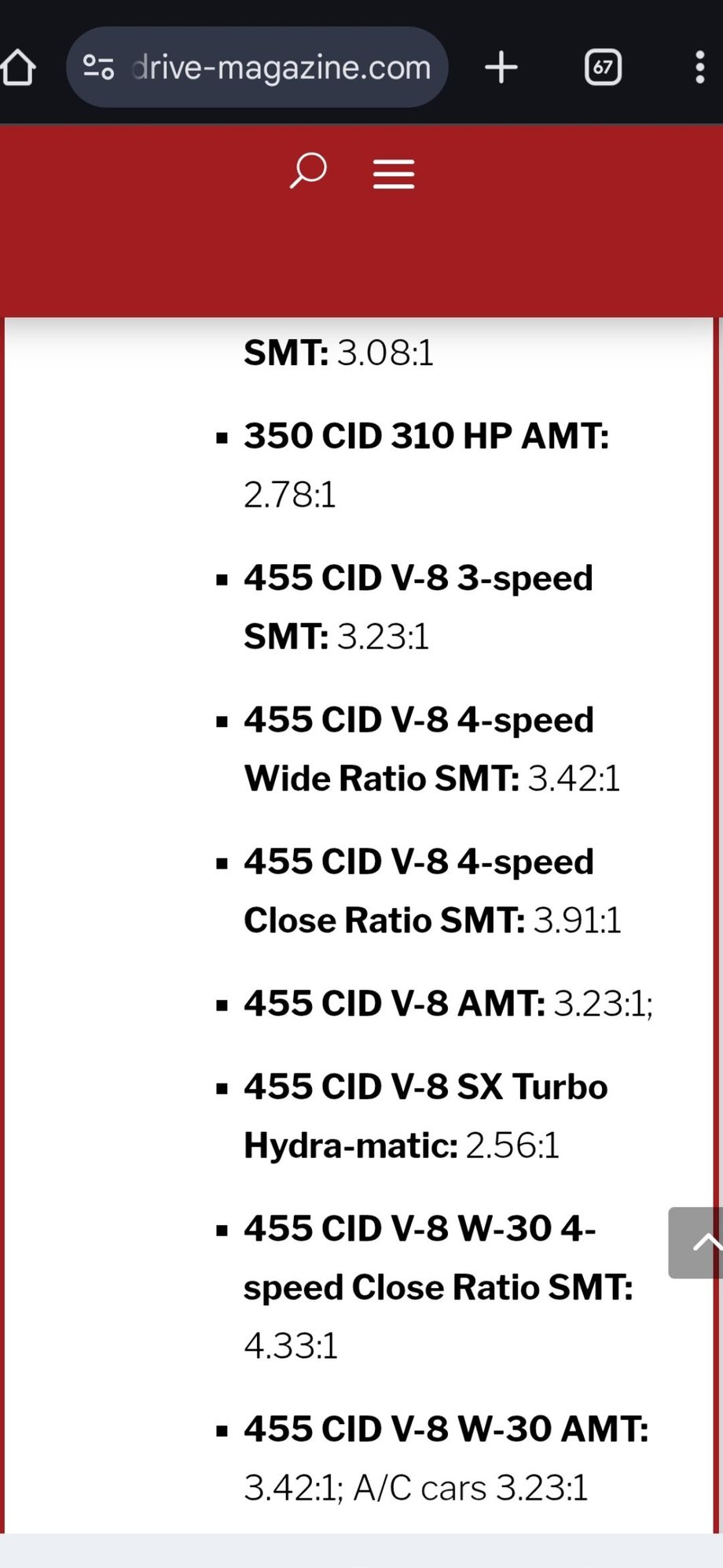

Originally Posted by chevyiiguy
it's 3.42 or 3.55 but that's done with the crude method that most of us learned how to do.
yes, sir, I would pop the diff cover if I really needed to confirm it
Either way, it's way off from a w30 stick.
3.42 was standard with regular 442 stick.
Here is every standard combo for 1970 455.
https://over-drive-magazine.com/2024...rs-fact-sheet/
I usually verify Over Drive Magazine with Automobile Catalog, but they have limited access to their site. Hopefully someone will chime in.
awesome! Thank you
so it could just be a w30 clone 442 with a 455, 4 speed, 12 bolt limited slip.

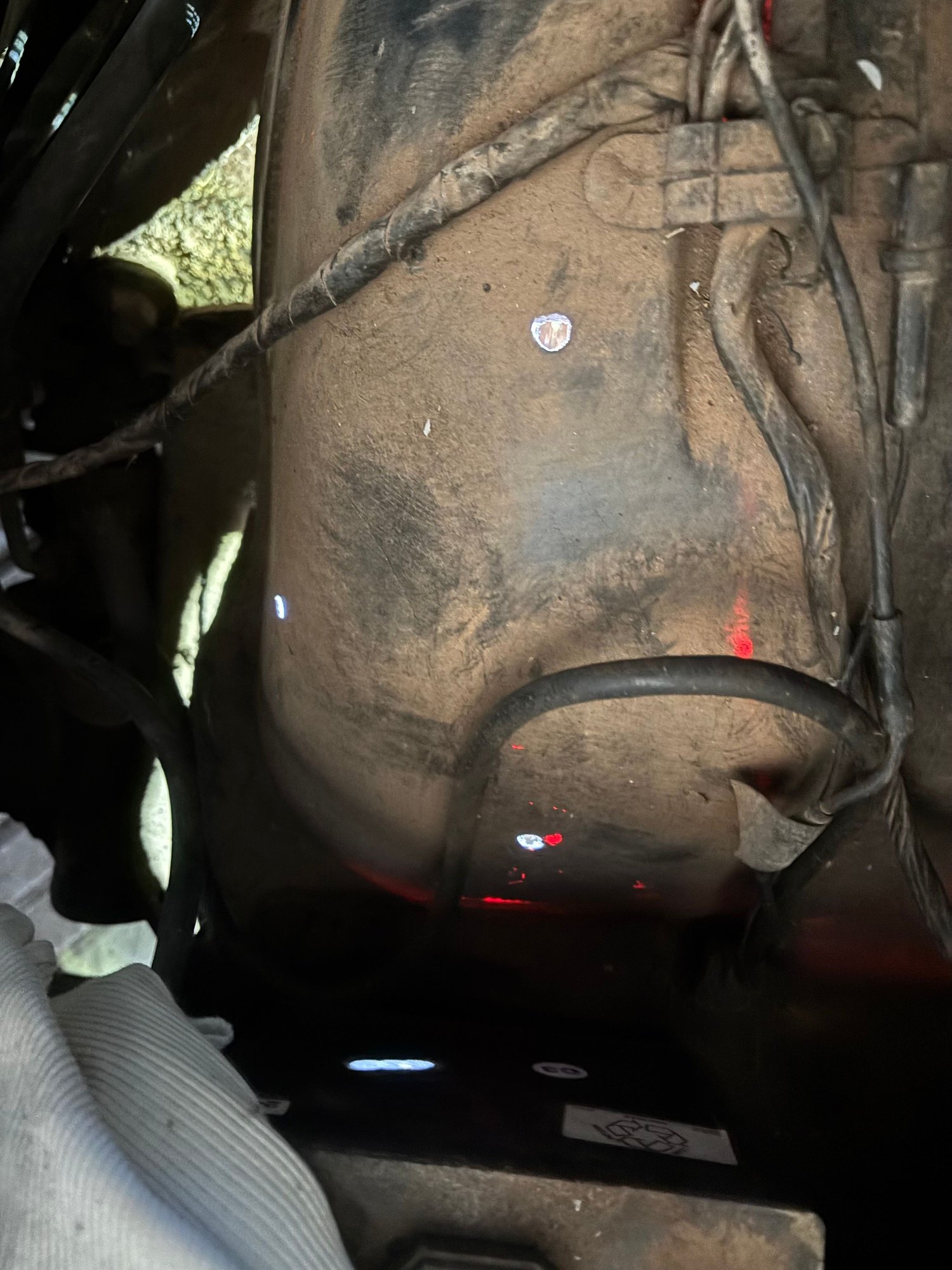

I am going to offer $10k. I cant get hurt at this price. It has new interior in bags and an extra muncie either m20 or 21.
floor pans so far look great with splatter? Paint, the rust i saw appears to be right passenger floor pan drop off. No body panel has obvious rust.
the red fender wells still have me on the w30 ride just a little. They were painted over:
Floor pans so far look great with splatter?
The red fender wells still have me on the W-30 ride just a little.
Somebody splattered the floorpans? That's weird.
I wouldn't let the red inners influence me one way or the other. Listen, there's a lot here that points to a W-30 but nothing provable.
You need to get a good look at whatever paperwork the seller has. If he has a real trim card with W-30 on it, you're golden. Failing that, I'd investigate the car's provenance on the off chance that it migrated South from Canada and can be documented that way, as mentioned above.
You need to be aware that authentication can make a huge difference in the car's value.
